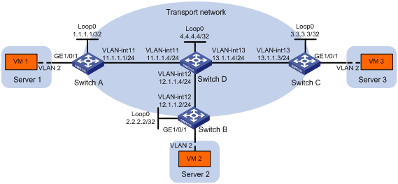

Example: Configuring VXLAN Layer 2 forwarding
As shown in Figure 1:
·     Configure VXLAN 10 as a unicast-mode VXLAN on Switch A, Switch B, and Switch C to provide Layer 2 connectivity for the VMs across the network sites.
·     Manually establish VXLAN tunnels and assign the tunnels to VXLAN 10.
Figure 1 Network diagram
Analysis
To ensure that the switches in the transport network can reach one another, configure a routing protocol on the switches to advertise routes for interfaces, including the loopback interfaces. In this example, OSPF is used.
To assign Switch A, Switch B, and Switch C to a VXLAN network, create VXLAN tunnels on the switches and assign the tunnels to the VXLAN.
To assign the customer traffic of a VLAN to a VXLAN, you must perform the following tasks:
·     Create an Ethernet service instance on the interface that receives the traffic.
·     Configure the Ethernet service instance to match the VLAN.
·     Map the Ethernet service instance to the VSI on which the VXLAN is created.

Execute the undo vxlan ip-forwarding command to enable Layer 2 forwarding for VXLANs on the VTEPs which are S5560X-EI switches.

Configuring IP addresses for interfaces
# Configure IP addresses for interfaces on Switch A.
<SwitchA> system-view
[SwitchA] vlan 11
[SwitchA-vlan11] port gigabitethernet 1/0/2
[SwitchA-vlan11] quit
[SwitchA] interface vlan-interface 11
[SwitchA-Vlan-interface11] ip address 11.1.1.1 24
[SwitchA-Vlan-interface11] quit
[SwitchA] interface loopback 0
[SwitchA-LoopBack0] ip address 1.1.1.1 32
[SwitchA-LoopBack0] quit

Configuring VXLAN settings
Configuring Switch A
# Enable L2VPN.
[SwitchA] l2vpn enable
# Enable Layer 2 forwarding for VXLANs. (Perform this step only on the S5560X-EI switch series.)
[SwitchA] undo vxlan ip-forwarding
# Create VSI vpna and VXLAN 10.
[SwitchA] vsi vpna
[SwitchA-vsi-vpna] vxlan 10
[SwitchA-vsi-vpna-vxlan10] quit
[SwitchA-vsi-vpna] quit
# Create a VXLAN tunnel to Switch B. The tunnel interface name is Tunnel 1.
[SwitchA] interface tunnel 1 mode vxlan
[SwitchA-Tunnel1] source 1.1.1.1
[SwitchA-Tunnel1] destination 2.2.2.2
[SwitchA-Tunnel1] quit
# Create a VXLAN tunnel to Switch C. The tunnel interface name is Tunnel 2.
[SwitchA] interface tunnel 2 mode vxlan
[SwitchA-Tunnel2] source 1.1.1.1
[SwitchA-Tunnel2] destination 3.3.3.3
[SwitchA-Tunnel2] quit
# Assign Tunnel 1 and Tunnel 2 to VXLAN 10.
[SwitchA] vsi vpna
[SwitchA-vsi-vpna-vxlan10] tunnel 1
[SwitchA-vsi-vpna-vxlan10] tunnel 2
# On GigabitEthernet 1/0/1, configure Ethernet service instance 1000 to match VLAN 2.
[SwitchA] interface gigabitethernet 1/0/1
[SwitchA-GigabitEthernet1/0/1] port link-type trunk
[SwitchA-GigabitEthernet1/0/1] port trunk permit vlan 2
[SwitchA-GigabitEthernet1/0/1] service-instance 1000
[SwitchA-GigabitEthernet1/0/1-srv1000] encapsulation s-vid 2
# Map Ethernet service instance 1000 to VSI vpna.
[SwitchA-GigabitEthernet1/0/1-srv1000] xconnect vsi vpna
[SwitchA-GigabitEthernet1/0/1-srv1000] quit
[SwitchA-GigabitEthernet1/0/1] quit
[SwitchC] interface gigabitethernet 1/0/1
[SwitchC-GigabitEthernet1/0/1] port link-type trunk
[SwitchC-GigabitEthernet1/0/1] port trunk permit vlan 2
[SwitchC-GigabitEthernet1/0/1] service-instance 1000
[SwitchC-GigabitEthernet1/0/1-srv1000] encapsulation s-vid 2
[SwitchC-GigabitEthernet1/0/1-srv1000] xconnect vsi vpna
[SwitchC-GigabitEthernet1/0/1-srv1000] quit
[SwitchC-GigabitEthernet1/0/1] quit
1.     Verify the VXLAN settings on the VTEPs. This example uses Switch A.
# Verify that the VXLAN tunnel interfaces on the VTEP are in up state.
[SwitchA] display interface tunnel
Tunnel1
Current state: UP
Line protocol state: UP
Description: Tunnel1 Interface
Bandwidth: 64 kbps
Maximum transmission unit: 1464
Internet protocol processing: Disabled
Last clearing of counters: Never
Tunnel source 1.1.1.1, destination 2.2.2.2
Tunnel protocol/transport UDP_VXLAN/IP
Last 300 seconds input rate: 0 bytes/sec, 0 bits/sec, 0 packets/sec
Last 300 seconds output rate: 0 bytes/sec, 0 bits/sec, 0 packets/sec
Input: 0 packets, 0 bytes, 0 drops
Output: 0 packets, 0 bytes, 0 drops
Tunnel2
Current state: UP
Description: Tunnel2 Interface
Bandwidth: 64 kbps
Tunnel source 1.1.1.1, destination 3.3.3.3
# Verify that the VXLAN tunnels have been assigned to the VXLAN, and the VXLAN tunnels and Ethernet service instances are in up state.
[SwitchA] display l2vpn vsi verbose
VSI Name: vpna
  VSI Index               : 0
  VSI State               : Up
  MTU                     : 1500
  Bandwidth               : -
  Broadcast Restrain      : -
  Multicast Restrain      : -
  Unknown Unicast Restrain: -
  MAC Learning            : Enabled
  MAC Table Limit         : -
  Drop Unknown            : -
  Flooding                : Enabled
  Statistics              : Disabled
  VXLAN ID                : 10
  Tunnels:
    Tunnel Name          Link ID    State  Type        Flood proxy
    Tunnel1              0x5000001  Up     Manual      Disabled
    Tunnel2              0x5000002  Up     Manual      Disabled
  ACs:
    AC                               Link ID    State     Type
    GE1/0/1 srv1000                  0          Up        Manual
# Verify that the VTEP has learned the MAC addresses of remote VMs.
[SwitchA] display l2vpn mac-address
MAC Address      State    VSI Name                        Link ID/Name  Aging
cc3e-5f9c-6cdb   Dynamic  vpna                            Tunnel1       Aging
cc3e-5f9c-23dc   Dynamic  vpna                            Tunnel2       Aging
--- 2 mac address(es) found  ---
2.     Verify that VM 1, VM 2, and VM 3 can ping each other. (Details not shown.)

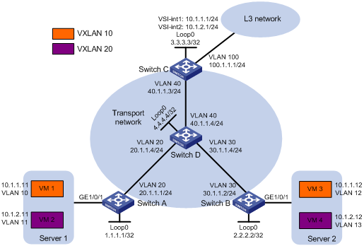

Example: Configuring a centralized VXLAN IP gateway
As shown in Figure 2:
·     Configure VXLAN 10 and VXLAN 20 as unicast-mode VXLANs on Switch A, Switch B, and Switch C.
·     Manually establish VXLAN tunnels and assign the tunnels to VXLAN 10 or VXLAN 20. Make sure VM 1 and VM 3 belong to VXLAN 10 and VM 2 and VM 4 belong to VXLAN 20.
·     Configure a centralized VXLAN IP gateway on Switch C to provide gateway services for VXLAN 10 and VXLAN 20.
Figure 2 Network diagram
Analysis
To assign Switch A, Switch B, and Switch C to VXLANs, create VXLAN tunnels on the switches and assign the tunnels to the VXLANs.
To assign the customer traffic of a VLAN to a VXLAN on Switch A or Switch B, you must perform the following tasks:
For Switch C to provide centralized VXLAN IP gateway services for VXLANs, you must perform the following tasks:
·     Create a VSI interface for each VXLAN on the switch.
·     Assign an IP address to each VSI interface.
·     Specify the VSI interfaces as the gateway interfaces for VXLANs.
For Layer 3 nodes in the transport network to reach the VMs, configure a routing protocol on Switch C to advertise routes for VSI interfaces and VLAN-interface 100. In this example, OSPF is used.
[SwitchA] vlan 20
[SwitchA-vlan20] port gigabitethernet 1/0/2
[SwitchA-vlan20] quit
[SwitchA] interface vlan-interface 20
[SwitchA-Vlan-interface20] ip address 20.1.1.1 24
[SwitchA-Vlan-interface20] quit
# Configure IP addresses for interfaces on other devices in the same way the IP addresses are configured on Switch A. (Details not shown.)
Configuring a routing protocol on the transport network
# Configure OSPF to advertise routes for Switch A.
[SwitchA] ospf 1 router-id 1.1.1.1
[SwitchA-ospf-1] area 0
[SwitchA-ospf-1-area-0.0.0.0] network 1.1.1.1 0.0.0.0
[SwitchA-ospf-1-area-0.0.0.0] network 20.1.1.0 0.0.0.255
[SwitchA-ospf-1-area-0.0.0.0] quit
[SwitchA-ospf-1] quit
# Configure OSPF to advertise routes for Switch B.
[SwitchB] ospf 1 router-id 2.2.2.2
[SwitchB-ospf-1] area 0
[SwitchB-ospf-1-area-0.0.0.0] network 2.2.2.2 0.0.0.0
[SwitchB-ospf-1-area-0.0.0.0] network 30.1.1.0 0.0.0.255
[SwitchB-ospf-1-area-0.0.0.0] quit
[SwitchB-ospf-1] quit
# Configure OSPF to advertise routes for Switch C.
[SwitchC] ospf 1 router-id 3.3.3.3
[SwitchC-ospf-1] area 0
[SwitchC-ospf-1-area-0.0.0.0] network 3.3.3.3 0.0.0.0
[SwitchC-ospf-1-area-0.0.0.0] network 40.1.1.0 0.0.0.255
[SwitchC-ospf-1-area-0.0.0.0] quit
[SwitchC-ospf-1] quit
# Configure OSPF to advertise routes for Switch D.
[SwitchD] ospf 1 router-id 4.4.4.4
[SwitchD-ospf-1] area 0
[SwitchD-ospf-1-area-0.0.0.0] network 4.4.4.4 0.0.0.0
[SwitchD-ospf-1-area-0.0.0.0] network 20.1.1.0 0.0.0.255
[SwitchD-ospf-1-area-0.0.0.0] network 30.1.1.0 0.0.0.255
[SwitchD-ospf-1-area-0.0.0.0] network 40.1.1.0 0.0.0.255
[SwitchD-ospf-1-area-0.0.0.0] quit
[SwitchD-ospf-1] quit
Configuring basic VXLAN settings
# Enable L2VPN.
[SwitchA] vsi vpna
# Create VSI vpnb and VXLAN 20.
[SwitchA] vsi vpnb
[SwitchA-vsi-vpnb] vxlan 20
[SwitchA-vsi-vpnb-vxlan10] quit
[SwitchA-vsi-vpnb] quit
[SwitchA] vsi vpna
# Assign Tunnel 1 and Tunnel 2 to VXLAN 20.
[SwitchA] vsi vpnb
[SwitchA-vsi-vpnb-vxlan20] tunnel 1
[SwitchA-vsi-vpnb-vxlan20] tunnel 2
[SwitchA-vsi-vpnb-vxlan20] quit
# On GigabitEthernet 1/0/1, configure Ethernet service instance 1000 to match VLAN 10.
[SwitchA-GigabitEthernet1/0/1] port trunk permit vlan 10 11
[SwitchA-GigabitEthernet1/0/1-srv1000] encapsulation s-vid 10
# On GigabitEthernet 1/0/1, configure Ethernet service instance 2000 to match VLAN 11.
[SwitchA-GigabitEthernet1/0/1] service-instance 2000
[SwitchA-GigabitEthernet1/0/1-srv2000] encapsulation s-vid 11
# Map Ethernet service instance 2000 to VSI vpnb.
[SwitchA-GigabitEthernet1/0/1-srv2000] xconnect vsi vpnb
[SwitchA-GigabitEthernet1/0/1-srv2000] quit
Configuring Switch B
# Enable L2VPN.
[SwitchB] l2vpn enable
[SwitchB] undo vxlan ip-forwarding
[SwitchB] vsi vpna
[SwitchB-vsi-vpna] vxlan 10
[SwitchB-vsi-vpna-vxlan10] quit
[SwitchB-vsi-vpna] quit
[SwitchB] vsi vpnb
[SwitchB-vsi-vpnb] vxlan 20
[SwitchB-vsi-vpnb-vxlan10] quit
[SwitchB-vsi-vpnb] quit
# Create a VXLAN tunnel to Switch A. The tunnel interface name is Tunnel 1.
[SwitchB] interface tunnel 1 mode vxlan
[SwitchB-Tunnel1] source 2.2.2.2
[SwitchB-Tunnel1] destination 1.1.1.1
[SwitchB-Tunnel1] quit
[SwitchB] interface tunnel 2 mode vxlan
[SwitchB-Tunnel2] source 2.2.2.2
[SwitchB-Tunnel2] destination 3.3.3.3
[SwitchB-Tunnel2] quit
[SwitchB] vsi vpna
[SwitchB-vsi-vpna-vxlan10] tunnel 1
[SwitchB-vsi-vpna-vxlan10] tunnel 2
[SwitchB] vsi vpnb
[SwitchB-vsi-vpnb-vxlan20] tunnel 1
[SwitchB-vsi-vpnb-vxlan20] tunnel 2
[SwitchB-vsi-vpnb-vxlan20] quit
# On GigabitEthernet 1/0/1, configure Ethernet service instance 1000 to match VLAN 12.
[SwitchB] interface gigabitethernet 1/0/1
[SwitchB-GigabitEthernet1/0/1] port link-type trunk
[SwitchB-GigabitEthernet1/0/1] port trunk permit vlan 12 13
[SwitchB-GigabitEthernet1/0/1] service-instance 1000
[SwitchB-GigabitEthernet1/0/1-srv1000] encapsulation s-vid 12
[SwitchB-GigabitEthernet1/0/1-srv1000] xconnect vsi vpna
[SwitchB-GigabitEthernet1/0/1-srv1000] quit
# On GigabitEthernet 1/0/1, configure Ethernet service instance 2000 to match VLAN 13.
[SwitchB-GigabitEthernet1/0/1] service-instance 2000
[SwitchB-GigabitEthernet1/0/1-srv2000] encapsulation s-vid 13
[SwitchB-GigabitEthernet1/0/1-srv2000] xconnect vsi vpnb
[SwitchB-GigabitEthernet1/0/1-srv2000] quit
[SwitchB-GigabitEthernet1/0/1] quit
Configuring Switch C
# Enable L2VPN.
[SwitchC] l2vpn enable
[SwitchC] vsi vpna
[SwitchC-vsi-vpna] vxlan 10
[SwitchC-vsi-vpna-vxlan10] quit
[SwitchC-vsi-vpna] quit
[SwitchC] vsi vpnb
[SwitchC-vsi-vpnb] vxlan 20
[SwitchC-vsi-vpnb-vxlan10] quit
[SwitchC-vsi-vpnb] quit
[SwitchC] interface tunnel 1 mode vxlan
[SwitchC-Tunnel1] source 3.3.3.3
[SwitchC-Tunnel1] destination 1.1.1.1
[SwitchC-Tunnel1] quit
# Create a VXLAN tunnel to Switch B. The tunnel interface name is Tunnel 2.
[SwitchC] interface tunnel 2 mode vxlan
[SwitchC-Tunnel2] source 3.3.3.3
[SwitchC-Tunnel2] destination 2.2.2.2
[SwitchC-Tunnel2] quit
[SwitchC] vsi vpna
[SwitchC-vsi-vpna-vxlan10] tunnel 1
[SwitchC-vsi-vpna-vxlan10] tunnel 2
[SwitchC] vsi vpnb
[SwitchC-vsi-vpnb-vxlan20] tunnel 1
[SwitchC-vsi-vpnb-vxlan20] tunnel 2
[SwitchC-vsi-vpnb-vxlan20] quit
Configuring the centralized VXLAN IP gateway
# Create VSI-interface 1 and assign the interface an IP address. The IP address will be used as the gateway address for VXLAN 10.
[SwitchC] interface vsi-interface 1
[SwitchC-Vsi-interface1] ip address 10.1.1.1 255.255.255.0
[SwitchC-Vsi-interface1] quit
# Specify VSI-interface 1 as the gateway interface for VSI vpna.
[SwitchC] vsi vpna
[SwitchC-vsi-vpna] gateway vsi-interface 1
# Create VSI-interface 2 and assign the interface an IP address. The IP address will be used as the gateway address for VXLAN 20.
[SwitchC] interface vsi-interface 2
[SwitchC-Vsi-interface2] ip address 10.1.2.1 255.255.255.0
[SwitchC-Vsi-interface2] quit
# Specify VSI-interface 2 as the gateway interface for VSI vpnb.
[SwitchC] vsi vpnb
[SwitchC-vsi-vpnb] gateway vsi-interface 2
# Configure OSPF to advertise routes for the VSI interfaces and VLAN-interface 100.
[SwitchC] ospf 2 router-id 3.3.3.3
[SwitchC-ospf-2] area 0
[SwitchC-ospf-2-area-0.0.0.0] network 10.1.1.0 0.0.0.255
[SwitchC-ospf-2-area-0.0.0.0] network 10.1.2.0 0.0.0.255
[SwitchC-ospf-2-area-0.0.0.0] network 100.1.1.0 0.0.0.255
[SwitchC-ospf-2-area-0.0.0.0] quit
[SwitchC-ospf-2] quit
# Verify that the VXLAN tunnel interfaces are in up state.
Tunnel1
Current state: UP
Bandwidth: 64 kbps
Tunnel2
Current state: UP
Bandwidth: 64 kbps
# Verify that the VXLAN tunnels have been assigned to their respective VXLANs, and the VXLAN tunnels and Ethernet service instances are in up state.
VSI Name: vpna
  VSI Index               : 0
  VSI State               : Up
  MTU                     : 1500
  Bandwidth               : -
  MAC Table Limit         : -
  Drop Unknown            : -
  Flooding                : Enabled
  VXLAN ID                : 10
  Tunnels:
  ACs:
VSI Name: vpnb
  VSI Index               : 1
  VSI State               : Up
  MTU                     : 1500
  Bandwidth               : -
  MAC Table Limit         : -
  Drop Unknown            : -
  Flooding                : Enabled
  VXLAN ID                : 20
  Tunnels:
  ACs:
    GE1/0/1 srv2000                  0          Up          Manual
2.     Verify the configuration on the VXLAN IP gateway:
[SwitchC] display interface tunnel
Tunnel1
Current state: UP
Bandwidth: 64 kbps
Tunnel source 3.3.3.3, destination 1.1.1.1
Tunnel2
Current state: UP
Bandwidth: 64 kbps
Tunnel source 3.3.3.3, destination 2.2.2.2
# Verify that the VSI interfaces are in up state.
[SwitchC] display interface vsi-interface
Vsi-interface1
Current state: UP
Description: Vsi-interface1 Interface
Bandwidth: 1000000 kbps
Maximum transmission unit: 1500
Internet Address: 10.1.1.1/24 (primary)
IP packet frame type: Ethernet II, hardware address: 0000-fc00-458d
IPv6 packet frame type: Ethernet II, hardware address: 0000-fc00-458d
Physical: Unknown, baudrate: 1000000 kbps
Vsi-interface2
Current state: UP
Description: Vsi-interface2 Interface
Internet Address:  10.1.2.1/24 (primary)
# Verify that the VXLAN tunnels have been assigned to VXLANs 10 and 20, VSI-interface 1 is the gateway interface of VSI vpna, and VSI-interface 2 is the gateway interface of VSI vpnb.
[SwitchC] display l2vpn vsi verbose
VSI Name: vpna
  VSI Index               : 0
  VSI State               : Up
  MTU                     : 1500
  Bandwidth               : -
  MAC Table Limit         : -
  Drop Unknown            : -
  Flooding                : Enabled
  Gateway interface       : VSI-interface 1
  VXLAN ID                : 10
  Tunnels:
    Tunnel Name          Link ID    State    Type        Flooding proxy
    Tunnel1              0x5000002  Up       Manual      Disabled
    Tunnel2              0x5000003  Up       Manual      Disabled
VSI Name: vpnb
  VSI Index               : 1
  VSI State               : Up
  MTU                     : 1500
  Bandwidth               : -
  MAC Table Limit         : -
  Drop Unknown            : -
  Flooding                : Enabled
  Gateway interface       : VSI-interface 2
  VXLAN ID                : 20
  Tunnels:
# Verify that Switch C has created ARP entries for the VMs.
[SwitchC] display arp
  Type: S-Static   D-Dynamic   O-Openflow   R-Rule   M-Multiport  I-Invalid
IP address       MAC address    VLAN/VSI  Interface/Link ID        Aging Type
10.1.1.11        0000-1234-0001 N/A       Tunnel1                  20    D
10.1.1.12        0000-1234-0002 N/A       Tunnel2                  19    D
# Verify that Switch C has created FIB entries for the VMs.
[SwitchC] display fib 10.1.1.11
Destination count: 1 FIB entry count: 1
Flag:
  U:Useable   G:Gateway   H:Host   B:Blackhole   D:Dynamic   S:Static
  R:Relay     F:FRR
Destination/Mask   Nexthop         Flag     OutInterface/Token       Label
10.1.1.11/32       10.1.1.11       UH       Vsi1                     Null
3.     Verify the network connectivity for VMs:
# Verify that VM 1, VM 2, VM 3, and VM 4 can ping each other. (Details not shown.)
# Verify that VM 1, VM 2, VM 3, VM 4, and VLAN-interface 100 (100.1.1.1) on Switch C can ping each other. (Details not shown.)

IMPORTANT:
The undo vxlan ip-forwarding command is available only on the S5560X-EI switch series.
·     Switch A:
 area 0.0.0.0
vlan 20
 l2vpn enable
vsi vpna
 vxlan 10
  tunnel 1
  tunnel 2
vsi vpnb
 vxlan 20
  tunnel 1
  tunnel 2
interface LoopBack0
 ip address 1.1.1.1 255.255.255.255
interface Vlan-interface20
 ip address 20.1.1.1 255.255.255.0
 port link-mode bridge
  xconnect vsi vpna
  xconnect vsi vpnb
 port access vlan 20
interface Tunnel1 mode vxlan
 source 1.1.1.1
 destination 2.2.2.2
interface Tunnel2 mode vxlan
 source 1.1.1.1
 destination 3.3.3.3
·     Switch B:
 area 0.0.0.0
vlan 30
 l2vpn enable
vsi vpna
 vxlan 10
  tunnel 1
  tunnel 2
vsi vpnb
 vxlan 20
  tunnel 1
  tunnel 2
interface LoopBack0
 ip address 2.2.2.2 255.255.255.255
interface Vlan-interface30
 ip address 30.1.1.2 255.255.255.0
  xconnect vsi vpna
  xconnect vsi vpnb
 port access vlan 30
 source 2.2.2.2
 destination 1.1.1.1
 source 2.2.2.2
 destination 3.3.3.3
·     Switch C:
 area 0.0.0.0
 area 0.0.0.0
vlan 40
vlan 100
 l2vpn enable
vsi vpna
 vxlan 10
  tunnel 1
  tunnel 2
vsi vpnb
 vxlan 20
  tunnel 1
  tunnel 2
interface LoopBack0
 ip address 3.3.3.3 255.255.255.255
interface Vlan-interface40
 ip address 40.1.1.3 255.255.255.0
interface Vlan-interface100
 ip address 100.1.1.1 255.255.255.0
 port access vlan 40
 port access vlan 100
interface Vsi-interface1
interface Vsi-interface2
 source 3.3.3.3
 destination 1.1.1.1
 source 3.3.3.3
 destination 2.2.2.2
return
·     Switch D:
 area 0.0.0.0
vlan 20
vlan 30
vlan 40
interface LoopBack0
 ip address 4.4.4.4 255.255.255.255
 ip address 20.1.1.4 255.255.255.0
 ip address 30.1.1.4 255.255.255.0
 ip address 40.1.1.4 255.255.255.0
 port access vlan 20
 port access vlan 30
 port access vlan 40
return
