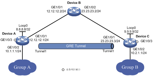

As shown in Figure 1, Group A and Group B are two private IPv4 networks. Device A and Device C will establish a GRE tunnel to interconnect Group 1 and Group 2.
To save IP address space, configure tunnel interface Tunnel 1 to borrow an IP address from the loopback interface loopback 0.
Figure 1 Network diagram

For the S6520XE-HI switch series, create a service loopback group and specify the unicast tunnel service for the group before you create a GRE tunnel.
Configuring Device A
1.     Assign IP addresses to the interfaces:
# Assign IP addresses to GigabitEthernet 1/0/1 and loopback 0.
<DeviceA> system-view
[DeviceA-GigabitEthernet1/0/1] ip address 12.12.12.1 24
[DeviceA-GigabitEthernet1/0/1] quit
[DeviceA] interface loopback 0
[DeviceA-LoopBack0] ip address 8.8.8.8 32
[DeviceA-LoopBack0] quit
# Assign IP addresses to other interfaces in the same way an IP address is assigned to GigabitEthernet 1/0/1. (Details not shown.)
2.     Configure OSPF:
# Enable OSPF process 1.
[DeviceA] ospf 1
# Create Area 0 and specify GigabitEthernet 1/0/1 whose IP address is on network 12.12.12.0/24 to run OSPF in Area 0.
[DeviceA-ospf-1] area 0
[DeviceA-ospf-1-area-0.0.0.0] network 12.12.12.0 0.0.0.255
[DeviceA-ospf-1-area-0.0.0.0] quit
[DeviceA-ospf-1] quit
3.     Configure a GRE tunnel:
# Create service loopback group 1 and specify the unicast tunnel service for the group.
[DeviceA] service-loopback group 1 type tunnel
# Assign GigabitEthernet 1/0/3 to the service loopback group.
[DeviceA] interface gigabitethernet 1/0/3
[DeviceA-GigabitEthernet1/0/3] port service-loopback group 1
[DeviceA-GigabitEthernet1/0/3] quit
# Create a tunnel interface Tunnel 1, and specify the tunnel mode as GRE/IPv4.
[DeviceA] interface tunnel 1 mode gre
# Specify 12.12.12.1 as the source address of interface Tunnel 1.
[DeviceA-Tunnel1] source 12.12.12.1
# Specify 23.23.23.3 as the destination address of interface Tunnel 1.
[DeviceA-Tunnel1] destination 23.23.23.3
# Configure interface Tunnel 1 to borrow an IP address from loopback 0.
[DeviceA-Tunnel1] ip address unnumbered interface loopback 0
[DeviceA-Tunnel1] quit
# Configure a static route from Device A through the tunnel interface to Group B.
[DeviceA] ip route-static 10.2.1.0 255.255.255.0 tunnel 1
Configuring Device B
# Assign an IP address to GigabitEthernet 1/0/1.
<DeviceB> system-view
[DeviceB-GigabitEthernet1/0/1] ip address 12.12.12.2 24
[DeviceB-GigabitEthernet1/0/1] quit
# Assign an IP address to GigabitEthernet 1/0/2 in the same way an IP address is assigned to GigabitEthernet 1/0/1. (Details not shown.)
2.     Configure OSPF:
[DeviceB] ospf 1
[DeviceB-ospf-1] area 0
[DeviceB-ospf-1-area-0.0.0.0] network 12.12.12.0 0.0.0.255
# Create Area 0 and specify GigabitEthernet 1/0/2 whose IP address is on network 23.23.23.0/24 to run OSPF in Area 0.
[DeviceB-ospf-1-area-0.0.0.0] network 23.23.23.0 0.0.0.255
[DeviceB-ospf-1-area-0.0.0.0] quit
[DeviceB-ospf-1] quit
Configuring Device C
<DeviceC> system-view
[DeviceC] interface gigabitethernet 1/0/1
[DeviceC-GigabitEthernet1/0/1] ip address 23.23.23.3 24
[DeviceC-GigabitEthernet1/0/1] quit
[DeviceC] interface loopback 0
[DeviceC-LoopBack0] ip address 9.9.9.9 32
[DeviceC-LoopBack0] quit
2.     Configure OSPF:
[DeviceC] ospf 1
# Create Area 0 and specify GigabitEthernet 1/0/1 whose IP address is on network 23.23.23.0/24 to run OSPF in Area 0.
[DeviceC-ospf-1] area 0
[DeviceC-ospf-1-area-0.0.0.0] network 23.23.23.0 0.0.0.255
[DeviceC-ospf-1-area-0.0.0.0] quit
[DeviceC-ospf-1] quit
[DeviceC] service-loopback group 1 type tunnel
[DeviceC] interface gigabitethernet 1/0/3
[DeviceC-GigabitEthernet1/0/3] port service-loopback group 1
[DeviceC-GigabitEthernet1/0/3] quit
[DeviceC] interface tunnel 1 mode gre
# Specify 23.23.23.3 as the source address of interface Tunnel 1.
[DeviceC-Tunnel1] source 23.23.23.3
# Specify 12.12.12.1 as the destination address of interface Tunnel 1.
[DeviceC-Tunnel1] destination 12.12.12.1
[DeviceC-Tunnel1] ip address unnumbered interface loopback 0
[DeviceC-Tunnel1] quit
# Configure a static route from Device C through the tunnel interface to Group A.
[DeviceC] ip route-static 10.1.1.0 255.255.255.0 tunnel 1
This example uses Device A to verify the configuration.
# Verify that the interface Tunnel 1 has borrowed the IP address 8.8.8.8/32 from loopback 0.
[DeviceA] display interface tunnel 1
Tunnel1
Current state: UP
Line protocol state: UP
Description: Tunnel1 Interface
Bandwidth: 64kbps
Maximum transmission unit: 1476
Internet Address: 8.8.8.8/32 (Unnumbered)
Tunnel source 12.12.12.1, destination 23.23.23.3
Tunnel keepalive disabled
Tunnel TTL 255
Tunnel protocol/transport GRE/IP
    GRE key disabled
    Checksumming of GRE packets disabled
Last clearing of counters: Never
Last 300 seconds input rate: 0 bytes/sec, 0 bits/sec, 0 packets/sec
Last 300 seconds output rate: 0 bytes/sec, 0 bits/sec, 0 packets/sec
Input: 11 packets, 924 bytes, 0 drops
Output: 10 packets, 840 bytes, 0 drops
# Verify that GigabitEthernet 1/0/2 on Device A can ping the IP address of GigabitEthernet 1/0/2 on Device C.
[DeviceA] ping -a 10.1.1.1 10.2.1.1
Ping 10.2.1.1 (10.2.1.1) from 10.1.1.1: 56 data bytes, press CTRL_C to break
56 bytes from 10.2.1.1: icmp_seq=0 ttl=255 time=32.641 ms
56 bytes from 10.2.1.1: icmp_seq=1 ttl=255 time=4.881 ms
56 bytes from 10.2.1.1: icmp_seq=2 ttl=255 time=4.816 ms
56 bytes from 10.2.1.1: icmp_seq=3 ttl=255 time=26.393 ms
56 bytes from 10.2.1.1: icmp_seq=4 ttl=255 time=43.003 ms
--- Ping statistics for 10.2.1.1 ---
round-trip min/avg/max/std-dev = 4.816/22.347/43.003/15.241 ms
