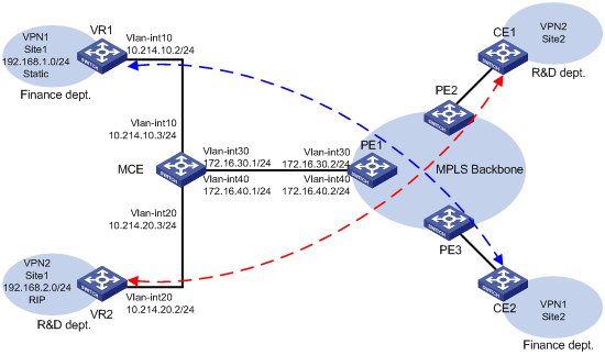

Example: Configuring the MCE to advertise VPN routes to the PE by using OSPF (on switches)
As shown in Figure 1, an enterprise has two MPLS L3VPNs. VPN 1 for the finance department uses static routes, and VPN 2 for the R&D department uses RIP routes. Site 1 of VPN 1 and Site 1 of VPN 2 are connected to the MPLS backbone through the same CE device (MCE). Site 2 of VPN 1 and Site 2 of VPN 2 are connected to the MPLS backbone through separate CEs (CE 1 and CE 2).
Configure the MCE to allow communication between the local and remote sites of the same VPN and isolate access between sites of different VPNs.
Configure the MCE and PE 1 to use OSPF to exchange VPN routes.
Figure 1 Network diagram

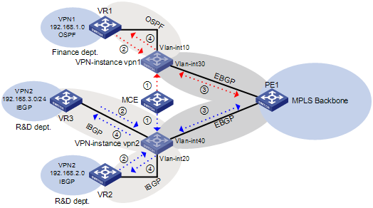

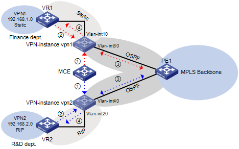

Analysis
To meet the network requirements, you must perform the following tasks:
1.     Create VPN instances on the MCE and PE 1, and bind each VPN instance to the interfaces that need to forward data for that VPN instance.
2.     Redistribute the VPN routes to the routing table of the corresponding VPN instance.
3.     Advertise the VPN routes to PE 1 through OSPF, and receive remote VPN routes from PE 1.
4.     Redistribute the remote VPN routes to the local VPN sites.

3.     Configure routing between the MCE and PE 1:
# On the MCE, bind Loopback 0 to the VPN instance vpn1 and configure an IP address for the loopback interface.
[MCE] interface Loopback 0
[MCE-Loopback0] ip binding vpn-instance vpn1
[MCE-Loopback0] ip address 100.100.10.1 32
[MCE-Loopback0] quit
# On PE 1, bind Loopback 0 to the VPN instance vpn1 and configure an IP address for the loopback interface.
[PE1] interface Loopback 0
[PE1-Loopback0] ip binding vpn-instance vpn1
[PE1-Loopback0] ip address 100.100.11.1 32
[PE1-Loopback0] quit
# On the MCE, enable OSPF process 10, specify the router ID as the IP address of Loopback 0, and bind the process to the VPN instance vpn1.
[MCE] ospf 10 router-id 100.100.10.1 vpn-instance vpn1
# Disable routing loop detection for OSPF process 10.
[MCE-ospf-10] vpn-instance-capability simple
# Advertise the network 172.16.30.0/24 in area 0, and redistribute the static route of VPN 1.
[MCE-ospf-10] area 0
[MCE-ospf-10-area-0.0.0.0] network 172.16.30.0 0.0.0.255
[MCE-ospf-10-area-0.0.0.0] quit
[MCE-ospf-10] import-route static
[MCE-ospf-10] quit
# On PE 1, enable OSPF process 10, specify the router ID as the IP address of Loopback 0, and bind the process to the VPN instance vpn1.
[PE1] ospf 10 router-id 100.100.11.1 vpn-instance vpn1
# Set the domain ID to 10.
[PE1-ospf-10] domain-id 10
[PE1-ospf-10] vpn-instance-capability simple
# Advertise the network 172.16.30.0/24 in area 0.
[PE1-ospf-10] area 0
[PE1-ospf-10-area-0.0.0.0] network 172.16.30.0 0.0.0.255
# On the MCE, bind Loopback 1 to the VPN instance vpn2 and configure an IP address for the loopback interface.
[MCE] interface Loopback 1
[MCE-Loopback1] ip binding vpn-instance vpn2
[MCE-Loopback1] ip address 100.100.20.1 32
# On PE 1, bind Loopback 1 to the VPN instance vpn2 and configure an IP address for the loopback interface.
[PE1] interface Loopback 1
[PE1-Loopback1] ip binding vpn-instance vpn2
[PE1-Loopback1] ip address 100.100.21.1 32
# On the MCE, enable OSPF process 20, specify the router ID as the IP address of Loopback 1, and bind the process to the VPN instance vpn2.
[MCE] ospf 20 router-id 100.100.20.1 vpn-instance vpn2
# Disable routing loop detection for OSPF process 20.
[MCE-ospf-20] vpn-instance-capability simple
# Advertise the network 172.16.40.0/24 in area 0, and redistribute the RIP route of VPN 2.
[MCE-ospf-20] area 0
[MCE-ospf-20-area-0.0.0.0] network 172.16.40.0 0.0.0.255
[MCE-ospf-20-area-0.0.0.0] quit
[MCE-ospf-20] import-route rip 20
# On PE 1, enable OSPF process 20, specify the router ID as the IP address of Loopback 1, and bind the process to the VPN instance vpn2.
[PE1] ospf 20 router-id 100.100.21.1 vpn-instance vpn2
# Set the domain ID to 20.
[PE1-ospf-20] domain-id 20
[PE1-ospf-20] vpn-instance-capability simple
# Advertise the network 172.16.40.0/24 in area 0.
[PE1-ospf-20] area 0
[PE1-ospf-20-area-0.0.0.0] network 172.16.40.0 0.0.0.255

# Verify that PE 1 has learned the static route of VPN 1 through OSPF.
[PE1] display ip routing-table vpn-instance vpn1
Destinations : 14        Routes : 14
Destination/Mask   Proto   Pre Cost        NextHop         Interface
0.0.0.0/32         Direct  0   0           127.0.0.1       InLoop0
100.100.11.1/32    Direct  0   0           127.0.0.1       InLoop0
127.0.0.0/8        Direct  0   0           127.0.0.1       InLoop0
127.0.0.0/32       Direct  0   0           127.0.0.1       InLoop0
127.0.0.1/32       Direct  0   0           127.0.0.1       InLoop0
127.255.255.255/32 Direct  0   0           127.0.0.1       InLoop0
172.16.30.0/24     Direct  0   0           172.16.30.2     Vlan30
172.16.30.0/32     Direct  0   0           172.16.30.2     Vlan30
172.16.30.2/32     Direct  0   0           127.0.0.1       InLoop0
172.16.30.255/32   Direct  0   0           172.16.30.2     Vlan30
192.168.1.0/24     O_INTRA 150 1           172.16.30.1     Vlan30
224.0.0.0/4        Direct  0   0           0.0.0.0         NULL0
224.0.0.0/24       Direct  0   0           0.0.0.0         NULL0
255.255.255.255/32 Direct  0   0           127.0.0.1       InLoop0
# Verify that PE 1 has learned the RIP route of VPN 2 through OSPF.
[PE1] display ip routing-table vpn-instance vpn2
100.100.21.1/32    Direct  0   0           127.0.0.1       InLoop0
172.16.40.0/24     Direct  0   0           172.16.40.2     Vlan40
172.16.40.0/32     Direct  0   0           172.16.40.2     Vlan40
172.16.40.2/32     Direct  0   0           127.0.0.1       InLoop0
172.16.40.255/32   Direct  0   0           172.16.40.2     Vlan40
192.168.2.0/24     O_INTRA 150 1           172.16.40.1     Vlan40
Configuration files
·     VR 1:
 vlan 10
interface Vlan-interface10
 ip address 10.214.10.2 255.255.255.0
 ip route-static 0.0.0.0 0 10.214.10.3
·     VR 2:
rip 20
 network 10.0.0.0
 network 192.168.2.0
 vlan 20
interface Vlan-interface20
 ip address 10.214.20.2 255.255.255.0
·     MCE:
ip vpn-instance vpn1
 route-distinguisher 10:1
ip vpn-instance vpn2
 route-distinguisher 20:1
 import-route static
 area 0.0.0.0
 import-route rip 20
 area 0.0.0.0
rip 20 vpn-instance vpn2
 undo summary
 network 10.0.0.0
 import-route ospf 20
vlan 10
vlan 20
vlan 30
vlan 40
interface LoopBack0
 ip address 100.100.10.1 255.255.255.255
interface LoopBack1
 ip address 100.100.20.1 255.255.255.255
 ip address 10.214.10.3 255.255.255.0
 ip address 10.214.20.3 255.255.255.0
interface Vlan-interface30
 ip address 172.16.30.1 255.255.255.0
interface Vlan-interface40
 ip address 172.16.40.1 255.255.255.0
 ip route-static vpn-instance vpn1 192.168.1.0 255.255.255.0 10.214.10.2
·     PE 1:
 domain-id 0.0.0.10
 area 0.0.0.0
 domain-id 0.0.0.20
 area 0.0.0.0
vlan 30
vlan 40
interface LoopBack0
 ip address 100.100.11.1 255.255.255.255
interface LoopBack1
 ip address 100.100.21.1 255.255.255.255
 ip address 172.16.30.2 255.255.255.0
 ip address 172.16.40.2 255.255.255.0

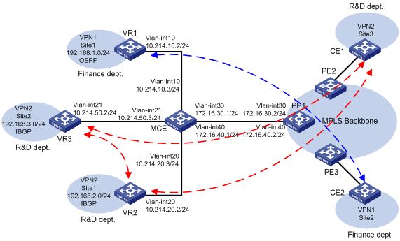

Example: Configuring the MCE to advertise VPN routes to the PE by using BGP (on switches)
As shown in Figure 3, an enterprise has two MPLS L3VPNs. VPN 1 for the finance department uses OSPF, and VPN 2 for the R&D department uses IBGP. Site 1 of VPN 1, Site 2 of VPN 2, and Site 1 of VPN 2 are connected to the MPLS backbone through the same CE device (MCE). Site 3 of VPN 2 and Site 2 of VPN 1 are connected to the MPLS backbone through separate CEs (CE 1 and CE 2).
Configure the MCE and PE 1 to use BGP to exchange VPN routes.
Figure 3 Network diagram
Analysis
IBGP requires a fully meshed network or a router reflector. In this example, you must configure the MCE as the IBGP route reflector.
3.     Advertise the VPN routes to PE 1 through EBGP, and receive remote VPN routes from PE 1.
Figure 4 Network diagram
Hardware
Hardware
S6520XE-HI switch series
Supported in Release 11xx
S5560X-EI switch series
Supported in Release 111x
S5500V2-EI switch series
MS4520V2-30F switch
S5560S-EI switch series
S5560S-SI switch series
Supported in Release 612x
S5130S-HI switch series
S5130S-EI switch series
S5130S-SI switch series
S5130S-LI switch series
Not supported
S5120V2-SI switch series
S5120V2-LI switch series
Not supported
S3100V3-EI switch series
S3100V3-SI switch series
Not supported
S5110V2 switch series
Not supported
S5110V2-SI switch series
Not supported
S5000V3-EI switch series
Not supported
S5000E-X switch series
Not supported
WAS6000 switch series
Not supported
E128C switch
E152C switch
E500C switch series
E500D switch series
Not supported
MS4520V2 switch series (except the MS4520V2-30F switch)
MS4320V2 switch series
MS4300V2 switch series
MS4320 switch series
MS4200 switch series
Not supported
WS5850-WiNet switch series
WS5820-WiNet switch series
WS5810-WiNet switch series
Not supported
Associating an interface with a VPN instance by using the ip binding vpn-instance command deletes the IP address of the interface. You must reconfigure the interface's IP address after the association.
Procedures
This example provides only the configurations on the MCE, VR 1, VR 2, VR 3, and PE 1. Configurations on other devices are not shown.
1.     Configure VPN instances on the MCE and PE 1:
# On the MCE, create a VPN instance named vpn1, and configure its RD as 10:1.
<MCE> system-view
[MCE] ip vpn-instance vpn1
[MCE-vpn-instance-vpn1] route-distinguisher 10:1
[MCE-vpn-instance-vpn1] quit
# Create a VPN instance named vpn2, and configure its RD as 20:1.
[MCE] ip vpn-instance vpn2
[MCE-vpn-instance-vpn2] route-distinguisher 20:1
[MCE-vpn-instance-vpn2] quit
# Bind VLAN-interface 10 to the VPN instance vpn1, and configure an IP address for the interface.
[MCE] interface Vlan-interface 10
[MCE-Vlan-interface10] ip binding vpn-instance vpn1
[MCE-Vlan-interface10] ip address 10.214.10.3 24
[MCE-Vlan-interface10] quit
# Bind VLAN-interface 20 to the VPN instance vpn2, and configure an IP address for the interface.
[MCE] interface Vlan-interface 20
[MCE-Vlan-interface20] ip binding vpn-instance vpn2
[MCE-Vlan-interface20] ip address 10.214.20.3 24
[MCE-Vlan-interface20] quit
# Bind VLAN-interface 21 to the VPN instance vpn2, and configure an IP address for the interface.
[MCE] interface Vlan-interface 21
[MCE-Vlan-interface21] ip binding vpn-instance vpn2
[MCE-Vlan-interface21] ip address 10.214.50.3 24
[MCE-Vlan-interface21] quit
# Bind VLAN-interface 30 to the VPN instance vpn1, and configure an IP address for the interface.
[MCE] interface Vlan-interface 30
[MCE-Vlan-interface30] ip binding vpn-instance vpn1
[MCE-Vlan-interface30] ip address 172.16.30.1 24
[MCE-Vlan-interface30] quit
# Bind VLAN-interface 40 to the VPN instance vpn2, and configure an IP address for the interface.
[MCE] interface Vlan-interface 40
[MCE-Vlan-interface40] ip binding vpn-instance vpn2
[MCE-Vlan-interface40] ip address 172.16.40.1 24
[MCE-Vlan-interface40] quit
# On PE 1, create VPN instances vpn1 and vpn2, and configure RDs for the VPN instances. Make sure the RDs are the same as those configured on the MCE.
[PE1] ip vpn-instance vpn1
[PE1-vpn-instance-vpn1] route-distinguisher 10:1
[PE1-vpn-instance-vpn1] quit
[PE1] ip vpn-instance vpn2
[PE1-vpn-instance-vpn2] route-distinguisher 20:1
[PE1-vpn-instance-vpn2] quit
# Bind VLAN-interface 30 to the VPN instance vpn1 and VLAN-interface 40 to the VPN instance vpn2, and configure IP addresses for the interfaces.
[PE1] interface vlan-interface 30
[PE1-Vlan-interface30] ip binding vpn-instance vpn1
[PE1-Vlan-interface30] ip address 172.16.30.2 24
[PE1-Vlan-interface30] quit
[PE1] interface vlan-interface 40
[PE1-Vlan-interface40] ip binding vpn-instance vpn2
[PE1-Vlan-interface40] ip address 172.16.40.2 24
[PE1-Vlan-interface40] quit
2.     Configure routing between the MCE and VPN sites:
# On VR 1, assign IP address 10.214.10.2/24 to the interface connected to the MCE. (Details not shown.)
# On VR 1, enable OSPF, and advertise networks 192.168.1.0/24 and 10.214.10.2/24.
<VR1> system-view
[VR1] ospf
[VR1-ospf-1] area 0
[VR1-ospf-1-area-0.0.0.0] network 192.168.1.0 0.0.0.255
[VR1-ospf-1-area-0.0.0.0] network 10.214.10.0 0.0.0.255
[MCE] interface LoopBack 0
[MCE-LoopBack0] ip binding vpn-instance vpn1
[MCE-LoopBack0] ip address 101.101.10.1 32
[MCE-LoopBack0] quit
# On the MCE, enable OSPF process 1, bind the process to the VPN instance vpn1, and specify the router ID as the IP address of Loopback 0.
[MCE] ospf 1 vpn-instance vpn1 router-id 101.101.10.1
# On the MCE, advertise the network 10.214.10.0/24.
[MCE-ospf-1] area 0
[MCE-ospf-1-area-0.0.0.0] network 10.214.10.0 0.0.0.255
[MCE-ospf-1-area-0.0.0.0] quit
[MCE-ospf-1] quit
# On the MCE, display the routing table for the VPN instance vpn1.
[MCE] display ip routing-table vpn-instance vpn1
Destinations : 6        Routes : 6
10.214.10.0/24     Direct  0   0            10.214.10.3     Vlan10
10.214.10.3/32     Direct  0   0            127.0.0.1       InLoop0
192.168.1.0/24     O_INTRA 10  2            10.214.10.2     Vlan10
The output shows that the MCE has learned an OSPF route to VPN 1 site 1.
# On VR 2, assign IP address 10.214.20.2/24 to the interface connected to the MCE. (Details not shown.)
# On VR 3, assign IP address 10.214.50.2/24 to the interface connected to the MCE. (Details not shown.)
# On VR 2, enable BGP in AS 100, specify 10.214.20.3 (the MCE) as the peer, and advertise networks 192.168.2.0/24 and 10.214.20.0/24.
<VR2> system-view
[VR2] bgp 100
[VR2-bgp-default] router-id 2.2.2.2
[VR2-bgp-default] peer 10.214.20.3 as-number 100
[VR2-bgp-default] address-family ipv4
[VR2-bgp-default-ipv4] peer 10.214.20.3 enable
[VR2-bgp-default-ipv4] network 192.168.2.0 24
[VR2-bgp-default-ipv4] network 10.214.20.0 24
[VR2-bgp-default-ipv4] quit
[VR2-bgp-default] quit
# On VR 3, enable BGP in AS 100, specify 10.214.50.3 (the MCE) as the peer, and advertise networks 192.168.3.0/24 and 10.214.50.0/24.
<VR3> system-view
[VR3] bgp 100
[VR3-bgp-default] router-id 3.3.3.3
[VR3-bgp-default] peer 10.214.50.3 as-number 100
[VR3-bgp-default] address-family ipv4
[VR3-bgp-default-ipv4] peer 10.214.50.3 enable
[VR3-bgp-default-ipv4] network 192.168.3.0 24
[VR3-bgp-default-ipv4] network 10.214.50.0 24
[VR3-bgp-default-ipv4] quit
[VR3-bgp-default] quit
# On the MCE, enable BGP in AS 100, create the BGP-VPN instance vpn2, specify 10.214.20.2 and 10.214.50.2 as the peers, and advertise networks 10.214.20.0/24 and 10.214.50.0/24.
[MCE] bgp 100
[MCE-bgp-default] ip vpn-instance vpn2
[MCE-bgp-default-vpn2] peer 10.214.20.2 as-number 100
[MCE-bgp-default-vpn2] peer 10.214.50.2 as-number 100
[MCE-bgp-default] address-family ipv4
[MCE-bgp-default-ipv4-vpn2] peer 10.214.20.2 enable
[MCE-bgp-default-ipv4-vpn2] peer 10.214.50.2 enable
[MCE-bgp-default-ipv4-vpn2] network 10.214.20.0 24
[MCE-bgp-default-ipv4-vpn2] network 10.214.50.0 24
# Configure the MCE as a route reflector, and specify VR 2 and VR 3 as its clients.
[MCE-bgp-default-ipv4-vpn2] peer 10.214.20.2 reflect-client
[MCE-bgp-default-ipv4-vpn2] peer 10.214.50.2 reflect-client
# On the MCE, display BGP VPNv4 routing information for the BGP instance vpn2.
[MCE-bgp-default-ipv4-vpn2] display bgp routing-table vpnv4
BGP local router ID is 4.4.4.4
 Status codes: * - valid, > - best, d - dampened, h - history
               s - suppressed, S - stale, i - internal, e – external
# On the MCE, create the BGP-VPN instance vpn1, and specify 172.16.30.2 (PE 1) as the EBGP peer in AS 200.
[MCE] bgp 100
[MCE-bgp-default] ip vpn-instance vpn1
[MCE-bgp-default-vpn1] peer 172.16.30.2 as-number 200
# Redistribute OSPF routes for BGP-VPN instance vpn1, and advertise network 172.16.30.0/24.
[MCE-bgp-default-vpn1] address-family ipv4
[MCE-bgp-default-ipv4-vpn1] import-route ospf
[MCE-bgp-default-ipv4-vpn1] peer 172.16.30.2 enable
[MCE-bgp-default-ipv4-vpn1] network 172.16.30.0 24
[MCE-bgp-default-ipv4-vpn1] quit
[MCE-bgp-default-vpn1] quit
# On PE 1, enter the view of the BGP-VPN instance vpn1, specify 172.16.30.1 (the MCE) as the EBGP peer in AS 100, and advertise network 172.16.30.0/24.
[PE1] bgp 200
[PE1-bgp-default] ip vpn-instance vpn1
[PE1-bgp-default-vpn1] peer 172.16.30.1 as-number 100
[PE1-bgp-default-vpn1] address-family ipv4
[PE1-bgp-default-ipv4-vpn1] peer 172.16.30.1 enable
[PE1-bgp-default-ipv4-vpn1] network 172.16.30.0 24
[PE1-bgp-default-ipv4-vpn1] quit
[PE1-bgp-default-vpn1] quit
# On the MCE, enter the view of the BGP-VPN instance vpn2, specify 172.16.40.2 (PE 1) as the EBGP peer in AS 200, and advertise network 172.16.40.0/24.
[MCE-bgp-default-vpn2] peer 172.16.40.2 as-number 200
[MCE-bgp-default-vpn2] address-family ipv4
[MCE-bgp-default-ipv4-vpn2] peer 172.16.40.2 enable
[MCE-bgp-default-ipv4-vpn2] network 172.16.40.0 24
[MCE-bgp-default-ipv4-vpn2] quit
[MCE-bgp-default-vpn2] quit
[MCE-bgp-default] quit
# On PE 1, enter the view of the BGP-VPN instance vpn2, specify 172.16.40.1 (the MCE) as the EBGP peer in AS 100, and advertise network 172.16.40.0/24.
[PE1-bgp-default] ip vpn-instance vpn2
[PE1-bgp-default-vpn2] peer 172.16.40.1 as-number 100
[PE1-bgp-default-vpn2] address-family ipv4
[PE1-bgp-default-ipv4-vpn2] peer 172.16.40.1 enable
[PE1-bgp-default-ipv4-vpn2] network 172.16.40.0 24
[PE1-bgp-default-ipv4-vpn2] quit
[PE1-bgp-default-vpn2] quit
[PE1-bgp-default] quit
# On PE 1, verify that the VPN instance vpn1 has learned the BGP route to VPN 1 site 1.
Destinations : 5        Routes : 5
172.16.30.2/24      Direct 0    0            127.0.0.1       InLoop0
192.168.1.0/24      BGP    255  3            172.16.30.1     Vlan30
# On PE 1, verify that the VPN instance vpn2 has learned the BGP routes to the sites of VPN 2.
Destinations : 16        Routes : 16
10.214.20.0/24     BGP     255 0           172.16.40.1     Vlan40
10.214.50.0/24     BGP     255 0           172.16.40.1     Vlan40
192.168.2.0/24     BGP     255 0           172.16.40.1     Vlan40
192.168.3.0/24     BGP     255 0           172.16.40.1     Vlan40
Configuration files
·     VR 1:
ospf 1
 area 0.0.0.0
 vlan 10
·     VR 2:
 vlan 20
bgp 100
 router-id 2.2.2.2
 address-family ipv4 unicast
  network 10.214.20.0 255.255.255.0
  network 192.168.2.0 255.255.255.0
·     VR 3:
 vlan 21
interface Vlan-interface21
 ip address 10.214.50.2 255.255.255.0
bgp 100
 router-id 3.3.3.3
  network 3.3.3.3 255.255.255.255
  network 10.214.50.0 255.255.255.0
  network 192.168.3.0 255.255.255.0
·     MCE:
vlan 10
vlan 20 to 21
vlan 30
vlan 40
interface LoopBack0
 ip address 101.101.10.1 255.255.255.255
 ip address 10.214.50.3 255.255.255.0
bgp 100
   import-route ospf 1
   network 172.16.30.0 255.255.255.0
   network 172.16.40.0 255.255.255.0
ospf 1 router-id 101.101.10.1 vpn-instance vpn1
 area 0.0.0.0
·     PE 1:
vlan 30
vlan 40
interface LoopBack0
interface LoopBack1
bgp 200
