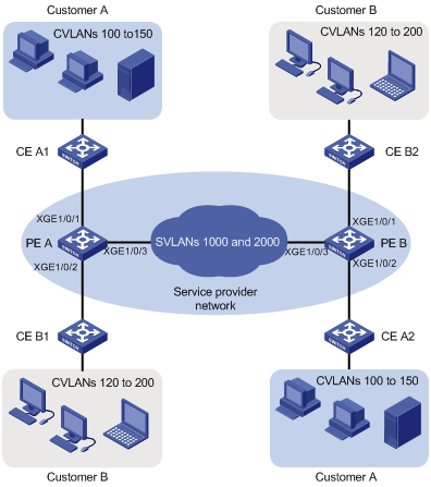

Network requirements
As shown in Figure 1:
·     The service provider assigns VLAN 1000 to Company A's VLANs 100 through 150.
·     The service provider assigns VLAN 2000 to Company B's VLANs 120 through 200.
Configure QinQ on PE A and PE B to transmit traffic in VLANs 1000 and 2000 for Company A and Company B, respectively.
Figure 1 Network diagram
