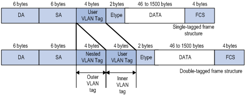

In the VLAN tag field defined in IEEE 802.1Q, only 12 bits are used for VLAN IDs, so a switch can support a maximum of 4,094 VLANs. In actual applications, however, a large number of VLANs are required to isolate users, especially in metropolitan area networks (MANs), and 4,094 VLANs are far from satisfying such requirements.
The port QinQ feature is a flexible, easy-to-implement Layer 2 VPN technique, which enables the access point to encapsulate an outer VLAN tag in Ethernet frames from customer networks (private networks), so that the Ethernet frames will travel across the service provider’s backbone network (public network) with double VLAN tags. The inner VLAN tag is the customer network VLAN tag while the outer one is the VLAN tag assigned by the service provider to the customer. In the public network, frames are forwarded based on the outer VLAN tag only, with the source MAC address learned as a MAC address table entry for the VLAN indicated by the outer tag, while the customer network VLAN tag is transmitted as part of the data in the frames.
Figure 1-1 shows the structure of 802.1Q-tagged and double-tagged Ethernet frames. The QinQ feature enables a device to support up to 4,094 x 4,094 VLANs to satisfy the requirement for the amount of VLANs in the MAN.
Figure 1-1 Single-tagged frame structure vs. double-tagged Ethernet frame structure

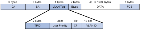

A VLAN tag uses the tag protocol identifier (TPID) field to identify the protocol type of the tag. The value of this field, as defined in IEEE 802.1Q, is 0x8100.
Figure 1-2 shows the 802.1Q-defined tag structure of an Ethernet frame.
Figure 1-2 VLAN Tag structure of an Ethernet frame
The device determines whether a received frame carries a service provider VLAN tag or a customer VLAN tag by checking the corresponding TPID value. Upon receiving a frame, the device compares the compares the configured TPID value with the value of the TPID field in the frame. If the two match, the frame carries the corresponding VLAN tag. For example, if a frame carries VLAN tags with the TPID values of 0x9100 and 0x8100 respectively while the configured TPID value of the service provider VLAN tag is 0x9100 and that of the VLAN tag for a customer network is 0x8200, the device considers that the frame carries only the service provider VLAN tag but not the customer VLAN tag.
In addition, the systems of different vendors may set the TPID of the outer VLAN tag of QinQ frames to different values. For compatibility with these systems, you can modify the TPID value so that the QinQ frames, when sent to the public network, carry the TPID value identical to the value of a particular vendor to allow interoperability with the devices of that vendor.
The TPID in an Ethernet frame has the same position with the protocol type field in a frame without a VLAN tag. To avoid problems in packet forwarding and handling in the network, you cannot set the TPID value to any of the values in the table below.

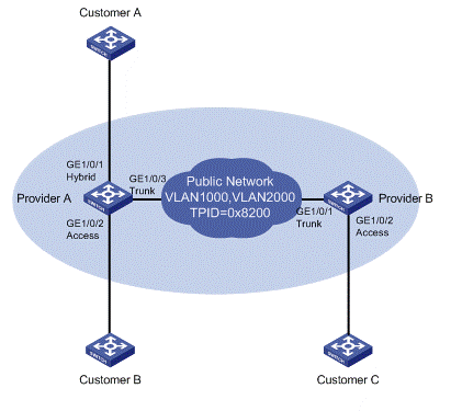

1.5  QinQ Configuration Example
I. Network requirements
l           Provider A and Provider B are service provider network access devices.
l           Customer A, Customer B and Customer C are customer network access devices.
l           Provider A and Provider B are interconnected through a configured trunk port. Provider A belongs to VLAN 1000 of the service provider network, and Provider B belongs to VLAN 2000 of the service provider network.
l           Third-party devices are deployed between Provider A and Provider B, with a TPID value of 0x8200.
After configuration, the network should satisfy the following requirement:
l           Frames of VLAN 10 of Customer A and frames of VLAN 10 of Customer B can be forwarded to each other through VLAN 1000 of the provider network; frames of VLAN 20 of Customer A and frames of VLAN 20 of Customer C can be forwarded to each other through VLAN 2000 of the provider network.
II. Network diagram
Figure 1-3 Network diagram for QinQ configuration
III. Configuration procedure
&  Note:
With this configuration, the user must allow the QinQ packets to pass between the devices of the service providers.
1)         Configuration on Provider A
# Enter system view.
<ProviderA> system-view
l           Configuration on GigabitEthernet 1/0/1
# Configure GigabitEthernet 1/0/1 as a Hybrid port that permits frames of VLAN 1000 and VLAN 2000 to pass, and configure the port to remove the outer tag of the fames when sending them out.
[ProviderA] interface GigabitEthernet 1/0/1
[ProviderA-GigabitEthernet1/0/1] port link-type hybrid
[ProviderA-GigabitEthernet1/0/1] port hybrid vlan 1000 2000 untagged
# Configure the port to tag frames from VLAN 10 with an outer tag with the VLAN ID of 1000.
[ProviderA-GigabitEthernet1/0/1] qinq vid 1000
[ProviderA-GigabitEthernet1/0/1-vid-1000] raw-vlan-id inbound 10
[ProviderA-GigabitEthernet1/0/1-vid-1000] quit
# Configure the port to tag frames from VLAN 20 with an outer tag with the VLAN ID of 2000.
[ProviderA-GigabitEthernet1/0/1] qinq vid 2000
[ProviderA-GigabitEthernet1/0/1-vid-2000] raw-vlan-id inbound 20
[ProviderA-GigabitEthernet1/0/1-vid-2000] quit
[ProviderA-GigabitEthernet1/0/1] quit
l           Configuration on GigabitEthernet 1/0/2
# Configure VLAN 1000 as the default VLAN of the port.
[ProviderA] interface GigabitEthernet 1/0/2
[ProviderA-GigabitEthernet1/0/2] port access vlan 1000
# Enable basic QinQ so that the port tags frames from VLAN 10 with an outer tag with the VLAN ID of 1000.
[ProviderA-GigabitEthernet1/0/2] qinq enable
[ProviderA-GigabitEthernet1/0/2] quit
l           Configuration on GigabitEthernet 1/0/3.
# Configure GigabitEthernet 1/0/3 as a trunk port, and permit frames of VLAN 1000 and VLAN 2000 to pass.
[ProviderA] interface GigabitEthernet 1/0/3
[ProviderA-GigabitEthernet1/0/3] port link-type trunk
[ProviderA-GigabitEthernet1/0/3] port trunk permit vlan 1000 2000
# To enable interoperability with the third-party devices in the public network, set the TPID value to be carried in VLAN Tags to 0x8200.
[ProviderA-GigabitEthernet1/0/3] quit
[ProviderA] qinq ethernet-type service-tag 8200

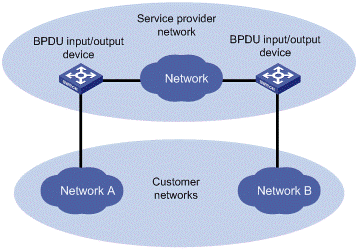

II. BPDU transparent transmission
As shown in Figure 2-1, the upper part is the service provider network, and the lower part represents the customer networks. The customer networks include network A and network B. Enabling the BPDU tunneling function on the BPDU input/output devices across the service provider network allows BPDUs of the customer networks to be transparently transmitted in the service provider network, and allows each customer network to implement independent spanning tree calculation, without affecting each other. Refer to Configuring BPDU Transparent Transmission.
Figure 2-1 Network hierarchy of BPDU tunneling
l           At the BPDU input side, the device changes the destination MAC address of a BPDU from a customer network from 0x0180-C200-0000 to a special multicast MAC address, 0x010F-E200-0003 by default. In the service provider’s network, the modified BPDUs are forwarded as data packets in the user VLAN.
l           At the packet output side, the device recognizes the BPDU with the destination MAC address of 0x010F-E200-0003 and restores its original destination MAC address 0x0180-C200-0000. Then, the device removes the outer tag, and sends the BPDU to the destination customer network.

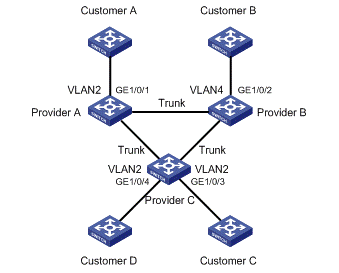

2.5  BPDU Tunneling Configuration Example
l           Customer A, Customer B, Customer C, and Customer D are customer network access devices.
l           Provider A, Provider B, and Provider C are service provider network access devices, which are interconnected through configured trunk ports.
The configuration is required to satisfy the following requirements:
l           Geographically dispersed customer network devices Customer A, Customer C and Customer D can implement consistent spanning tree calculation across the service provider network.
l           BPDU packets from Customer B are isolated so it does not take part in the spanning tree calculation.
II. Network diagram
Figure 2-2 Network diagram for BPDU tunneling configuration
# Configure BPDU transparent transmission on GigabitEthernet 1/0/1.
[ProviderA-GigabitEthernet1/0/1] port access vlan 2
[ProviderA-GigabitEthernet1/0/1] stp disable
[ProviderA-GigabitEthernet1/0/1] undo ntdp enable
[ProviderA-GigabitEthernet1/0/1] bpdu-tunnel dot1q enable
[ProviderA-GigabitEthernet1/0/1] bpdu-tunnel dot1q stp
2)         Configuration on Provider B
# Configure BPDU isolation on GigabitEthernet 1/0/2.
<ProviderB> system-view
[ProviderB] interface GigabitEthernet 1/0/2
[ProviderB-GigabitEthernet1/0/2] port access vlan 4
[ProviderB-GigabitEthernet1/0/2] undo ntdp enable
[ProviderB-GigabitEthernet1/0/2] bpdu-tunnel dot1q enable
3)         Configuration on Provider C
# Configure BPDU transparent transmission on GigabitEthernet 1/0/3.
<ProviderC> system-view
[ProviderC] interface GigabitEthernet 1/0/3
[ProviderC-GigabitEthernet1/0/3] port access vlan 2
[ProviderC-GigabitEthernet1/0/3] stp disable
[ProviderC-GigabitEthernet1/0/3] undo ntdp enable
[ProviderC-GigabitEthernet1/0/3] bpdu-tunnel dot1q enable
[ProviderC-GigabitEthernet1/0/3] bpdu-tunnel dot1q stp
# Configure BPDU transparent transmission on GigabitEthernet 1/0/4.
[ProviderC-GigabitEthernet1/0/3] quit
[ProviderC] interface GigabitEthernet 1/0/4
[ProviderC-GigabitEthernet1/0/4] port access vlan 2
[ProviderC-GigabitEthernet1/0/4] stp disable
[ProviderC-GigabitEthernet1/0/4] undo ntdp enable
[ProviderC-GigabitEthernet1/0/4] bpdu-tunnel dot1q enable
[ProviderC-GigabitEthernet1/0/4] bpdu-tunnel dot1q stp
&  Note:
When STP works stably on the customer network, if Customer A acts as the root bridge, the ports of Customer C and Customer D connected with Provider C can receive BPDUs from Customer A. Since BPDU isolation is enabled on Customer B, the port that connects Customer B to Provider B cannot receive BPDUs from Customer A.
