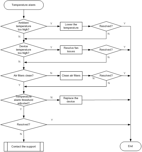

Temperature alarms· 20
Symptom·· 20
Troubleshooting flowchart 20
Solution· 20

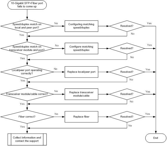

10-Gigabit SFP+ fiber port fails to come up· 21
Symptom·· 21
Troubleshooting flowchart 22
Solution· 22

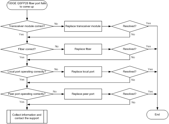

100-GE QSFP28 fiber port fails to come up· 23
Symptom·· 23
Troubleshooting flowchart 24
Solution· 24

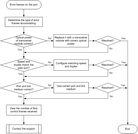

Error frames (for example, CRC errors) on a port 27
Symptom·· 27
Troubleshooting flowchart 28
Solution· 28

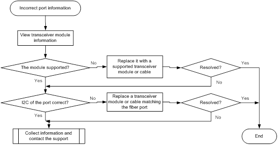

Incorrect port information· 32
Symptom·· 32
Troubleshooting flowchart 33
Solution· 33

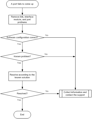

A port fails to come up· 34
Symptom·· 34
Troubleshooting flowchart 34
Solution· 34

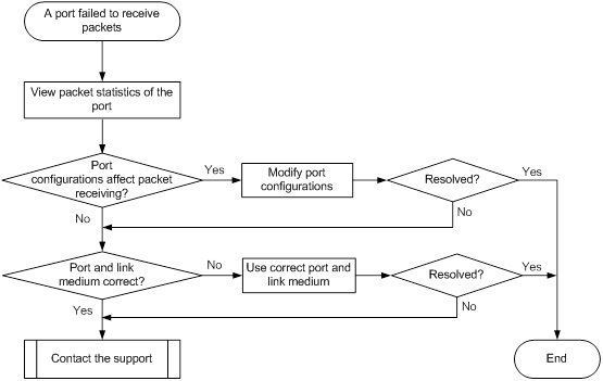

Ports
Is half duplex used in port negotiation?
display interface brief
OK
Not OK
Not related
If the duplex mode of a port is half, verify that the peer port uses the same duplex mode.
Is flow control unnecessarily enabled on ports?
Verify the port settings.
OK
Not OK
Not related
Disable flow control on the ports.

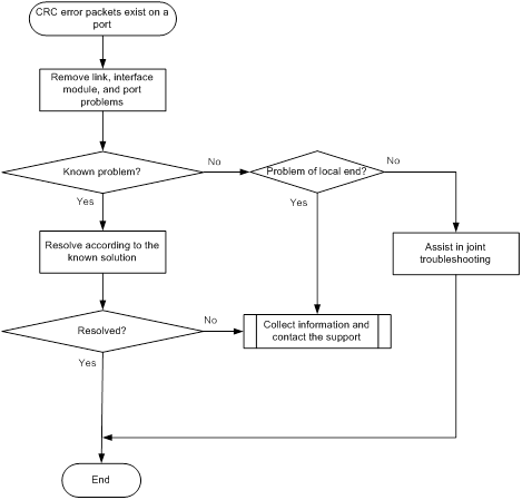

Are large numbers of error packets generated continuously in the outbound or inbound direction of the port?
display interface
OK
Not OK
Not related
If an error counter displays a non-zero value and the value is increasing, check for the following errors:
·     Link and optical-electrical converter errors.
·     Port setting inconsistencies with the peer port.
Does the port change between an up and down state frequently?
display logbuffer
OK
Not OK
Not related
If the port state flaps, check for the following errors:
·     Optical power threshold crossing events if the port is a fiber port.
Fiber ports
Do the ports at the two ends use the same port settings?
display current-configuration interface
OK
Not OK
Not related
When you connect an H3C device to a device from another vendor, set the same port rate and duplex mode settings at the two ends as a best practice.
Are CRC errors present on any fiber port? Is the number of CRC errors increasing?
display interface
OK
Not OK
Not related
If CRC errors persist, replace the transceiver module or pigtail fiber, or clean the transceiver module connector.

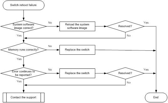

Switch reboot failure
Symptom
The switch fails to reboot.
Figure 1 Troubleshooting switch reboot failure
Solution
To resolve the issue:
1.     Verify that the system software image on the switch is correct.
a.     Log in to the switch through the console port and restart the switch. If the system reports that a CRC error occurs or that no system software image is available during the BootWare loading process, reload the system software image.
b.     Verify that the system software image in the flash memory is the same size as the one on the server. If no system software image is available in the flash memory, or if the image size is different from the one on the server, reload the system software image. Then set the reloaded system software image to the current system software image.
The system software image in the flash memory is automatically set to the current system software image during the BootWare loading process.
2.     Verify that the memory is running correctly.
Reboot the switch, and immediately press CTRL+T to examine the memory. If a memory fault is detected, replace the switch.
3.     Verify that no error is reported during the BootWare loading process.
If the memory is running correctly but there are still errors reported during the BootWare loading process, replace the switch.
4.     If the issue persists, contact H3C Support.

Temperature alarms
Symptom
Temperature alarms occur.
Figure 4 Troubleshooting temperature alarms
Solution
1.     Check the ambient temperature. If the ambient temperature is higher than 22 °C (71.6°F), lower the temperature by adding air conditioners or taking other heat dissipation measures.
2.     Check the device temperature. If the device temperature is higher than the high-temperature warning threshold, use the display fan command to verify that the fans a operating correctly. If the status of a fan is Fault, replace the fan.
3.     Check whether the air filters are clean. If they are not, clean them.
4.     If the issue persists, use the temperature-limit command to adjust the temperature alarm thresholds.
5.     Use the display environment command to identify whether the temperature alarm thresholds are adjusted successfully. If the thresholds are not adjusted, temperature related components of the device might have failed. Replace the device.
6.     If the thresholds are adjusted but the issue persists, collect diagnostic information and contact H3C Support.
Symptom
A 10-Gigabit SFP+ fiber port fails to come up.
Figure 5 Troubleshooting link up failure on a port
Solution
1.     Verify that the speed and duplex mode of the local port match the speed and duplex mode of the peer port:
a.     Execute the display interface brief command to examine whether the speed and duplex mode of the port match the speed and duplex mode of the peer port.
b.     If they do not match, use the speed command and the duplex command to set the speed and duplex mode for the port.
2.     Verify that the speed and duplex mode of the port match the speed and duplex mode of the transceiver module:
a.     Execute the display interface brief command to examine whether the speed and duplex mode of the port match the speed and duplex mode of the transceiver module.
3.     Verify that the local and peer ports are operating correctly:
Use a 10-Gigabit SFP+ cable to connect the local port directly to another 10-Gigabit SFP+ fiber port on the same device.
¡     If the local port can come up, replace the peer port with a new one.
¡     If the local port cannot come up, replace the local port with a new one.
4.     Verify that the transceiver module and cable are operating correctly:
a.     Execute the display transceiver alarm interface command to check for alarms on the transceiver module.
-     The device displays None if no error has occurred.
Symptom
A 100-GE QSFP28 fiber port fails to come up.
Figure 6 Troubleshooting link up failure on a port
Solution
1.     Verify that the transceiver module is operating correctly:
-     The device displays alarms if the transceiver module has failed or if the type of the transceiver module does not match the port type.
b.     Use an optical power meter to verify that the Tx power and Rx power of the transceiver module are stable and are within the correct range.
c.     Execute the display transceiver interface command to verify that the local transceiver module has the same wavelength and transmission distance as the peer transceiver module.
d.     If the transceiver module is not operating correctly, replace it with a new H3C transceiver module that matches the fiber port.
For more information about transceiver modules, see the installation guide for the switch.
2.     Verify that the fiber matches the transceiver module. If they do not match, replace the fiber with a new one that matches the transceiver module.
3.     Verify that the local port is operating correctly:
Replace the local port with a new one to identify whether this issue has been resolved.
4.     Verify that the peer port is operating correctly:
Replace the peer port with a new one to identify whether this issue has been resolved.
5.     If the issue persists, collect diagnostic information and contact H3C Support.
To collect diagnostic information, execute the display diagnostic-information command to display or save running status data for multiple feature modules.
<Sysname> display diagnostic-information
Save or display diagnostic information (Y=save, N=display)? [Y/N]:Y

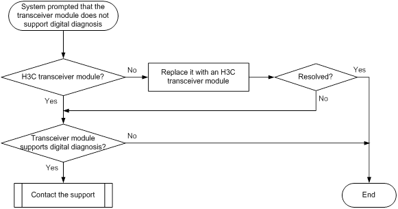

Transceiver module does not support digital diagnosis
Symptom
The output from the display transceiver diagnosis interface command shows that the transceiver module does not support the digital diagnosis function.
<Sysname> display transceiver diagnosis interface HundredGigE1/0/25
Error: The transceiver does not support this function.
Figure 8 Troubleshooting digital diagnosis failure on a transceiver module
Solution
1.     Verify that the transceiver module is an H3C transceiver module:
Execute the display transceiver interface command to view the vendor name of the transceiver module.
¡     If the vendor name field does not display H3C, replace the transceiver module with an H3C transceiver module.
¡     If the vendor name field displays H3C, perform the following tasks:
-     Execute the display transceiver register interface command in probe view to save the transceiver module information.
-     Provide the information to H3C Support to verify that the transceiver module is an H3C transceiver module. If it is not, replace it with an H3C transceiver module.
2.     Execute the display transceiver interface command to save the transceiver module information, and contact H3C Support to verify that the transceiver module supports the digital diagnosis function.
3.     If the issue persists, collect diagnostic information and contact H3C Support.
Symptom
In the output from the display interface command, error frames exist (for example, CRC error frames).
Figure 9 Troubleshooting error frames (for example, CRC errors) on a port
Solution
1.     Examine the error frame statistics and identify the error frame type:
a.     (Optional.) Use the reset counter interface command in user view to clear the packet statistics of the port.
This command resets all packet counters to 0, so that you can view the statistics changes more clearly.
b.     Use the display interface command to display the incoming packet statistics and outgoing packet statistics of the port.
c.     Determine the type of error frames that are accumulating.
2.     If the port is a fiber port, verify that the optical power of the transceiver module is operating correctly:
a.     Use the display transceiver diagnosis interface command to view the present measured values of the digital diagnosis parameters for the transceiver module.
HundredGigE1/0/25 transceiver diagnostic information:
  Current diagnostic parameters:
[module]  Temp.(°C) Voltage(V)
          23         3.33
[channel] Bias(mA)  RX power(dBm)  TX power(dBm)
    1     33.82     0.99           0.36
    2     34.59     1.15           0.35
    3     35.56     0.85           0.10
    4     33.78     -0.39          0.20
  Alarm thresholds:
          Temp.(°C) Voltage(V)  Bias(mA)  RX power(dBm)  TX power(dBm)
    High  78         3.63        105.00    3.30           5.30
Low   -5         2.97        8.00      -17.70         -11.00
b.     If the optical power of the transceiver module is not within the correct range, replace the transceiver module with a transceiver module of the same model that is operating correctly.
3.     Verify that the port configurations are correct:
a.     Execute the display interface brief command.
b.     Determine whether the speed and duplex mode of the port match the speed and duplex mode of the peer port.
c.     If they do not match, use the speed command and the duplex command to set the speed and duplex mode for the port.
4.     Verify that the link medium connected to the port is operating correctly.
Plug the link medium into a new port that is operating correctly. If error frames still exist, replace the link medium.
5.     Determine whether the port has received a large amount of flow control frames:
a.     Use the display interface command to view the number of pause frames.
If the number of pause frames is accumulating, you can determine that the port has sent or received a large amount of flow control frames.
b.     Verify that the incoming traffic and outgoing traffic have not exceeded the maximum traffic processing capability of the local device and the peer device.
6.     If the issue persists, collect diagnostic information and contact H3C Support.
Failure to receive packets
Symptom
A port is up, but it cannot receive packets.
Figure 10 Troubleshooting failure to receive packets
Solution
1.     Verify that the ports at both ends are up.
2.     Examine the packet statistics of the port:
b.     Use the display interface command to verify that the number of incoming packets is accumulating.
c.     Verify that the number of error frames is not accumulating.
3.     Verify that the port configurations do not affect packet receiving:
a.     Use the display interface brief command to verify that the port configurations are correct.
The port configurations include the duplex mode, speed, port type, and VLAN configurations of the ports at both ends of the link. If configuration errors exist, modify the port configurations. If the port still fails to receive packets, use the shutdown command and then the undo shutdown command to re-enable the port.
b.     If the port is configured with the spanning tree feature, use the display stp brief command to verify that the port is not in the discarding state.
If the port is set to the discarding state by the spanning tree feature, examine and modify the spanning tree feature configurations to resolve the issue.
As a best practice, configure the port as an edge port or disable the spanning tree feature on the port if it is directly connected to a terminal.
c.     If the port is in an aggregation group, use the display link-aggregation summary command to verify that the status of the port is Selected.
If the status of the port is Unselected, the port cannot send or receive data packets. Determine the reasons why the port becomes Unselected, for example, the attribute configurations of the port are different from the reference port. Modify the attribute configurations of the port to make the port become Selected.
Plug the link medium into a new port that is operating correctly. If the new port cannot receive packets, replace the link medium.

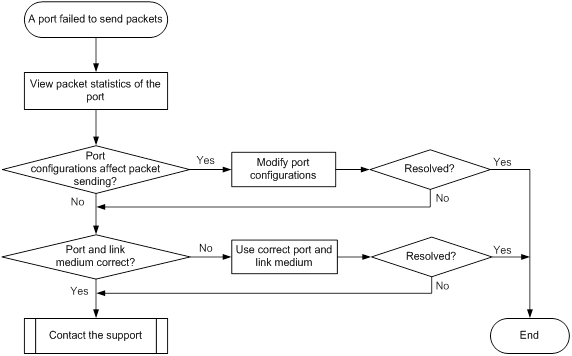

Failure to send packets
Symptom
A port is up, but it cannot send packets.
Figure 11 Troubleshooting failure to send packets
Solution
b.     Use the display interface command to verify that the number of outgoing packets is accumulating.
3.     Verify that the port configurations do not affect packet sending:
The port configurations include the duplex mode, speed, port type, and VLAN configurations of the ports at both ends of the link. If configuration errors exist, modify the port configurations. If the port fails to send packets, use the shutdown command and then the undo shutdown command to re-enable the port.
Plug the link medium into a new port that is operating correctly. If the new port cannot send packets, replace the link medium.
Symptom
The port transceiver module type cannot be correctly identified, and the diagnosis information is incorrect. The port transceiver module is displayed as absent, or sometimes present and sometimes absent.
Figure 12 Troubleshooting incorrect port information
Solution
1.     Execute the display transceiver interface command to view basic information of the transceiver modules and identify the incorrect information of the transceiver module.
2.     See the installation guide for the device to identify whether the transceiver module is supported. If the transceiver module is not supported, replace it with an H3C transceiver module supported by the device.
3.     Identify whether the I2C of the port is normal.
a.     Identify whether the transceiver module type or diagnosis information of another port of the same PHY (typically, a neighboring port) is incorrect. If the transceiver module type or diagnosis information of another port is also incorrect, the I2C might be abnormal. Contact H3C Support.
b.     If another port does not have this problem, replace the transceiver module. If the problem is resolved after replacement, contact H3C Support.
4.     Execute commands in the following table to collect information and contact H3C Support.
Description
Displays the current values of the digital diagnosis parameters on transceiver modules.
Displays the key parameters of transceiver modules.
display transceiver manuinfo interface
Displays electronic label information for transceiver modules.
display transceiver information interface
Displays transmission information for transceiver modules.
Symptom
A port fails to come up.
Figure 13 Troubleshooting the failure of a port to come up
Solution
1.     Perform a basic replacement test to remove link, interface module, and peer port problems. For more information, see "10-Gigabit SFP+ fiber port fails to come up. "
2.     Identify whether the software configuration is correct.
a.     Read the Tx and Rx optical powers of the port multiple times. If a problem exists, troubleshoot the link.
b.     Execute the following command multiple times. If a problem occurs, contact H3C Support.
====debug port optical-module chassis 1 slot 0====

CRC error packets on a port
Symptom
A large number of CRC error packets exist on the local or remote port.
Figure 15 Troubleshooting CRC error packets on a port
Solution
1.     Perform a basic replacement test to remove link, interface module, and port problems.
a.     Remove link problems. For more information, see "10-Gigabit SFP+ fiber port fails to come up.
b.     Execute the display transceiver diagnosis interface command multiple times to view the Tx and Rx optical powers of the port. If CRC error packets on the port are caused by the Tx/Rx power instability, troubleshoot the link.
2.     Identify whether the problem is known.
a.     See the known problem list in the S6890 switch series usage guidelines to identify whether CRC error packets are caused by known problems. If CRC error packets are caused by known problems, upgrade the software or install patches according to the problem description and identify whether the problem of CRC error packets has been resolved.
b.     Troubleshoot the problems of port failure to come up, port flapping, and CRC error packets on a port together. The three symptoms are sometimes related, and it is hard to locate the root cause. When one of the problems occurs, as a best practice, troubleshoot the three problems together.
3.     Execute commands in the following table to collect information and contact H3C Support.
Description
bcm slot 6 chip 0 phy/control/xl1/dump
Collects the port register information. (This operation will not cause flapping of interfaces on the same chip. To see the xl1 port name. execute the debug port mapping slot command.)

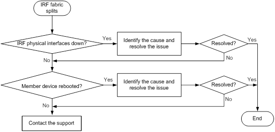

IRF split
Symptom
An IRF fabric splits.
Figure 17 Troubleshooting IRF split
Solution
1.     Verify that the IRF physical interfaces are operating correctly:
a.     Execute the display logbuffer command or view system logs to check for physical IRF link down events that occurred around the split time.
b.     If the split followed an IRF link down event, execute the display interface command to check port statistics for CRC errors.
c.     If transceiver modules and fibers are used, execute the display transceiver diagnosis command. Make sure the transmit and receive power has not exceeded the power specifications of the fiber module.
2.     Remove hardware issues that might cause recurring IRF split events:
a.     Execute the display version command to identify the uptime of IRF member devices.
b.     Compare the uptime of IRF member devices to determine whether a member device had rebooted before the IRF split.
c.     If the IRF split is caused by a device reboot, perform one of the following tasks:
-     If the split is caused by a device reboot, use the methods described in "Switch reboot failure" to resolve the issue.
-     If the reboot is caused by power failures, use the methods described in "Operating power module failure" to resolve the issue.
3.     If the issue persists, execute the display diagnostic-information command and collect the device diagnostic information, and then send the information to H3C Support.

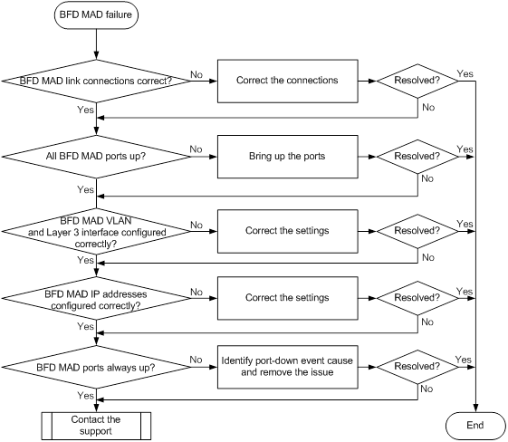

BFD MAD failure
Symptom
BFD MAD fails to detect an IRF split event. Two IRF fabrics are operating with the same Layer 3 configurations, including the same IP address.
Figure 18 Troubleshooting BFD MAD failure
Solution
1.     Verify that BFD MAD link connections are correct:
¡     If you do not use an intermediate device, verify that each pair of member devices has a dedicated BFD MAD link.
¡     If you use an intermediate device, verify that each member device has a dedicated BFD MAD link with the intermediate device.
As a best practice to conserve management Ethernet port resources, use an intermediate device if you use management Ethernet ports for BFD MAD.
2.     Verify that all physical ports used for BFD MAD are up:
a.     Execute the display interface command.
b.     Check the Current state field in the command output:
-     If the field displays Administratively DOWN for a port, execute the undo shutdown command to bring up the port.
-     If the field displays DOWN for a port, check the physical link for a link failure.
3.     Verify that the Layer 3 interface used for BFD MAD and the BFD MAD VLAN (if any) are configured correctly:
a.     Execute the display mad verbose command.
b.     Check the MAD BFD enabled interface field to identify the Layer 3 interface used for BFD MAD. This interface can be a VLAN interface, Layer 3 aggregate interface, or management Ethernet port.
The interface used for MAD BFD can be a VLAN interface, Layer 3 aggregate interface, or management Ethernet port, depending on the software version. For more information, see IRF configuration in the configuration guides for the software version of your device.
c.     Verify that the Layer 3 interface used for BFD MAD is configured as required depending on the interface type. Table 3, Table 4, and Table 5 list the restrictions and guidelines on configuring a VLAN interface, Layer 3 aggregate interface, and management Ethernet port, respectively.
Table 3 BFD MAD configuration restrictions and guidelines (VLAN interface)
Category
BFD MAD VLAN
·     Do not enable BFD MAD on VLAN-interface 1.
·     If you are using an intermediate device, perform the following tasks:
¡     On both the IRF fabric and intermediate device, create a VLAN for BFD MAD.
¡     On both the IRF fabric and intermediate device, assign the ports of BFD MAD links to the BFD MAD VLAN.
¡     On the IRF fabric, create a VLAN interface for the BFD MAD VLAN.
·     Make sure the IRF fabrics on the network use different BFD MAD VLANs.
·     Make sure the BFD MAD VLAN contains only ports on the BFD MAD links. Exclude a port from the BFD MAD VLAN if that port is not on a BFD MAD link. If you have assigned that port to all VLANs by using the port trunk permit vlan all command, use the undo port trunk permit command to exclude that port from the BFD MAD VLAN.
BFD MAD VLAN and feature compatibility
Do not use the BFD MAD VLAN and its member ports for any purpose other than configuring BFD MAD.
·     Use only the mad bfd enable and mad ip address commands on the BFD MAD-enabled VLAN interface. If you configure other features, both BFD MAD and other features on the interface might run incorrectly.
·     Disable the spanning tree feature on any Layer 2 Ethernet ports in the BFD MAD VLAN. The MAD feature is mutually exclusive with the spanning tree feature.
Table 4 BFD MAD configuration restrictions and guidelines (Layer 3 aggregate interface)
Category
BFD MAD-enabled Layer 3 aggregate interface
·     Make sure the Layer 3 aggregate interface operates in static aggregation mode.
·     Make sure the member ports in the aggregation group do not exceed the maximum number of Selected ports allowed for an aggregation group. If the number of member ports exceeds the maximum number of Selected ports, some member ports cannot become Selected. BFD MAD will be unable to work correctly and its state will change to Faulty.
BFD MAD VLAN
·     On the intermediate device (if any), assign the ports on the BFD MAD links to the same VLAN. Do not assign the ports to an aggregate interface. If the ports are hybrid ports, make sure these ports are untagged members of their PVIDs.
·     If the intermediate device acts as a BFD MAD intermediate device for multiple IRF fabrics, assign different BFD MAD VLANs to the IRF fabrics.
·     Do not use the BFD MAD VLAN on the intermediate device for any purposes other than BFD MAD.
·     Make sure the BFD MAD VLAN on the intermediate device contains only ports on the BFD MAD links. Exclude a port from the BFD MAD VLAN if that port is not on a BFD MAD link. If you have assigned that port to all VLANs by using the port trunk permit vlan all command, use the undo port trunk permit command to exclude that port from the BFD MAD VLAN.
BFD MAD-enabled Layer 3 aggregate interface and feature compatibility
Use only the mad bfd enable and mad ip address commands on the BFD MAD-enabled interface. If you configure other features, both BFD MAD and other features on the interface might run incorrectly.
Table 5 BFD MAD configuration restrictions and guidelines (management Ethernet port)
Category
Management Ethernet ports for BFD MAD
Connect a management Ethernet port on each IRF member device to the common Ethernet ports on the intermediate device.
BFD MAD VLAN
·     On the intermediate device, create a VLAN for BFD MAD, and assign the ports used for BFD MAD to the VLAN. On the IRF fabric, you do not need to assign the management Ethernet ports to the VLAN.
4.     Verify that MAD IP addresses are configured correctly:
b.     Check the MAD IP address field to verify that all the MAD IP addresses are on the same subnet. In addition, verify that the MAD IP addresses are unique among all IP addresses on the IRF fabric.
c.     Execute the display interface command to verify that the Layer 3 interface used for BFD MAD has only MAD IP addresses configured by using the mad ip address command. For example, make sure the interface does not have a VRRP virtual address or an IP address configured by using the ip address command.
5.     Verify that the physical ports in the BFD MAD VLAN are always up:
a.     Execute the display logbuffer command or use system logs to check for BFD MAD port-down events that occurred around the split time.
b.     Identify the cause of the events, and remove the issue.
6.     If the issue persists, execute the display diagnostic-information command and collect the device diagnostic information, and then send the information to H3C Support.

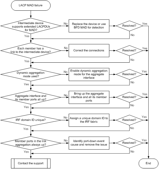

LACP MAD failure
Symptom
LACP MAD fails to detect an IRF split event. Two IRF fabrics are operating with the same Layer 3 configurations, including the same IP address.
Figure 19 Troubleshooting LACP MAD failure
Solution
1.     Verify that the intermediate device is a device that supports extended LACPDUs for MAD.
If the intermediate device does not support extended LACPDUs for MAD, replace the intermediate device, or use BFD MAD for split detection.
2.     Verify that each member device has a link in the link aggregation with the intermediate device.
3.     Verify that the link aggregation is operating in dynamic mode.
To enable dynamic aggregation mode, use the link-aggregation mode dynamic command.
4.     Verify that the aggregate interface and its member ports are up:
b.     Check the Current state field of the aggregate interface:
-     If the field displays Administratively DOWN, execute the undo shutdown command to bring up the interface.
-     If the field displays DOWN, check the state of all its physical ports.
An aggregate interface goes down only if all its physical ports are down.
c.     Check the Current state field of each member port:
-     If the field displays Administratively DOWN, execute the undo shutdown command to bring up the port.
-     If the field displays DOWN, check the physical link of the port for a link failure.
5.     If the intermediate device is also an IRF fabric, verify that the IRF domain IDs of the two IRF fabrics are unique:
CAUTION
CAUTION:
The IRF member devices send extended LACPDUs with TLVs that convey the domain ID and the active ID (the member ID of the master) of the IRF fabric. To avoid split detection failure, make sure the IRF fabric has a unique domain ID.
a.     Execute the display irf command to identify the domain ID of each IRF fabric.
b.     If the IRF fabrics use the same domain ID, execute the irf domain command to change the domain ID on one IRF fabric.
6.     Verify that the physical ports in the link aggregation are always up:
a.     Execute the display logbuffer command or use system logs to check for port-down events around the split time.
b.     Identify the event cause and remove the issue.
7.     If the issue persists, execute the display diagnostic-information command and collect the device diagnostic information, and then send the information to H3C Support.

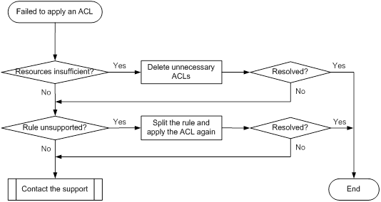

Troubleshooting QoS and ACL
This section provides troubleshooting information for common QoS and ACL issues.
ACL application failure for unsupported ACL rules or insufficient resources
Symptom
The system fails to apply a packet filter or an ACL-based QoS policy to the hardware. It displays an error message that an unsupported rule exists in the ACL or hardware resources are insufficient. The following are sample error messages:
·     For unsupported rules:
Error: Slot=2 Fail to apply or refresh packet filter policy 3180 rule 5 on interface Vlan-interface20. Not supported.
·     For insufficient hardware resources:
Error: Slot=2 Fail to apply or refresh packet filter policy 3001 rule 25 on interface Vlan-interface6 due to lack of resources.
Warning: Classifier-behavior test in policy test applied on vlan 4079 failed in slot 2. Reason: Not enough hardware resource.
Either of the preceding two messages indicates insufficient hardware resources.
Figure 20 Troubleshooting ACL application failure
Solution
To resolve the issue in the case of unsupported rules:
1.     Identify the unsupported match criterion in the rule:
a.     Split the rule into multiple rules such that each rule contains one match criterion.
b.     Apply the packet filter or QoS policy again.
c.     Identify the unsupported criterion according to the new error message.
If the rule contains only one criterion, the criterion is not supported.
2.     If the issue persists, contact H3C Support.
To resolve the issue in the case of insufficient hardware resources:
1.     Check the ACL, Counter, and Meter resource usage for insufficiency.
Execute the display qos-acl resource command to display the resource usage. If the number of ACLs to be applied is higher than the value of the Remaining field, resources are insufficient. If the ACLs are to be applied globally, check the resource usage on all cards.
[Sysname] display qos-acl resource
Interfaces: XGE1/0/1 to XGE1/0/24, HGE1/0/25 to HGE1/0/30
              XGE1/0/31 to XGE1/0/54, MGE0/0/0 to MGE0/0/1 (slot 1)
 Type             Total      Reserved   Configured Remaining  Usage
 VFP ACL          41984      0          0          41984      0%
 IFP ACL          50176      8192       0          41984      16%
 IFP Meter        30720      129        0          30591      0%
 IFP Counter      8175       140        0          8035       1%
 EFP ACL          20992      0          0          20992      0%
 EFP Counter      4094       0          0          4094       0%
¡     IFP—Resource usage for inbound traffic.
¡     EFP—Resource usage for outbound traffic.
2.     Delete unnecessary ACLs to release resources if the failure is caused by ACL resource insufficiency. Delete unnecessary ACLs that use Meter or Counter resources if the failure is caused by Meter or Counter resource insufficiency. If the ACL resources are sufficient, go to step 4.
3.     Apply the packet filter or QoS policy again.
4.     If the issue persists, collect diagnostic information by using the following command and contact H3C Support.

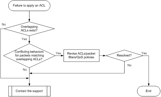

ACL application failure without an error message
Symptom
The system applies a packet filter or an ACL-based QoS policy to the hardware. However, the ACL does not take effect.
Figure 21 Troubleshooting ACL application failure
Solution
1.     Check the ACLs used by QoS policies and packet filters for overlapping rules:
a.     Use the following commands to display ACLs that are used by QoS policies and packet filters:
-     display packet-filter
-     display qos policy user-defined
-     display traffic classifier user-defined
b.     Execute the display acl command to check for overlapping rules in the ACLs.
For example, the following sample output shows that rule 0 in ACL 3100 and rule 0 in ACL 3009 can both match traffic sourced from 2.2.2.1.
ACL number 3100
rule 0 permit ip source 2.2.2.2 255.255.0.0
ACL number 3009
2.     Check the filters and policies that use overlapping ACLs for a behavior conflict.
If two behaviors conflict, the device performs the behavior that has higher priority, as shown in Table 6.
Table 6 Rules for selecting a higher priority behavior from conflicting behaviors
Conflicting behaviors
Higher priority behavior
·     redirect
·     filter permit
redirect
·     redirect
·     filter deny
filter deny
·     filter permit
·     filter deny
The behavior configured first.
3.     Revise ACLs, packet filters, or QoS policies to remove the behavior conflict.
