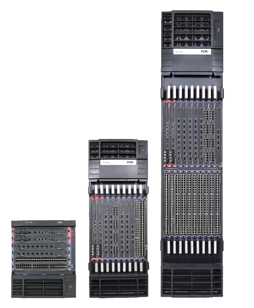

Q. What models does the H3C S12500 routing switch series include?. 1

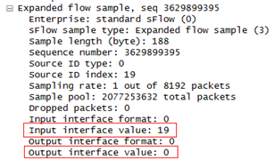

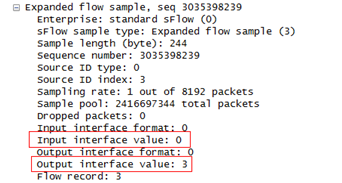

Q. Why does the Input interface value or Output interface value field in an sFlow packet have a value of 0?. 12
A.  The H3C S12500 Routing Switch Series includes H3C S12504, H3C S12508, and H3C S12518.
·     An H3C S12504 switch has slot 0 and slot 1 for main processing units (MPUs), and has slots 2 through 5 for line processing units (LPUs).
·     An H3C S12508 switch has slot 0 and slot 1 for MPUs, and has slots 2 through 9 for LPUs.
·     An H3C S12518 switch has slot 0 and slot 1 for MPUs, and has slots 2 through 19 for LPUs.
H3C S12504, H3C S12508, and H3C S12518 switches are illustrated from left to right in Figure 1.
A.  A sample packet in the inbound direction does not carry the outbound packet count. A sample packet in the outbound direction does not carry the inbound packet count.
Figure 2 Sample in the inbound direction
Figure 3 Sample in the outbound direction
