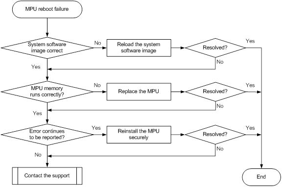

MPU reboot failure· 17
Symptom·· 17
Troubleshooting flowchart 17
Solution· 17

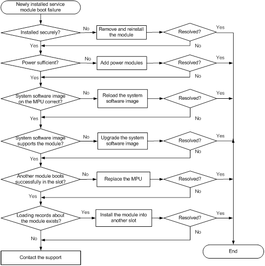

Service module reboot failure· 19
Symptom·· 19
Troubleshooting flowchart 20
Solution· 20
Service module boot failure· 21
Symptom·· 21
Troubleshooting flowchart 22
Solution· 22

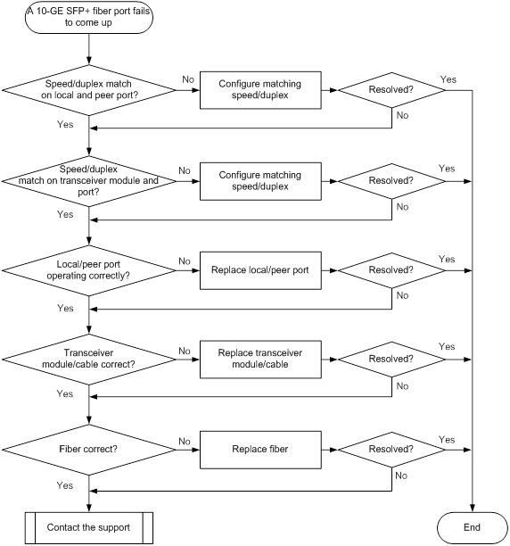

10-Gigabit SFP+ fiber port fails to come up· 40
Symptom·· 40
Troubleshooting flowchart 41
Solution· 41

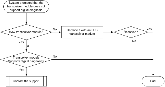

Failure to support digital diagnosis on a transceiver module· 48
Symptom·· 48
Troubleshooting flowchart 48
Solution· 49

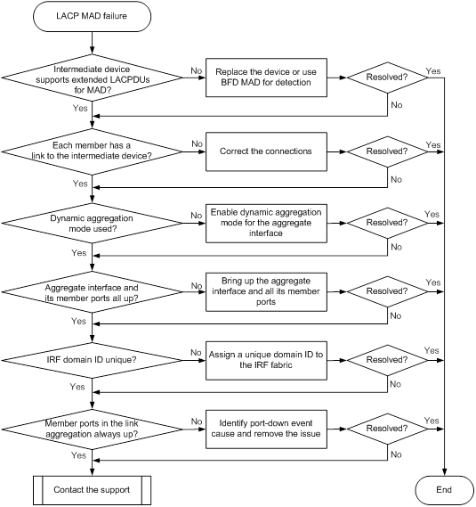

LACP MAD failure· 63
Symptom·· 63
Troubleshooting flowchart 63
Solution· 63

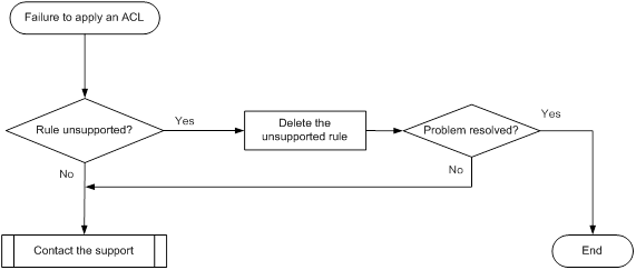

ACL application failure for unsupported ACL rules· 65
Symptom·· 65
Troubleshooting flowchart 65
Solution· 65

MPU reboot failure
Symptom
An MPU fails to reboot. The RUN and ALM LEDs for the MPU are on.
Figure 1 Troubleshooting MPU reboot failure
Solution
To resolve the problem:
1.     Verify that the system software image on the MPU is correct.
a.     Log in to the MPU through the console port and restart the switch. If the system reports that a CRC error occurs or that no system software image is available during the BootWare loading process, reload the system software image.
b.     Verify that the system software image in the flash memory is the same size as the one on the server. If no system software image is available in the flash memory, or if the image size is different from the one on the server, reload the system software image. Then set the reloaded system software image to the current system software image.
The system software image in the flash memory is automatically set to the current system software image during the BootWare loading process.
2.     Verify that the MPU memory is running correctly.
Reboot the MPU, and immediately press CTRL+T to examine the memory. If a memory fault is detected, replace the MPU.
RAM test successful.
Press Ctrl+T to start five-step full RAM test...
Press Ctrl+Y to start nine-step full RAM test...
Running five-step RAM test...
This operation may take several minutes. Please wait...
RAM dataline testing...                    [ PASS ]
RAM unit testing...                        [ PASS ]
Five-step RAM test succeeded.
3.     Verify that no error is reported during the BootWare loading process.
If there are still errors reported during the BootWare loading process, identify the faulty module and verify that the MPU is installed securely.
?     If the MPU is not installed securely, remove and reinstall the MPU.
?     If the MPU is installed securely, replace the MPU.
4.     If the problem persists, contact H3C Support.

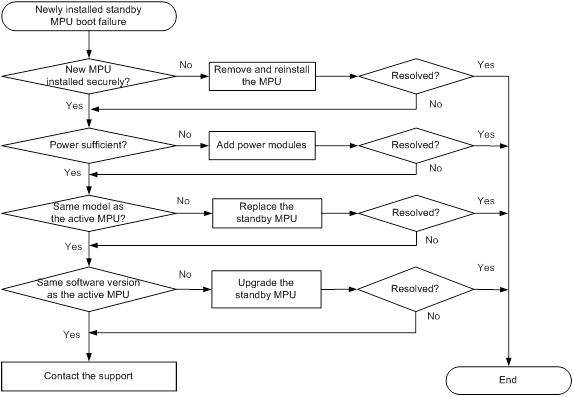

MPU boot failure
Symptom
An MPU designated as the standby MPU fails to boot after installation. The RUN and ALM LEDs for the MPU are on.
Figure 2 Troubleshooting newly installed standby MPU boot failure
Solution
1.     Remove and reinstall the MPU to make sure the MPU is installed securely.
2.     Execute the display power-info command to verify that the surplus power is sufficient.
If the power is insufficient, add power modules to the switch and examine whether the MPU is operating correctly.
[Sysname-probe] display power-info
  Device Power: 2500
  Fan Power: 195
  Surplus power: 2089
  Slot No.     Power
   3           60
   6           78      --reserve  for  mainboard
   7           78
Board Exist Reg50: 0xbf  Reg51: 0xf7  Reg52: 0x52
Power  up   Reg5A: 0x 0  Reg5B: 0xc8  Reg5C: 0x5c  Reg15B: 0xc8  Reg15C: 0xff
  Power Event Information:
POE Power Chassis 0: Fail
3.     Verify that the MPU is the same model as the active MPU. If they are not the same model, replace the MPU with one that is the same model as the active MPU.
4.     Verify that the MPU runs the same software version as the active MPU. If the two MPUs run different software versions, upgrade the software version of the standby MPU to make sure the two MPUs run the same software version.
5.     If the problem persists, contact H3C Support.

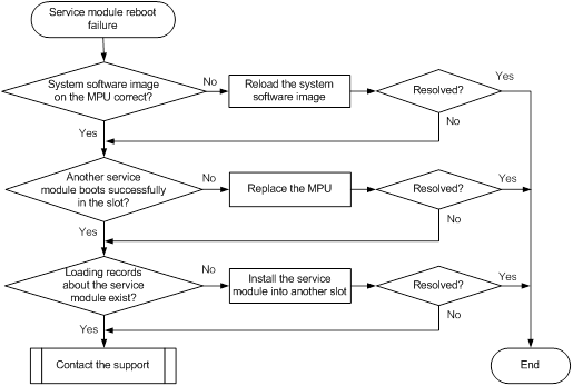

Symptom
A service module fails to reboot. The RUN and ALM LEDs for the service module are on.
Figure 3 Troubleshooting service module reboot failure
Solution
1.     Verify that the system software image is available and that the image is the same size as the one on the server. If no system software image is available, or the system software image size is different from the one on the server, reload the system software image.
<Sysname> display boot-loader
  Software images on slot 1:
Current software images:
  flash:/S10500X-CMW710-BOOT-R7557.bin
  flash:/S10500X-CMW710-SYSTEM-R7557.bin
Main startup software images:
Backup startup software images:
  None
Symptom
A newly-installed service module fails to boot. The RUN and ALM LEDs for the service module are on.
Figure 4 Troubleshooting service module boot failure
Solution
  None
<Sysname> dir
Directory of flash:
   0 drw-           - Jun 14 2017 16:18:06   core
   1 drw-           - Jun 14 2017 11:32:34   diagfile
   2 -rw-        7122 Jun 14 2017 10:02:46   ifindex.dat
   3 drw-           - Jun 14 2017 19:00:37   start-zy.cfg
   4 drw-           - Jun 14 2017 11:51:15   logfile
   5 -rw-    20529152 Jun 14 2017 14:28:40   S10500X-cmw710-boot-R7557.bin
   6 -rw-   178325504 Jun 14 2017 14:39:02   S10500X-cmw710-system-R7557.bin
   7 drw-           - Jun 14 2017 11:32:34   seclog
   8 -rw-       17175 Jun 14 2017 10:02:48   startup.cfg
   9 -rw-      276535 Jun 14 2017 10:02:48   startup.mdb
  10 drw-           - Jun 14 2017 11:11:54   versionInfo
2097152 KB total (1998644 KB free)
2.     Remove and reinstall the service module to make sure the service module is installed securely.
3.     Verify that the power system of the switch provides sufficient power. Add power modules to the switch to verify that the MPU is operating correctly.
4.     See the release notes to determine whether the system software image supports the service module. If the system software image does not support the service module, upgrade the system software image to the version that supports the service module.
5.     Install another service module that is compatible with the system software image into the slot to verify that the service module can boot successfully. If the service module boots successfully, no failure occurs on the MPU and backplane. If the service module fails to boot, replace the MPU.
6.     Execute the display logbuffer command to verify that the service module has loaded files.
[Sysname]display logbuffer
%May  3 13:27:17:086 2017 H3C DEVM/4/BOARD_LOADING: Board is loading file on Chassis 1 Slot 7.
%May  3 13:27:17:647 2017 H3C DEVM/5/LOAD_FINISHED: Board has finished loading file on Chassis 1 Slot 7.
?     If the service module has loaded files, install the service module into another slot to verify that the service module can load files successfully.
?     If the service module has not leaded files, go to step 7.
7.     If the problem persists, contact H3C Support.

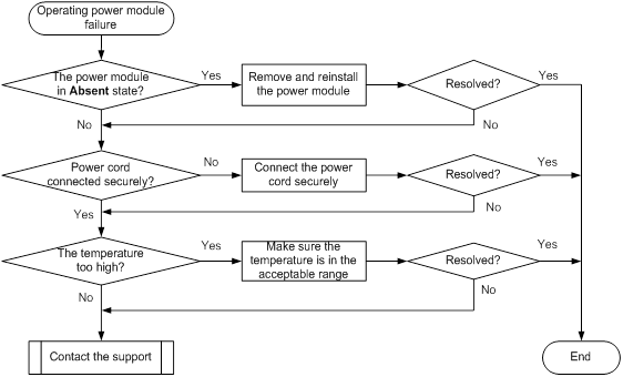

Operating power module failure
Symptom
An operating power module fails. On the MPU, the PWR OK LED is off and the PWR FAIL LED is on.
Figure 5 Troubleshooting operating power supply failure
Solution
1.     Identify the operating state of the power module.
?     Execute the display power command to view the operating state of the power module.
<Sysname>display power
 Power        0 State: Normal
 Power        1 State: Absent
 Power        2 State: Absent
 Power        3 State: Absent
?     Execute the display alarm command to view alarm information about the power module.
<Sysname> display alarm
Slot   CPU   Level   Info
-      -     INFO    Power 1 is absent.
-      -     INFO    Power 2 is absent.
-      -     INFO    Power 3 is absent.
If the power module is in Absent state, go to step 2. If the power module is in Fault state, go to step 3.
2.     Verify that the power module is installed securely.
Remove and reinstall the power module to make sure the power module is installed securely. Then observe the power module LEDs on the MPU. If the LEDs still indicate power module failure, exchange the power module with another power module that is operating correctly. Then execute the display power command to verify that the power module has changed to Normal state. If the power module remains in Absent state, replace the power module.
3.     Verify that the power module is operating correctly.
a.     Verify that the power cord is connected to the power module securely.
<Sysname> display power
 Power        3 State: Fault
If the voltage and current of the power module are 0 and the power module state is Fault, the power cord is disconnected. Connect the power cord securely to the power module. Then execute the display power command to verify that the power module has changed to Normal state.
b.     Determine whether the power module is in high temperature. If dust accumulation on the power module causes the high temperature, remove the dust. Then remove and reinstall the power module. Execute the display power command to verify that the power module has changed to Normal state.
c.     Install the power module into an empty power module slot. Then execute the display power command to verify that the power module has changed to Normal state in the new slot. If the power module remains in Fault state, replace the power module.

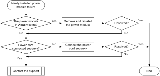

Newly installed power module failure
Symptom
A newly installed power module fails. On the MPU, the PWR OK LED is off and the PWR FAIL LED is on.
Figure 6 Troubleshooting newly installed power module failure
Solution
Chassis Slot   CPU   Level   Info
2       -      -     INFO    power 1 is absent.
2       -      -     INFO    power 2 is absent.
2       -      -     INFO    power 3 is absent.
a.     Remove and reinstall the power module to make sure the power module is installed securely. Then execute the display power command to verify that the power module has changed to Normal state.
b.     Remove and install the power module into an empty power module slot. Then execute the display power command to verify that the power module has changed to Normal state in the new slot. If the power module remains in Absent state, go to step 4.
a.     Verify that the power module is connected to the power source correctly. If it is not, connect it to the power source correctly. Then execute the display power command to verify that the power module has changed to Normal state.
b.     Remove and install the power module into an empty power module slot. Then execute the display power command to verify that the power module has changed to Normal state in the new slot. If the power module remains in Fault state, go to step 4.

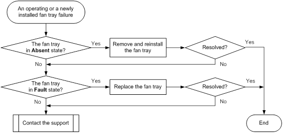

Fan tray failure
Symptom
An operating fan tray or a newly installed fan tray fails. On the MPU, the FAN OK LED is off and the FAN FAIL LED is on.
Figure 7 Troubleshooting fan tray failure
Solution
1.     Identify the operating state of the fan tray.
?     Execute the display fan command to view the operating state of the fan tray.
<Sysname> display fan
Fan Frame 0  State: Normal
?     Execute the display alarm command to view alarm information about the fan tray.
2       -      -     INFO    fan 1 is absent.
If the fan tray is in Absent state, go to step 2. If the fan tray is in Fault state, go to step 3.
2.     Verify that the fan tray is installed securely.
Remove and reinstall the fan tray to make sure the fan tray is installed securely. Then execute the display fan command to verify that the fan tray has changed to Normal state. If the fan tray remains in Absent state, replace the fan tray.
3.     Verify that the fan tray is operating correctly.
a.     Identify whether the fan tray is faulty.
-     Execute the display environment command to view temperature information.
If the temperature continues to rise, put your hand at the air outlet to feel if air is being expelled out of the air outlet. If no air is being expelled out of the air outlet, the fan tray is faulty.
-     Execute the debug sysm fan fan-id get-speed command in probe view to view the fan speed information.
If the fan speed is less than 500 rpm, the fan tray is faulty.
b.     If the fan tray is faulty, remove and reinstall the fan tray to make sure the fan tray is installed securely. Then execute the display fan command to verify that the fan tray has changed to Normal state.
c.     If the fan tray remains in Fault state, replace the fan tray.
You must make sure the switching operating temperature is below 60°C (140°F) while you replace the fan tray. If a new fan tray is not readily available, power off the switch to avoid damage caused by high temperature.

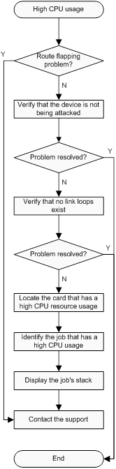

High CPU usage
Symptom
The sustained CPU usage is over 80% on a card.
Figure 8 Troubleshooting high CPU usage
Solution
Possible reasons for high CPU usage problems include:
·     Route flapping is taking place.
·     The device is being attacked.
·     A link loop exists. A link loop might cause broadcast storm and network flapping problems. If such a problem occurs, large amounts of protocol packets are sent to the CPU. Many interfaces on the device receive heavy traffic. The interface usage might reach 90% or be even higher.
1.     Display routing table information multiple times. If route entries change frequently, route flapping is taking place. Go to step 7.
2.     Verify that the device is not being attacked:
a.     Use a packet capture tool to capture packets on ports of the device. For example, you can use Sniffer, Wireshark, or WinNetCap.
b.     Analyze packet characteristics to identify the attack sources.
c.     Configure attack prevention against the attack sources.
For more information, see Security Configuration Guide.

c.     If the problem persists, an STP protocol calculation error might have occurred or interfaces are not blocked at the driver level as expected. Shut down the uplink interface of the loop or disconnect the cable and then connect the cable again to trigger STP recalculation to recover services. Send the symptom information to H3C Support for analysis.
4.     If the problem persists, execute the display cpu-usage command multiple times to locate the card that has a high CPU resource usage.
5.     If you still cannot locate the problem, identify the job that has a high CPU usage. For example:

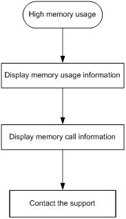

High memory usage
Symptom
The memory usage on a card is over 60% for more than 30 minutes.
Figure 9 Troubleshooting high memory usage
Solution
IMPORTANT
IMPORTANT:
As a best practice, do not reboot the device before you contact H3C Support. You might lose critical diagnostic information if you reboot the device.
1.     Execute the display system internal kernel memory pool command multiple times to display memory usage information.
[Sysname-probe] display system internal kernel memory pool slot 1
Active    Number  Size     Align Slab Pg/Slab ASlabs  NSlabs Name
9126      9248    64       8     32   1       289     289    kmalloc-64
105       112     16328    0     2    8       54      56     kmalloc-16328
14        14      2097096  0     1    512     14      14     kmalloc-2097096
147       225     2048     8     15   8       12      15     kmalloc-2048
7108      7232    192      8     32   2       226     226    kmalloc-192
22        22      524232   0     1    128     22      22     kmalloc-524232
1288      1344    128      8     21   1       64      64     kmalloc-128
0         0       67108808 0     1    16384   0       0      kmalloc-67108808
630       651     4096     8     7    8       93      93     kmalloc-4096
68        70      131016   0     1    32      68      70     kmalloc-131016
1718      2048    8        8     64   1       31      32     kmalloc-8
1         1       16777160 0     1    4096    1       1      kmalloc-16777160
2         15      2048     0     15   8       1       1      sgpool-64
0         0       40       0     42   1       0       0      inotify_event_cache
325       330     16328    8     2    8       165     165    kmalloc_dma-16328
0         0       72       0     30   1       0       0      LFIB_IlmEntryCache
0         0       1080     0     28   8       0       0      LFIB_IlmEntryCache
0         0       1464     0     21   8       0       0      MFW_FsCache
1         20      136      0     20   1       1       1      L2VFIB_Ac_cache
0         0       240      0     25   2       0       0      CCF_JOBDESC
0         0       88       0     26   1       0       0      NS4_Aggre_TosSrcPre
0         0       128      0     21   1       0       0      IPFS_CacheHash_cachep
---- More ----
Each value line shows the memory information for a slab. The Number field shows the number of objects (memory blocks) allocated to the module. The product of the Number field and the Size field shows the size of the memory space that is used by a slab. If the memory space used by a slab keeps increasing, the slab might have memory leakage problems.
2.     Display the memory call information for the slabs that might have leak problems. This example uses the kmalloc-2048 slab.
[Sysname-probe] view /sys/kernel/slab/kmalloc-2048/alloc_calls
     23 kque_create+0x58/0x260 age=4262117/4404939/4692659 pid=128-372 cpus=0,2-3
      2 sys_init_module+0x1bdc/0x1e50 age=4746250/4748179/4750108 pid=109-128 cpus=9,12
      4 __vmalloc_area_node+0x154/0x1b0 age=4652363/4677089/4747310 pid=128-166
cpus=0-1,12
     16 percpu_populate+0x3c/0x60 age=4322758/4322758/4322758 pid=128 cpus=0
     21 alloc_pipe_info+0x24/0x60 age=4/3888025/4320768 pid=1-564 cpus=0-4,9,11
     29 alloc_pci_dev+0x18/0x40 age=4758366/4758366/4758368 pid=1 cpus=15
      2 init_dev+0x1c0/0x870 age=510128/2630142/4750157 pid=1-542 cpus=0,2
      1 init_dev+0x4dc/0x870 age=510128 pid=542 cpus=2
      2 kobj_map_init+0x2c/0xd0 age=4758371/4758535/4758700 pid=0-1 cpus=0,15
      2 usb_alloc_dev+0x38/0x200 age=4750540/4750605/4750671 pid=1 cpus=15
      1 usb_create_hcd+0x34/0x120 age=4750540 pid=1 cpus=15
     16 exception_notifier_init+0x298/0x4f8 age=4750380/4750380/4750381 pid=1 cpus=15
      1 drv_port_module_varialbe_init+0x24/0x80 [system] age=4651959 pid=128 cpus=0
      1 DRV_VLAN_BasicFunc_Init+0x1ec/0x700 [system] age=4651871 pid=128 cpus=0
      1 drv_vlan_maccash_init+0x124/0x240 [system] age=4651869 pid=128 cpus=0
      1 drv_ipmc_spec_init+0x54/0x840 [system] age=4650355 pid=128 cpus=0
      1 drv_evb_add_broadcast_group+0x964/0xa50 [system] age=4264182 pid=312 cpus=1
      2 DRV_EVB_MAP_AddRec+0x160/0x2a0 [system] age=4264142/4264175/4264209 pid=288 cpus=9
      1 drv_evi_localmac_init+0x160/0x650 [system] age=4651896 pid=128 cpus=0
      1 DRV_QINQ_Init+0x278/0x890 [system] age=4650270 pid=128 cpus=0
      1 DRV_QINQ_Init+0x478/0x890 [system] age=4650270 pid=128 cpus=0
      1 Drv_Qacl_InitAddUdfTemplate+0x68/0xb30 [system] age=4651968 pid=128 cpus=0
      1 drv_qacl_sal_rsc_init+0xc8/0x210 [system] age=4651968 pid=128 cpus=0
---- More ----
The first field of the output shows the number of objects. The remaining fields show the call information.
3.     Save the information displayed in the previous steps.
4.     Contact H3C Support.

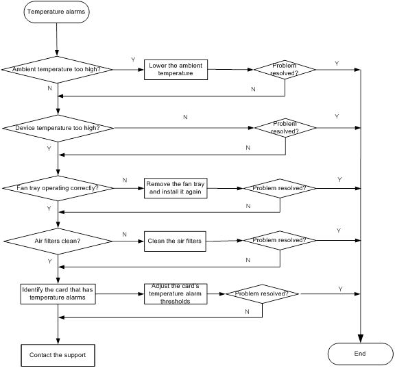

Temperature alarms
Symptom
Temperature alarms occur.
Figure 10 Troubleshooting temperature alarms
Solution
1.     Check the ambient temperature. If the ambient temperature is higher than 45°C (113°F), lower the ambient temperature by adding air conditioners or taking other heat dissipation measures.
2.     Check the device temperature. If the device temperature is higher than 68°C (154.4°F), use the display fan command to check the fan tray operating status. If the status field displays Fault, remove the fan tray and then install the fan tray again.
3.     Identify whether the air filters are clean. If they are not, clean them.
4.     Read the temperature alarms to identify the involved card.
5.     Use the temperature-limit command to adjust the temperature alarm thresholds for the card.
6.     Use the display environment command to identify whether the temperature alarm thresholds have been adjusted successfully. If the thresholds have not been adjusted, replace the card.

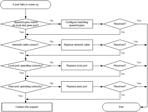

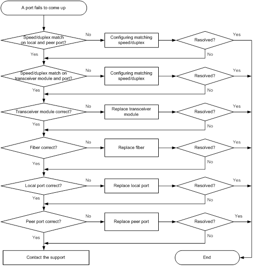

10/100/1000Base-T copper port fails to come up
Symptom
A 10/100/1000Base-T copper port cannot come up.
Figure 11 Troubleshooting link up failure on a port
Solution
1.     Verify that the speed and duplex mode of the local port match the speed and duplex mode of the peer port:
a.     Execute the display interface command to verify that the port is up.
b.     If the port is down, use the undo shutdown command to bring up the port.
c.     Execute the display interface brief command to examine whether the speed and duplex mode of the port match the speed and duplex mode of the peer port.
d.     If they do not match, use the speed command and the duplex command to set the speed and duplex mode for the port.
The speed and duplex mode of network management ports cannot be configured in the current software version.
2.     Replace the network cable with a new one to verify that the network cable is in good condition.
3.     Replace the local port with a new one (on an interface module of the same type, if possible) to verify that the local port is operating correctly.
4.     Replace the peer port with a new one (on an interface module of the same type, if possible) to verify that the peer port is operating correctly.
1000-Mbps SFP fiber port fails to come up
Symptom
A 1000-Mbps SFP fiber port cannot come up.
Figure 12 Troubleshooting link up failure on a port
Solution
2.     Verify that the speed and duplex mode of the port match the speed and duplex mode of the transceiver module:
a.     Execute the display interface brief command to examine whether the speed and duplex mode of the port match the speed and duplex mode of the transceiver module.
b.     If they do not match, use the speed command and the duplex command to set the speed and duplex mode for the port.
3.     Verify that the transceiver module is operating correctly:
a.     Execute the display transceiver alarm interface command to examine the alarms present on the transceiver module.
-     The device displays None if no error occurs.
-     If input errors occur, verify that the peer port, fiber, and intermediate device are operating correctly.
-     If output errors, current errors, or voltage errors occur, verify that the local port is operating correctly.
<Sysname> display transceiver alarm interface GigabitEthernet 2/0/1
GigabitEthernet2/0/1 transceiver current alarm information:
  TX fault
  RX power high
Table 2 Transceiver module alarms
Field
Description
SFP/SFP+/CFP/QSFP+
RX loss of signal
Incoming (Rx) signal is lost.
RX power high
Incoming (Rx) power is high.
RX power low
Incoming (Rx) power is low.
TX fault
Transmit (Tx) fault.
TX bias high
Tx bias current is high.
TX bias low
Tx bias current is low.
TX power high
Tx power is high.
TX power low
Tx power is low.
Temp high
Temperature is high.
Temp low
Temperature is low.
Voltage high
Voltage is high.
Voltage low
Voltage is low.
Transceiver info I/O error
Transceiver information read and write error.
Transceiver info checksum error
Transceiver information checksum error.
Transceiver type and port configuration mismatch
Transceiver type does not match port configuration.
Transceiver type not supported by port hardware
The port does not support the transceiver type.
Field
Description
SFP/SFP+/QSFP+
RX loss of signal
RX power high
RX power low
TX fault
TX bias high
TX bias low
TX power high
Tx power is high.
TX power low
Tx power is low.
Temp high
Temp low
Temperature is low.
Voltage high
Voltage is high.
Voltage low
Voltage is low.

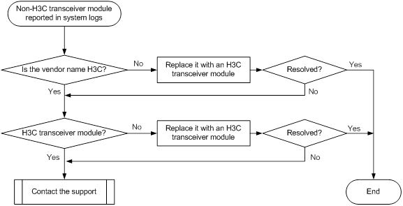

b.     Use an optical power meter to verify that the Tx power and Rx power of the transceiver module are stable and are within the correct range.
c.     Execute the display transceiver interface command to verify that the wavelength and transmission distance of the local transceiver module are consistent with the wavelength and transmission distance of the peer transceiver module.
d.     If the transceiver module is not operating correctly, replace it with a new H3C transceiver module that matches the fiber port.
For more information about transceiver modules, see related installation guides.
4.     Replace the fiber with a new one to verify that the fiber is in good condition.
5.     Replace the local port with a new one (on an interface module of the same type, if possible) to verify that the local port is operating correctly.
6.     Replace the peer port with a new one (on an interface module of the same type, if possible) to verify that the peer port is operating correctly.
Symptom
A 10-Gigabit SFP+ fiber port cannot come up.
Figure 13 Troubleshooting link up failure on a port
Solution
a.     Execute the display interface brief command to examine whether the speed and duplex mode of the port match the speed and duplex mode of the peer port.
3.     Verify that the local and peer ports are operating correctly:
a.     Use a 10-GE SFP+ cable to directly connect the local port and another 10-GE SFP+ of the same interface module. A 10-GE SFP+ cable is suitable for short connections.
b.     If the local port can come up, replace the peer port with a new one to verify that the peer port is operating correctly.
c.     If the local port cannot come up, replace the local port with a new one to verify that the local port is operating correctly.
4.     Verify that the transceiver module is operating correctly:
-     The device displays alarms if the transceiver module fails or the type of the transceiver module does not match the port type.
5.     Verify that the fiber matches the transceiver module. If they do not match, replace the fiber with a new one that matches the transceiver module.
6.     If the problem persists, contact H3C Support.

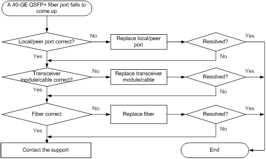

40-GE QSFP+ fiber port fails to come up
Symptom
A 40-Gigabit QSFP+ fiber port cannot come up.
Figure 14 Troubleshooting link up failure on a port
Solution
1.     Verify that the local and peer ports are operating correctly:
a.     Use a QSFP+ cable to directly connect the local port and another 40-GE QSFP+ fiber port of the same interface module. A QSFP+ cable is suitable for short connections.
b.     If the local port can come up, replace the peer port with a new one (on an interface module of the same type, if possible) to verify that the peer port is operating correctly.
c.     If the local port cannot come up, replace the local port with a new one (on an interface module of the same type, if possible) to verify that the local port is operating correctly.
2.     Verify that the transceiver module is operating correctly:
IMPORTANT
IMPORTANT:
If a QSFP+ to SFP+ cable is used, use an optical attenuator to make sure the Tx power of the QSFP+ module stays below the Rx power of the SFP+ module.
3.     Verify that the fiber matches the transceiver module. If they do not match, replace the fiber with a new one that matches the transceiver module.

Reporting non-H3C transceiver modules
Symptom
When you use the display logbuffer command to view the system logs, the following reports about non-H3C transceiver modules appear in the system logs:
<Sysname> display logbuffer
%Oct 17 21:37:24:812 2011 nl-denbo-ro01 OPTMOD/4/PHONY_MODULE:
  -Chassis=2-Slot=3;    GigabitEthernet2/3/0/5: This transceiver is NOT sold by H3C. H3C  therefore shall NOT guarantee the normal function of the device or  assume the maintenance responsibility thereof!
Figure 15 Troubleshooting non-H3C transceiver module reports
Solution
1.     Identify the vendor of the transceiver module plugged into the port:
a.     Use the display transceiver interface command to display the transceiver information.
If the Vendor Name field is H3C, the transceiver module might be an H3C transceiver module without an electrical label or a non-H3C transceiver module.
b.     If the Vendor Name field is not H3C, you can determine that this is not an H3C transceiver module. Replace it with an H3C transceiver module.
2.     Contact H3C Support to determine whether the transceiver module vendor is H3C:
a.     Use the debug port optical-eeprom command in probe view to collect the transceiver module information. Send the bar code of the transceiver module to H3C Support to identify the vendor of the transceiver module.
b.     If you determine that the transceiver module vendor is not H3C, replace it with an H3C transceiver module.
3.     If the transceiver module vendor is identified as H3C but the problem persists, contact H3C Support.
Symptom
When you use the display transceiver diagnosis interface command to display the diagnostic information of a transceiver module, the system displays a message that the transceiver module does not support digital diagnosis.
<Sysname> display transceiver diagnosis interface gigabitethernet 1/0/1
Error: The transceiver does not support this function.
Figure 16 Troubleshooting the failure to support digital diagnosis on a transceiver module
Solution
1.     Verify that the vendor of the transceiver module is H3C:
b.     Determine whether the value of the Vendor Name field is H3C.
c.     Use the display transceiver manuinfo interface command to collect the transceiver module information. Send the bar code of the transceiver module to H3C Support to verify that the vendor of the transceiver module is H3C.
2.     Verify that the transceiver module supports digital diagnosis:
a.     Use the display transceiver interface command to display transceiver module information.
b.     Determine whether the value of the Digital Diagnostic Monitoring field is Yes.
c.     Consult H3C Support about whether the transceiver module supports digital diagnosis.
3.     If the transceiver module vendor is identified as H3C and the transceiver module supports digital diagnosis but the problem persists, contact H3C Support.

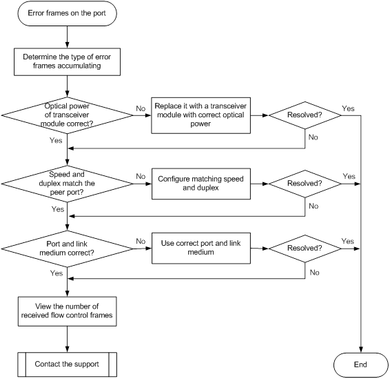

Error frames (for example, CRC errors) on a port
Symptom
The output from the display interface command shows that error frames exist (for example, CRC error frames) on a port.
<Sysname> display interface gigabitethernet3/0/1
GigabitEthernet3/0/1
Current state: DOWN
Line protocol state: DOWN
Description: GigabitEthernet3/0/1 Interface
Bandwidth: 1000000 kbps
Maximum transmission unit: 1500
Internet address: 2.1.1.2/24 (primary)
IP packet frame type: Ethernet II, hardware address: 0000-fc00-9276
IPv6 packet frame type: Ethernet II, hardware address: 0000-fc00-9276
Loopback is not set
Media type is twisted pair, port hardware type is 1000_BASE_T
Port priority: 0
1000Mbps-speed mode, full-duplex mode
Link speed type is autonegotiation, link duplex type is autonegotiation
Flow-control is not enabled
Maximum frame length: 9216
Last clearing of counters: Never
 Peak input rate: 8 bytes/sec, at 2017-03-19 09:20:48
 Peak output rate: 1 bytes/sec, at 2017-03-19 09:16:16
 Last 300 second input: 0 packets/sec 0 bytes/sec -%
 Last 300 second output: 0 packets/sec 0 bytes/sec -%
 Input (total):  2892 packets, 236676 bytes
          24 unicasts, 2 broadcasts, 2866 multicasts, 0 pauses
 Input (normal):  2892 packets, - bytes
 Input:  0 input errors, 0 runts, 0 giants, 0 throttles
          3 CRC, 0 frame, - overruns, 0 aborts
          - ignored, - parity errors
 Output (total): 29 packets, 1856 bytes
          24 unicasts, 5 broadcasts, 0 multicasts, 0 pauses
 Output (normal): 29 packets, - bytes
 Output: 0 output errors, - underruns, - buffer failures
          0 aborts, 0 deferred, 0 collisions, 0 late collisions
          0 lost carrier, - no carrier
Figure 17 Troubleshooting error frames (for example, CRC errors) on a port
Solution
1.     (Optional.) Use the reset counter interface command in user view to clear the packet statistics of the port.
This command resets the values of each statistical field to 0, so that you can view the statistics changes more clearly.
2.     Use the display interface command to display the incoming packet statistics and outgoing packet statistics of the port.
?     If the value of the input CRC, frame, or throttles field is increasing, perform the following tasks:
# Verify that the link is operating correctly.
Poor link quality or excessive optical attenuation might cause packet transmission errors. Replace the cable or fiber if the link is not operating correctly.
# Replace the local port with a new one to verify that the local port is operating correctly.
-     If error frames stop accumulating, replace the local port and send the error information to the technical support.
-     If error frames continue to accumulate, check the peer device and the intermediate link.
?     If the value of the input overruns field is increasing, verify that the interface module is operating correctly.
The value of the overruns field represents the number of packets dropped because the input rate of the port exceeded the queuing capability.
If only one port or only the device connected to the port has error frames, execute the display interface command multiple times. If the value of input errors field is increasing, and the increased number equals to the increased number of the overruns field, the interface module is incorrect. Send the error information to the technical support.
?     If the value of the input giants field is increasing, verify that the local and peer ports have the same jumbo frame configuration.
3.     If the port is a fiber port, verify that the optical power of the transceiver module is operating correctly:
a.     Use the display transceiver diagnosis interface command in probe view to view the present measured values of the digital diagnosis parameters for the transceiver module.
b.     If the optical power of the transceiver module is not within the correct range, replace the transceiver module with a transceiver module of the same model that is operating correctly.
[Sysname-probe] display transceiver diagnosis interface ten-gigabitethernet 1/0/1
Ten-GigabitEthernet1/0/1 transceiver diagnostic information:
  Current diagnostic parameters:
    [module]  Temp.(°C)
              1stTX   2ndTX   1stRX   2ndRX
              N/A     N/A     N/A     N/A
              Voltage(V)
              3.3VTX  12VTX   3.3VRX  12VRX
              3.29    N/A     3.40    N/A
    [channel] TX Bias(mA)    RX power(dBm)  TX power(dBm)
    1         6.09           0.91           -0.77
    2         5.95           1.09           -0.16
    3         6.05           1.58           -0.17
    4         5.85           1.58           -0.14
    5         6.07           2.23           -0.30
    6         5.72           2.85           -0.47
    7         6.11           3.01           -0.08
    8         5.50           1.17           -0.02
    9         5.89           -0.85          -0.17
    10        5.94           -40.00         0.29
    11        6.05           -40.00         0.18
    12        5.78           -40.00         -0.30
  Alarm thresholds:
    [module]  Temp.(°C) Voltage(V)  Bias(mA)  RX power(dBM)  TX power(dBM)
    High      0          3.63        10.00     1.58           5.44
    Low       0          2.97        0.50      3.13           -11.61
4.     Verify that the port configurations are correct:
a.     Execute the display interface brief command.
b.     Determine whether the speed and duplex mode of the port match the speed and duplex mode of the peer port.
c.     If they do not match, use the speed command and the duplex command to set the speed and duplex mode for the port.
5.     Verify that the port and the link medium are operating correctly:
a.     Plug the link medium into another port that is operating correctly, and determine whether the same problem occurs.
b.     If the problem still occurs, verify that the following items are operating correctly:
-     Intermediate links and devices, including optical-to-electrical converters, cable terminal racks, and transmission devices.
-     Transmission medium, including network cables, optical fibers, and transceiver modules.
c.     Examine the port:
-     If the port is a copper port, directly connect the port to a PC.
-     If the port is a fiber port, replace the transceiver module plugged into the port.
6.     Determine whether the port has received a large amount of flow control frames:
a.     Use the display interface command to view the number of pause frames.
If the number of pause frames is accumulating, you can determine that the port has sent or received a large amount of flow control frames.
b.     Verify that the incoming traffic and outgoing traffic have not exceeded the maximum traffic processing capability of the local device and the peer device.

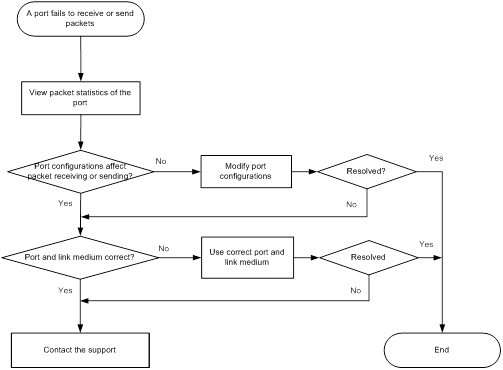

Failure to receive or send packets
Symptom
A port is up, but it cannot receive or send packets.
Figure 18 Troubleshooting the failure to receive packets
Solution
1.     Examine the packet statistics of the port:
a.     (Optional.) Use the reset counter interface command in user view to clear the packet statistics of the port.
b.     Determine whether the ports at both ends are always up, and use the display interface  command to determine whether the number of incoming or outgoing packets is accumulating. At the same time, examine the outgoing or incoming packet statistics of the peer port.
c.     View the values of the error packet fields and determine whether the number of error packets is accumulating.
2.     Verify that the port configurations do not affect packet receiving or sending:
a.     Use the display interface brief command to verify that the port configurations are correct.
The port configurations include the duplex mode, speed, port type, and VLAN configurations of the ports at both ends of the link.
b.     If configuration errors exist, modify the port configurations. If the number of incoming packets in the output from the display interface command is accumulating, you can determine that the port can receive packets.
c.     If the port fails to receive packets, use the shutdown command and then the undo shutdown command to re-enable the port. If the number of incoming packets in the output from the display interface command is accumulating, you can determine that the port can receive packets.
d.     If the port is configured with STP, use the display stp brief command to verify that the port is not in the discarding state.
e.     If a port is set to the discarding state by STP, examine and modify the STP-related configurations to resolve the problem.
As a best practice, configure the port as an edge port or disable STP on the port if it is directly connected to a terminal.
f.     If the port is assigned to an aggregation group, use the display link-aggregation summary command to verify that the status of the port is Selected.
g.     If the status of the port is Unselected, the port cannot send or receive data packets.
h.     Determine the reasons why the port becomes Unselected, for example, the attribute configurations of the port are different from the reference port. Modify the attribute configurations of the port to make the port become Selected.
3.     Verify that the port and the link medium are operating correctly:
b.     Examine the port.

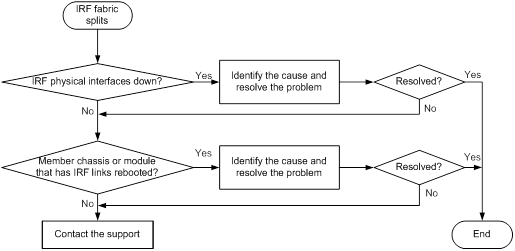

IRF split
Symptom
An IRF fabric splits.
Figure 20 Troubleshooting IRF split
Solution
1.     Verify that the IRF physical interfaces are operating correctly:
a.     Execute the display trapbuffer command or view system logs to check for physical IRF link down events that occurred around the split time.
b.     If the split followed an IRF link down event, execute the display interface command to check port statistics for CRC errors.
c.     If transceiver modules and fibers are used, execute the display transceiver diagnosis command. Make sure the transmit and receive power has not exceeded the power specifications of the fiber module.
d.     Remove hardware problems that might cause recurring IRF split events:
e.     Execute the display version command to identify the uptime of MPUs and interface modules that have IRF links.
f.     Compare the uptime of MPUs and interface modules to determine whether a member chassis or interface module had rebooted before the IRF split.
g.     If the IRF split is caused by a member chassis or interface module reboot, use the methods described in "Troubleshooting hardware" to resolve the problem.
2.     If the problem persists, contact H3C Support.

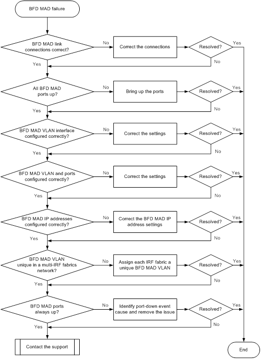

BFD MAD failure
Symptom
BFD MAD fails to detect an IRF split event. Two IRF fabrics are operating with the same Layer 3 settings, including the same IP address.
Figure 21 Troubleshooting BFD MAD failure
Solution
1.     Verify that BFD MAD link connections are correct:
?     If you do not use an intermediate device, verify that each pair of member chassis has a dedicated BFD MAD link.
?     If you use an intermediate device, verify that each member chassis has a dedicated BFD MAD link with the intermediate device.
2.     Verify that all physical ports used for BFD MAD are up:
a.     Execute the display interface command.
b.     Check the current state field in the command output:
-     If the field displays DOWN ( Administratively ) for a port, execute the undo shutdown command to bring up the port.
-     If the field displays DOWN for a port, check the physical link for a link failure.
3.     Verify that the BFD MAD VLAN interface is configured correctly:
a.     Execute the display mad verbose command.
b.     Check the MAD BFD enabled interface field to verify that VLAN-interface 1 is not used for BFD MAD.
c.     If VLAN-interface 1 is used for BFD MAD, disable BFD MAD on VLAN-interface 1, and then enable BFD MAD on another VLAN interface.
d.     Verify that the BFD MAD-enabled VLAN interface does not have any other features, including VPN.
e.     Execute the display interface command to verify that the interface does not have the following IP addresses:
-     IP address assigned by using the ip address command.
-     VRRP virtual IP address.
4.     Verify that the BFD MAD VLAN and physical ports in the VLAN are configured correctly:
a.     Execute the display vlan command to verify the following items:
-     The BFD VLAN contains all physical ports used for BFD MAD.
-     The BFD VLAN does not contain physical ports that are not used for BFD MAD.
If an intermediate device is used, you must also perform this step on the intermediate device.
b.     Execute the display interface command to verify that the physical ports in the BFD VLAN are not configured with any features.
For BFD MAD to operate correctly, you must disable all features on the physical ports in the BFD MAD VLAN, including the spanning tree feature, ARP, and LACP.
5.     Verify that the MAD IP addresses are correct:
b.     Check the mad ip address field to verify the following items:
-     Each member chassis has a MAD IP address.
-     All MAD IP addresses are on the same subnet.
-     The MAD IP addresses are not addresses being used on the IRF fabric.
6.     If the network has multiple IRF fabrics, execute the display mad verbose command to verify that their BFD MAD VLANs are different.
7.     Verify that the physical ports in the BFD MAD VLAN are always up:
a.     Execute the display trapbuffer command or use system logs to check for BFD MAD port-down events that occurred around the split time.
b.     Identify the cause of the events, and remove the issue.
8.     If the problem persists, contact H3C Support.
LACP MAD failure
Symptom
LACP MAD fails to detect an IRF split event. Two IRF fabrics are operating with the same Layer 3 settings, including the same IP address.
Figure 22 Troubleshooting LACP MAD failure
Solution
1.     Verify that the intermediate device is an H3C device that supports extended LACPDUs for MAD.
If the intermediate device does not support extended LACPDUs for MAD, replace the intermediate device, or use BFD MAD for split detection.
2.     Verify that each member chassis has a link in the link aggregation with the intermediate device.
3.     Verify that the link aggregation is operating in dynamic mode.
To enable dynamic aggregation mode, use the link-aggregation mode dynamic command.
4.     Verify that the aggregate interface and its member ports are up:
b.     Check the current state field of the aggregate interface:
-     If the field displays DOWN ( Administratively ), execute the undo shutdown command to bring up the interface.
-     If the field displays DOWN, check the state of all its physical ports.
An aggregate interface goes down only if all its physical ports are down.
c.     Check the current state field of each member port:
-     If the field displays DOWN ( Administratively ), execute the undo shutdown command to bring up the port.
-     If the field displays DOWN, check the physical link of the port for a link failure.
5.     If the intermediate device is also an IRF fabric, verify that the IRF domain IDs of the two IRF fabrics are unique:
CAUTION
CAUTION:
he IRF member devices send extended LACPDUs with TLVs that convey the domain ID and the active ID of the IRF fabric. To avoid split detection failure, make sure the IRF fabric has a unique domain ID.
a.     Execute the display irf command to identify the domain ID of each IRF fabric.
b.     If the IRF fabrics use the same domain ID, execute the irf domain command to change the domain ID on one IRF fabric.
6.     Verify that the physical ports in the link aggregation are always up:
a.     Execute the display trapbuffer command or use system logs to check for port-down events around the split time.
b.     Identify the event cause and remove the issue.
Symptom
The system fails to apply a packet filter or an ACL-based QoS policy to the hardware. It displays an error message that an unsupported rule exists in the ACL. The following is a sample error message:
Error: Slot=2 Fail to apply or refresh packet filter policy 3180 rule 5 on interface Vlan-interface20. Not supported.
Figure 23 Troubleshooting ACL application failure
Solution
1.     Delete the unsupported rule and apply the packet filter or QoS policy again.
If the rule is indispensable and cannot be deleted, go to step 2.

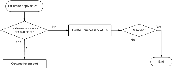

ACL application failure for insufficient resources
Symptom
The system fails to apply a packet filter or an ACL-based QoS policy to the hardware. It displays an error message that the hardware resources are not sufficient. The following are sample error messages:
Error: Slot=2 Fail to apply or refresh packet filter policy 3001 rule 25 on interface Vlan-interface6 due to lack of resources.
Warning: Classifier-behavior test in policy test applied on vlan 4079 failed in slot 2.
Reason: Not enough hardware resource.
Figure 24 Troubleshooting ACL application failure
Solution
Insufficient hardware resources might be insufficient Counter, Meter, or ACL resources.
1.     Check the ACL, Counter, and Meter resource usage for insufficiency.
Execute the display qos-acl resource command to display the resource usage. If the number of ACLs to be applied is higher than the value of the Remaining field, resources are insufficient. If the ACLs are to be applied globally, check remaining resource usage on all cards.
[Sysname] display qos-acl resource
Interfaces: XGE2/3/0/1 to XGE2/3/0/4
 Type             Total      Reserved   Configured Remaining  Usage
 VFP ACL          2048       1024       0          1024       50%
 IFP ACL          8192       3072       0          5120       37%
 IFP Meter        4096       1536       0          2560       37%
 IFP Counter      4096       1536       0          2560       37%
 EFP ACL          1024       0          0          1024       0%
 EFP Meter        512        0          0          512        0%
 EFP Counter      512        0          0          512        0%
Interfaces: XGE2/3/0/5 to XGE2/3/0/8
?     IFP—Resource usage for inbound traffic.
?     EFP—Resource usage for outbound traffic.
2.     Delete unnecessary ACLs to release resources if the failure is caused by ACL resource insufficiency. Delete unnecessary ACLs that use Meter or Counter resources if the failure is caused by Meter or Counter resource insufficiency.
If you cannot release enough resources, go to step 4.
If the ACL resources are sufficient, the reason might be that the ACL conflicts with a specific algorithm in the ASIC chip. In this case, go to step 4.
3.     Apply the packet filter or QoS policy again.

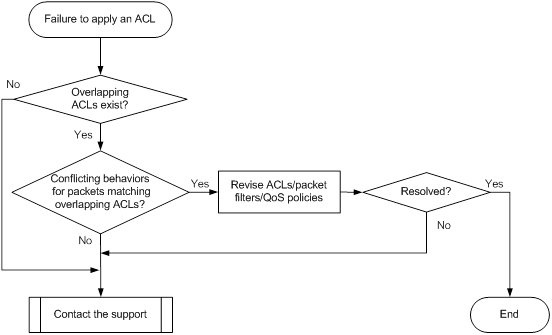

ACL application failure without an error message
Symptom
The system applies a packet filter or an ACL-based QoS policy to the hardware. However, the ACL does not take effect.
Figure 25 Troubleshooting ACL application failure
Solution
1.     Check the ACLs used by QoS policies and packet filters for overlapping rules:
a.     Use the following commands to display ACLs that are used by QoS policies and packet filters:
-     display packet-filter
-     display qos policy user-defined
-     display traffic classifier user-defined
b.     Execute the display acl command to check for overlapping rules in the ACLs.
For example, the following sample output shows that rule 0 in ACL 3100 and rule 0 in ACL 3009 can both match traffic sourced from 2.2.2.1.
ACL number 3100
rule 0 permit ip source 2.2.2.2 0.0.255.255
ACL number 3009
rule 0 permit ip source 2.2.2.2 0.0.0.255
2.     Check the filters and policies that use overlapping ACLs for a behavior conflict.
If two behaviors conflict, the device performs the behavior that has higher priority, as shown in Table 4.
Table 4 Rules for selecting a higher priority behavior from conflicting behaviors
Conflicting behaviors
Higher priority behavior
·     redirect
·     filter permit
redirect
·     redirect
·     filter deny
filter deny
·     filter permit
·     filter deny
The behavior configured first.
3.     Revise ACLs, packet filters, or QoS policies to remove the behavior conflict.

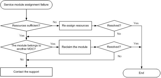

Service module assignment failure
Symptom
The location command fails to assign a service module to an MDC.
Figure 27 Troubleshooting service module assignment failure
Solution
Typical service module assignment failure reasons include:
·     The available hardware resources are insufficient.
·     The service module belongs to another MDC. A service module can belong to only one MDC. Before you assign a service module to a non-default MDC, you must remove the existing assignment of the service module.

2.     If the CPU, disk space, or memory space resources assigned to an MDC are insufficient, re-assign resources to the MDC. (Details not shown.)
3.     Display the MDC to which the service module belongs. In this example, the service module is installed in slot 3 of member device 3. The service module is required to be assigned to mdcB.
If the output is as follows, the undo location command has not been executed for any service modules on the default MDC, and all service modules belong to the default MDC:
[Sysname]mdc Admin
[Sysname-mdc-1-Admin]display this
mdc Admin id 1
Return
If the output is as follows, the service module belongs to mdcA:
[Sysname-mdc-2-mdcA]display this
mdc mdcA id 2
 location chassis 3 slot 3
 mdc start
Return
4.     Reclaim the service module. In this example, the service module belongs to the default MDC.
[Sysname-mdc-1-Admin]undo location chassis 3 slot 3
The configuration associated with the specified slot of MDC will be lost. Continue? [Y/N]:y
5.     Verify that the service module does not belong to the default MDC.
mdc Admin id 1
Return
6.     Assign the service module to the mdcB.
[Sysname-mdc-2-mdcA]quit
[Sysname]mdc mdcB
[Sysname-mdc-3-mdcB]location chassis 3 slot 3
7.     Verify that the service module belongs to mdcB.
[Sysname-mdc-3-mdcB]display this
mdc mdcB id 3
 mdc start
Return

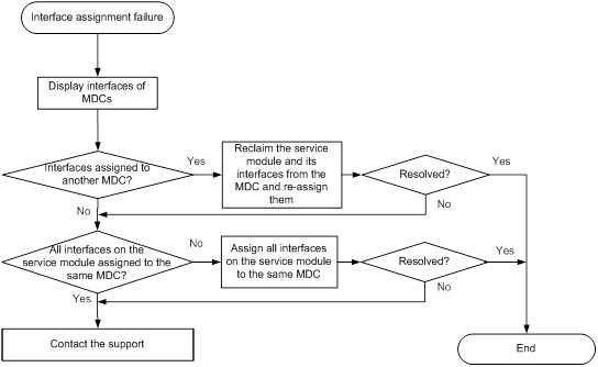

Interface assignment failure
Symptom
Interfaces on a service module fail to be assigned to a non-default MDC, or the interfaces are not available in MDC view.
Figure 28 Troubleshooting interface assignment failure
Solution
To successfully assign interfaces to a non-default MDC, make sure the following requirements are met:
·     A service module on the device can belong to only one MDC.
·     All interfaces on a service module must be assigned to the same MDC by using a single command.
·     Before assigning a service module to an MDC, assign all interfaces on the service module to the MDC by using a single allocate command.
To reclaim a service module from the default MDC, only the undo location command is required. You do not need to use the undo allocate command.
1.     Display the interfaces of MDCs.
[Sysname]display mdc interface
 MDC Admin's interface(s):
  M-GigabitEthernet1/0/0/0
 MDC mdcA's interface(s):
  M-GigabitEthernet1/0/0/0             GigabitEthernet3/3/0/1
  GigabitEthernet3/3/0/2               GigabitEthernet3/3/0/3
  GigabitEthernet3/3/0/4               GigabitEthernet3/3/0/5
  GigabitEthernet3/3/0/6               GigabitEthernet3/3/0/7
  GigabitEthernet3/3/0/8               GigabitEthernet3/3/0/9
  GigabitEthernet3/3/0/10              GigabitEthernet3/3/0/11
  GigabitEthernet3/3/0/12              GigabitEthernet3/3/0/13
  GigabitEthernet3/3/0/14              GigabitEthernet3/3/0/15
  GigabitEthernet3/3/0/16              GigabitEthernet3/3/0/17
  GigabitEthernet3/3/0/18              GigabitEthernet3/3/0/19
  GigabitEthernet3/3/0/20              GigabitEthernet3/3/0/21
  GigabitEthernet3/3/0/22              GigabitEthernet3/3/0/23
  GigabitEthernet3/3/0/24              Ten-GigabitEthernet3/3/0/25
  Ten-GigabitEthernet3/3/0/26
 MDC mdcB's interface(s):
[Sysname]mdc mdcA
mdc mdcA id 2
 mdc start
 allocate interface GigabitEthernet3/3/0/1 to GigabitEthernet3/3/0/24 Ten-GigabitEthernet3/3/0/25 Ten-GigabitEthernet3/3/0/26
return
The output shows that the service module in slot 3 of member device 3 and its interfaces belong to mdcA.
2.     Reclaim the service module in slot 3 on member device 3 and its interfaces from mdcA.
[Sysname-mdc-2-mdcA]undo allocate interface GigabitEthernet 3/3/0/1 to GigabitEthernet 3/3/0/24 Ten-GigabitEthernet 3/3/0/25 Ten-GigabitEthernet 3/3/0/26
Configuration of the interfaces will be lost. Continue? [Y/N]:y
[Sysname-mdc-2-mdcA]undo location chassis 3 slot 3
mdc mdcA id 2
 mdc start
return
3.     Assign the service module in slot 3 on member device 3 and its interface to mdcB.
[Sysname] mdc mdcB
[Sysname-mdc-3-mdcB]allocate interface GigabitEthernet 3/3/0/1 to GigabitEthernet 3/3/0/24
mdc mdcB id 3
 mdc start
 allocate interface GigabitEthernet3/3/0/1 to GigabitEthernet3/3/0/24  Ten-GigabitEthernet3/3/0/25 to Ten-GigabitEthernet3/3/0/26
return
[Sysname-mdc-3-mdcB]quit
