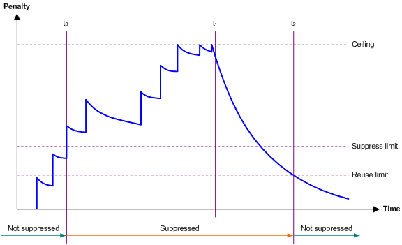

The interface dampening feature uses an exponential decay mechanism to prevent excessive interface flapping events from adversely affecting routing protocols and routing tables in the network. Suppressing interface state change events protects the system resources.
If an interface is not dampened, its state changes are reported. For each state change, the system also generates an SNMP trap and log message.
After a flapping interface is dampened, it does not report its state changes to the CPU. For state change events, the interface only generates SNMP trap and log messages.
Parameters
· Penalty—The interface has an initial penalty of 0. When the interface flaps, the penalty increases by 1000 for each down event until the ceiling is reached. It does not increase for up events. When the interface stops flapping, the penalty decreases by half each time the half-life timer expires until the penalty drops to the reuse threshold.
· Ceiling—The penalty stops increasing when it reaches the ceiling.
· Suppress-limit—The accumulated penalty that triggers the device to dampen the interface. In dampened state, the interface does not report its state changes to the CPU. For state change events, the interface only generates SNMP traps and log messages.
· Reuse-limit—When the accumulated penalty decreases to this reuse threshold, the interface is not dampened. Interface state changes are reported to the upper layers. For each state change, the system also generates an SNMP trap and log message.
· Decay—The amount of time (in seconds) after which a penalty is decreased.
· Max-suppress-time—The maximum amount of time the interface can be dampened. If the penalty is still higher than the reuse threshold when this timer expires, the penalty stops increasing for down events. The penalty starts to decrease until it drops below the reuse threshold.
When configuring the dampening command, follow these rules to set the values mentioned above:
· The ceiling is equal to 2(Max-suppress-time/Decay) × reuse-limit. It is not user configurable.
· The configured suppress limit is lower than or equal to the ceiling.
· The ceiling is lower than or equal to the maximum suppress limit supported.
Figure 1 shows the change rule of the penalty value. The lines t0 and t2 indicate the start time and end time of the suppression, respectively. The period from t0 to t2 indicates the suppression period, t0 to t1 indicates the max-suppress-time, and t1 to t2 indicates the complete decay period.
Figure 1 Change rule of the penalty value
When you configure dampening on an Ethernet interface, follow these restrictions and guidelines:
· The dampening, link-delay, and port link-flap protect enable commands are mutually exclusive on an interface.
· The dampening command does not take effect on the administratively down events. When you execute the shutdown command, the penalty restores to 0, and the interface reports the down event to the upper-layer protocols.
· Do not enable the dampening feature on an interface with RRPP, MSTP, or Smart Link enabled.

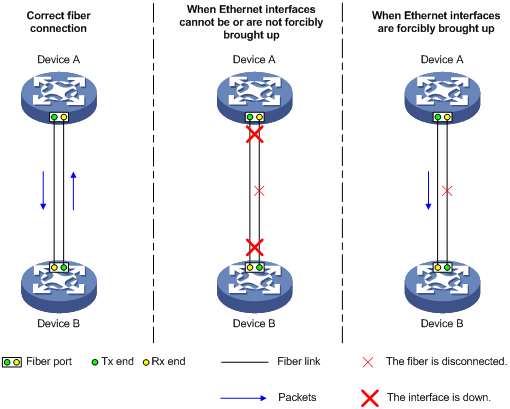

Forcibly bringing up a fiber port
As shown in Figure 2, a fiber port uses separate fibers for transmitting and receiving packets. The physical state of the fiber port is up only when both transmit and receive fibers are physically connected. If one of the fibers is disconnected, the fiber port does not work.
To enable a fiber port to forward traffic over a single link, you can use the port up-mode command. This command forcibly brings up a fiber port, even when no fiber links or transceiver modules are present for the fiber port. When one fiber link is present and up, the fiber port can forward packets over the link unidirectionally.
Figure 2 Forcibly bring up a fiber port
When you forcibly bring up a fiber port, follow these restrictions and guidelines:
· This feature is not supported on interfaces on the following interface modules:
¡ EB interface module: LSU1TGX4EB0.
¡ EC interface modules:
- LSUM1CGC2EC0.
- LSUM1TGS24EC0.
- LSUM1QGS6EC0.
¡ SC interface module: LSU1TGS16SC0.
¡ SE interface modules:
- LSU1TGX4SE0.
- LSU1TGS8SE0.
- LSU1CGC2SE0.
¡ SF interface modules:
- LSUM2TGS16SF0.
- LSU1TGS32SF0.
- LSU1QGS4SF0.
- LSU1TGS48SF0.
- LSU1QGS8SF0.
- LSU1QGC4SF0.
¡ GE interfaces on an LSUM1GP44TSEC0 module.
¡ 10-GE interfaces on an LSU1GP24TXEB0 module.
¡ Interfaces numbered 45 through 48 on the LSUM2GP44TSSE0 and LSUM2GT24PTSSE0 modules.
¡ Interfaces numbered 25 through 28 on the LSUM2GP24TSSE0, LSUM2GP24TSSA0, and LSUM2GT24TSSE0 modules.
· For fiber ports connected to the same physical link to operate correctly, you must configure this feature for both of them.
· The port up-mode, shutdown, and loopback commands are mutually exclusive.
· A fiber Ethernet port does not support this feature if the port is shut down by a protocol or by using the shutdown command.
· A fiber Ethernet port does not support this feature if the port joins an aggregate group.
· Either of the following operations on an interface forcibly brought up will cause the interface to go down before staying physically up:
¡ Configure the speed, duplex, or port fec mode command on the interface.
¡ Remove and install fibers or transceiver modules.
· A GE fiber port forcibly brought up cannot correctly forward traffic if it is installed with a fiber-to-copper converter, 100/1000-Mbps transceiver module, or 100-Mbps transceiver module. To solve the problem, use the undo port up-mode command on the fiber port.
Configuration procedure
To forcibly bring up a fiber port:
Step |
Command |
Remarks |
1. Enter system view. |
system-view |
N/A |
2. Enter Ethernet interface view. |
interface interface-type interface-number |
Copper ports and combo interfaces do not support this feature. |
3. Forcibly bring up the fiber port. |
port up-mode |
By default, a fiber port is not forcibly brought up, and the physical state of a fiber port depends on the physical state of the fibers. |
