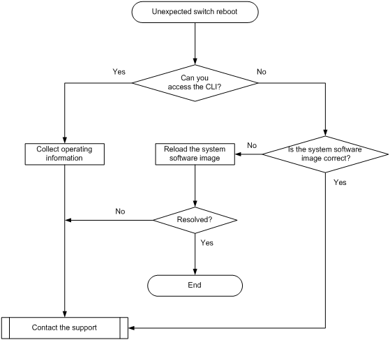

Unexpected switch reboot
Symptom
The switch reboots unexpectedly when it is operating.
Troubleshooting flowchart
Figure 1 Troubleshooting unexpected switch reboot
Solution
To resolve the problem:
1.        Verify that you can access the CLI after the switch reboots.
¡  If you can access the CLI, execute the display diagnostic-information command to collect operating information.
¡  If you cannot access the CLI, go to step 2.
2.        Verify that the system software image on the switch is correct.
Connect to the switch through the console port and restart the switch. If BootWare reports that a CRC error has occurred or that no system software image is available, perform the following steps:
a.    Use the BootWare menu to reload the system software image.
b.    Configure it as the current system software image.
3.        If the problem persists, contact H3C Support.

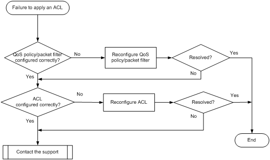

ACL application failure without an error message
Symptom
The system applies a packet filter or an ACL-based QoS policy to the hardware. However, the ACL does not take effect.
Figure 2 Troubleshooting ACL application failure
Solution
Choose a solution depending on the module that uses the ACL.
ACL used in a QoS policy
To resolve the problem when the ACL is used in a QoS policy:
1.        Verify that the QoS policy is configured correctly:
a.    Use one of the following commands to check the QoS policy for configuration errors, depending on the policy application destination:
Destination
Interface
display qos policy interface
VLAN
display qos vlan-policy
Global
display qos policy global
Control plane
display qos policy control-plane slot slot-number
b.    If the QoS policy does not contain a class-behavior association, associate the traffic behavior with the traffic class.
c.    If the QoS policy contains a class-behavior association, execute the display traffic classifier user-defined command and the display traffic behavior user-defined command to check for traffic class and behavior configuration errors, respectively.
-      If they are configured incorrectly, reconfigure them.
-      If they are configured correctly, go to step 2.
2.        Verify that the ACL is configured correctly.
Execute the display acl command to check whether the ACL is configured correctly.
¡  If the ACL is configured incorrectly, reconfigure it.
¡  If the ACL is configured correctly, go to step 3.
ACL used in a packet filter
To resolve the problem when the ACL is used in a packet filter:
1.        Verify that the packet filter is configured correctly.
Execute the display packet-filter command to check whether the packet filter is configured correctly.
¡  If there are any configuration errors, reconfigure the packet filter.
¡  If there is no configuration error, go to step 2.

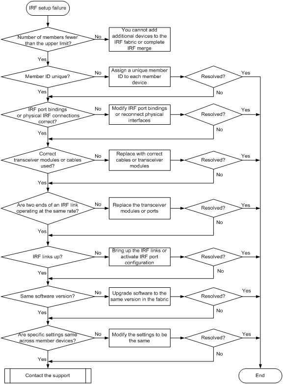

Troubleshooting IRF
This section provides troubleshooting information for common problems with IRF.
IRF fabric setup failure
Symptom
An IRF fabric cannot be set up.
Figure 3 Troubleshooting IRF fabric setup failure
Solution
1.        Verify that the number of member devices does not exceed the upper limit (10).
If you are adding a new member device to an existing IRF fabric or merging IRF fabrics, use the display irf command to identify the number of member devices in the IRF fabrics. If the total number of member devices exceeds the upper limit, the IRF setup will fail.
2.        Verify that the member ID of each member device is unique:
a.    Execute the display irf command to view the member ID of each member device.
b.    Use the irf member renumber command to assign a unique member ID to each member.
-      If you are adding a new member device to an existing IRF fabric, assign the member device a member ID that is not being used in the IRF fabric.
-      If you are merging IRF fabrics, make sure each member device in these IRF fabrics has a unique member ID.
3.        Verify that the IRF port bindings and physical IRF link connections are correct:
a.    Execute the display irf configuration command, and check the IRF-Port1 and IRF-Port2 fields for IRF port bindings.
b.    Verify that the physical interfaces bound to IRF ports are IRF capable. You can use QSFP+ or QSFP28 ports for IRF links. If there are binding errors, reconfigure the IRF port bindings.
IMPORTANT
IMPORTANT:
QSFP28 ports on the LSWM18CQMSEC module cannot be used as IRF physical interfaces.
c.    Verify that the IRF physical interfaces are correct connected. When you connect two neighboring IRF members, you must connect the physical interfaces of IRF-port 1 on one member to the physical interfaces of IRF-port 2 on the other.
4.        Verify that the correct transceiver modules and cables are used:
¡  To connect QSFP+ ports in a long distance, use QSFP+ transceiver modules and fibers.
¡  To connect QSFP+ ports in a short distance, use QSFP+ DAC or AOC cables.
¡  To connect QSFP28 ports in a long distance, use QSFP28 or QSFP+ transceiver modules and fibers.
¡  To connect QSFP28 ports in a short distance, use QSFP28 or QSFP+ DAC or AOC cables.
IMPORTANT
IMPORTANT:
Except the above listed transceiver modules and fibers or cables, do not use any other transceiver modules and fibers or cables to connect IRF physical interfaces on the switch series.
When you use QSFP+ DAC cables to connect IRF physical interfaces, follow these restrictions and guidelines:
¡  The two ends of a physical IRF link must both use fixed ports as IRF physical interfaces or both use ports on interface modules as IRF physical interfaces. Do not connect a fixed port to a port on an interface module for IRF connection. However, you can bind fixed ports and ports on an interface module to the same IRF port.
¡  If you use ports on interface modules as IRF physical interfaces, make sure the interface modules at the two ends of a physical IRF link are the same type.
¡  To use a fixed QSFP28 port on the rear panel of an S6850-2C member as an IRF physical interface, you must make sure its IRF neighbor is also an S6850-2C switch. In addition, you can connect that port only to a fixed QSFP28 port on the rear panel of the neighboring S6850-2C switch.
5.        Verify that the two ends of an IRF link are operating at the same rate.
If you are using transceiver modules and fibers, verify that the transceiver modules at the two ends of an IRF link are the same type. If the transceiver modules are not the same type, replace them to be the same type.
6.        Verify that all IRF links are up:
a.    Execute the display irf topology command, and then check the Link field.
-      If the Link field for each IRF port does not display DOWN, go to step 7.
-      If the Link field for an IRF port displays DOWN, go to step b.
b.    Execute the display irf link command, and then check the Status field of the physical interfaces bound to the IRF port.
-      If the field displays DOWN or ADM (administratively down) for all the physical interfaces, remove the link failures or use the undo shutdown command to bring up the administratively down physical interfaces.
-      If the field displays UP for at least one of the physical interfaces, go to step c.
c.    Save the configuration, and then execute the irf-port-configuration active command in system view to activate the IRF port configuration.
IMPORTANT
IMPORTANT:
Activating IRF port configuration requires a reboot. To prevent configuration loss, you must save the configuration before you execute the irf-port-configuration active command.
7.        Verify that all member devices use the same software version:
a.    Execute the display version command to identify the software version of each member device.
b.    Upgrade the software of all member devices to the same version.
Typically, the irf auto-update enable command can automatically synchronize a member device with the software version of the master device. However, the synchronization might fail when the gap between the software versions is too large. For more information, see the release notes.
8.        Execute display commands to verify that all member devices use the same settings for the following features:
¡  System operating mode (set by using the system-working-mode command).
¡  Hardware resource mode for the MAC address table, ARP and ND tables, and routing tables (set by using the hardware-resource switch-mode command).
¡  Enhanced ECMP mode (set by using the ecmp mode enhanced command).
¡  Support for the IPv6 routes with prefixes longer than 64 bits (set by using the hardware-resource routing-mode ipv6-128 command).
¡  Enabling status of packet loss prevention for OpenFlow forwarding (set by using the openflow lossless enable command).
¡  VXLAN hardware resource allocation mode (set by using the hardware-resource vxlan command).
9.        If the problem persists, contact H3C Support.

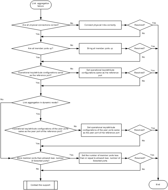

Link aggregation failure
Symptom
Some member ports fail to be placed in Selected state, and link aggregation does not operate correctly.
Figure 4 Troubleshooting link aggregation failure
Solution
1.        Verify that all physical connections are correct.
You can verify the physical connections against your network plan.
2.        Verify that all member ports are up:
a.    Execute the display interface command to display the status of the member ports.
b.    If the member ports are down, follow the solution in "Troubleshooting ports" to troubleshoot the problem.
3.        Verify that the member ports have the same operational key and attribute configurations as the reference port:
a.    Execute the display link-aggregation verbose command to display the Selected state of the member ports.
b.    Execute the display current-configuration interface command to display the configurations of the aggregate interface and the Unselected ports.
c.    Configure the Unselected ports to make sure they have the same operational key and attribute configurations as the reference port.
4.        Identify the aggregation mode of the aggregation group.
¡  If the aggregation mode is static, proceed to step 6.
¡  If the aggregation mode is dynamic, proceed to step 5.
5.        Verify that the peer member ports have the same operational key and attribute configurations as the peer port of the reference port:
a.    Execute the display current-configuration interface command on the peer device to display the configurations of the peer member ports.
b.    Configure the peer member ports to make sure the peer ports have the same operational key and attribute configurations as the peer port of the reference port.
6.        Verify that the number of member ports in the aggregation group does not exceed the configured maximum number of Selected ports.
a.    Execute the link-aggregation selected-port maximum command to set the maximum number of Selected ports allowed in the aggregation group. The value range is 1 to 16.
b.    Execute the display link-aggregation verbose command to verify that the number of member ports does not exceed the configured maximum number of Selected ports.
If the number of member ports exceeds the maximum number of Selected ports, the ports with higher port numbers are in Unselected state.
c.    Use the undo port link-aggregation group command to remove undesired member ports from the aggregation group.
This makes sure all member ports you assign to the aggregation group can become Selected ports.
7.        If the problem persists, contact Hewlett Packard Enterprise Support.

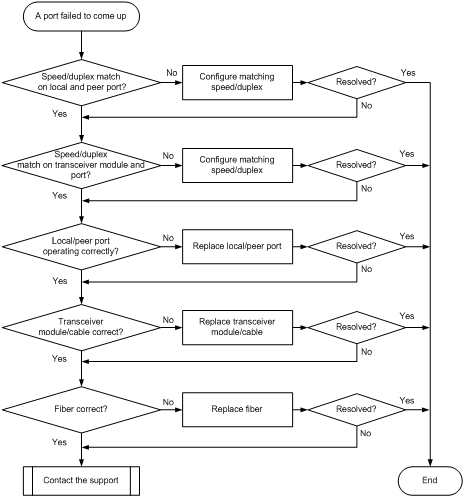

A GE SFP, 10-GE SFP+, 40-GE QSFP+, or 100-GE QSFP28 fiber port fails to come up
Symptom
A GE SFP, 10-GE SFP+, 40-GE QSFP+, or 100-GE QSFP28 fiber port fails to come up.
Figure 5 Troubleshooting link up failure on a fiber port
Solution
1.        Verify that the speed and duplex mode of the local port match the speed and duplex mode of the peer port:
a.    Execute the display interface brief command to examine whether the speed and duplex mode of the port match the speed and duplex mode of the peer port.
b.    If they do not match, use the speed command and the duplex command to set the rate and duplex mode for the port.
2.        Verify that the speed and duplex mode of the local port match the speed and duplex mode of the transceiver module:
a.    Execute the display interface brief command to examine whether the speed and duplex mode of the port match the speed and duplex mode of the transceiver module.
3.        Verify that the ports at both ends are operating correctly:
a.    For an SFP+/QSFP+/QSFP28 fiber port, use an SFP+/QSFP+/QSFP28 cable to directly connect it to another fiber port of the same type on the local end.
b.    Identify whether the port can come up:
-      If the port can come up, you can determine that the peer port fails. Replace the peer port with a new port operating correctly.
-      If the port cannot come up, you can determine that the local port fails. Replace the local port with a new port operating correctly.
4.        Verify that the transceiver module and cable are operating correctly:
a.    Use the display transceiver alarm interface command to check for alarms on the transceiver module:
-      The device displays None if no error has occurred.
-      The device displays alarms if the transceiver module has failed or if the type of the transceiver module does not match the port type.
b.    Use an optical power meter to verify that the Tx power and Rx power of the transceiver module are stable and are within the correct range.
c.    Execute the display transceiver interface command to verify that the local transceiver module has the same wavelength and transmission distance as the peer transceiver module.
d.    If the transceiver module is not operating correctly, replace it with an H3C transceiver module that matches the fiber port.
For more information about transceiver modules and cables, see the installation guide for the switch.
When you use a QSFP+ to SFP+ cable to connect a 40-GE QSFP+ fiber port, you must use an optical attenuator because the Tx optical power of the QSFP+ transceiver module exceeds the upper Rx optical power limit of the SFP+ transceiver module.
5.        Verify that the fiber matches the transceiver module. If they do not match, replace the fiber with a new one that matches the transceiver module.
For more information about fibers, see the installation guide for the switch.
6.        If the problem persists, contact H3C Support.

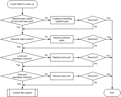

A 10/100/1000Base-T GE copper port or 1/10GBase-T 10-GE copper port fails to come up
Symptom
A 10/100/1000Base-T GE copper port or 1/10GBase-T 10-GE copper port fails to come up.
Figure 7 Troubleshooting link up failure on a copper port
Solution
2.        Replace the network cable with a new one to verify that the network cable is in good condition.
3.        Replace the local port with a new one to verify that the local port is operating correctly.
4.        Replace the peer port with a new one to verify that the peer port is operating correctly.
5.        If the problem persists, contact H3C Support.

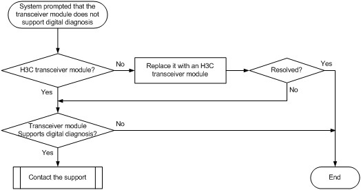

Transceiver module does not support digital diagnosis
Symptom
The output from the display transceiver diagnosis interface command shows that the transceiver module does not support the digital diagnosis function.
<Sysname> display transceiver diagnosis interface twenty-fivegige 1/0/1
The transceiver does not support this function.
Figure 9 Troubleshooting digital diagnosis failure on a transceiver module
Solution
1.        Verify that the transceiver module is an H3C transceiver module:
Execute the display transceiver interface command to view the vendor name of the transceiver module.
¡  If the vendor name field does not display H3C, replace the transceiver module with an H3C transceiver module.
¡  If the vendor name field displays H3C, perform the following tasks:
-      Execute the display transceiver manuinfo interface command to save the transceiver module information.
-      Provide the information to H3C Support to verify that the transceiver module is an H3C transceiver module. If the module is not from H3C, replace it with an H3C transceiver module.
2.        Execute the display transceiver interface command to save the transceiver module information, and contact H3C Support to verify that the transceiver module supports the digital diagnosis function.
<Sysname> display transceiver interface twenty-fivegige 1/0/1
Twenty-FiveGigE 1/0/1 transceiver information:
  Transceiver Type              : 40G_BASE_LR4_QSFP_PLUS
  Connector Type                : LC
  Wavelength(nm)                : 1301
  Transfer Distance(km)         : 10(SMF)
  Digital Diagnostic Monitoring : YES
  Vendor Name                   : H3C
  Ordering Name                 : QSFP-40G-LR4-WDM1300

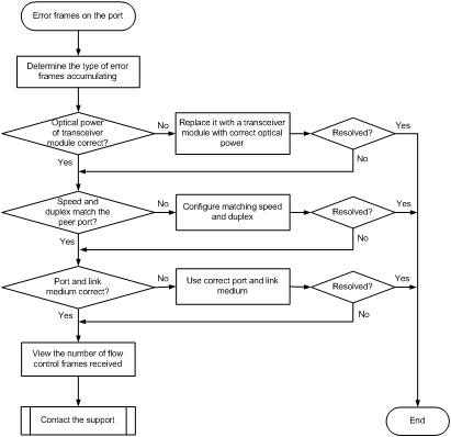

Error frames (for example, CRC errors) on a port
Symptom
The output from the display interface command shows that error frames exist (for example, CRC error frames) on a port.
Figure 10 Troubleshooting error frames (for example, CRC errors) on a port
Solution
1.        Examine the error frame statistics and identify the error frame type:
a.    (Optional.) Use the reset counter interface command in user view to clear the packet statistics of the port.
This command resets all packet counters to 0, so that you can view the statistics changes more clearly.
b.    Use the display interface command to display the incoming packet statistics and outgoing packet statistics of the port.
c.    Determine the type of error frames that are accumulating.
2.        If the port is a fiber port, verify that the optical power of the transceiver module is operating correctly:
a.    Use the display transceiver diagnosis interface command to view the present measured values of the digital diagnosis parameters for the transceiver module.
[Sysname] display transceiver diagnosis interface twenty-fivegige 1/0/1
Twenty-FiveGigE1/0/1 transceiver diagnostic information:
  Current diagnostic parameters:
    Temp.(°C) Voltage(V)  Bias(mA)  RX power(dBm)  TX power(dBm)
    43         3.31        6.23      -6.50          -2.15
  Alarm thresholds:
          Temp(°C)  Voltage(V)  Bias(mA)  RX power(dBM)  TX power(dBM)
    High   75         -63        10.50       2.00           1.50
    Low    -5         2.97        2.00      -13.90         -11
b.    If the optical power of the transceiver module is not within the correct range, replace the transceiver module with a transceiver module of the same model that is operating correctly.
3.        Verify that the port configurations are correct:
a.    Execute the display interface brief command.
b.    Determine whether the speed and duplex mode of the port match the speed and duplex mode of the peer port.
c.    If they do not match, use the speed command and the duplex command to set the speed and duplex mode for the port.
4.        Verify that the link medium connected to the port is operating correctly.
Plug the link medium into a new port that is operating correctly. If error frames still exist, replace the link medium.
5.        Verify that the port is operating correctly:

If error frames do not exist, troubleshoot the remaining possible points of failure on the transmission path. The troubleshooting process is beyond the scope of this document.
6.        Determine whether the port has received a large amount of flow control frames:
a.    Use the display interface command to view the number of pause frames.
If the number of pause frames is accumulating, you can determine that the port has sent or received a large amount of flow control frames.
b.    Verify that the incoming traffic and outgoing traffic have not exceeded the maximum traffic processing capability of the local device and the peer device.
7.        If the problem persists, contact H3C Support.

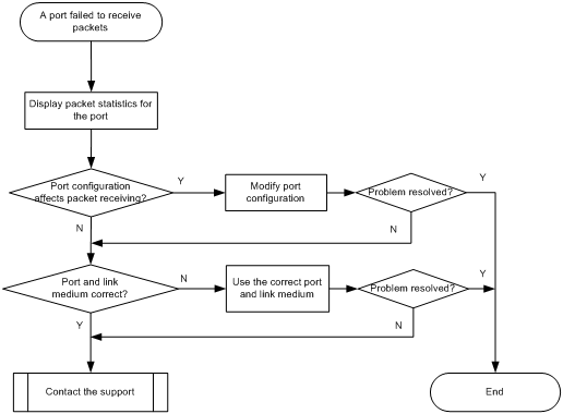

Failure to receive packets
Symptom
A port is up, but it cannot receive packets.
Figure 11 Troubleshooting failure to receive packets
Solution
1.        Verify that the ports at both ends are up.
2.        Examine the packet statistics of the port:
a.    (Optional.) Use the reset counter interface command to clear the packet statistics of the port.
b.    Use the display interface command to verify that the number of incoming packets is accumulating.
c.    Verify that the number of error frames is not accumulating.
If the number of error frames is accumulating, remove the errors. For more information, see "Error frames (for example, CRC errors) on a port."
3.        Verify that the port configurations do not affect packet receiving:
a.    Use the display interface brief command to verify that the port configurations are correct.
The port configurations include the duplex mode, speed, port type, and VLAN configurations of the ports at both ends of the link. If configuration errors exist, modify the port configurations. If the port fails to receive packets, use the shutdown command and then the undo shutdown command to re-enable the port.
b.    If the port is configured with the spanning tree feature, use the display stp brief command to verify that the port is not in the discarding state.
If the port is set to the discarding state by the spanning tree feature, examine and modify the spanning tree feature configurations to resolve the problem.
As a best practice, configure the port as an edge port or disable the spanning tree feature on the port if it is directly connected to a terminal.
c.    If the port is in an aggregation group, use the display link-aggregation summary command to verify that the status of the port is Selected.
If the status of the port is Unselected, the port cannot send or receive data packets. Determine the reasons why the port becomes Unselected, for example, the attribute configurations of the port are different from the reference port. Modify the attribute configurations of the port to make the port become Selected.
Plug the link medium into a new port that is operating correctly. If the new port cannot receive packets, replace the link medium.
¡  If the port is a copper port, connect the port directly to a PC.
¡  If the port is a fiber port, replace the transceiver module in the port.
If the port can receive packets, troubleshoot the remaining possible points of failure on the transmission path. The troubleshooting process is beyond the scope of this document.

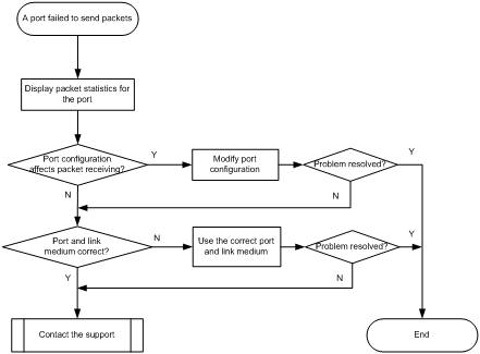

Failure to send packets
Symptom
A port is up, but it cannot send packets.
Figure 12 Troubleshooting failure to send packets
Solution
b.    Use the display interface command to verify that the number of outgoing packets is accumulating.
3.        Verify that the port configurations do not affect packet sending:
The port configurations include the duplex mode, speed, port type, and VLAN configurations of the ports at both ends of the link. If configuration errors exist, modify the port configurations. If the port fails to send packets, use the shutdown command and then the undo shutdown command to re-enable the port.
Plug the link medium into a new port that is operating correctly. If the new port cannot send packets, replace the link medium.
If the port can send packets, troubleshoot the remaining possible points of failure on the transmission path. The troubleshooting process is beyond the scope of this document.

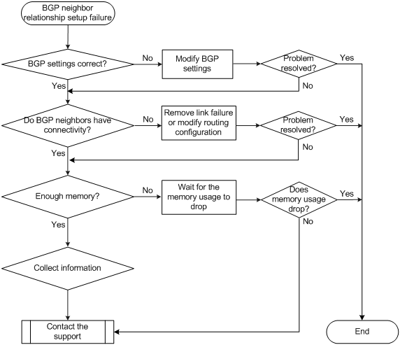

EBGP or IBGP neighbor relationship setup failure
Symptom
Two devices cannot set up an EBGP or IBGP neighbor relationship.
Figure 13 Troubleshooting EBGP or IBGP neighbor relationship setup failure
Solution
1.        Verify that BGP is correctly configured:
a.    Execute the display bgp peer l2vpn evpn command on the devices to view their BGP settings.
b.    Verify that the EBGP or IBGP peers on the devices have matching AS numbers. If the AS numbers do not match, use the peer as-number command to modify the AS numbers.
c.    Verify that the devices use different router IDs. If the devices use the same router ID, use the router-id command to modify the router ID of one device.
2.        Verify that the devices have connectivity:
a.    Verify that one device can ping the other device.
b.    If the ping fails, check for link failure and verify that the devices have routes to each other.
3.        Verify that the memory usage of each device is below the critical alarm threshold:
a.    Execute the display memory-threshold command on each device to view its memory usage.
b.    Verify that the memory usage is below the critical alarm threshold in the last 10 minutes.
c.    If the memory usage stays above the critical alarm threshold, contact Hewlett Packard Enterprise Support.
4.        Perform the following tasks to collect information and contact Hewlett Packard Enterprise Support:
a.    Execute the debugging bgp event command to view possible causes for neighbor relationship setup failure, such as connection setup errors and connection conflicts.
b.    Execute the debugging bgp open command to view errors in OPEN message transmission and receipt.
c.    Execute the debugging tcp packet command to view TCP packet exchange failure.
d.    Execute the display bgp peer l2vpn evpn verbose command to view neighbor address family negotiation information and packet transmission and receipt history.
e.    Execute the display bgp peer l2vpn evpn log-info command to view neighbor status changes and neighbor down reasons.
f.     Execute the display system internal bgp peer l2vpn evpn session statistics command to view session status details.

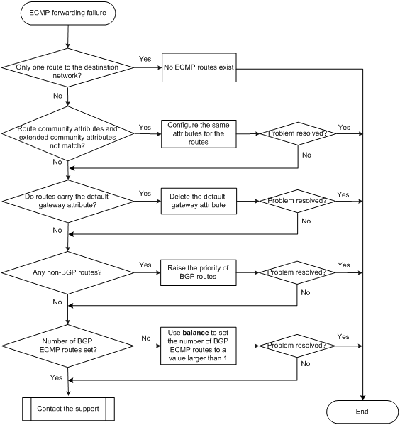

ECMP forwarding failure
Symptom
In an EVPN network, the device cannot forward packets through ECMP routes.
Figure 14 Troubleshooting ECMP forwarding failure
Solution
1.        Verify that the device has routes to the destination network:
a.    Execute the display bgp l2vpn evpn route-distinguisher route-type ip-prefix command.
b.    Verify that the device has routes to the destination network.
The routes must have the same RD and different next hops. If only one route exists, ECMP forwarding cannot be performed.
2.        Verify that the routes have the same community attributes and extended community attributes:
a.    Execute the display bgp l2vpn evpn route-distinguisher route-distinguisher evpn-route route-length command.
b.    Verify that the routes have the same BGP community attributes and extended community attributes.
c.    If the routes have different BGP community attributes and extended community attributes, modify the attributes.
3.        Verify that the routes do not have the default-gateway attribute:
b.    Verify that the routes do not have the default-gateway attribute. Routes with this attribute cannot act as ECMP routes.
c.    If the routes have the default-gateway attribute, delete the attribute.
4.        Verify that the routes are all BGP routes:
a.    Execute the display ip routing-table vpn-instance command.
b.    Verify that the routes are all BGP routes.
c.    If some of the routes are from other protocols, raise the priority of BGP routes by using the preference command.
5.        Verify that the number of BGP ECMP routes is larger than one:
a.    Execute the display bgp routing-table ipv4 vpn-instance command to verify that multiple routes have the same prefix.
b.    If one of the routes that have the same prefix has the optimal sign (>), execute the display current-configuration configuration bgp command to verify that the balance command has been executed in BGP-VPN IPv4 unicast address family view.
c.    If the balance command is not executed, use it to set the number of BGP ECMP routes to a value larger than 1.
6.        If the problem persists, contact Hewlett Packard Enterprise Support.

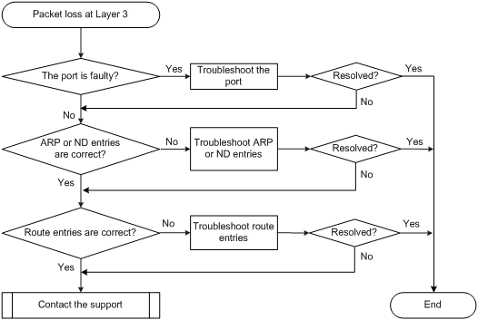

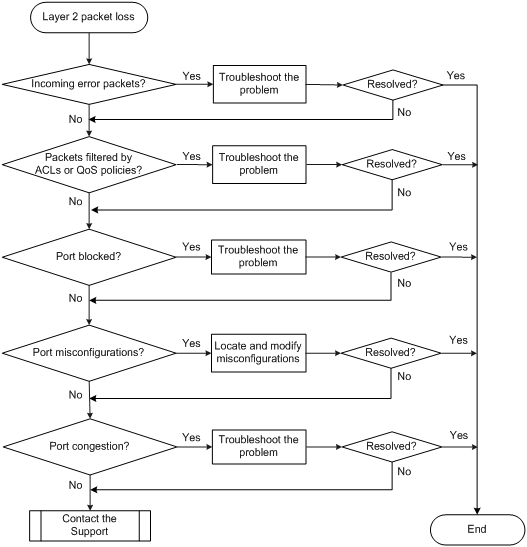

Layer 2 forwarding failure
Symptom
Layer 2 packet loss occurs when the switch forwards packets to a peer on the same network segment and in the same VLAN.
Figure 17 Troubleshooting Layer 2 packet loss failure
Solution
1.        Verify that no error packets have been received on the local port:
a.    Execute the display interface command and check for error packets.
<Sysname>display interface hundredgige 1/0/32
HundredGigE1/0/32 current state: UP
Line protocol state: UP
IP Packet Frame Type: PKTFMT_ETHNT_2, Hardware Address: 000f-e200-002b
Last 300 seconds input:  0 packets/sec 10 bytes/sec 0%
 Last 300 seconds output:  0 packets/sec 10 bytes/sec 0%
 Input (total):  1438 packets, 480292 bytes
          0 unicasts, 0 broadcasts, 1438 multicasts, 0 pauses
 Input (normal):  1438 packets, - bytes
 Input:  0 input errors, 0 runts, 0 giants, 0 throttles
          0 CRC, 0 frame, - overruns, 0 aborts
          - ignored, - parity errors
 Output (total): 1440 packets, 475200 bytes
          0 unicasts, 0 broadcasts, 1440 multicasts, 0 pauses
 Output (normal): 1440 packets, - bytes
 Output: 0 output errors, - underruns, - buffer failures
          0 aborts, 0 deferred, 0 collisions, 0 late collisions
          0 lost carrier, - no carrier
b.    If the statistics are not zero, the following failures might occur:
-      Interface hardware failure—To test such a failure, connect the cable that is connected to the local port to a correctly operating port (for example, Port A) with the same configurations as the local port. If Port A forwards traffic correctly, you can determine that the hardware of the local port fails. In this event, you must replace the local port with a correctly operating port.
-      Transceiver module, fiber, or twisted pair failure—To test and resolve such a failure, replace the transceiver module, fiber, or twisted pair with a good one.
-      Inconsistent configurations—Verify that the configurations (including speed and duplex mode) of the peer are consistent with the local port. If they are inconsistent, modify the configurations of the local port.
c.    If the problem persists, contact Hewlett Packard Enterprise Support.

2.        Verify that packets are not mistakenly filtered out by ACLs:
a.    Examine the ACL and QoS policy configurations for packet filtering on the port, on the VLAN of the port, or globally. If packets are mistakenly filtered out, modify the ACL or QoS policy configuration.
-      To display the ACL configuration on the port for packet filtering, execute the display packet-filter command.
-      To display the QoS policy configuration on the port, execute the display qos policy command.
-      To display the QoS policy configuration on the VLAN of the port, execute the display qos vlan-policy command.
-      To display the global QoS policy configuration, execute the display qos policy global command.
b.    Verify that packets are not filtered out by ACLs automatically created by some features.
-      Execute the display this command in Ethernet interface view to verify that the ip source binding or ip verify source command is configured on the port. To display source guard binding entries, execute the display ip source binding or display ipv6 source binding command. If IP source guard is configured but the packets match no entry, further troubleshoot the problem based on the way the binding entries are created.
-      Determine whether the port is configured with the portal authentication. Packets of users that fail to pass the portal authentication will be dropped by the port. Use the display portal interface command to display the portal configuration information of the specified VLAN interface. Determine whether the portal authentication can be disabled based on the network conditions. To disable the portal authentication at Layer 3, use the undo portal server server-name command in VLAN interface view of the VLAN to which the port belongs.
3.        Verify that the port is not blocked:
¡  Execute the display stp brief command to verify that STP does not set the state of the port to discarding. When the port is in discarding state, it cannot forward traffic. Hewlett Packard Enterprise recommends disabling STP on the port, or configuring the port as an edge port if the port is connected to a terminal device.
¡  If the port belongs to an aggregation group, execute the display link-aggregation verbose command to identify the port status. When the port is an Unselected port, it cannot forward traffic. Locate the reasons why the port is in Unselected state. For example, the attribute configurations of the port are different from the configurations of the reference port.
¡  Identify whether the port is blocked by smart link. Use the display smart-link group command to view the port status. If the state of the port is STANDBY or DOWN, the port cannot forward traffic.
-      If the state of the port is DOWN, locate the reason for the port to be down. The possible reasons include: its uplink device is configured with monitor link, the link of the port fails, or the port is shut down. Further troubleshoot the problem based on the reason for the port to be down.
-      If the state of the port is STANDBY, perform an active/standby switchover in the smart link group.
4.        Examine the following configurations that might cause packet loss:
¡  VLAN configuration—Execute the display this command in Ethernet interface view to verify that the port is in the VLAN of the packets. If it is not, add the port to the VLAN.
¡  Blackhole MAC address entriesExecute the display mac-address blackhole command to display blackhole MAC address entries. If the packets are discarded because they match a blackhole MAC address entry, delete the entry. To delete the blackhole MAC address entry, execute the undo mac-address blackhole mac-address vlan vlan-id command.
¡  Rate limitExecute the display qos lr interface command to display the rate limit configuration on the port. If rate limit is configured on the port, make sure the committed information rate (CIR) and the committed burst size (CBS) are appropriate. To adjust the CIR and CBS values, execute the qos lr { inbound | outbound } cir committed-information-rate [ cbs committed-burst-size ] command.

Layer 3 forwarding failure
Symptom
Packet loss occurs when the switch forwards packets to a different network.
Figure 18 Troubleshooting Layer 3 forwarding failure
Solution
1.        Verify that the port is not faulty (due to hardware or configuration problems).
If the port is faulty, follow the solution in "Layer 2 forwarding failure" to troubleshoot the problem.
2.        Verify that ARP entries are correct if Layer 3 forwarding is based on IPv4:
a.    Execute the display arp command to verify that ARP entries are correct.
-      If incorrect ARP entries exist, execute the debugging arp packet command to locate the problem.
-      If the switch learns no ARP entries, execute the arp static command to configure static ARP entries.
b.    Execute the display mac-address command to verify that the output interfaces in the MAC address entries and ARP entries are the same.
If the output interfaces are different, execute the reset arp command to clear the ARP entries. Then the switch can learn ARP entries again.
3.        Verify that ND entries are correct if Layer 3 forwarding is based on IPv6:
a.    Execute the display ipv6 neighbors command to verify that ND entries are correct.
-      If incorrect ND entries exist, execute the debugging ipv6 icmp command to locate the problem.
-      If the switch learns no ND entries, execute the ipv6 neighbor command to configure static ND entries.
b.    Execute the display mac-address command to verify that the output interfaces in the MAC address entries and ND entries are the same.
If the output interfaces are different, execute the reset ipv6 neighbors command to clear the ND entries. Then the switch can learn ND entries again.
4.        Verify that route entries are correct:
a.    Execute the display ip routing-table command to verify that route entries are correct.
If incorrect route entries exist, troubleshoot the protocol that learns the route entries.
b.    Execute the display fib command to verify that the output interfaces in the FIB entries and route entries are the same.
If the output interfaces are not the same, execute the reset command to clear the route entries. Then the switch can learn route entries again.
5.        If the problem persists, contact Hewlett Packard Enterprise Support.

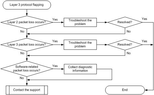

Protocol flapping
Symptom
The switch cannot send or receive protocol packets.
Figure 19 Troubleshooting protocol flapping
Solution
1.        Verify that Layer 2 is operating correctly, as described in "Layer 2 forwarding failure."
2.        Verify that Layer 3 is operating correctly, as described in "Layer 3 forwarding failure."
3.        Check for software-related packet loss.
[Sysname-probe] debug rxtx softcar show slot 1
ID  Type                RcvPps PpsMax Rcv_All    DisPkt_All Pps  Dyn Swi Hash AC
Lmax
0   ROOT                0      0      0          0          3000 S   On  SMAC 0
1   ISIS                0      0      0          0          2000 D   On  SMAC 8
2   ESIS                0      0      0          0          600  S   On  SMAC 8
3   CLNP                0      0      0          0          1000 S   On  SMAC 8
4   VRRP                0      0      0          0          2000 S   On  SMAC 8
5   UNKNOWN_IPV4MC      0      0      0          0          600  S   On  SMAC 8
6   UNKNOWN_IPV6MC      0      0      0          0          600  S   On  SMAC 8
7   IPV4_MC_RIP         0      0      0          0          1000 D   On  SMAC 8
8   IPV4_BC_RIP         0      0      0          0          1000 D   On  SMAC 8
4.        If the problem persists, contact Hewlett Packard Enterprise Support.
