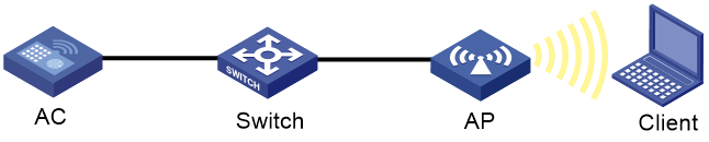

Bandwidth guaranteeing
This feature provides the following functions:
·     Ensures that traffic from all BSSs can pass through freely when the network is not congested.
·     Ensures that each BSS can get the guaranteed bandwidth when the network is congested.
This feature improves bandwidth efficiency and maintains fair use of bandwidth among WLAN services. For example, you assign SSID1, SSID2, and SSID3 25%, 25%, and 50% of the total bandwidth. When the network is not congested, SSID1 can use all idle bandwidth in addition to its guaranteed bandwidth. When the network is congested, SSID1 is guaranteed with 25% of the bandwidth.
This feature applies only to AP-to-client traffic.

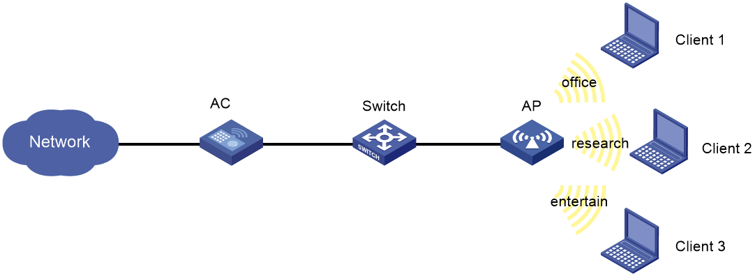

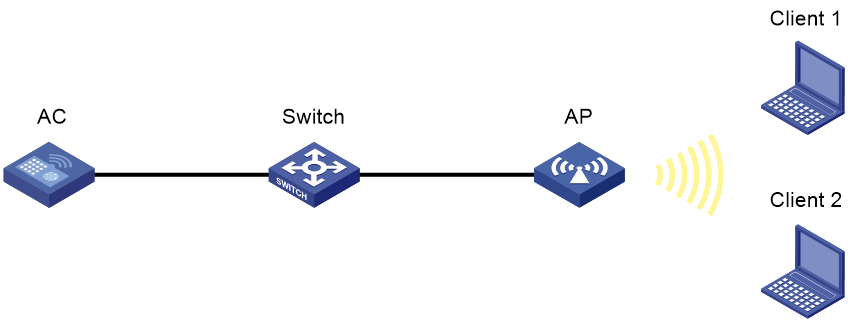

Client rate limiting
This feature prevents aggressive use of bandwidth by one client and ensures fair use of bandwidth among clients associated with the same AP.
You can configure either of the following modes for client rate limiting:
·     Dynamic mode—Sets the total bandwidth shared by all clients. The rate limit for each client is the total rate divided by the number of online clients. For example, if the total rate is 10 Mbps and five clients are online, the rate limit for each client is 2 Mbps.
·     Static mode—Sets the bandwidth that can be used by each client. When the rate limit multiplied by the number of associated clients exceeds the available bandwidth provided by the AP, the clients might not get the set bandwidth.

Example: Configuring CAC
As shown in Figure 3, configure CAC to allow a maximum of 10 clients to use the AC-VO and AC-VI queues.
Figure 3 Network diagram
1.     Create a service template named market, set the SSID to market, and enable the service template.
<AC> system-view
[AC] wlan service-template market
[AC-wlan-st-market] ssid market
[AC-wlan-st-market] service-template enable
[AC-wlan-st-market] quit
2.     Create a manual AP named ap1, and specify the AP model and serial ID.
[AC] wlan ap ap1 model WA4320i-ACN
[AC-wlan-ap-ap1] serial-id 210235A29G007C000020
3.     Configure WMM:
# Bind service template market to radio 1.
[AC-wlan-ap-ap1] radio 1
[AC-wlan-ap-ap1-radio-1] service-template market
# Enable WMM for AC-VO and AC-VI queues, and configure a CAC policy to limit the number of clients to 10.
[AC-wlan-ap-ap1-radio-1] wmm enable
[AC-wlan-ap-ap1-radio-1] edca client ac-vo cac enable
[AC-wlan-ap-ap1-radio-1] edca client ac-vi cac enable
[AC-wlan-ap-ap1-radio-1] cac policy client 10
# Enable radio 1.
[AC-wlan-ap-ap1-radio-1] radio enable
# Assume that a client requests to use a high-priority AC queue (AC-VO or AC-VI). Verify the following information:
·     If the number of clients using high-priority AC queues is smaller than the maximum number of high-priority AC clients (10 in this example), the request is accepted.
·     If the number of clients using high-priority AC queues is equal to the maximum number of high-priority AC clients (10 in this example), the request is rejected. The AP decreases the priority of packets from the client.

Example: Configuring bandwidth guaranteeing
As shown in Figure 6, Clients 1, 2, and 3 access the network through SSIDs research, office, and entertain, respectively.
For the network to operate correctly, guarantee 20% of the bandwidth for SSID office, 80% for research, and none for entertain.
Figure 6 Network diagram
# Create a service template named office, set the SSID to office, and enable the service template.
<AC> system-view
[AC] wlan service-template office
[AC-wlan-st-office] ssid office
[AC-wlan-st-office] service-template enable
[AC-wlan-st-office] quit
# Create a service template named research, set the SSID to research, and enable the service template.
[AC] wlan service-template research
[AC-wlan-st-research] ssid research
[AC-wlan-st-research] service-template enable
[AC-wlan-st-research] quit
# Create a service template named entertain, set the SSID to entertain, and enable the service template.
[AC] wlan service-template entertain
[AC-wlan-st-entertain] ssid entertain
[AC-wlan-st-entertain] service-template enable
[AC-wlan-st-entertain] quit
# Set the maximum bandwidth to 10000 Kbps for the 802.11ac radio.
[AC] wlan max-bandwidth dot11ac 10000
# Create a manual AP named ap1, and specify the AP model and serial ID.
[AC-wlan-ap-ap1] serial-id 210235A1BSC123000050
# Set the radio mode to dot11ac for radio 1, bind the service templates office, research, and entertain to radio 1, and enable radio 1.
[AC-wlan-ap-ap1-radio-1] type dot11ac
[AC-wlan-ap-ap1-radio-1] service-template office
[AC-wlan-ap-ap1-radio-1] service-template research
[AC-wlan-ap-ap1-radio-1] service-template entertain
# Enable bandwidth guaranteeing.
[AC-wlan-ap-ap1-radio-1] bandwidth-guarantee enable
# Set the guaranteed bandwidth percentage to 20% for the service template office and 80% for service template research.
[AC-wlan-ap-ap1-radio-1] bandwidth-guarantee service-template office percent 20
[AC-wlan-ap-ap1-radio-1] bandwidth-guarantee service-template research percent 80
[AC-wlan-ap-ap1-radio-1] return
# Verify that the rate of traffic from the AP to any client is not limited when the total traffic rate is lower than 10000 Kbps.
# Send traffic from the AP to Client 1 and Client 2 at a rate of over 2000 Kbps and over 8000 Kbps, respectively, to verify the following items:
·     The AP sends traffic to Client 1 at 2000 Kbps.
·     The AP sends traffic to Client 2 at 8000 Kbps.
·     The rate of traffic from the AP to Client 3 is limited.
Example: Configuring service-template-based client rate limiting
As shown in Figure 7, the AC is in the same network as the AP. Perform the following tasks on the AC:
·     Configure static mode client rate limiting to limit the rate of incoming client traffic.
·     Configure dynamic mode client rate limiting to limit the rate of outgoing client traffic.
Figure 7 Network diagram
# Create a service template named service, and set its SSID to service.
<AC> system-view
[AC] wlan service-template service
[AC-wlan-st-service] ssid service
# Limit the rate of incoming traffic to 8000 Kbps in static mode, and limit the rate of outgoing traffic to 8000 Kbps in dynamic mode.
[AC-wlan-st-service] client-rate-limit inbound mode static cir 8000
[AC-wlan-st-service] client-rate-limit outbound mode dynamic cir 8000
[AC-wlan-st-service] service-template enable
[AC-wlan-st-service] quit
# Bind service template service to radio 1, and enable radio 1.
[AC-wlan-ap-ap1-radio-1] service-template service
