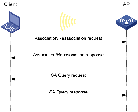

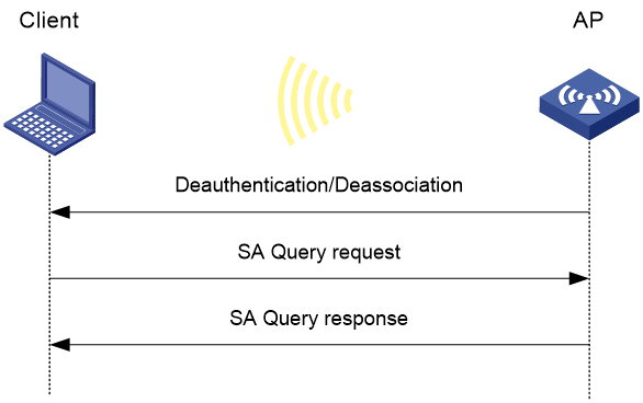

Open system authentication
Open system authentication is the default and simplest authentication algorithm. Any client that requests authentication by using this algorithm can pass the authentication.
Open system authentication uses the following process:
1.     The client sends an authentication request to the AP.
2.     The AP sends an authentication response to the client after the client passes the authentication.
Figure 1 Open system authentication process

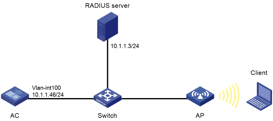

Shared key authentication
Shared key authentication uses a WEP key for the AP and client to complete authentication.
Shared key authentication uses the following process:
2.     The AP randomly generates a challenge text and sends it to the client.
3.     The client uses the WEP key to encrypt the challenge text and sends it to the AP.
4.     The AP uses the WEP key to decrypt the challenge text and compares the decrypted challenge text with the original challenge text. If they are identical, the client passes the authentication. If they are not, the authentication fails.
Figure 2 Shared key authentication process

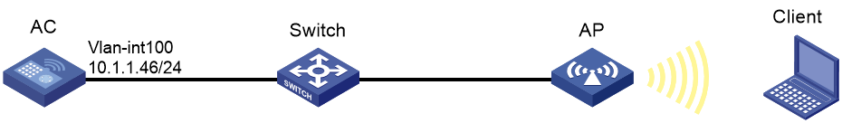

802.11i mechanism
IMPORTANT
IMPORTANT:
802.11i requires open system authentication for link layer authentication.
Security modes
The 802.11i mechanism (the RSNA mechanism) provides WPA and RSN security modes. WPA implements a subset of an 802.11i draft to provide enhanced security over WEP and RSN implements the full 802.11i.
AKM
The 802.11i mechanism uses the following authentication and key management (AKM) modes for authenticating user integrity and dynamically generating and updating keys:
·     802.1X—802.1X performs user authentication and generates the pairwise master key (PMK) during authentication. The client and AP use the PMK to generate the pairwise transient key (PTK).
·     Private PSK—The MAC address of the client is used as the PSK to generate the PMK. The client and AP use the PMK to generate the PTK.
·     PSK—The PSK is used to generate the PMK. The client and AP use the PMK to generate the PTK.
Authentication
802.1X authentication is more secure than PSK authentication.
PSK authentication requires the same PSK to be configured for both an AP and a client. PSK integrity is verified during the four-way handshake. If PTK negotiation succeeds, the client passes the authentication.

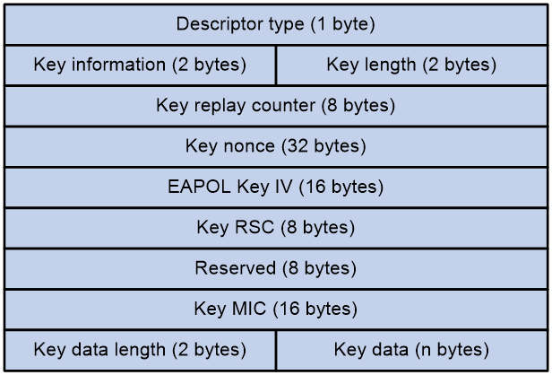

EAPOL-Key packet
The IEEE 802.11i protocol uses EAPOL-Key packets during key negotiation.
Figure 3 EAPOL-Key structure
Table 1 EAPOL-Key field description
Field
Description
Descriptor type
Specifies the network type:
·     WPA network.
·     RSN network.
Key information
For more information about this field, see Table 2.
Key length
Length of the key.
Key replay counter
Records the total number of GTK updates to prevent replay attacks.
The AP sets this field to 0 at the beginning of the negotiation and increments the value on each successive EAPOL-Key frame.
The client records this field from the last valid EAPOL-Key frame that it received if this field is greater than the field recorded previously.
EAPOL-Key frame retransmission is required in the following situations:
·     The field received by the client is smaller than or equal to the field recorded by the client.
·     The field received by the AP is not equal to the field recorded on the AP.
If the retransmission attempts exceed the maximum number, the AP disconnects the client.
Key nonce
Random value used to generate the PTK.
EAPOL Key IV
Encrypts the TKIP. This field is valid only when the encryption type is not CCMP.
Key RSC
Records the total number of multicast packets or broadcast packets to prevent replay attacks. The AP increments the value of this field on transmission of each multicast or broadcast packet.
Reserved
Reserved field.
Key MIC
Message integrity check.
Key data length
Length of the key data.
Key data
Data to be transmitted, such as the GTK and pairwise master key identifier (PMKID).
Figure 4 Key information structure

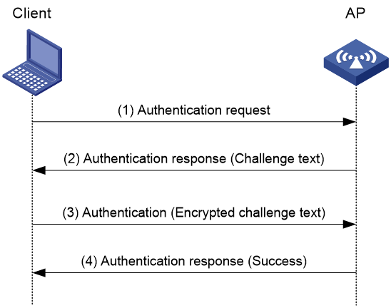

WPA key negotiation
WPA uses EAPOL-Key packets in the four-way handshake to negotiate the PTK, and in the two-way handshake to negotiate the GTK.
Figure 5 WPA key negotiation process
WPA key negotiation uses the following process:
1.     The AP sends the client EAPOL-Key message 1 that contains a random value ANonce.
2.     The client performs the following operations:
a.     Uses the random value SNonce, ANonce, and PMK to generate a PTK by using the key derivation function (KDF).
b.     Uses the KCK in the PTK to generate the MIC.
c.     Returns EAPOL-Key message 2 that contains the SNonce and MIC.
3.     The AP performs the following operations:
a.     Uses the SNonce, ANonce, and PMK to generate a PTK by using the KDF.
c.     Compares the received MIC with the local MIC.
d.     Returns EAPOL-Key message 3 that contains the PTK installation request tag and MIC if the two MICs are the same.
4.     The client performs the following operations:
a.     Compares the received MIC with the local MIC.
b.     Installs the PTK and returns EAPOL-Key message 4 that contains the MIC if the two MICs are the same.
5.     The AP performs the following operations:
b.     Installs the PTK and generates a GTK with the GMK and MAC address of the AP by using the KDF if the two MICs are the same.
c.     Returns EAPOL-Key group message 1 that contains the GTK and MIC.
6.     The client performs the following operations:
a.     Installs the GTK if the two MICs are the same.
b.     Returns EAPOL-Key group message 2 that contains the MIC.
7.     The AP performs the following operations:
b.     Installs the GTK if the MICs are the same.

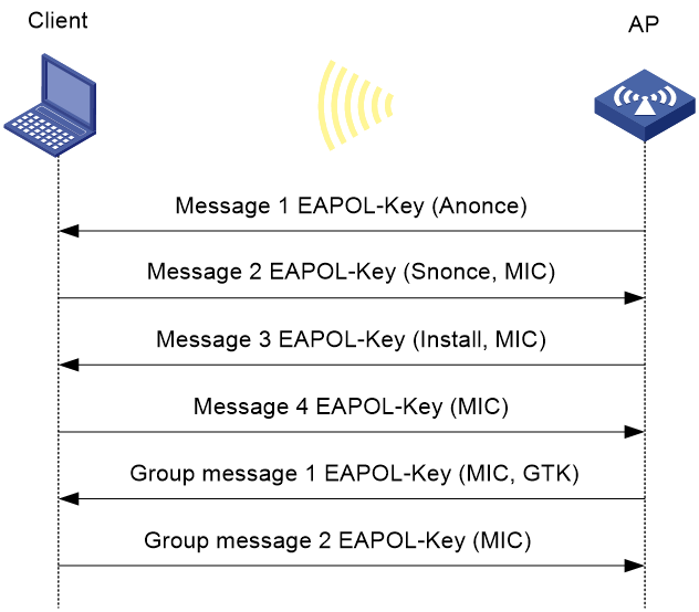

RSN key negotiation
RSN uses EAPOL-Key packets in the four-way handshake to negotiate the PTK and the GTK.
Figure 6 RSN key negotiation process
RSN key negotiation uses the following process:
a.     Uses the random value SNonce, ANonce, and PMK to generate a PTK by using the KDF.
d.     Generates a GTK with the random GMK and MAC address of the AP by using the KDF if the two MICs are the same.
e.     Returns EAPOL-Key message 3 that contains the key installation request tag, MIC, and GTK.
b.     Installs the PTK and GTK if the two MICs are the same.
c.     Returns EAPOL-Key message 4 that contains the MIC.

The security association (SA) query mechanism is used to enhance security if the AP and client negotiate to use management frame protection. SA queries include active SA queries and passive SA queries.
Active SA query
As shown in Figure 7, active SA query uses the following process:
1.     The client sends an association or reassociation request to the AP.
2.     Upon receiving the request, the AP sends a response to inform the client that the request is denied and the client can associate at a later time. The response contains the association comeback time.
3.     The AP sends an SA query request to verify the status of the client:
¡     If the AP receives an SA query response within the timeout time, it considers the client online.
¡     If the AP does not receive an SA query response within the timeout time, it sends another SA query request. If the AP receives an SA query response within the retransmission time, it considers the client online. The AP does not respond to any association or reassociation requests from the client until the association comeback time times out.
¡     If the AP does not receive an SA query response within the retransmission time, it considers the client offline and allows the client to reassociate.
Figure 7 Active SA query process
Passive SA query
As shown in Figure 8, passive SA query uses the following process:
1.     The client triggers the SA query process upon receiving an unencrypted disassociation or deauthentication frame.
2.     The client sends an SA query request to the AP.
3.     The AP sends an SA query response to the client:
¡     If the client receives the response, the client determines that the AP is online and does not process the disassociation or deauthentication frame.
¡     If the client does not receive a response, the client determines that the AP is offline and disassociates with the AP.
Figure 8 Passive SA query process

Example: Configuring shared key authentication
As shown in Figure 9, the switch functions as a DHCP server to assign IP addresses to the AP and client. Configure shared key authentication to enable the client to access the network by using WEP key 12345.
Figure 9 Network diagram
# Create a WLAN service template named service1.
<AC> system-view
[AC] wlan service-template service1
# Specify an SSID of service for the service template.
[AC-wlan-st-service1] ssid service
# Configure a WEP40 plaintext key of 12345 as WEP key 2, and apply WEP key 2.
[AC-wlan-st-service1] cipher-suite wep40
[AC-wlan-st-service1] wep key 2 wep40 pass-phrase simple 12345
[AC-wlan-st-service1] wep key-id 2
# Enable service template service1.
[AC-wlan-st-service1] service-template enable
[AC-wlan-st-service1] quit
# Create an AP named ap1 and specify the model and serial ID.
[AC] wlan ap ap1 model WA6320
[AC-wlan-ap-ap1] serial-id 219801A28N819CE0002T
# Bind service template service1 to radio 1 of the AP and enable radio 1.
[AC-wlan-ap-ap1] radio 1
[AC-wlan-ap-ap1-radio-1] service-template service1
[AC-wlan-ap-ap1-radio-1] radio enable
[AC-wlan-ap-ap1-radio-1] return
# Use the display wlan service-template command to verify that the WLAN service template has been configured correctly.
<AC> display wlan service-template service1 verbose
Service template name        : service1
Description                  : Not configured
SSID                         : service
SSID-hide                    : Disabled
User-isolation               : Disabled
Service template status      : Enabled
Maximum clients per BSS      : 64
Frame format                 : Dot3
Seamless roam status         : Disabled
Seamless roam RSSI threshold : 50
Seamless roam RSSI gap       : 20
VLAN ID                      : 1
AKM mode                     : Not configured
Security IE                  : Not configured
Cipher suite                 : WEP40
WEP key ID                   : 2
TKIP countermeasure time     : 0
PTK lifetime                 : 43200 sec
PTK rekey                    : Enabled
GTK rekey                    : Enabled
GTK rekey method             : Time-based
GTK rekey time               : 86400 sec
GTK rekey client-offline     : Enabled
WPA3 status                  : Disabled
PPSK                         : Disabled
PPSK Fail Permit             : Enabled
User authentication mode          : Bypass
Intrusion protection         : Disabled
Intrusion protection mode    : Temporary-block
Temporary block time         : 180 sec
Temporary service stop time  : 20 sec
Fail VLAN ID                 : Not configured
802.1X handshake             : Disabled
802.1X handshake secure      : Disabled
802.1X domain                : Not configured
MAC-auth domain              : Not configured
Max 802.1X users per BSS     : 4096
Max MAC-auth users per BSS   : 4096
802.1X re-authenticate       : Disabled
Authorization fail mode      : Online
Accounting fail mode         : Online
Authorization                : Permitted
Key derivation               : N/A
PMF status                   : Disabled
Hotspot policy number        : Not configured
Forwarding policy status     : Disabled
Forward policy name          : Not configured
Forwarder                    : AC
FT status                    : Disabled
QoS trust                    : Port
QoS priority                 : 0
BTM status                   : Disabled
Example: Configuring PSK authentication and bypass authentication
As shown in Figure 10, the switch functions as a DHCP server to assign IP addresses to the AP and client.
·     Configure open system authentication and bypass authentication.
·     Configure the client to use preshared key 12345678 to access the network.
Figure 10 Network diagram
1.     Create a WLAN service template named service1.
<AC> system-view
2.     Specify an SSID of service for the service template.
3.     Configure WLAN security for service template service1:
# Configure the PSK AKM mode and the 12345678 plaintext key.
[AC-wlan-st-service1] akm mode psk
[AC-wlan-st-service1] preshared-key pass-phrase simple 12345678
# Configure CCMP as the cipher suite and RSN as the security IE.
[AC-wlan-st-service1] cipher-suite ccmp
[AC-wlan-st-service1] security-ie rsn
4.     Enable service template service1.
5.     Create an AP named ap1 and specify the model and serial ID.
6.     Bind service template service1 to radio 1 of the AP and enable radio 1.
SSID                         : service
Frame format                 : Dot3
VLAN ID                      : 1
AKM mode                     : PSK
Security IE                  : RSN
Cipher suite                 : CCMP
PTK rekey                    : Enabled
GTK rekey                    : Enabled
PPSK                         : Disabled
Forwarder                    : AC
QoS trust                    : Port
QoS priority                 : 0
Example: Configuring PSK authentication and MAC authentication
As shown in Figure 11, the switch functions as a DHCP server to assign IP addresses to the AP and client.
·     Configure open system authentication and MAC authentication so that the client can access the network by using login username abc and password 123.
Figure 11 Network diagram
1.     Configure a username of abc and a password of 123 on the RADIUS server and make sure the RADIUS server and AC can reach each other. (Details not shown.)
2.     Create a WLAN service template named service1.
<AC> system-view
3.     Specify an SSID of service for the service template.
4.     Configure WLAN security for service template service1:
# Configure CCMP as the cipher suite and WPA as the security IE.
[AC-wlan-st-service1] security-ie wpa
# Configure MAC authentication.
[AC-wlan-st-service1] client-security authentication-mode mac
5.     Enable service template service1.
6.     Configure a RADIUS scheme:
# Create a RADIUS scheme named radius1 and enter its view.
[AC] radius scheme radius1
# Specify the primary authentication server and accounting server.
[AC-radius-radius1] primary authentication 10.1.1.3 1812
[AC-radius-radius1] primary accounting 10.1.1.3 1813
# Set the shared keys for authentication and accounting to 12345678 in plaintext.
[AC-radius-radius1] key authentication simple 12345678
[AC-radius-radius1] key accounting simple 12345678
# Set the format for the usernames sent to the RADIUS server based on the RADIUS server configuration:
¡     Exclude domain names from the usernames sent to the RADIUS server.
[Device-radius-rs1] user-name-format without-domain
[Device-radius-rs1] quit
¡     Include domain names in the usernames sent to the RADIUS server.
[Device-radius-rs1] user-name-format with-domain
7.     Create an ISP domain named dom1 and configure a RADIUS scheme for the ISP domain.
[AC] domain dom1
[AC-isp-dom1] authentication lan-access radius-scheme radius1
[AC-isp-dom1] authorization lan-access radius-scheme radius1
[AC-isp-dom1] accounting lan-access radius-scheme radius1
[AC-isp-dom1] quit
8.     Configure an ISP domain of dom1, a username of abc, and password 123 for the user.
[AC] mac-authentication mac domain dom1
[AC] mac-authentication user-name-format fixed account abc password simple 123
9.     Create an AP named ap1 and specify the model and serial ID.
10.     Bind service template service1 to radio 1 of the AP and enable radio 1.
For more information about the AAA and RADIUS commands in this section, see User Access and Authentication Command Reference.
SSID                         : service
Frame format                 : Dot3
VLAN ID                      : 1
AKM mode                     : PSK
Security IE                  : WPA
Cipher suite                 : CCMP
PTK rekey                    : Enabled
GTK rekey                    : Enabled
PPSK                         : Disabled
User authentication mode     : MAC
Forwarder                    : AC
QoS trust                    : Port
QoS priority                 : 0
Example: Configuring 802.1X AKM
As shown in Figure 12, the switch functions as a DHCP server to assign IP addresses to the AP and client.
·     Configure open system authentication and 802.1X authentication so that the client can access the network by using login username abcdef and password 123456.
·     Configure 802.1X as the AKM mode.
Figure 12 Network diagram
1.     Configure a username of abcdef and a password of 123456 on the RADIUS server and make sure the RADIUS server and AC can reach each other. (Details not shown.)
2.     Configure the 802.1X client.
<AC> system-view
[AC] dot1x
[AC] dot1x authentication-method eap
3.     Create a WLAN service template named service1.
4.     Specify an SSID of service for the service template.
5.     Configure WLAN security for service template service1:
# Configure 802.1X as the AKM mode.
[AC-wlan-st-service1] akm mode dot1x
# Configure the 802.1X authentication mode.
[AC-wlan-st-service1] client-security authentication-mode dot1x
6.     Enable service template service1.
7.     Configure a RADIUS scheme:
# Set the shared keys for authentication and accounting to 12345 in plaintext.
8.     Create an ISP domain named dom1 and configure a RADIUS scheme for the ISP domain.
[AC] domain dom1
[AC-isp-dom1] quit
9.     Configure ISP domain dom1 as the default ISP domain.
[AC] domain default enable dom1
10.     Create an AP named ap1 and specify the model and serial ID.
11.     Bind service template service1 to radio 1 of the AP and enable radio 1.
SSID                         : service
Frame format                 : Dot3
VLAN ID                      : 1
AKM mode                     : dot1x
Security IE                  : WPA
Cipher suite                 : CCMP
PTK rekey                    : Enabled
GTK rekey                    : Enabled
PPSK                         : Disabled
User authentication mode     : 802.1X
Forwarder                    : AC
QoS trust                    : Port
QoS priority                 : 0
Example: Configuring management frame protection
As shown in Figure 13, the switch functions as a DHCP server to assign IP addresses to the AP and client.
·     Configure the CCMP cipher suite, RSN security IE, and management frame protection.
Figure 13 Network diagram
<AC> system-view
3.     Configure management frame protection:
# Enable management frame protection in optional mode.
[AC-wlan-st-service1] pmf optional
# Set the KDF to sha1-and-sha256.
[AC-wlan-st-service1] key-derivation sha1-and-sha256
4.     Configure the 802.11i mechanism:
6.     Create an AP named ap1 and specify the model and serial ID.
7.     Bind service template service1 to radio 1 of the AP and enable radio 1.
SSID                         : service
Frame format                 : Dot3
VLAN ID                      : 1
Customer Vlan                : 4294967295
AKM mode                     : PSK
Security IE                  : RSN
Cipher suite                 : CCMP
PTK rekey                    : Enabled
GTK rekey                    : Enabled
PPSK                         : Disabled
Key derivation               : SHA1-AND-SHA256
PMF status                   : Optional
Forwarder                    : AC
QoS trust                    : Port
QoS priority                 : 0
# Use the display wlan client verbose command to verify the management frame protection negotiation results after a 802.11w client comes online.
<AC> display wlan client verbose
Total number of clients: 1
MAC address                       : 5250-0012-0411
IPv4 address                      : 135.3.2.1
IPv6 address                      : N/A
Username                          : 11w
AID                               : 1
AP ID                             : 1
AP name                           : ap1
Radio ID                          : 1
Channel                           : 36
SSID                              : service
BSSID                             : 1111-2222-3333
VLAN ID                           : 1
Sleep count                       : 147
Power save mode                   : Active
Wireless mode                     : 802.11a
Channel bandwidth                 : 20MHz
SM power save                     : Disabled
Short GI for 20MHz                : Not supported
Short GI for 40MHz                : Not supported
STBC RX capability                : Not supported
STBC TX capability                : Not supported
LDPC RX capability                : Not supported
Block Ack                         : TID 0  In
Support HT-MCS set                : 0, 1, 2, 3, 4, 5, 6, 7,
                                    8, 9, 10, 11, 12, 13, 14,
                                    15
Supported rates                   : 1, 2, 5.5, 6, 9, 11,
                                    12, 18, 24, 36, 48, 54 Mbps
QoS mode                          : WMM
Listen interval                   : 10
RSSI                              : 46
Rx/Tx rate                        : 39/65
Authentication method             : Open system
Security mode                     : RSN
AKM mode                          : 802.1X
Cipher suite                      : CCMP
Authorization ACL ID              : N/A
Authorization user profile        : N/A
Roam status                       : N/A
PMF status                        : Enabled
Forwarding policy name            : N/A
Online time                       : 0days 0hours 2minutes 56seconds
FT status                         : Inactive
Example: Configuring dynamic WEP
As shown in Figure 14, the switch functions as a DHCP server to assign IP addresses to the AP and client.
·     Configure dynamic WEP.
Figure 14 Network diagram
2.     Configure the 802.1X client. (Details not shown.)
<AC> system-view
5.     Enable dynamic WEP.
[AC-wlan-st-service1] wep mode dynamic
6.     Configure the 802.1X authentication mode.
7.     Enable service template service1.
8.     Configure a RADIUS scheme:
9.     Create an ISP domain named dom1 and configure a RADIUS scheme for the ISP domain.
[AC] domain dom1
[AC-isp-dom1] quit
10.     Configure ISP domain dom1 as the default ISP domain.
11.     Create an AP named ap1 and specify the model and serial ID.
12.     Bind service template service1 to radio 1 of the AP and enable radio 1.

Example: Configuring private PSK authentication and MAC authentication
As shown in Figure 15, the switch functions as a DHCP server to assign IP addresses to the AP and client.
·     Configure the MAC authentication mode so that the client can access the network by using its MAC address as the login username and password.
·     Configure the private PSK AKM mode so that the client can use its MAC address as the PSK.
Figure 15 Network diagram
1.     Configure a username of 00-23-12-45-67-7a and a password of 00-23-12-45-67-7a on the RADIUS server and make sure the RADIUS server and AC can reach each other. (Details not shown.)
