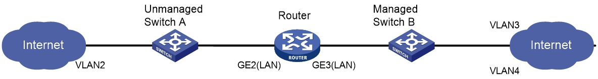

Q.     How can I divide VLANs and disable access between VLANs?
A.     The following example describes how to divide VLAN and disable access between the VLANs.
Network diagram
As shown in the figure above, unmanaged switch Switch A connects to interface LAN1 on the device, and managed switch Switch B connects to interface LAN2 on the device. Configure VLANs to meet the following requirements:
All clients attached to Switch A can obtain IP addresses from the VLAN 2 address pool.
Two VLAN interfaces (VLAN-interface 3:192.168.3.0/24 and VLAN-interface 4:192.168.4.0/24) exist on Switch B and correspond to two departments. The two departments cannot access each other.
1.     On the Web interface for the device, access the Network Settings > LAN Settings page. Click the VLAN Settings tab. On this tab, add the following three VLANs:
¡     VLAN 2: Configure the VLAN interface IP address as 192.168.2.1 and subnet mask as 255.255.255.0.
¡     VLAN 3: Configure the VLAN interface IP address as 192.168.3.1 and subnet mask as 255.255.255.0.
¡     VLAN 4: Configure the VLAN interface IP address as 192.168.4.1 and subnet mask as 255.255.255.0.
2.     On the Web interface for the device, access the Network Settings > LAN Settings page. Click the VLAN Division tab. Click the Edit icon in the Actions column for interface LAN1. The Detailed Port Settings page opens. Modify both the PVID and permitted VLANs to VLAN 2 for interface LAN1. If other interfaces are also connected to unmanaged devices to implement similar functions, configure these interfaces in a similar way.
3.     On the Web interface for the device, access the Network Settings > LAN Settings page. Click the VLAN Division tab. Click the Edit icon in the Actions column for interface LAN2. The Detailed Port Settings page opens. On both Switch A and Switch B, add VLAN 3 and VLAN 4 to the selected VLANs. If more VLANs exist on a managed switch, add them to the permitted VLANs.
4.     For users in the LAN to dynamically obtain IP addresses from the corresponding network segments through DHCP, perform the following tasks: On the Web interface for the device, access the Network Settings > LAN Settings page. Click the VLAN Settings tab. Click the Edit icon in the Actions column for a VLAN interface, and configure DHCP for the VLAN interface.
5.     To disable the gateway of VLAN 3 and the gateway of VLAN 4 from accessing each other, add firewall rules in the firewall configuration of the device. Disable all services with source IP addresses 192.168.3.2 through 192.168.3.254 from accessing all services with destination IP addresses 192.168.4.2 through 192.168.4.254.
