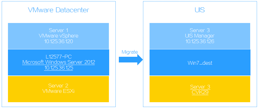

Heterogeneous migration allows migration of disk data on physical x86 servers, VMs managed by UIS Manager, and VMs managed by another platform to destination VMs on the UIS Manager platform. It requires client installation on the source device.
This document uses an environment shown in Figure 1-1 as an example.
Figure 1-1 Migration environment

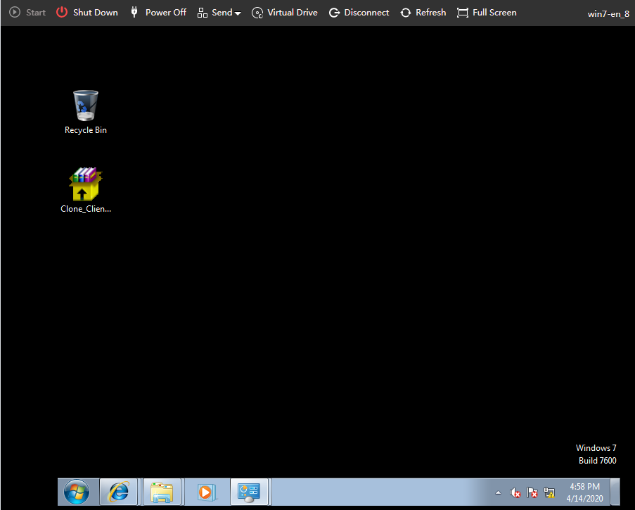

To install the migration client:
1.     Access the remote console of the source device.
Figure 2-2 Accessing the remote console of the source device
2.     Double-click Clone_Client_Win.exe.

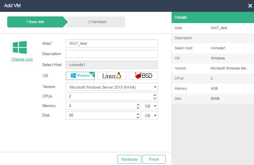

Creating a destination VM
CAUTION
CAUTION:
If the source device uses the Suse10 OS, set the bus type to IDE when creating a destination VM.
Create the destination VM on UIS Manager as shown in Figure 3-1. Make sure both the available disk size and total disk size of the destination VM are equal to or larger than the disk sizes of the source device.
Figure 3-1 Creating the destination VM

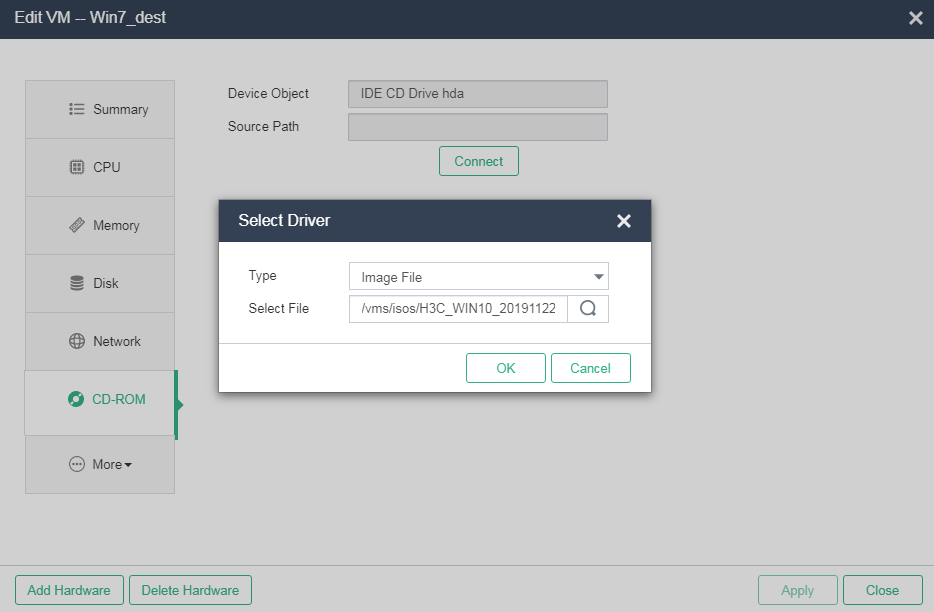

1.     Mount the PE image to the destination VM.
Figure 3-2 Mounting the PE image to the destination VM

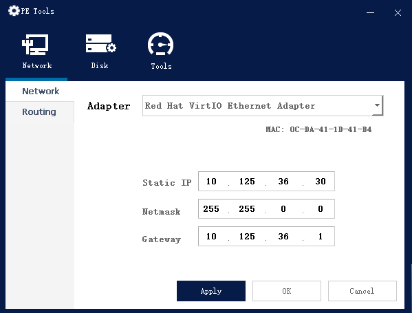

3.     Click Tools and configure network settings for the VM to communicate with UIS Manager.
CAUTION
CAUTION:
The network settings configured in this step get lost after the VM restarts. After the migration, you can reconfigure network settings for the VM as needed.
Figure 3-4 Configuring network settings

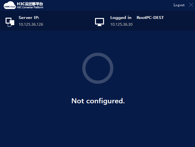

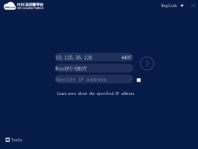

4.     Enter the IP address of UIS Manager, specify a host name for the VM, and then click the chevron.
The local IP address field is optional. By default, the default IP address used by the destination VM to access the migration platform is used. If UIS Manager uses a public IP address, or if two hosts provide stateful failover, you must specify a local IP address. If you do not do so, the source device cannot connect to the destination VM.
Figure 3-5 Configuring TargetClient parameters
The page that opens indicates that TargetClient and the destination VM have been connected to UIS Manager.
Figure 3-6 TargetClient connection

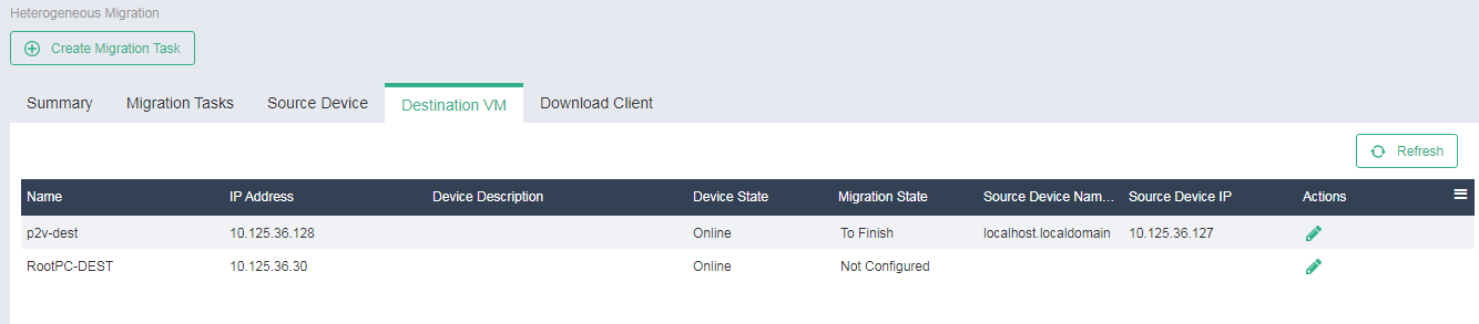

5.     Access the Services > Heterogeneous Migration > Destination VM page to verify that the destination VM has been added to the destination VM page, and the VM status is online.
IMPORTANT
IMPORTANT:
Only online destination VMs support migration tasks. If the migration operation fails for an online destination VM, verify that no network address conflict exists.
Figure 3-7 Destination VM list

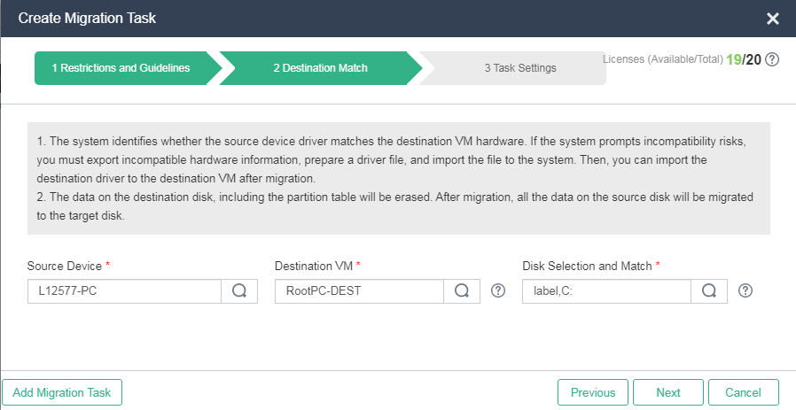

5.     Specify the source device and destination VM.
Figure 4-1 Specifying the source device and destination VM

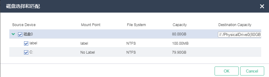

6.     Select source and destination disks.
By default, the system maps each source device disk to a target device disk. If you manually map a source disk to a target disk, make sure the target disk has a same or larger size than the source disk. For dynamic source disks, the destination disks and source disks must have the same size.
IMPORTANT
IMPORTANT:
·     Only system disks and data disks can be migrated.
·     You do not need to select a destination disk for an LVM disk because it is a logical volume, but the system also migrates LVM data.
·     The data on the destination disk, including the partition table will be erased. After migration, all the data on the source disk will be migrated to the target disk.
Figure 4-2 Selecting disks

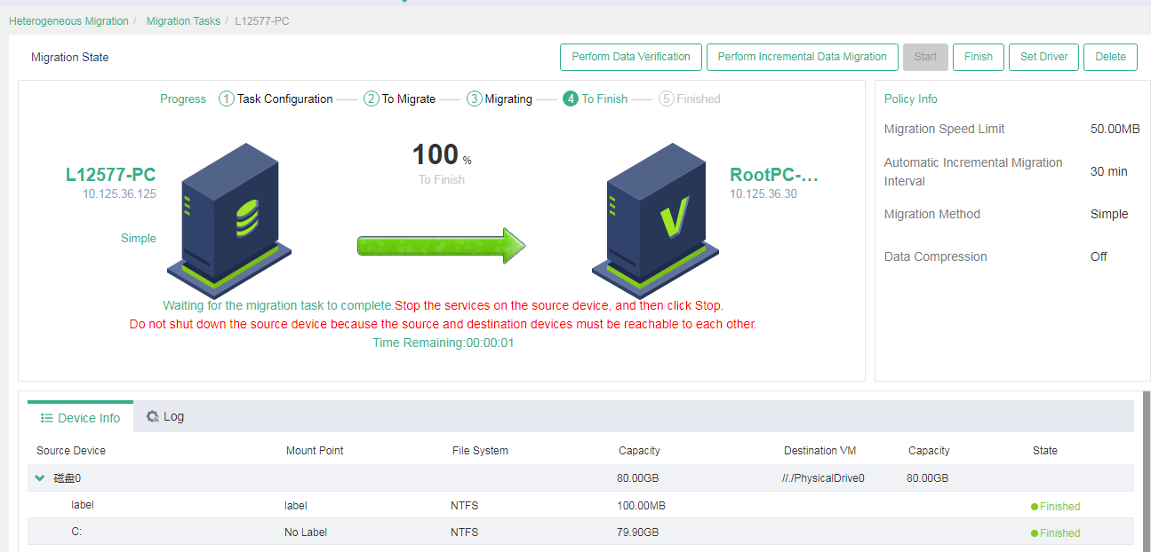

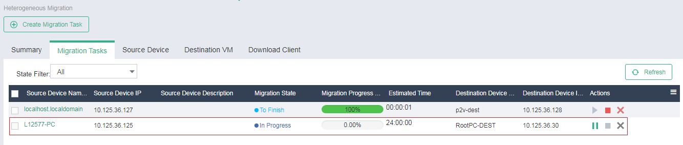

9.     To view the migration task list, click the Migration Tasks tab. The system names migration tasks by source device names and updates the list every 30 seconds.
Figure 4-4 Migration task list

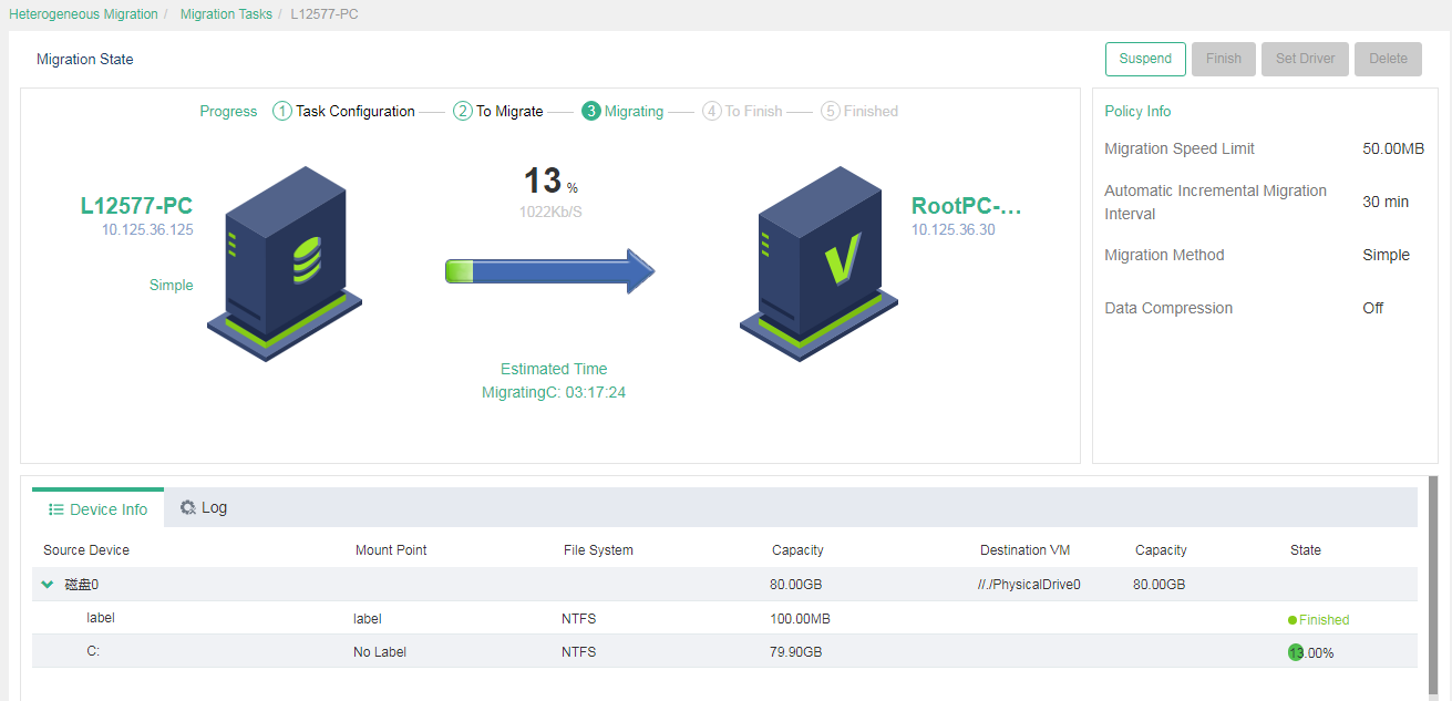

10.     To view detailed information about a migration task, click the source device name. The detailed information page displays the migration process, device information, and logs.
The system calculates the execution progress of a migration task by periodically sampling data. The system might not refresh the execution progress in real time when migrating a large number of disks, which does not affect migration. You can check the migration progress for the migration state of each disk.
Figure 4-5 Viewing detailed information about a migration task
11.     The system executes a migration task periodically at the incremental migration interval if you do not finish it manually. To manually finish a migration task, click Finish.
Before manually finishing a task, you must stop the services on the source device to prevent the device from generating new data.
CAUTION
CAUTION:
You can manually perform incremental data migration for a migration task that is not finished after its first execution. Incremental migration copies only the changed or new data since the previous migration. You can verify data integrity and restore data for a migration task that is not finished after its first execution.
Figure 4-6 Finishing a migration task
After you finish the task, the task enters Finished state.

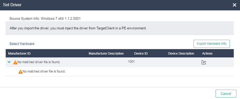

Configuring a driver
IMPORTANT
IMPORTANT:
As a best practice, for Linux OSs, use Virtio drivers if the kernel version is 2.6.25 or higher (for example, redhat 5.2), and use IDE drivers if the kernel version is not.
The system can detect disk driver incompatibility risks for a migration task. You can export information about the hardware that might have driver incompatibility issues and import drivers for the hardware to the destination VM.
To configure a driver:
1.     On the top navigation bar, click Services.
2.     From the left navigation pane, select Heterogeneous Migration.
3.     Select the Migration Tasks tab.
4.     Click the source device name of a migration task.
5.     Click Set Driver.
Figure 4-8 Configuring a driver
6.     Click Export Hardware Info. The system exports hardware information about disks of the destination VM in TXT format.
7.     Open the downloaded file to view information about the required drivers. The file name is Destination_VM_name Driver Hardware Info.txt.
8.     Compress driver files to be uploaded into a .zip file and name the compressed file mptspi.zip.
Typically, driver files are .sys or .inf files and .ko files for Windows and Linux, respectively.
Make sure the compressed file does not contain multi-layered folders.
9.     On the detailed task information page, click the import button to import the compressed file to UIS Manager.
Figure 4-9 Importing the compressed file to UIS Manager

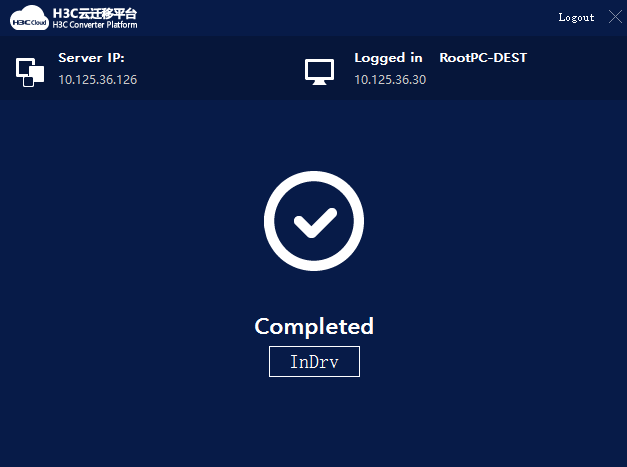

10.     Click InDrv in TargetClient to install drivers to the destination VM.
Figure 4-10 Installing drivers

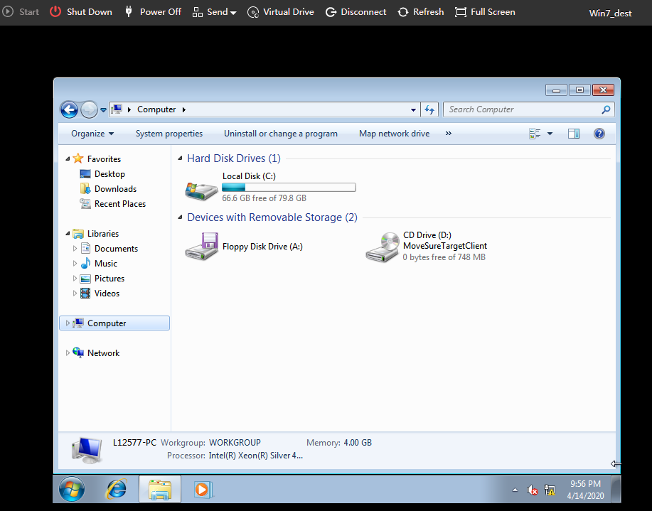

Accessing the destination VM

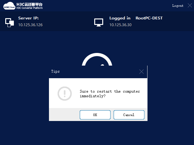

1.     Access the console of the destination VM and exit the H3C Converter Platform.
2.     At the prompt, click OK to restart the destination VM.
If you cannot access the VM's operating system or the system prompts partition or disk not found, power off the VM, restart the VM, and select boot from CAS.
Figure 4-11 Restarting the destination VM
3.     Enter the username and password and access the destination VM. Verify that all data in the source device has been migrated to the destination VM.
By default, the destination VM uses the same username and password as the source device.
Figure 4-12 Verifying data on the destination VM

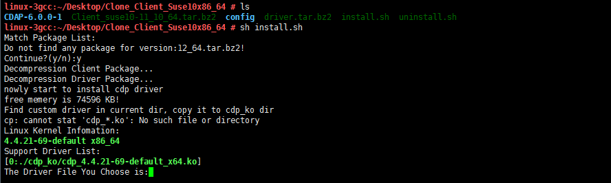

6 Appendix B Installing a migration client on a Linux OS
1.     Log in to the migration client through FTP and access the /root/Clone_Client_Linux_64 directory.
2.     Execute the ./install.sh command to run the installation script
3.     Select the matching driver package at the prompt and enter y.
4.     If multiple driver packages exist, select the one that has a similar version as the system kernel.
Figure 6-2 Installing the migration client
The system prompts install/start CAS succeeded! after the installation finishes.
Figure 6-3 Installation completion
