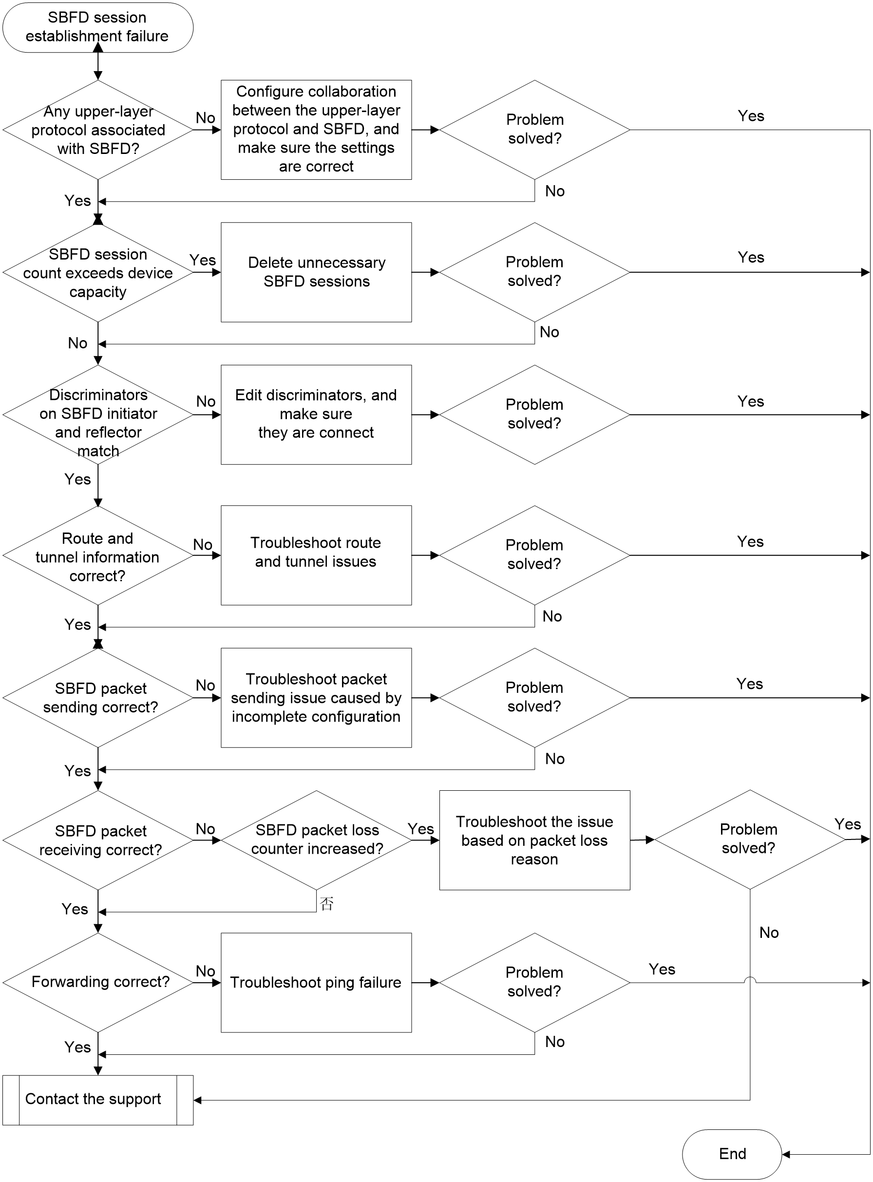

Figure 1 shows the troubleshooting flowchart.
Figure 1 Flowchart for troubleshooting master/backup state change of the VRRP group
