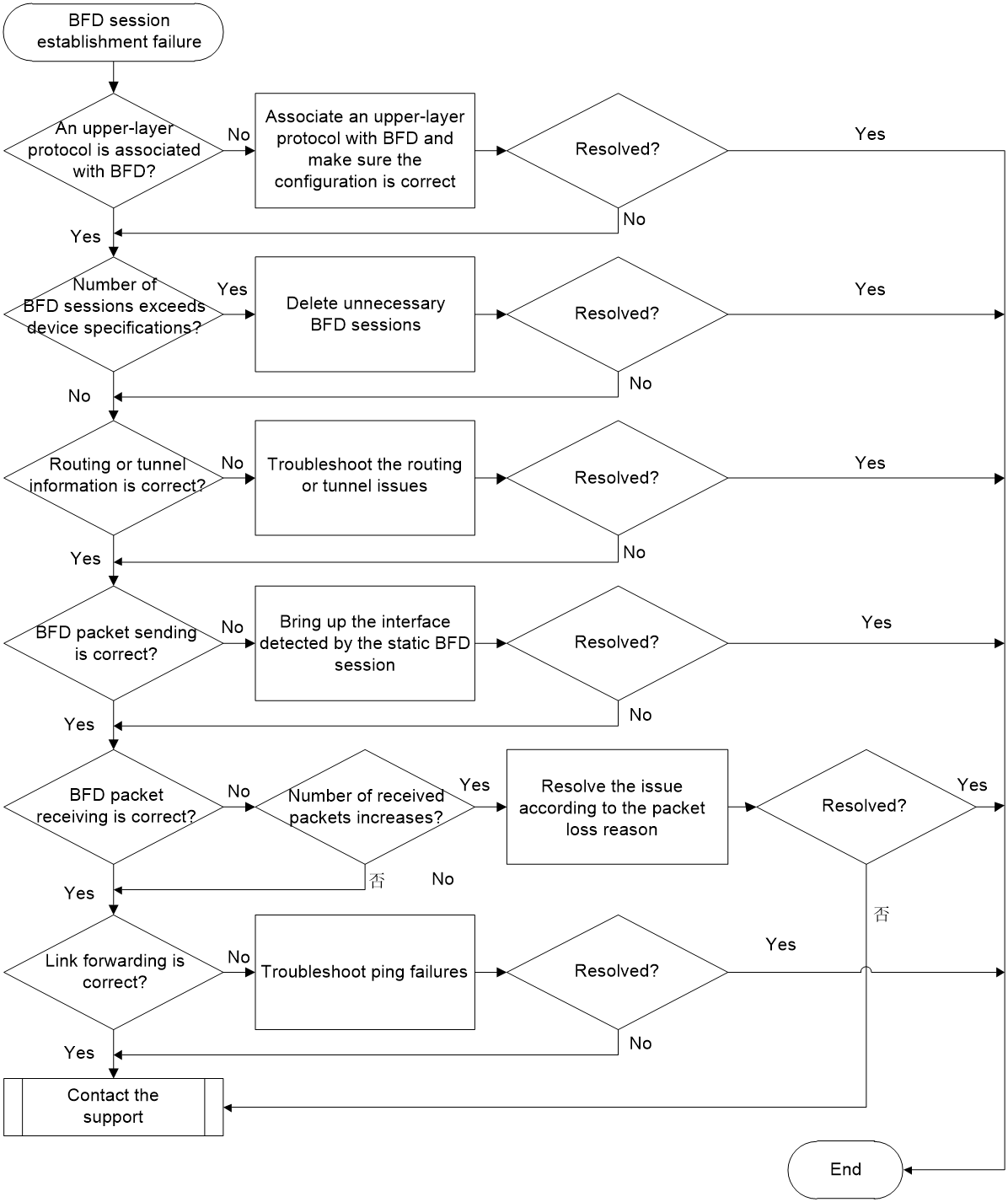

Troubleshooting flow
Figure 1 shows the troubleshooting flowchart.
Figure 1 Flowchart for troubleshooting BFD session establishment failure
Solution
BFD uses a session established between two network devices to detect the bidirectional forwarding path between the devices for the upper-layer application. BFD itself does not have a discovery mechanism. It relies on the notifications from the associated upper-layer protocol to establish a session. After the upper-layer protocol establishes a new neighbor relationship, it sends the neighbor's parameters and detection parameters (including the destination address and source address) to BFD. BFD then establishes a session based on the received parameters. Once the session is established, BFD packets are quickly sent periodically. If BFD packets are not received within the detection interval, the bidirectional forwarding path is considered faulty, and fault information is sent to the upper-layer application, which takes corresponding actions. To accurately troubleshoot a BFD session establishment failure, make sure the upper-layer protocol operates correctly.
To resolve the issue:
1.     Execute the display bfd session command to identify whether BFD session information exists.
¡     If no BFD session information exists, proceed to step 2 and step 3.
¡     If BFD session information exists, but the State field value is Down, proceed to step 4.
2.     Identify whether an upper-layer protocol is associated with BFD.
Execute the display current-configuration command to identify whether an upper-layer protocol is associated with BFD. For example, the following output shows that OSPF is associated with BFD:
 ospf bfd enable
¡     If an upper-layer protocol is associated with BFD, proceed to step 3.
¡     If no upper-layer protocol is associated with BFD, execute the corresponding command to associate an upper-layer protocol with BFD and make sure the configuration is correct.
3.     Identify whether the number of BFD sessions exceeds the upper limit of the device.
Execute the display bfd session command to view the value of the Total sessions field. If the value reaches the device upper limit, new BFD sessions cannot be created. To solve this issue, delete some unnecessary BFD sessions by disabling BFD for some upper-layer protocols.
If the number of BFD sessions does not exceed the device upper limit, proceed to step 4.
4.     Identify whether the BFD routing or tunnel information is correct.
If BFD is used to detect the connectivity of an IP link, perform the following tasks to check the routing information:
a.     Execute the display bfd session command to view the IPv4 or IPv6 address displayed in the DestAddr field.
b.     Execute the display ip routing-table or display ipv6 routing-table command to identify whether a route destined for the address is available in the DestAddr field.
c.     If no routes exist, see the Layer 3—IP routing troubleshooting guide to troubleshoot the issue.
If a route exists but the BFD session cannot come up, proceed to step 5.

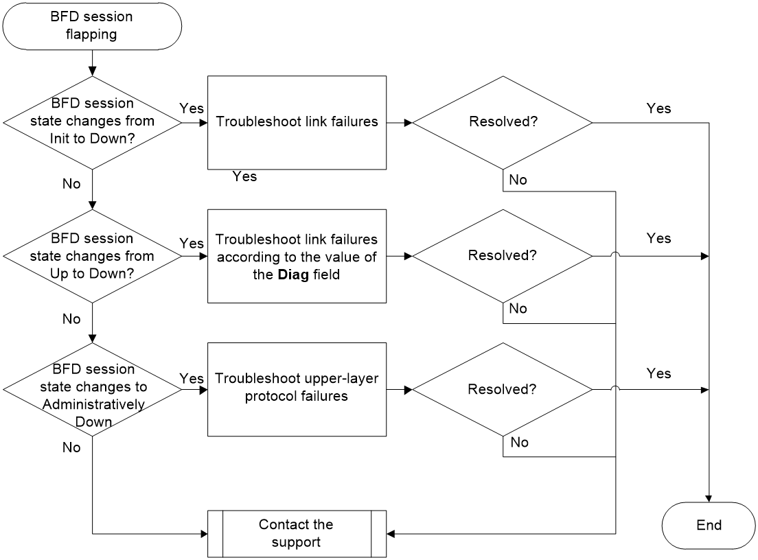

The troubleshooting flow for this issue is as follows:
1.     Determine the reasons according to the BFD logs.
2.     Check the board hardware, physical link, upper-layer protocol state, route availability, and whether the tunnel is correctly established.
Figure 2 shows the troubleshooting flowchart.
Figure 2 Flowchart for troubleshooting BFD session flapping.
Solution
CAUTION
CAUTION:
·     Output of excessive debugging messages increases the CPU usage and affects the system operation. To guarantee system performance, enable debugging for only the specified modules.
·     Save the execution results of the following steps. If the issue cannot be resolved, contact Technical Support.
1.     Identify whether the BFD session state changes from Init to Down.
The following log message outputted by the CLI indicates that the BFD session state changes from Init to Down:
