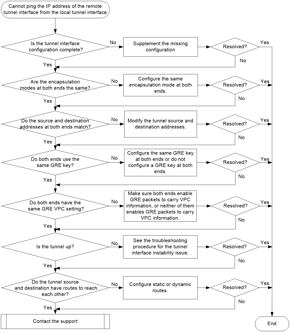

Troubleshooting flow
Figure 1 shows the troubleshooting flowchart.
Figure 1 Flowchart for troubleshooting the failure in pinging the IP address of the remote tunnel interface

1.     Verify that the tunnel interface configuration is complete on both ends of the tunnel.
Execute the display current interface tunnel command on both ends of the tunnel to display the tunnel interface configuration. Make sure the tunnel source address, tunnel destination address, and IP address of the tunnel interface have all been configured on each end.
<Sysname> display current interface tunnel
interface Tunnel1 mode gre
 source 1.1.1.1
 destination 1.1.1.2
If the configuration of the tunnel interface on one end is incomplete, supplement the missing configuration. The following information provides an example of the tunnel interface configuration:

2.     Verify that the encapsulation modes at both ends of the tunnel are the same.
On each end, execute the display current interface tunnel command to display the encapsulation mode of the tunnel interface.
 source 1.1.1.1
 destination 1.1.1.2
If the encapsulation modes at both ends are inconsistent, you must first execute the undo interface tunnel command to delete the tunnel interface with an incorrect mode, and then execute the interface tunnel command to re-create the tunnel interface. Deleting a tunnel interface also deletes the configuration on that tunnel interface. You must reconfigure the tunnel source address, tunnel destination address, and IP address of the tunnel interface after the tunnel interface is re-created.
3.     Verify that the source and destination addresses at one end of the tunnel are the destination and source addresses at the other end of the tunnel, respectively.
On each end, execute the display current interface tunnel command to display the tunnel interface configuration. Make sure the tunnel source address on the local end is the tunnel destination address on the remote end and the tunnel destination address on the local end is the tunnel source address on the remote end. In addition, the tunnel source address on each end must be a local address.
Local end:
 source 1.1.1.1
 destination 1.1.1.2
Remote end:
 ip address 10.1.1.2 255.255.255.0
 source 1.1.1.2
 destination 1.1.1.1
If the tunnel source or destination address on one end is incorrectly configured, execute the source or destination command in tunnel interface view to reconfigure the tunnel source or destination address.
4.     Verify that the GRE keys at both ends of the tunnel are identical.
You must configure the same GRE key at both ends of a GRE tunnel, or do not configure any GRE key at both ends of a GRE tunnel. To check the GRE key configuration, execute the display current interface tunnel command on both ends.
Local end:
 source 1.1.1.1
 destination 1.1.1.2
 gre key 123
Remote end:
 source 1.1.1.2
 destination 1.1.1.1
 gre key 123
If the GRE keys configured on both ends of the tunnel are different, execute the gre key command in tunnel interface view to configure the same GRE key on both ends.
5.     Verify that GRE packets at both ends of the tunnel carry virtual private cloud (VPC) information or GRE packets at neither of the ends carries VPC information.
On the same tunnel interface, do not enable GRE packets to carry VPC information when a GRE key is configured.
Make sure both ends of a GRE tunnel maintain consistent settings regarding whether to enable GRE packets to carry VPC information. If one end enables GRE packets to carry VPC information and the other end does not, you cannot ping the IP address of the tunnel interface on the other end.
On each end, execute the display current interface tunnel command to display whether GRE packets are configured to carry VPC information.
Local end:
 source 1.1.1.1
 destination 1.1.1.2
gre vpc enable
Remote end:
 source 1.1.1.2
 destination 1.1.1.1
gre vpc enable
If both ends of the GRE tunnel do not maintain consistent settings regarding whether to enable GRE packets to carry VPC information, execute the [ undo ] gre vpc enable command in tunnel interface view to make the settings consistent on both ends.
6.     Verify that the tunnel interfaces at both ends are already up.
Execute the display interface tunnel command to display the tunnel interface state. If the tunnel interface on one end is still down after you perform steps 1 and 2, see "Tunnel interface instability" in Tunnel Interface Troubleshooting Guide.

7.     Verify that the source and destination IP addresses of the tunnel have routes to reach each other.
Execute the display current interface tunnel command to identify whether the IP addresses of the tunnel interfaces at both ends of the tunnel belong to the same subnet. If they belong to the same subnet, the two ends will generate subnet routes by default. In this case, no physical link disconnectivity issue exists. If they do not belong to the same subnet, execute the display fib command to identify whether the source and destination IP addresses of the tunnel have routes to reach each other. If no routes are available, you must configure static or dynamic routes to make sure the source and destination IP addresses of the tunnel have routes to reach each other. If the issue persists, proceed to step 8.

8.     If the issue persists, collect the following information and contact Technical Support:
¡     Results of each step.
¡     The configuration file, log messages, and alarm messages.
¡     Command output from the debugging commands in Table 1.
