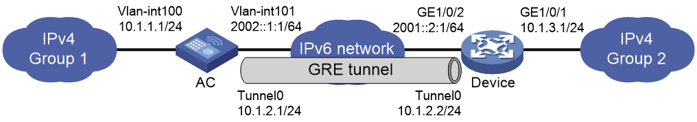

Configuring a GRE/IPv6 tunnel
2.     Create a GRE tunnel interface, and specify the tunnel mode as GRE/IPv6.
interface tunnel number mode gre ipv6
You must configure the same tunnel mode on both ends of a tunnel. Otherwise, packet delivery might fail.

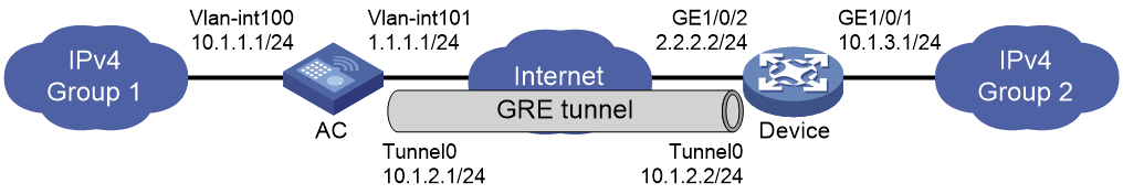

Example: Configuring an IPv4 over IPv4 GRE tunnel
As shown in Figure 5, Group 1 and Group 2 are two private IPv4 networks. The two networks both use private network addresses. Establish a GRE tunnel between the AC and the peer device (Device) to interconnect the two private IPv4 networks Group 1 and Group 2.
Figure 5 Network diagram
Before performing the following configuration, configure an IP address for each interface, and make sure the AC and Device can reach each other.

Example: Configuring an IPv4 over IPv6 GRE tunnel
As shown in Figure 6, two IPv4 subnets Group 1 and Group 2 are connected to an IPv6 network. Create a GRE/IPv6 tunnel between the AC and the peer device (Device), so the two IPv4 subnets can communicate with each other through the GRE tunnel over the IPv6 network.
Figure 6 Network diagram

Troubleshooting GRE
The key to configuring GRE is to keep the configuration consistent. Most faults can be located by using the debugging gre or debugging tunnel command. This section analyzes one type of fault for illustration, with the scenario shown in Figure 7.
Figure 7 Network diagram
Hosts at both ends of a GRE tunnel cannot ping each other
Symptom
The interfaces at both ends of the tunnel are configured correctly and can ping each other, but Host A and Host B cannot ping each other.
