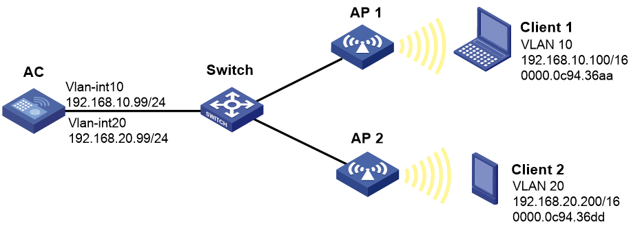

As shown in Figure 3, Client 1 and Client 2 have the same IP prefix and mask, but they are located on different subnets separated by the AC. Client 1 belongs to VLAN 10, and Client 2 belongs to VLAN 20. No default gateway is configured on Client 1 and Client 2.
Configure common proxy ARP on the AC to enable communication between the two clients.
Figure 3 Network diagram
# Create VLAN 10 and VLAN 20.
<AC> system-view
[AC] vlan 10
[AC-vlan10] quit
[AC] vlan 20
[AC-vlan20] quit
# Configure the IP address of VLAN-interface 10.
[AC] interface vlan-interface 10
[AC-Vlan-interface10] ip address 192.168.10.99 255.255.255.0
# Enable common proxy ARP on VLAN-interface 10.
[AC-Vlan-interface10] proxy-arp enable
[AC-Vlan-interface10] quit
# Configure the IP address of VLAN-interface 20.
[AC] interface vlan-interface 20
[AC-Vlan-interface20] ip address 192.168.20.99 255.255.255.0
# Enable common proxy ARP on VLAN-interface 20.
[AC-Vlan-interface20] proxy-arp enable
# Verify that Client 1 and Client 2 can ping each other.

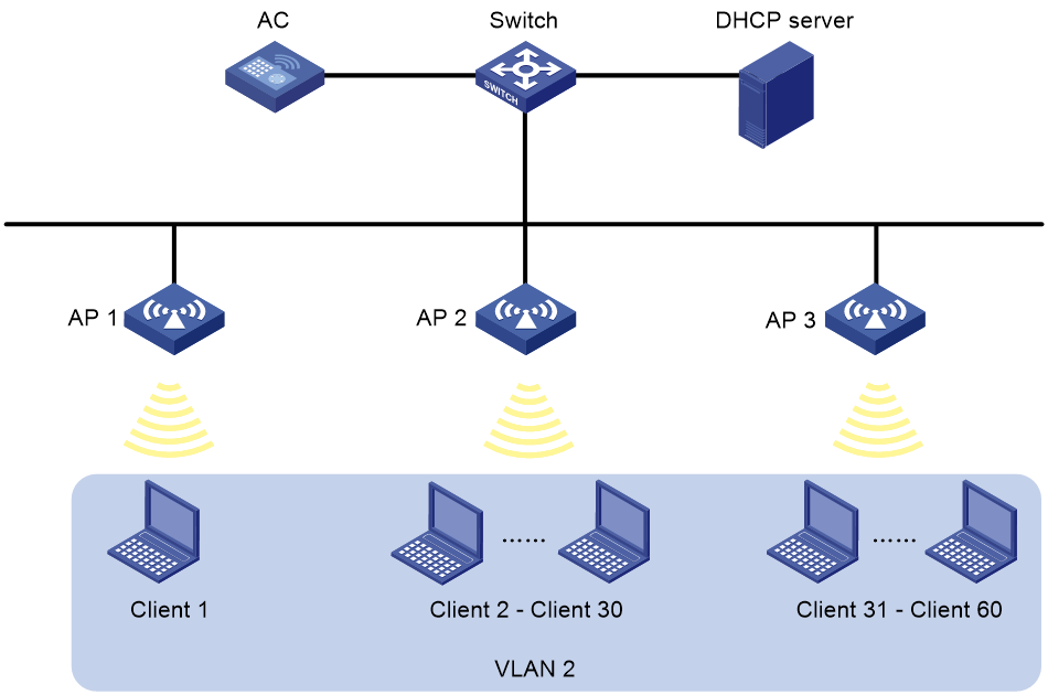

As shown in Figure 4, AP 1, AP 2 and AP 3 are connected to the AC through the switch. APs are connected to VLAN 2. All clients have obtained IP addresses through DHCP.
Enable ARP snooping and ARP fast-reply for VLAN 2. The AC directly returns an ARP reply without broadcasting received ARP requests to other APs upon receiving an ARP request from a client.
Figure 4 Network diagram
1.     Configure basic functions on the AC.
For more information about the configuration, see WLAN Access Configuration Guide.
2.     Enable ARP snooping for VLAN 2 on the AC.
<AC> system-view
[AC] vlan 2
[AC-vlan2] arp snooping enable
3.     Enable ARP fast-reply for VLAN 2 on the AC.
[AC-vlan2] arp fast-reply enable
[AC-vlan2] quit
