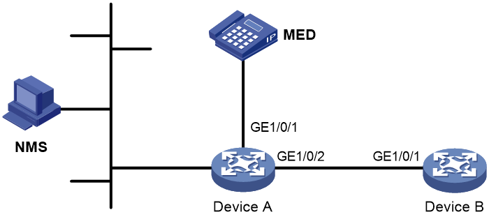

LLDP exchanges packets between neighbor agents and creates and maintains neighbor information for them. Figure 1 shows the neighbor relationships for these LLDP agents.
Figure 1 LLDP neighbor relationships

As shown in Figure 5, enable LLDP globally on Device A and Device B to perform the following tasks:
·     Monitor the link between Device A and Device B on the NMS.
·     Monitor the link between Device A and the MED device on the NMS.
Figure 5 Network diagram

# Verify the following items:
·     GigabitEthernet 1/0/1 of Device A connects to a MED device.
·     GigabitEthernet 1/0/2 of Device A connects to a non-MED device.
·     Both ports operate in Rx mode, and they can receive LLDP frames but cannot send LLDP frames.
