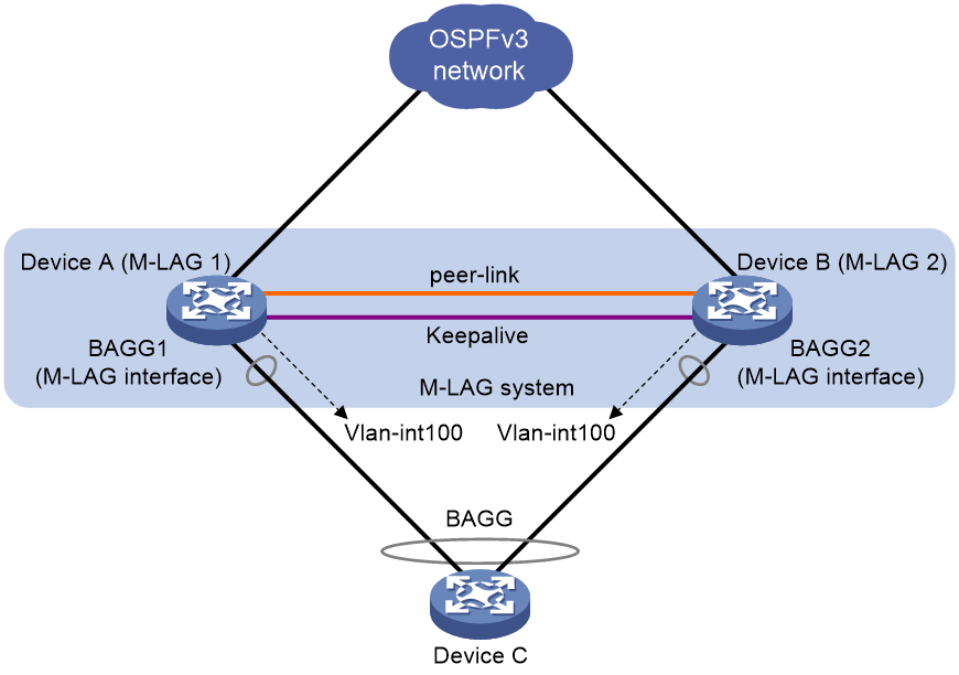

Establishing OSPFv3 neighbor relationships on an M-LAG network
When a customer-side device accesses the OSPFv3 network through both M-LAG member devices in an M-LAG system, the M-LAG member devices provide Layer 3 gateway services. The gateway interfaces (such as VLAN or VSI interfaces) on different M-LAG member devices might generate the same link-local address because they have the same IP address and MAC address. In this case, the M-LAG member devices cannot establish OSPFv3 neighbor relationships with the customer-side device.
To resolve this issue, configure the gateway interfaces to use M-LAG virtual IPv6 addresses for OSPFv3 neighbor relationship establishment. The M-LAG virtual IPv6 address configured for a gateway interface must be a link-local address because OSPFv3 uses link-local addresses for OSPFv3 neighbor relationship establishment. For more information about M-LAG, see M-LAG configuration in Layer 2—LAN Switching Configuration Guide.
As shown in Figure 1, Device C accesses the OSPFv3 network through the M-LAG system that consists of Device A and Device B. Device A and Device B provide Layer 3 gateway services. The gateway interface VLAN-interface 100 on Device A and the gateway interface VLAN-interface 100 on Device B have the same IP address and the same MAC address. To ensure that both Device A and Device B can establish an OSPFv3 neighbor relationship with Device C, configure different M-LAG virtual IPv6 addresses for the VLAN interfaces on Device A and Device B.
Figure 1 OSPFv3 neighbor relationship establishment on an M-LAG network
2.     Enter interface view.
3.     Specify a link-local address as the M-LAG virtual IPv6 address to be assigned to the interface.
port m-lag ipv6 virtual-ip ipv6-address link-local
By default, no M-LAG virtual IPv6 address is assigned to an interface.
For more information about this command, see M-LAG commands in Layer 2—LAN Switching Ethernet Command Reference.

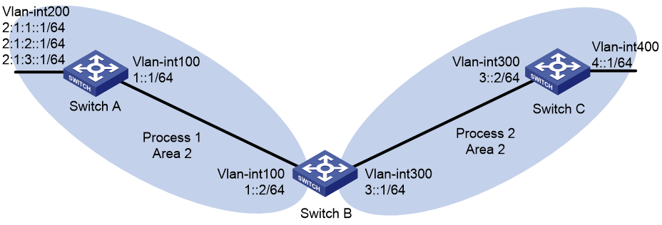

Example: Configuring OSPFv3 stub area
As shown in Figure 5:
·     Enable OSPFv3 on all switches.
·     Split the AS into three areas.
·     Configure Switch B and Switch C as ABRs to forward routing information between areas.
·     Configure Area 2 as a stub area to reduce LSAs in the area without affecting route reachability.
Figure 5 Network diagram
1.     Configure IPv6 addresses for interfaces. (Details not shown.)
2.     Configure basic OSPFv3:
# On Switch A, enable OSPFv3 and specify the router ID as 1.1.1.1.
<SwitchA> system-view
[SwitchA] ospfv3
[SwitchA-ospfv3-1] router-id 1.1.1.1
[SwitchA-ospfv3-1] quit
[SwitchA] interface vlan-interface 300
[SwitchA-Vlan-interface300] ospfv3 1 area 1
[SwitchA-Vlan-interface300] quit
[SwitchA] interface vlan-interface 200
[SwitchA-Vlan-interface200] ospfv3 1 area 1
[SwitchA-Vlan-interface200] quit
# On Switch B, enable OSPFv3 and specify the router ID as 2.2.2.2.
<SwitchB> system-view
[SwitchB] ospfv3
[SwitchB-ospfv3-1] router-id 2.2.2.2
[SwitchB-ospfv3-1] quit
[SwitchB-Vlan-interface100] ospfv3 1 area 0
[SwitchB] interface vlan-interface 200
[SwitchB-Vlan-interface200] ospfv3 1 area 1
[SwitchB-Vlan-interface200] quit
# On Switch C, enable OSPFv3 and specify the router ID as 3.3.3.3.
<SwitchC> system-view
[SwitchC] ospfv3
[SwitchC-ospfv3-1] router-id 3.3.3.3
[SwitchC-ospfv3-1] quit
[SwitchC] interface vlan-interface 100
[SwitchC-Vlan-interface100] ospfv3 1 area 0
[SwitchC-Vlan-interface100] quit
[SwitchC] interface vlan-interface 400
[SwitchC-Vlan-interface400] ospfv3 1 area 2
[SwitchC-Vlan-interface400] quit
# On Switch D, enable OSPFv3 and specify the router ID as 4.4.4.4.
<SwitchD> system-view
[SwitchD] ospfv3
[SwitchD-ospfv3-1] router-id 4.4.4.4
[SwitchD-ospfv3-1] quit
[SwitchD] interface vlan-interface 400
[SwitchD-Vlan-interface400] ospfv3 1 area 2
[SwitchD-Vlan-interface400] quit
# Display OSPFv3 neighbors on Switch B.
[SwitchB] display ospfv3 peer
               OSPFv3 Process 1 with Router ID 2.2.2.2
 Area: 0.0.0.0
 Router ID       Pri State             Dead-Time InstID Interface
 3.3.3.3         1   Full/BDR          00:00:40  0      Vlan100
 Area: 0.0.0.1
 1.1.1.1         1   Full/DR           00:00:40  0      Vlan200
# Display OSPFv3 neighbors on Switch C.
[SwitchC] display ospfv3 peer
               OSPFv3 Process 1 with Router ID 3.3.3.3
 Area: 0.0.0.0
 2.2.2.2         1   Full/DR           00:00:40  0      Vlan100
 Area: 0.0.0.2
 4.4.4.4         1   Full/BDR          00:00:40  0      Vlan400
# Display OSPFv3 routing table information on Switch D.
[SwitchD] display ospfv3 routing
               OSPFv3 Process 1 with Router ID 4.4.4.4
 I  - Intra area route,  E1 - Type 1 external route,  N1 - Type 1 NSSA route
 IA - Inter area route,  E2 - Type 2 external route,  N2 - Type 2 NSSA route
 *  - Selected route
*Destination: 2001::/64
  Type       : IA                        Area       : 0.0.0.2
  AdvRouter  : 3.3.3.3                   Preference : 10
  NibID      : 0x23000004                Cost       : 2
  Interface  : Vlan400                   BkInterface: N/A
  Nexthop    : FE80::48C0:26FF:FEDA:305
  BkNexthop  : N/A
  Status     : Rely
 *Destination: 2001:1::/64
  NibID      : 0x23000004                Cost       : 3
  BkNexthop  : N/A
  Status     : Rely
 *Destination: 2001:2::/64
  Type       : I                         Area       : 0.0.0.2
  AdvRouter  : 4.4.4.4                   Preference : 10
  NibID      : 0x23000002                Cost       : 1
  Nexthop    : ::
  BkNexthop  : N/A
  Status     : Direct
 *Destination: 2001:3::1/128
  BkNexthop  : N/A
  Status     : Rely
 Total: 4
 Intra area: 1         Inter area: 3         ASE: 0         NSSA: 0
3.     Configure Area 2 as a stub area:
# Configure Switch D.
[SwitchD] ospfv3
[SwitchD-ospfv3-1] area 2
[SwitchD-ospfv3-1-area-0.0.0.2] stub
# Configure Switch C, and specify the cost of the default route sent to the stub area as 10.
[SwitchC] ospfv3
[SwitchC-ospfv3-1] area 2
[SwitchC-ospfv3-1-area-0.0.0.2] stub
[SwitchC-ospfv3-1-area-0.0.0.2] default-cost 10

Example: Configuring OSPFv3 route summarization
As shown in Figure 9:
·     Switch A, Switch B, and Switch C are in Area 2.
·     OSPFv3 process 1 and OSPFv3 process 2 run on Switch B. Switch B communicates with Switch A and Switch C through OSPFv3 process 1 and OSPFv3 process 2, respectively.
·     On Switch A, configure IPv6 addresses 2:1:1::1/64, 2:1:2::1/64, and 2:1:3::1/64 for VLAN-interface 200.
·     On Switch B, configure OSPFv3 process 2 to redistribute direct routes and the routes from OSPFv3 process 1. Switch C can then learn the routes destined for 2::/64, 2:1:1::/64, 2:1:2::/64, and 2:1:3::/64.
·     On Switch B, configure route summarization to advertise only summary route 2::/16 to Switch C.
Figure 9 Network diagram
2.     Configure OSPFv3:
# Enable OSPFv3 process 1 on Switch A.
[SwitchA] ospfv3 1
[SwitchA-Vlan-interface100] ospfv3 1 area 2
[SwitchA-Vlan-interface200] ipv6 address 2:1:1::1 64
[SwitchA-Vlan-interface200] ipv6 address 2:1:2::1 64
[SwitchA-Vlan-interface200] ipv6 address 2:1:3::1 64
[SwitchA-Vlan-interface200] ospfv3 1 area 2
# Enable OSPFv3 process 1 and OSPFv3 process 2 on Switch B.
[SwitchB] ospfv3 1
[SwitchB-Vlan-interface100] ospfv3 1 area 2
[SwitchB] ospfv3 2
[SwitchB-ospfv3-2] router-id 3.3.3.3
[SwitchB-ospfv3-2] quit
[SwitchB] interface vlan-interface 300
[SwitchB-Vlan-interface300] ospfv3 2 area 2
[SwitchB-Vlan-interface300] quit
# Enable OSPFv3 process 2 on Switch C.
[SwitchC] ospfv3 2
[SwitchC-ospfv3-2] router-id 4.4.4.4
[SwitchC-ospfv3-2] quit
[SwitchC] interface vlan-interface 300
[SwitchC-Vlan-interface300] ospfv3 2 area 2
[SwitchC-Vlan-interface300] quit
[SwitchC-Vlan-interface400] ospfv3 2 area 2
3.     Configure OSPFv3 route redistribution:
# Configure OSPFv3 process 2 to redistribute direct routes and the routes from OSPFv3 process 1 on Switch B.
[SwitchB] ospfv3 2
[SwitchB-ospfv3-2] import-route ospfv3 1
[SwitchB-ospfv3-2] import-route direct
# Display the routing table on Switch C.
[SwitchC] display ipv6 routing-table
Destinations : 12 Routes : 12
Destination: ::1/128                                     Protocol  : Direct
NextHop    : ::1                                         Preference: 0
Interface  : InLoop0                                     Cost      : 0
Destination: 1::/64                                      Protocol  : O_ASE2
NextHop    : FE80::200:CFF:FE01:1C03                     Preference: 150
Interface  : Vlan300                                     Cost      : 1
Destination: 2::/64                                      Protocol  : O_ASE2
Destination: 2:1:1::/64                                  Protocol  : O_ASE2
Destination: 2:1:2::/64                                  Protocol  : O_ASE2
Destination: 2:1:3::/64                                  Protocol  : O_ASE2
Destination: 3::/64                                      Protocol  : Direct
NextHop    : 3::2                                        Preference: 0
Interface  : Vlan300                                     Cost      : 0
Destination: 3::2/128                                    Protocol  : Direct
Destination: 4::/64                                      Protocol  : Direct
NextHop    : 4::1                                        Preference: 0
Interface  : Vlan400                                     Cost      : 0
Destination: 4::1/128                                    Protocol  : Direct
Destination: FE80::/10                                   Protocol  : Direct
NextHop    : ::                                          Preference: 0
Interface  : NULL0                                       Cost      : 0
Destination: FF00::/8                                    Protocol  : Direct
4.     Configure ASBR route summarization:
# On Switch B, configure OSPFv3 process 2 to advertise a single route 2::/16.
[SwitchB] ospfv3 2
[SwitchB-ospfv3-2] asbr-summary 2:: 16
Destinations : 9 Routes : 9
Destination: 2::/16                                      Protocol  : O_ASE2
