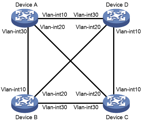

As shown in Figure 4, the same level routers on a network, including non-DIS routers, establish adjacency with each other.
Figure 4 DIS in the IS-IS broadcast network
The DIS creates and updates pseudonodes, and generates LSPs for the pseudonodes, to describe all routers on the network.
A pseudonode represents a virtual node on the broadcast network. It is not a real router. In IS-IS, it is identified by the system ID of the DIS and a 1-byte Circuit ID (a non-zero value).
Using pseudonodes simplifies network topology and can reduce the amount of resources consumed by SPF.
On an IS-IS broadcast network, all routers establish adjacency relationships, but they synchronize their LSDBs through the DIS.

To resolve this issue, configure IPv6 IS-IS MTR to perform route calculation separately in IPv4 and IPv6 topologies.
Figure 7 Network diagram
As shown in Figure 7, the numbers refer to the link costs. Router A, Router B, and Router D support both IPv4 and IPv6. Router C supports only IPv4 and cannot forward IPv6 packets.
Enable IPv6 IS-IS MTR on Router A, Router B, Router C, and Router D to make them perform route calculation separately in IPv4 and IPv6 topologies. With this configuration, Router A does not forward IPv6 packets destined to Router D through Router B, avoiding packet loss.
As a best practice to avoid route calculation failures, configure this feature when both IPv4 and IPv6 topologies exist in the network.

On a fully meshed network, many P2P links exist. As shown in Figure 12, Devices A, B, C and D run IS-IS. When Device A generates an LSP, it floods the LSP out of VLAN-interface 10, VLAN-interface 20, and VLAN-interface 30. After Device D receives the LSP from VLAN-interface 30, it floods it out of VLAN-interface 10 and VLAN-interface 20 to Device B and Device C. However, Device B and Device C have already received the LSP from Device A. Repeated LSP flooding consumes extra bandwidth.
Figure 12 Network diagram of a fully meshed network
To avoid this problem, you can add interfaces to a mesh group or block some interfaces.
·     An interface in a mesh group floods a received LSP only to interfaces not in the mesh group.
·     A blocked interface sends LSPs only after receiving LSP requests.

Setting the LSDB overload bit
By setting the overload bit in sent LSPs, an IS-IS device informs other devices of failures that make it unable to select routes and forward packets. The device is then excluded from the SPF calculation by other devices except its direct routes.
When an IS-IS device cannot record the complete LSDB, for example, because of memory insufficiency, it will calculate routes incorrectly. To locate the faulty device, you can temporarily isolate the suspects from the IS-IS network by setting the overload bit.
As shown in Figure 13, the path from Device A to the IP network should be Device A > Device D > Device E > IP network. After you set the overload bit in the LSPs sent by Device D, the path from Device A to the IP network becomes Device A > Device B > Device C > Device E > IP network. If the packets from Device A are destined for Device D's directly-connected networks, the forwarding path does not change.
Figure 13 Overload bit

A link or router failure on a path can cause packet loss. IS-IS LFA FRR enables fast rerouting to minimize the failover time.
Figure 14 Network diagram for IS-IS LFA FRR
In Figure 14, after you enable LFA FRR on Router B, IS-IS automatically calculates or designates a backup next hop when a link failure is detected. In this way, packets are directed to the backup next hop to reduce traffic recovery time. Meanwhile, IS-IS calculates the shortest path based on the new network topology, and forwards packets over the path after network convergence.

As shown in Figure 16, Switch A, Switch B, Switch C, and Switch D reside in an IS-IS AS.
Switch A and B are Level-1 switches, Switch D is a Level-2 switch, and Switch C is a Level-1-2 switch. Switch A, Switch B, and Switch C are in Area 10, and Switch D is in Area 20.
Figure 16 Network diagram

Example: Configuring DIS election
As shown in Figure 17, Switches A, B, C, and D reside in IS-IS area 10 on a broadcast network (Ethernet). Switch A and Switch B are Level-1-2 switches, Switch C is a Level-1 switch, and Switch D is a Level-2 switch.
Change the DIS priority of Switch A to make it elected as the Level-1-2 DIS router.
Figure 17 Network diagram

Example: Configuring IS-IS authentication
As shown in Figure 19, Switch A, Switch B, Switch C, and Switch D reside in the same IS-IS routing domain. Run IS-IS among them.
Switch A, Switch B, and Switch C belong to Area 10, and Switch D belongs to Area 20.
·     Configure neighbor relationship authentication between neighbors.
·     Configure area authentication in Area 10 to prevent untrusted routes from entering into the area.
·     Configure routing domain authentication on Switch C and Switch D to prevent untrusted routes from entering the routing domain.
Figure 19 Network diagram

Example: Configuring IS-IS FRR
As shown in Figure 23, Switch A, Switch B, and Switch C belong to the same IS-IS routing domain. Configure IS-IS FRR so that when the Link A fails, traffic can be switched to Link B immediately.
Figure 23 Network diagram

1.     Configure IP addresses and subnet masks for interfaces on the switches. (Details not shown.)
2.     Configure IS-IS on the switches to make sure Switch A, Switch B, and Switch C can communicate with each other at Layer 3. (Details not shown.)
3.     Configure IS-IS FRR:
Enable IS-IS FRR to calculate a backup next hop through LFA calculation, or designate a backup next hop by using a referenced routing policy.
¡     (Method 1.) Enable IS-IS FRR to calculate a backup next hop through LFA calculation:
# Configure Switch A.
<SwitchA> system-view
[SwitchA] isis 1
[SwitchA-isis-1] address-family ipv4
[SwitchA-isis-1-ipv4] fast-reroute lfa
[SwitchA-isis-1-ipv4] quit
[SwitchA-isis-1] quit
# Configure Switch B.
<SwitchB> system-view
[SwitchB] isis 1
[SwitchB-isis-1] address-family ipv4
[SwitchB-isis-1-ipv4] fast-reroute lfa
[SwitchB-isis-1-ipv4] quit
[SwitchB-isis-1] quit
¡     (Method 2.) Enable IS-IS FRR to designate a backup next hop by using a referenced routing policy:
[SwitchA] ip prefix-list abc index 10 permit 4.4.4.4 32
[SwitchA] route-policy frr permit node 10
[SwitchA-route-policy-frr-10] if-match ip address prefix-list abc
[SwitchA-route-policy-frr-10] apply fast-reroute backup-interface vlan-interface 100 backup-nexthop 12.12.12.2
[SwitchA-route-policy-frr-10] quit
[SwitchA] isis 1
[SwitchA-isis-1-ipv4] fast-reroute route-policy frr
[SwitchB] ip prefix-list abc index 10 permit 1.1.1.1 32
[SwitchB] route-policy frr permit node 10
[SwitchB-route-policy-frr-10] if-match ip address prefix-list abc
[SwitchB-route-policy-frr-10] apply fast-reroute backup-interface vlan-interface 101 backup-nexthop 24.24.24.2
[SwitchB-route-policy-frr-10] quit
[SwitchB] isis 1
[SwitchB-isis-1-ipv4] fast-reroute route-policy frr

As shown in Figure 25, Switch A, Switch B, Switch C, and Switch D, all enabled with IPv6, reside in the same AS. Configure IPv6 IS-IS on the switches so that they can reach each other.
Switch A and Switch B are Level-1 switches, Switch D is a Level-2 switch, and Switch C is a Level-1-2 switch.
Figure 25 Network diagram
1.     Configure IPv6 addresses for interfaces. (Details not shown.)
2.     Configure IPv6 IS-IS:

Example: Configuring BFD for IPv6 IS-IS
As shown in Figure 26:
·     Configure IPv6 IS-IS on Switch A and Switch B so that they can reach other.
·     Enable BFD on VLAN-interface 10 of Switch A and Switch B.
After the link between Switch B and the Layer 2 switch fails, BFD can quickly detect the failure and notify IPv6 IS-IS of the failure. Then Switch A and Switch B communicate through Switch C.
Figure 26 Network diagram
Table 7 Interface and IP address assignment
Device
Interface
IPv6 address
Device
Interface
IPv6 address
Switch A
Vlan-int10
2001::1/64
Switch B
Vlan-int10
2001::2/64
Vlan-int11
2001:2::1/64
Vlan-int13
2001:3::2/64
Switch C
Vlan-int11
2001:2::2/64
Vlan-int13
2001:3::1/64
