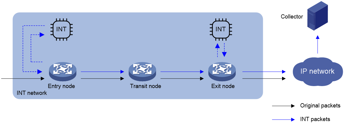

INT network components
As shown in Figure 1, an INT network contains the following INT-enabled devices: one entry node, one transit node, and one exit node.
Figure 1 INT network

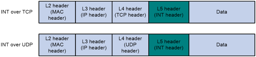

INT packet formats
INT generates INT packets by mirroring original packets, inserting INT headers, and collecting data. The INT header and collected data are in the original IP header. Therefore, an INT packet and its original packet have the same IP header and forwarding path.
The device supports generating INT packets from TCP packets and UDP packets. Figure 2 shows the INT packet formats. The 64 most significant bits of the INT header are fixed at 0xaaaaaaaabbbbbbbb, which are the INT mark.
Figure 2 INT packet formats

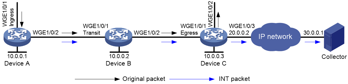

Common INT
As shown in Figure 3, the nodes in common INT perform the following functions:
1.     On the entry node, the ingress port uses a QoS policy to sample matching packets, and mirrors sampled packets to the INT processor. Then, the INT processor adds an INT header to the INT packet and loops it back to the ingress port. The ingress port identifies the looped-back INT packet according to the INT mark, adds collected data to it, and forwards it to the egress port. The egress port adds collected data to the INT packet and sends it to the transit node.
2.     On the transit node, the ingress port identifies the INT packet according to the INT mark, adds collected data to it, and forwards it to the egress port. The egress port adds collected data to the INT packet, and sends it to the exit node.
3.     On the exit node, the ingress port identifies the INT packet according to the INT mark, adds collected data to the INT packet, encapsulates the INT packet with the configured parameters, and sends it to the collector.

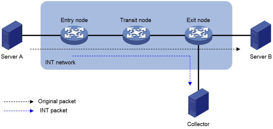

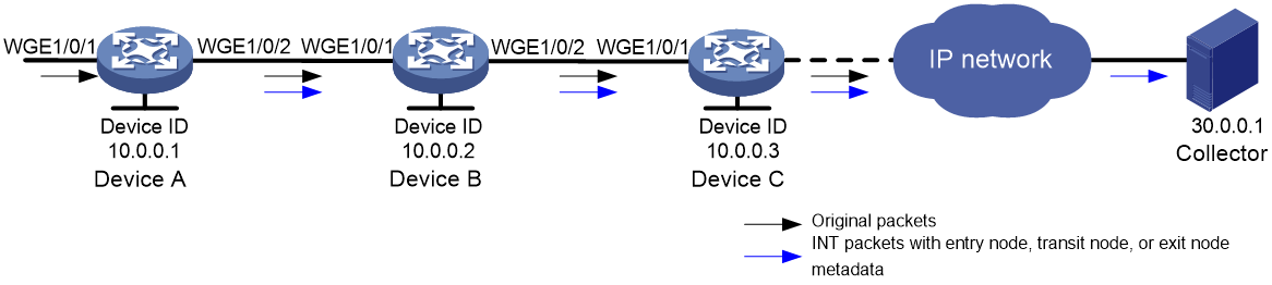

Flexible INT
As shown in Figure 3, the nodes in flexible INT perform the following functions:
1.     On the entry node, the ingress port uses an ACL to sample matching packets, and mirrors sampled packets to the INT processor. Then, the INT processor adds an INT header to the INT packet and loops it back to the ingress port. The ingress port identifies the looped-back INT packet according to an ACL and adds collected data to it, and forwards it. The egress port adds collected data to the INT packet and sends it to the transit node.
2.     On the transit node, the ingress port uses an ACL to identify INT packets, adds collected data to INT packets, and forwards them to the egress port. The egress port adds collected data to INT packets and sends them to the exit node.
3.     On the exit node, the ingress port uses an ACL to identify INT packets  and mirrors them to the INT processor. The INT processor encapsulates the INT packets and sends them to the collector.
Figure 3 INT network diagram

As shown in Figure 4, configure common INT to test the link delay.
Figure 4 Network diagram
1.     Assign IP addresses to interfaces and configure routes. Make sure the network connections are available. (Details not shown.)
2.     Configure Device C:
# Specify 10.0.0.3 as the device ID of the exit node.
[DeviceC] telemetry ifa device-id 10.0.0.3
# Specify Twenty-FiveGigE 1/0/1 as the egress interface.
[DeviceC] interface twenty-fivegige 1/0/1
[DeviceC-Twenty-FiveGigE1/0/1] telemetry ifa role egress
[DeviceC-Twenty-FiveGigE1/0/1] quit
# Configure addressing parameters to encapsulate in INT packets sent to the collector.
[DeviceC] telemetry ifa collector source 20.0.0.2 destination 30.0.0.1 source-port 12 destination-port 14
# Enable INT globally.
[DeviceC] telemetry ifa global enable
3.     Configure Device B:
# Specify 10.0.0.2 as the device ID of the transit node.
<DeviceB> system-view
[DeviceB] telemetry ifa device-id 10.0.0.2
# Specify Twenty-FiveGigE 1/0/1 as the transit interface.
[DeviceB] interface twenty-fivegige 1/0/1
[DeviceB-Twenty-FiveGigE1/0/1] telemetry ifa role transit
[DeviceB-Twenty-FiveGigE1/0/1] quit
[DeviceB] telemetry ifa global enable
4.     Configure Device A:
# Specify 10.0.0.1 as the device ID of the entry node.
<DeviceA> system-view
[DeviceA] telemetry ifa device-id 10.0.0.1
# Specify Twenty-FiveGigE 1/0/1 as the ingress interface.
[DeviceA] interface twenty-fivegige 1/0/1
[DeviceA-Twenty-FiveGigE1/0/1] telemetry ifa role ingress
[DeviceA-Twenty-FiveGigE1/0/1] quit
# Enable internal loopback on Twenty-FiveGigE 1/0/3. You can enable internal loopback on any interface that is in the same port group as the ingress port.
[DeviceA] interface twenty-fivegige 1/0/3
[DeviceA-Twenty-FiveGigE1/0/3] telemetry ifa loopback
[DeviceA-Twenty-FiveGigE1/0/3] quit
# Create a sampler named samp in random sampling mode, and set the sampling rate to 8. One packet from 256 packets is selected.
[DeviceA] sampler samp mode random packet-interval n-power 8
# Create a traffic class named classifier1, and use destination MAC address a08c-fdd7-fd99 as the match criterion in the traffic class.
[DeviceA] traffic classifier classifier1
[DeviceA-classifier-classifier1] if-match destination-mac a08c-fdd7-fd99
[DeviceA-classifier-classifier1] quit
# Create a traffic behavior named behavior1, and configure the action of mirroring traffic to the INT processor.
[DeviceA] traffic behavior behavior1
[DeviceA-behavior-behavior1] mirror-to ifa-processor sampler samp
[DeviceA-behavior-behavior 1] quit
# Create a QoS policy named ifa1, and associate traffic class classifier1 with traffic behavior behavior1 in the QoS policy.
[DeviceA] qos policy ifa1
[DeviceA-qospolicy-ifa1] classifier classifier1 behavior behavior1
[DeviceA-qospolicy-ifa1] quit
# Apply QoS policy ifa1 to the incoming traffic of Twenty-FiveGigE 1/0/1.
[DeviceA-Twenty-FiveGigE1/0/1] qos apply policy ifa1 inbound
[DeviceA] telemetry ifa global enable
Verify the configuration
# Verify the configuration on Device A.
[DeviceA] display qos policy interface twenty-fivegige 1/0/1 inbound
Interface: Twenty-FiveGigE1/0/1
  Direction: Inbound
  Policy: ifa1
   Classifier: classifier1
     Operator: AND
     Rule(s) :
      If-match destination-mac a08c-fdd7-fd99
     Behavior: behavior1
      Mirroring:
        Mirror to the ifa-processor sampler samp
[DeviceA] display telemetry ifa
  Telemetry ifa status          : Enabled
  Telemetry ifa packet-drop     : Disabled
  Telemetry ifa device-id       : 10.0.0.1
  Telemetry ifa role:
    Twenty-FiveGigE1/0/1: Ingress
  Telemetry ifa loopback:
# Verify the configuration on Device B.
[DeviceB] display telemetry ifa
  Telemetry ifa device-id       : 10.0.0.2
  Telemetry ifa role:
    Twenty-FiveGigE1/0/1: Transit
# Verify the configuration on Device C.
[DeviceC] display telemetry ifa
  Telemetry ifa device-id       : 10.0.0.3
  Telemetry ifa role:
    Twenty-FiveGigE1/0/1: Egress
  Telemetry ifa collector:
    Source IP: 20.0.0.2
    Destination IP: 30.0.0.1
    Source-port: 12
    Destination-port: 14
Example: Configuring flexible INT
As shown in Figure 5, configure flexible INT to meet the following requirements:
·     Device C sends INT packets carrying entry node data and transit node data to the collector.
·     Device C sends INT packets carrying exit node data and original packets to the IP network, which sends the INT packets carrying exit node data to the collector.
Figure 5 Network diagram
<DeviceC> system-view
# Create user-defined ACL 5000, and configure a rule to match INT packets with source IP address 192.168.1.2.
[DeviceC] acl user-defined 5000
[DeviceC-acl-user-5000] rule permit tcp source 192.168.1.2 0 ifa l5 aaaaaaaabbbbbbbb ffffffffffffffff 0
[DeviceC-acl-user-5000] rule permit udp source 192.168.1.2 0 ifa l5 aaaaaaaabbbbbbbb ffffffffffffffff 0
[DeviceC-acl-user-5000] quit
# Configure the action of mirroring incoming INT packets on Twenty-FiveGigE 1/0/1 to the INT processor and dropping the original INT packets.
[DeviceC-Twenty-FiveGigE1/0/1] telemetry ifa 1 acl user-defined 5000 action mirror-to-processor drop
[DeviceB] acl user-defined 5000
[DeviceB-acl-user-5000] rule permit tcp source 192.168.1.2 0 ifa l5 aaaaaaaabbbbbbbb ffffffffffffffff 0
[DeviceB-acl-user-5000] rule permit udp source 192.168.1.2 0 ifa l5 aaaaaaaabbbbbbbb ffffffffffffffff 0
[DeviceB-acl-user-5000] quit
# Configure the action of mirroring INT packets on Twenty-FiveGigE 1/0/1 to the INT processor.
[DeviceB-Twenty-FiveGigE1/0/1] telemetry ifa 1 acl user-defined 5000 action add-metadata
# Create IPv4 basic ACL 2000, and configure a rule to match packets with source IP address 192.168.1.2.
[DeviceA] acl basic 2000
[DeviceA-acl-ipv4-basic-2000] rule permit source 192.168.1.2 0
[DeviceA-acl-ipv4-basic-2000] quit
# Configure the action of mirroring original packets on Twenty-FiveGigE 1/0/1 to the INT processor.
[DeviceA-Twenty-FiveGigE1/0/1] telemetry ifa 2 acl 2000 action mirror-to-processor sampler samp
[DeviceA] acl user-defined 5000
[DeviceA-acl-user-5000] rule permit tcp source 192.168.1.2 0 ifa l5 aaaaaaaabbbbbbbb ffffffffffffffff 0
[DeviceA-acl-user-5000] rule permit udp source 192.168.1.2 0 ifa l5 aaaaaaaabbbbbbbb ffffffffffffffff 0
[DeviceA-acl-user-5000] quit
# Configure the action of adding collected data to local loopback traffic.
[DeviceA-Twenty-FiveGigE1/0/1] telemetry ifa 3 acl user-defined 5000 local-loopback action add-metadata
  Telemetry ifa action:
      Telemetry ifa 1 acl 2000 action mirror-to-processor sampler samp
      Telemetry ifa 2 acl user-defined 5000 local-loopback action add-metadata
      Telemetry ifa 1 acl user-defined 5000 action add-metadata
      Telemetry ifa 1 acl user-defined 5000 action mirror-to-processor drop
    Source IP: 20.0.0.2
    Source-port: 12
