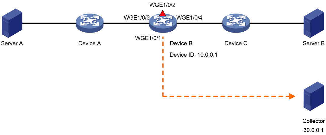

Telemetry stream is a network monitoring technology used to collect data from devices. It continuously streams data to a collector.
Telemetry stream supports collecting the input interface, timestamp, and output interface of traffic.

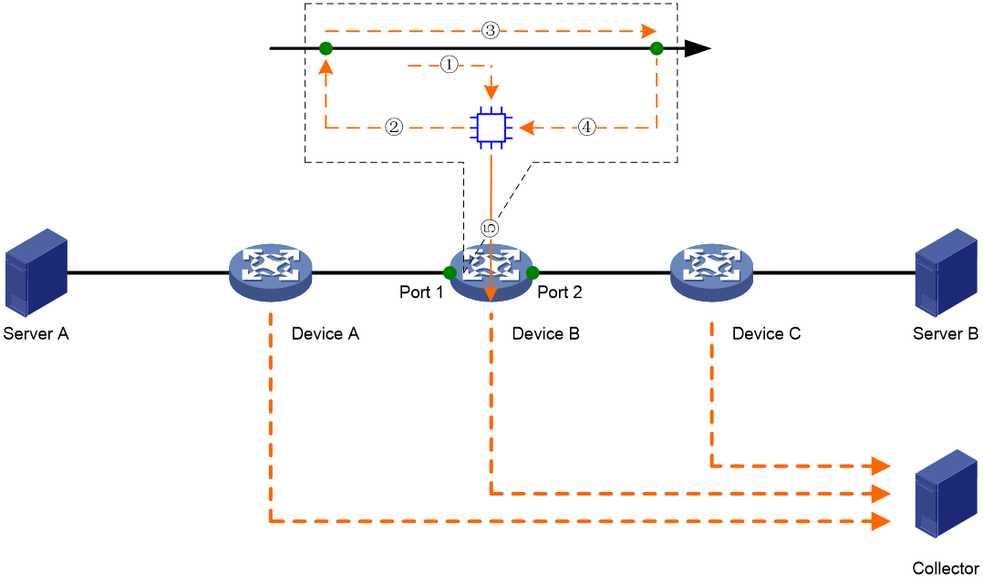

As shown in Figure 1, the working mechanism of telemetry stream is as follows:
1.     Telemetry stream samples a matching packet on the input interface and copies it to the telemetry stream processor in the device. The telemetry stream processor adds the input interface information to the packet.
2.     The telemetry stream processor loops the packet back to a service loopback group.
3.     The interface in the service loopback group identifies the looped-back packet, adds the timestamp information, and forwards it to the output interface according to the routing table.
4.     The output interface identifies the looped-back packet, adds the output interface and timestamp information to it, and sends it to the telemetry stream processor.
5.     The telemetry stream processor encapsulates the packet and routes it to the collector.
The collector can calculate the path and delay information according to the collected data from multiple nodes.
