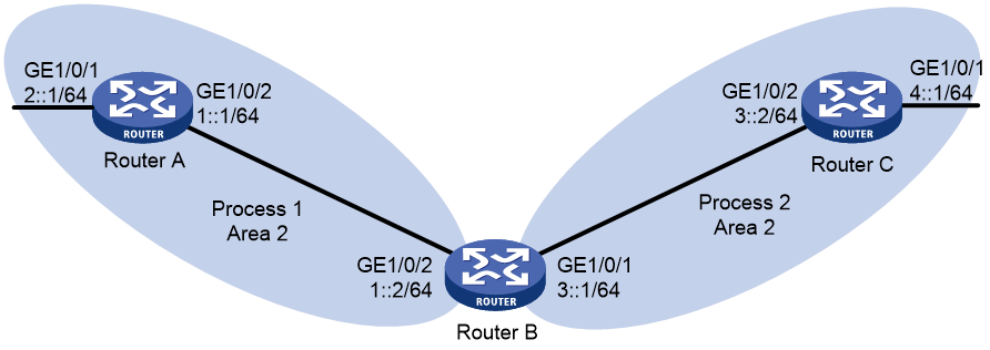

Enabling OSPFv3
To enable an OSPFv3 process on a router:
1.     Enable the OSPFv3 process globally.
2.     Assign the OSPFv3 process a router ID.
3.     Enable the OSPFv3 process on related interfaces.
An OSPFv3 process ID has only local significance. Process 1 on a router can exchange packets with process 2 on another router.
OSPFv3 requires you to manually specify a router ID for each router in an AS. Make sure all assigned router IDs in the AS are unique.
Restrictions and guideline
As a best practice, if a router runs multiple OSPFv3 processes, you should specify a unique router ID for each process.
2.     Enable an OSPFv3 process and enter its view.
ospfv3 [ process-id | vpn-instance vpn-instance-name ] *
By default, no OSPFv3 processes are enabled.
3.     Specify a router ID.
router-id router-id
By default, no router ID is configured.
4.     Enter interface view.
5.     Enable an OSPFv3 process on the interface.
ospfv3 process-id area area-id [ instance instance-id ]
By default, no OSPFv3 processes are enabled on an interface.

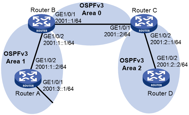

Configuring an OSPFv3 virtual link
You can configure a virtual link to maintain connectivity between a non-backbone area and the backbone, or in the backbone itself.
Both ends of a virtual link are ABRs that must be configured with the vlink-peer command.
2.     Enter OSPFv3 view.
3.     Enter OSPFv3 area view.
area area-id
4.     Configure a virtual link.
vlink-peer router-id [ dead seconds | hello seconds | instance instance-id | ipsec-profile profile-name | keychain keychain-name | retransmit seconds | trans-delay seconds ] *

Example: Configuring OSPFv3 stub area
As shown in Figure 2:
·     Enable OSPFv3 on all routers.
·     Split the AS into three areas.
·     Configure Router B and Router C as ABRs to forward routing information between areas.
·     Configure Area 2 as a stub area to reduce LSAs in the area without affecting route reachability.
Figure 2 Network diagram
1.     Configure IPv6 addresses for interfaces. (Details not shown.)
2.     Configure basic OSPFv3:
# On Router A, enable OSPFv3 and specify the router ID as 1.1.1.1.
<RouterA> system-view
[RouterA] ospfv3 1
[RouterA-ospfv3-1] router-id 1.1.1.1
[RouterA-ospfv3-1] quit
[RouterA] interface gigabitethernet 1/0/1
[RouterA-GigabitEthernet1/0/1] ospfv3 1 area 1
[RouterA-GigabitEthernet1/0/1] quit
[RouterA] interface gigabitethernet 1/0/2
[RouterA-GigabitEthernet1/0/2] ospfv3 1 area 1
[RouterA-GigabitEthernet1/0/2] quit
# On Router B, enable OSPFv3 and specify the router ID as 2.2.2.2.
<RouterB> system-view
[RouterB] ospfv3 1
[RouterB-ospfv3-1] router-id 2.2.2.2
[RouterB-ospfv3-1] quit
[RouterB-GigabitEthernet1/0/1] ospfv3 1 area 0
[RouterB-GigabitEthernet1/0/1] quit
[RouterB] interface gigabitethernet 1/0/2
[RouterB-GigabitEthernet1/0/2] ospfv3 1 area 1
[RouterB-GigabitEthernet1/0/2] quit
# On Router C, enable OSPFv3 and specify the router ID as 3.3.3.3.
<RouterC> system-view
[RouterC] ospfv3 1
[RouterC-ospfv3-1] router-id 3.3.3.3
[RouterC-ospfv3-1] quit
[RouterC] interface gigabitethernet 1/0/1
[RouterC-GigabitEthernet1/0/1] ospfv3 1 area 0
[RouterC-GigabitEthernet1/0/1] quit
[RouterC] interface gigabitethernet 1/0/2
[RouterC-GigabitEthernet1/0/2] ospfv3 1 area 2
[RouterC-GigabitEthernet1/0/2] quit
# On Router D, enable OSPFv3 and specify the router ID as 4.4.4.4.
<RouterD> system-view
[RouterD] ospfv3 1
[RouterD-ospfv3-1] router-id 4.4.4.4
[RouterD-ospfv3-1] quit
[RouterD] interface gigabitethernet 1/0/2
[RouterD-GigabitEthernet1/0/2] ospfv3 1 area 2
[RouterD-GigabitEthernet1/0/2] quit
# Display OSPFv3 neighbors on Router B.
[RouterB] display ospfv3 peer
               OSPFv3 Process 1 with Router ID 2.2.2.2
 Area: 0.0.0.0
 Router ID       Pri State             Dead-Time InstID Interface
 3.3.3.3         1   Full/BDR          00:00:40  0      GE1/0/1
 Area: 0.0.0.1
 1.1.1.1         1   Full/DR           00:00:40  0      GE1/0/2
# Display OSPFv3 neighbors on Router C.
[RouterC] display ospfv3 peer
               OSPFv3 Process 1 with Router ID 3.3.3.3
 Area: 0.0.0.0
 2.2.2.2         1   Full/DR           00:00:40  0      GE1/0/1
 Area: 0.0.0.2
 4.4.4.4         1   Full/BDR          00:00:40  0      GE1/0/2
# Display OSPFv3 neighbors on Router D.
[RouterD] display ospfv3 routing
               OSPFv3 Process 1 with Router ID 4.4.4.4
 I  - Intra area route,  E1 - Type 1 external route,  N1 - Type 1 NSSA route
 IA - Inter area route,  E2 - Type 2 external route,  N2 - Type 2 NSSA route
 *  - Selected route
*Destination: 2001::/64
  Type       : IA                        Area       : 0.0.0.2
  AdvRouter  : 3.3.3.3                   Preference : 10
  NibID      : 0x23000004                Cost       : 2
  Interface  : GE1/0/2                   BkInterface: N/A
  Nexthop    : FE80::48C0:26FF:FEDA:305
  BkNexthop  : N/A
 *Destination: 2001:1::/64
  NibID      : 0x23000004                Cost       : 3
  BkNexthop  : N/A
 *Destination: 2001:2::/64
  Type       : I                         Area       : 0.0.0.2
  AdvRouter  : 4.4.4.4                   Preference : 10
  NibID      : 0x23000002                Cost       : 1

Example: Configuring OSPFv3 NSSA area
As shown in Figure 3:
·     Configure OSPFv3 on all routers and split the AS into three areas.
·     Configure Area 1 as an NSSA area and configure Router A as an ASBR to redistribute static routes into the AS.
Figure 3 Network diagram
2.     Configure basic OSPFv3 (see "Example: Configuring OSPFv3 stub area").
3.     Configure Area 1 as an NSSA area:

Example: Configuring OSPFv3 route redistribution
As shown in Figure 5:
·     Router A, Router B, and Router C are in Area 2.
·     OSPFv3 process 1 and OSPFv3 process 2 run on Router B. Router B communicates with Router A and Router C through OSPFv3 process 1 and OSPFv3 process 2.
·     Configure OSPFv3 process 2 to redistribute direct routes and the routes from OSPFv3 process 1 on Router B, and set the cost for redistributed routes to 3. Router C can then learn the routes destined for 1::0/64 and 2::0/64, and Router A cannot learn the routes destined for 3::0/64 or 4::0/64.
Figure 5 Network diagram
# Enable OSPFv3 process 1 on Router A.
[RouterA] ospfv3 1
[RouterA-GigabitEthernet1/0/2] ospfv3 1 area 2
[RouterA-GigabitEthernet1/0/1] ospfv3 1 area 2
# Enable OSPFv3 process 1 and OSPFv3 process 2 on Router B.
[RouterB] ospfv3 1
[RouterB-GigabitEthernet1/0/2] ospfv3 1 area 2
[RouterB] ospfv3 2
[RouterB-ospfv3-2] router-id 3.3.3.3
[RouterB-ospfv3-2] quit
[RouterB-GigabitEthernet1/0/1] ospfv3 2 area 2
# Enable OSPFv3 process 2 on Router C.
[RouterC] ospfv3 2
[RouterC-ospfv3-2] router-id 4.4.4.4
[RouterC-ospfv3-2] quit
[RouterC-GigabitEthernet1/0/2] ospfv3 2 area 2
[RouterC-GigabitEthernet1/0/1] ospfv3 2 area 2
# Display the routing table on Router C.
[RouterC] display ipv6 routing-table
Destinations : 7 Routes : 7
Destination: ::1/128                                     Protocol  : Direct
NextHop    : ::1                                         Preference: 0
Interface  : InLoop0                                     Cost      : 0
Destination: 3::/64                                      Protocol  : Direct
NextHop    : ::                                          Preference: 0
Interface  : GE1/0/2                                     Cost      : 0
Destination: 3::2/128                                    Protocol  : Direct
Destination: 4::/64                                      Protocol  : Direct
Interface  : GE1/0/1                                     Cost      : 0
Destination: 4::1/128                                    Protocol  : Direct
Destination: FE80::/10                                   Protocol  : Direct
Interface  : NULL0                                       Cost      : 0
Destination: FF00::/8                                    Protocol  : Direct
3.     Configure OSPFv3 route redistribution:
# Configure OSPFv3 process 2 to redistribute direct routes and the routes from OSPFv3 process 1 on Router B, and set the cost for redistributed routes to 3.
[RouterB] ospfv3 2
[RouterB-ospfv3-2] import-route ospfv3 1 cost 3
[RouterB-ospfv3-2] import-route direct cost 3
Destinations : 9 Routes : 9
Destination: 1::/64                                      Protocol  : O_ASE2
NextHop    : FE80::200:CFF:FE01:1C03                     Preference: 150
Interface  : GE1/0/2                                     Cost      : 3
Destination: 2::/64                                      Protocol  : O_ASE2
Example: Configuring OSPFv3 route summarization
As shown in Figure 6:
·     OSPFv3 process 1 and OSPFv3 process 2 run on Router B. Router B communicates with Router A and Router C through OSPFv3 process 1 and OSPFv3 process 2, respectively.
·     On Router A, configure IPv6 addresses 2:1:1::1/64, 2:1:2::1/64, and 2:1:3::1/64 for GigabitEthernet 1/0/1.
·     On Router B, configure OSPFv3 process 2 to redistribute direct routes and the routes from OSPFv3 process 1. Router C can then learn the routes destined for 2::/64, 2:1:1::/64, 2:1:2::/64, and 2:1:3::/64.
·     On Router B, configure route summarization to advertise only summary route 2::/16 to Router C.
Figure 6 Network diagram
2.     Configure OSPFv3:
[RouterA] ospfv3 1
[RouterA-GigabitEthernet1/0/1] ipv6 address 2:1:1::1 64
[RouterA-GigabitEthernet1/0/1] ipv6 address 2:1:2::1 64
[RouterA-GigabitEthernet1/0/1] ipv6 address 2:1:3::1 64
[RouterB] ospfv3 1
[RouterB] ospfv3 2
[RouterC] ospfv3 2
# Configure OSPFv3 process 2 to redistribute direct routes and the routes from OSPFv3 process 1 on Router B.
[RouterB] ospfv3 2
Destinations : 12 Routes : 12
Interface  : GE1/0/2                                     Cost      : 1
Destination: 2:1:1::/64                                  Protocol  : O_ASE2
Destination: 2:1:2::/64                                  Protocol  : O_ASE2
Destination: 2:1:3::/64                                  Protocol  : O_ASE2
NextHop    : 3::2                                        Preference: 0
NextHop    : 4::1                                        Preference: 0
4.     Configure ASBR route summarization:
# On Router B, configure OSPFv3 process 2 to advertise a summary route 2::/16.
[RouterB] ospfv3 2
[RouterB-ospfv3-2] asbr-summary 2:: 16
Destination: 2::/16                                      Protocol  : O_ASE2

Example: Configuring OSPFv3 IPsec profile
As shown in Figure 11, all routers run OSPFv3, and the AS is divided into two areas.
Configure IPsec profiles on the routers to authenticate and encrypt protocol packets.
Figure 11 Network diagram
2.     Configure OSPFv3 basic features:
[RouterA] ospfv3 1
[RouterB] ospfv3 1
[RouterC] ospfv3 1
3.     Configure OSPFv3 IPsec profiles:
¡     On Router A:
# Create an IPsec transform set named trans.
[RouterA] ipsec transform-set trans
# Specify the encapsulation mode as transport.
[RouterA-ipsec-transform-set-trans] encapsulation-mode transport
# Specify the ESP encryption and authentication algorithms.
[RouterA-ipsec-transform-set-trans] protocol esp
[RouterA-ipsec-transform-set-trans] esp encryption-algorithm aes-cbc-128
[RouterA-ipsec-transform-set-trans] esp authentication-algorithm sha1
[RouterA-ipsec-transform-set-trans] quit
# Create a manual IPsec profile named profile001.
[RouterA] ipsec profile profile001 manual
# Use IPsec transform set trans.
[RouterA-ipsec-profile-manual-profile001] transform-set trans
# Configure the inbound and outbound SPIs for ESP.
[RouterA-ipsec-profile-manual-profile001] sa spi outbound esp 123456
[RouterA-ipsec-profile-manual-profile001] sa spi inbound esp 123456
# Configure the inbound and outbound SA keys for ESP.
[RouterA-ipsec-profile-manual-profile001] sa string-key outbound esp simple abcdefg
[RouterA-ipsec-profile-manual-profile001] sa string-key inbound esp simple abcdefg
[RouterA-ipsec-profile-manual-profile001] quit
¡     On Router B:
[RouterB] ipsec transform-set trans
[RouterB-ipsec-transform-set-trans] encapsulation-mode transport
[RouterB-ipsec-transform-set-trans] protocol esp
[RouterB-ipsec-transform-set-trans] esp encryption-algorithm aes-cbc-128
[RouterB-ipsec-transform-set-trans] esp authentication-algorithm sha1
[RouterB-ipsec-transform-set-trans] quit
[RouterB] ipsec profile profile001 manual
[RouterB-ipsec-profile-manual-profile001] transform-set trans
[RouterB-ipsec-profile-manual-profile001] sa spi outbound esp 123456
[RouterB-ipsec-profile-manual-profile001] sa spi inbound esp 123456
[RouterB-ipsec-profile-manual-profile001] sa string-key outbound esp simple abcdefg
[RouterB-ipsec-profile-manual-profile001] sa string-key inbound esp simple abcdefg
[RouterB-ipsec-profile-manual-profile001] quit
# Create a manual IPsec profile named profile002.
[RouterB] ipsec profile profile002 manual
[RouterB-ipsec-profile-manual-profile002] transform-set trans
[RouterB-ipsec-profile-manual-profile002] sa spi outbound esp 256
[RouterB-ipsec-profile-manual-profile002] sa spi inbound esp 256
[RouterB-ipsec-profile-manual-profile002] sa string-key outbound esp simple byebye
[RouterB-ipsec-profile-manual-profile002] sa string-key inbound esp simple byebye
[RouterB-ipsec-profile-manual-profile002] quit
¡     On Router C:
[RouterC] ipsec transform-set trans
[RouterC-ipsec-transform-set-trans] encapsulation-mode transport
[RouterC-ipsec-transform-set-trans] protocol esp
[RouterC-ipsec-transform-set-trans] esp encryption-algorithm aes-cbc-128
[RouterC-ipsec-transform-set-trans] esp authentication-algorithm sha1
[RouterC-ipsec-transform-set-trans] quit
[RouterC] ipsec profile profile002 manual
[RouterC-ipsec-profile-manual-profile002] transform-set trans
[RouterC-ipsec-profile-manual-profile002] sa spi outbound esp 256
[RouterC-ipsec-profile-manual-profile002] sa spi inbound esp 256
[RouterC-ipsec-profile-manual-profile002] sa string-key outbound esp simple byebye
[RouterC-ipsec-profile-manual-profile002] sa string-key inbound esp simple byebye
[RouterC-ipsec-profile-manual-profile002] quit
4.     Apply the IPsec profiles to areas:
# Configure Router A.
[RouterA] ospfv3 1
[RouterA-ospfv3-1] area 1
[RouterA-ospfv3-1-area-0.0.0.1] enable ipsec-profile profile001
[RouterA-ospfv3-1-area-0.0.0.1] quit
# Configure Router B.
[RouterB] ospfv3 1
[RouterB-ospfv3-1] area 0
[RouterB-ospfv3-1-area-0.0.0.0] enable ipsec-profile profile002
[RouterB-ospfv3-1-area-0.0.0.0] quit
[RouterB-ospfv3-1] area 1
[RouterB-ospfv3-1-area-0.0.0.1] enable ipsec-profile profile001
[RouterB-ospfv3-1-area-0.0.0.1] quit
# Configure Router C.
[RouterC] ospfv3 1
[RouterC-ospfv3-1] area 0
[RouterC-ospfv3-1-area-0.0.0.0] enable ipsec-profile profile002
[RouterC-ospfv3-1-area-0.0.0.0] quit
# Verify that OSPFv3 packets between Routers A, B, and C are protected by IPsec. (Details not shown.)
