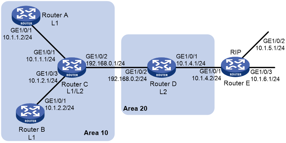

IS-IS topology
Figure 2 shows one IS-IS network topology. Area 1 is the backbone that comprises a set of Level-2 routers. The other four areas are non-backbone areas connected to the backbone through Level-1-2 routers.
Figure 2 IS-IS topology 1

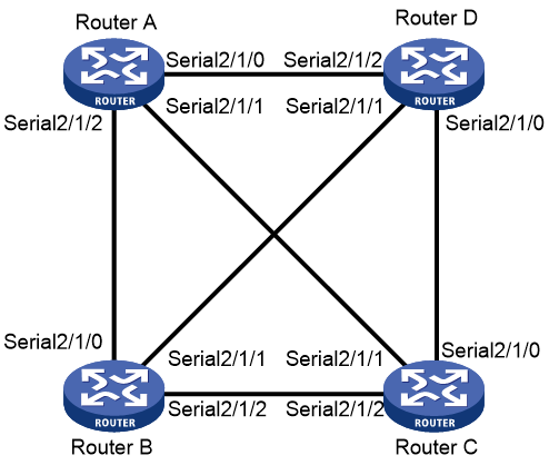

Figure 3 shows another IS-IS topology. No area is defined as the backbone in this topology. The backbone comprises all contiguous Level-2 and Level-1-2 routers in different areas. The IS-IS backbone does not need to be a specific area.
Figure 3 IS-IS topology 2
Both the Level-1 and Level-2 routers use the SPF algorithm to generate the shortest path tree.

Configuring IPv4 IS-IS MTR
Typically, service packets with the same destination are forwarded over the same link. To forward them over different links, you can use one of the following methods:
·     Policy-based routing (PBR). Use PBR to change the next hop.
·     Traffic engineering (TE).
·     Multi-Topology Routing (MTR).
MTR is based on topology and is easier to deploy than TE. MTR splits the topology of a specific address family (for example, IPv4) into multiple topologies, and forwards traffic on a per-topology basis.
Figure 7 Network diagram
As shown in Figure 7, the base topology is split into two topologies, topology A and topology B. You can forward voice traffic through topology A and video traffic through topology B.
Router B does not belong to topology A. In topology B, the links between Router A and Router D and the links between Router B and Router C do not exist. Route calculation and traffic forwarding are performed in each topology independently.
You must configure MTR before configuring IPv4 IS-IS MTR. For more information about MTR, see "Configuring MTR."

Figure 8 Network diagram
As shown in Figure 8, the numbers refer to the link costs. Router A, Router B, and Router D support both IPv4 and IPv6. Router C supports only IPv4 and cannot forward IPv6 packets.
Enable IPv6 IS-IS MTR on Router A, Router B, Router C, and Router D to make them perform route calculation separately in IPv4 and IPv6 topologies. With this configuration, Router A does not forward IPv6 packets destined to Router D through Router B, avoiding packet loss.
As a best practice to avoid route calculation failures, configure this feature when both IPv4 and IPv6 topologies exist in the network.

Limiting LSP flooding
In NBMA networks such as ATM and FR, many P2P links exist. As shown in Figure 9, Routers A, B, C and D run IS-IS. When Router A generates an LSP, it floods the LSP out of Serial2/1/0, Serial2/1/1, and Serial2/1/2. After Router D receives the LSP from Serial2/1/2, it floods it out of Serial2/1/0 and Serial2/1/1 to Router B and Router C. However, Router B and Router C have already received the LSP from Router A. Repeated LSP flooding consumes extra bandwidth.
Figure 9 Network diagram of a fully meshed network
To avoid this problem, you can add interfaces to a mesh group or block some interfaces.
·     An interface in a mesh group floods a received LSP only to interfaces not in the mesh group.
·     A blocked interface sends LSPs only after receiving LSP requests.
Before you configure this task, you must consider redundancy for interfaces in case LSP packets cannot be flooded because of link failures.

Configuring IS-IS FRR
About IS-IS FRR
IS-IS Fast Reroute (FRR) calculates a backup path based on the LSDB and saves the backup path information to the FIB. When the primary path fails, the system immediately switches traffic to the backup path to prevent traffic loss and reduce the route convergence time.
IS-IS supports Loop Free Alternate (LFA) FRR and remote LFA FRR.
The following IS-IS FRR traffic protection types are available:
·     Link protection—Protects traffic that traverses a specific link.
·     Node protection—Protects traffic that traverses a specific node.
Node protection takes precedence over link protection.
Configuring IS-IS LFA FRR
A link or router failure on a path can cause packet loss. IS-IS FRR enables fast rerouting to minimize the failover time.
Figure 10 Network diagram for IS-IS FRR
In Figure 10, after you enable FRR on Router B, IS-IS automatically calculates or designates a backup next hop when a link failure is detected. In this way, packets are directed to the backup next hop to reduce traffic recovery time. Meanwhile, IS-IS calculates the shortest path based on the new network topology, and forwards packets over the path after network convergence.
You can assign a backup next hop for IS-IS FRR through the following ways:
·     Enable IS-IS FRR to calculate a backup next hop through Loop Free Alternate (LFA) calculation.
·     Designate a backup next hop with a routing policy for routes matching specific criteria.
The LFA calculation of FRR and that of TE are mutually exclusive.

Configuring IS-IS remote LFA FRR
In a ring topology where IS-IS LFA FRR cannot calculate the backup path, configure remote LFA FRR to ensure network reliability.
Remote LFA uses the following concepts:
·     P space—Use the source node of the protected link as the root to establish a shortest path tree. All nodes that are reachable from the source node without passing the protected link form the P space. Nodes in the P space are called P nodes.
·     Extended P space—Use the source node of the protected link and its neighbors as the roots to establish shortest path trees. All nodes that are reachable from the source node or one of its neighbors without passing the protected link form the extended P space. The P space is a subset of the extended P space.
·     Q space—Use the destination node of the protected link as the root to establish a reverse shortest path tree. All nodes that are reachable from the root node without passing the protected link form the Q space. Nodes in the Q space are called Q nodes.
·     PQ node—A PQ node refers to a node that resides in both the extended P space and the Q space. Remote LFA uses a PQ node as the destination node of a protected link.
As shown in Figure 11, the traffic forwarding path is PE 1—P 1—P 2—PE 2. To avoid traffic loss caused by link failures between P 1 and P 2, the system establishes an LDP tunnel between P 1 and P 4, which is the PQ node. When the link between P 1 and P 2 fails, P 1 encapsulates IP packets in MPLS packets and sends the MPLS packets to P 4 through the LDP tunnel. After receiving the MPLS packets, P 4 removes the MPLS labels of the packets and then forwards the packets to the next hop based on the IP routing table.
The system determines P 4 as the PQ node as follows:
1.     Uses P 1 (source node of the protected link) and its neighbors except P 2 (which passes the protected link) as the roots to establish shortest path trees.
2.     Finds out all nodes that are reachable from P 1 or one of its neighbors without passing the protected link, which are PE 1, P 1, P 3, and P 4.
These nodes form the extended P space.
3.     Uses P 2 (destination node of the protected link) as the root to establish a reverse shortest path tree.
4.     Finds out all nodes that are reachable from P 2 without passing the protected link, which are PE 2 and P 4.
These nodes form the Q space.
5.     Finds out all nodes that reside in both the extended P space and the Q space.
Only P 4 resides in both the extended P space and the Q space, so P 4 is the PQ node of the protected link.
Figure 11 Network diagram for IS-IS remote LFA FRR

Example: Configuring basic IS-IS
As shown in Figure 12, Router A, Router B, Router C, and Router D reside in an AS.
Router A and Router B are Level-1 routers, Router D is a Level-2 router, and Router C is a Level-1-2 router connecting two areas. Router A, Router B, and Router C are in area 10, and Router D is in area 20.
Figure 12 Network diagram
1.     Configure IP addresses for interfaces. (Details not shown.)
2.     Configure IS-IS:
# Configure Router A
<RouterA> system-view
[RouterA] isis 1
[RouterA-isis-1] is-level level-1
[RouterA-isis-1] network-entity 10.0000.0000.0001.00
[RouterA-isis-1] quit
[RouterA] interface gigabitethernet 1/0/1
[RouterA-GigabitEthernet1/0/1] isis enable 1
[RouterA-GigabitEthernet1/0/1] quit
# Configure Router B.
<RouterB> system-view
[RouterB] isis 1
[RouterB-isis-1] is-level level-1
[RouterB-isis-1] network-entity 10.0000.0000.0002.00
[RouterB-isis-1] quit
[RouterB-GigabitEthernet1/0/1] isis enable 1
[RouterB-GigabitEthernet1/0/1] quit
# Configure Router C.
<RouterC> system-view
[RouterC] isis 1
[RouterC-isis-1] network-entity 10.0000.0000.0003.00
[RouterC-isis-1] quit
[RouterC] interface gigabitethernet 1/0/3
[RouterC-GigabitEthernet1/0/3] isis enable 1
[RouterC-GigabitEthernet1/0/3] quit
[RouterC] interface gigabitethernet 1/0/1
[RouterC-GigabitEthernet1/0/1] isis enable 1
[RouterC-GigabitEthernet1/0/1] quit
[RouterC] interface gigabitethernet 1/0/2
[RouterC-GigabitEthernet1/0/2] isis enable 1
[RouterC-GigabitEthernet1/0/2] quit
# Configure Router D
<RouterD> system-view
[RouterD] isis 1
[RouterD-isis-1] is-level level-2
[RouterD-isis-1] network-entity 20.0000.0000.0004.00
[RouterD-isis-1] quit
[RouterD] interface gigabitethernet 1/0/1
[RouterD-GigabitEthernet1/0/1] isis enable 1
[RouterD-GigabitEthernet1/0/1] quit
[RouterD] interface gigabitethernet 1/0/2
[RouterD-GigabitEthernet1/0/2] isis enable 1
[RouterD-GigabitEthernet1/0/2] quit
# Display the IS-IS LSDB information.
[RouterA] display isis lsdb
                        Database information for ISIS(1)
                          Level-1 Link State Database
LSPID                 Seq Num      Checksum      Holdtime      Length  ATT/P/OL
0000.0000.0001.00-00* 0x00000004   0xdf5e        1096          68      0/0/0
0000.0000.0002.00-00  0x00000004   0xee4d        1102          68      0/0/0
0000.0000.0002.01-00  0x00000001   0xdaaf        1102          55      0/0/0
0000.0000.0003.00-00  0x00000009   0xcaa3        1161          111     1/0/0
0000.0000.0003.01-00  0x00000001   0xadda        1112          55      0/0/0
    *-Self LSP, +-Self LSP(Extended), ATT-Attached, P-Partition, OL-Overload
[RouterB] display isis lsdb
0000.0000.0001.00-00  0x00000006   0xdb60        988           68      0/0/0
0000.0000.0002.00-00* 0x00000008   0xe651        1189          68      0/0/0
0000.0000.0002.01-00* 0x00000005   0xd2b3        1188          55      0/0/0
0000.0000.0003.00-00  0x00000014   0x194a        1190          111     1/0/0
0000.0000.0003.01-00  0x00000002   0xabdb        995           55      0/0/0

# Display the IS-IS routing information on each router.
[RouterA] display isis route
                         Route information for IS-IS(1)
                         Level-1 IPv4 Forwarding Table
 IPv4 Destination     IntCost    ExtCost ExitInterface   NextHop         Flags
 10.1.1.0/24          10         NULL    GE1/0/1         Direct          D/L/-
 10.1.2.0/24          20         NULL    GE1/0/1         10.1.1.1        R/-/-
 192.168.0.0/24       20         NULL    GE1/0/1         10.1.1.1        R/-/-
 0.0.0.0/0            10         NULL    GE1/0/1         10.1.1.1        R/-/-
      Flags: D-Direct, R-Added to Rib, L-Advertised in LSPs, U-Up/Down Bit Set
[RouterC] display isis route
 10.1.2.0/24          10         NULL    GE1/0/3         Direct          D/L/-
 192.168.0.0/24       10         NULL    GE1/0/2         Direct          D/L/-
                         Level-2 IPv4 Forwarding Table
 10.1.1.0/24          10         NULL                                    D/L/-
 10.1.2.0/24          10         NULL                                    D/L/-
 192.168.0.0/24       10         NULL                                    D/L/-
 172.16.0.0/16        20         NULL    GE1/0/2         192.168.0.2     R/-/-
[RouterD] display isis route
 10.1.1.0/24          20         NULL    GE1/0/2         192.168.0.1     R/-/-
 10.1.2.0/24          20         NULL    GE1/0/2         192.168.0.1     R/-/-
 172.16.0.0/16        10         NULL    GE1/0/1         Direct          D/L/-
The output shows that the routing table of Level-1 routers contains a default route with the next hop as the Level-1-2 router. The routing table of Level-2 router contains all Level-1 and Level-2 routes.
Example: Configuring DIS election
As shown in Figure 13, on a broadcast network (Ethernet), Router A, Router B, Router C, and Router D reside in IS-IS Area 10. Router A and Router B are Level-1-2 routers, Router C is a Level-1 router, and Router D is a Level-2 router.
Change the DIS priority of Router A to make it elected as the Level-1-2 DIS router.
Figure 13 Network diagram
2.     Enable IS-IS:
# Configure Router A.
[RouterA] isis 1
[RouterB] isis 1
[RouterC] isis 1
[RouterC-isis-1] is-level level-1
# Configure Router D.
[RouterD] isis 1
[RouterD-isis-1] network-entity 10.0000.0000.0004.00
# Display information about IS-IS neighbors of Router A.
[RouterA] display isis peer
                          Peer information for IS-IS(1)
 System ID: 0000.0000.0002
 Interface: GE1/0/1                 Circuit Id:  0000.0000.0003.01
 State: Up     HoldTime: 21s        Type: L1(L1L2)     PRI: 64
 System ID: 0000.0000.0003
 State: Up     HoldTime: 6s         Type: L1           PRI: 64
 Interface: GE1/0/1                 Circuit Id:  0000.0000.0004.01
 State: Up     HoldTime: 23s        Type: L2(L1L2)     PRI: 64
 System ID: 0000.0000.0004
 State: Up     HoldTime: 23s        Type: L2           PRI: 64
# Display information about IS-IS interfaces of Router A.
[RouterA] display isis interface
                       Interface information for IS-IS(1)
  Interface:  GigabitEthernet1/0/1
  Index     IPv4 state      IPv6 state     Circuit ID   MTU   Type   DIS
  00001     Up              Down           1            1497  L1/L2  No/No
# Display IS-IS interfaces of Router C.
[RouterC] display isis interface
  00001     Up              Down           1            1497  L1/L2  Yes/No
# Display information about IS-IS interfaces of Router D.
[RouterD] display isis interface
  00001     Up              Down           1            1497  L1/L2  No/Yes
The output shows that when the default DIS priority is used, Router C is the DIS for Level-1, and Router D is the DIS for Level-2. The pseudonodes of Level-1 and Level-2 are 0000.0000.0003.01 and 0000.0000.0004.01.
# Configure the DIS priority of Router A.
[RouterA-GigabitEthernet1/0/1] isis dis-priority 100
 Interface: GE1/0/1                 Circuit Id:  0000.0000.0001.01
 State: Up     HoldTime: 29s        Type: L1(L1L2)     PRI: 64
 State: Up     HoldTime: 22s        Type: L1           PRI: 64
 State: Up     HoldTime: 22s        Type: L2(L1L2)     PRI: 64
 State: Up     HoldTime: 22s        Type: L2           PRI: 64
  00001     Up              Down           1            1497  L1/L2  Yes/Yes
The output shows that after the DIS priority configuration, Router A becomes the DIS for Level-1-2, and the pseudonode is 0000.0000.0001.01.
# Display information about IS-IS neighbors and interfaces of Router C.
[RouterC] display isis peer
 System ID: 0000.0000.0001
 State: Up     HoldTime: 7s         Type: L1           PRI: 100
 State: Up     HoldTime: 23s        Type: L1           PRI: 64
  00  1     Up              Down           1            1497  L1/L2  No/No
# Display information about IS-IS neighbors and interfaces of Router D.
[RouterD] display isis peer
 State: Up     HoldTime: 7s         Type: L2           PRI: 100
 State: Up     HoldTime: 26s        Type: L2           PRI: 64

Redistribute RIP routes into IS-IS on Router D.
Figure 14 Network diagram
2.     Configure basic IS-IS:
[RouterA] isis 1
[RouterB] isis 1
[RouterC] isis 1
[RouterD] isis 1
# Display IS-IS routing information on each router.
 10.1.4.0/24          10         NULL                                    D/L/-
 10.1.4.0/24          10         NULL    GE1/0/1         Direct          D/L/-
3.     Configure RIPv2 on Router D and Router E, and configure IS-IS to redistribute RIP routes on Router D:
# Configure RIPv2 on Router D.
[RouterD] rip 1
[RouterD-rip-1] network 10.0.0.0
[RouterD-rip-1] version 2
[RouterD-rip-1] undo summary
# Configure RIPv2 on Router E.
[RouterE] rip 1
[RouterE-rip-1] network 10.0.0.0
[RouterE-rip-1] version 2
[RouterE-rip-1] undo summary
# On Router D, configure IS-IS to redistribute routes from RIP.
[RouterD-rip-1] quit
[RouterD] isis 1
[RouterD–isis-1] address-family ipv4
[RouterD–isis-1-ipv4] import-route rip level-2
# Display IS-IS routing information on Router C.
 10.1.4.0/24          20         NULL    GE1/0/2         192.168.0.2     R/L/-
 10.1.5.0/24          10         0       GE1/0/2         192.168.0.2     R/L/-
 10.1.6.0/24          10         0       GE1/0/2         192.168.0.2     R/L/-
Example: Configuring IS-IS authentication
As shown in Figure 15, Router A, Router B, Router C, and Router D reside in the same IS-IS routing domain.
Router A, Router B, and Router C belong to Area 10, and Router D belongs to Area 20.
·     Configure neighbor relationship authentication between neighbors.
·     Configure area authentication in Area 10 to prevent untrusted routes from entering into the area.
·     Configure routing domain authentication on Router C and Router D to prevent untrusted routes from entering the routing domain.
Figure 15 Network diagram
[RouterA] isis 1
[RouterB] isis 1
[RouterC] isis 1
[RouterD] isis 1
[RouterD-isis-1] network-entity 20.0000.0000.0001.00
3.     Configure neighbor relationship authentication between neighbors:
# Set the authentication mode to MD5 and set the plaintext key to eRq on GigabitEthernet 1/0/1 of Router A and on GigabitEthernet 1/0/3 of Router C.
[RouterA-GigabitEthernet1/0/1] isis authentication-mode md5 plain eRg
[RouterC-GigabitEthernet1/0/3] isis authentication-mode md5 plain eRg
# Set the authentication mode to MD5 and set the plaintext key to t5Hr on GigabitEthernet 1/0/1 of Router B and on GigabitEthernet 1/0/1 of Router C.
[RouterB-GigabitEthernet1/0/1] isis authentication-mode md5 plain t5Hr
[RouterC-GigabitEthernet1/0/1] isis authentication-mode md5 plain t5Hr
# Set the authentication mode to MD5 and set the plaintext key to hSec on GigabitEthernet 1/0/1 of Router D and on GigabitEthernet 1/0/2 of Router C.
[RouterC-GigabitEthernet1/0/2] isis authentication-mode md5 plain hSec
[RouterD-GigabitEthernet1/0/1] isis authentication-mode md5 plain hSec
4.     Set the area authentication mode to MD5 and set the plaintext key to 10Sec on Router A, Router B, and Router C.
[RouterA] isis 1
[RouterA-isis-1] area-authentication-mode md5 plain 10Sec
[RouterB] isis 1
[RouterB-isis-1] area-authentication-mode md5 plain 10Sec
[RouterC] isis 1
[RouterC-isis-1] area-authentication-mode md5 plain 10Sec
5.     Set routing domain authentication mode to MD5 and set the plaintext key to 1020Sec on Router C and Router D.
[RouterC] isis 1
[RouterC-isis-1] domain-authentication-mode md5 plain 1020Sec
[RouterD] isis 1
[RouterD-isis-1] domain-authentication-mode md5 plain 1020Sec

IPv6 IS-IS configuration examples
Example: Configuring IPv6 IS-IS basics
As shown in Figure 20, Router A, Router B, Router C, and Router D, all enabled with IPv6, reside in the same AS. Configure IPv6 IS-IS on the routers so that they can reach each other.
Router A and Router B are Level-1 routers, Router D is a Level-2 router, and Router C is a Level-1-2 router.
Figure 20 Network diagram
1.     Configure IPv6 addresses for interfaces. (Details not shown.)
2.     Configure IPv6 IS-IS:
[RouterA] isis 1
[RouterA-isis-1] address-family ipv6
[RouterA-isis-1-ipv6] quit
[RouterA-GigabitEthernet1/0/1] isis ipv6 enable 1
[RouterB] isis 1
[RouterB-isis-1] address-family ipv6
[RouterB-isis-1-ipv6] quit
[RouterB-GigabitEthernet1/0/1] isis ipv6 enable 1
[RouterC] isis 1
[RouterC-isis-1] address-family ipv6
[RouterC-isis-1-ipv6] quit
[RouterC-GigabitEthernet1/0/1] isis ipv6 enable 1
[RouterC-GigabitEthernet1/0/2] isis ipv6 enable 1
[RouterC-GigabitEthernet1/0/3] isis ipv6 enable 1
[RouterD] isis 1
[RouterD-isis-1] address-family ipv6
[RouterD-isis-1-ipv6] quit
[RouterD-GigabitEthernet1/0/1] isis ipv6 enable 1
[RouterD-GigabitEthernet1/0/2] isis ipv6 enable 1
<RouterA>system-view
[RouterA] isis 1
[RouterA-isis-1-ipv6] fast-reroute lfa
[RouterB] isis 1
[RouterB-isis-1-ipv6] fast-reroute lfa
¡     (Method 2.) Enable IPv6 IS-IS FRR to designate a backup next hop by using a routing policy:
[RouterA] ipv6 prefix-list abc index 10 permit 20::1 128
[RouterA] route-policy frr permit node 10
[RouterA-route-policy-frr-10] if-match ipv6 address prefix-list abc
[RouterA-route-policy-frr-10] apply ipv6 fast-reroute backup-interface gigabitethernet 1/0/1 backup-nexthop 1::2
[RouterA-route-policy-frr-10] quit
[RouterA] isis 1
[RouterA-isis-1-ipv6] fast-reroute route-policy frr
[RouterB] ipv6 prefix-list abc index 10 permit 10::1 128
[RouterB] route-policy frr permit node 10
[RouterB-route-policy-frr-10] if-match ipv6 address prefix-list abc
[RouterB-route-policy-frr-10] apply ipv6 fast-reroute backup-interface gigabitethernet 1/0/1 backup-nexthop 3::2
[RouterB-route-policy-frr-10] quit
[RouterB] isis 1
[RouterB-isis-1-ipv6] fast-reroute route-policy frr
# Display route 20::1/128 on Router A to view the backup next hop information.
[RouterA] display ipv6 routing-table 20::1 128 verbose
Summary count : 1
Destination: 20::1/128
    Protocol: IS_L1
  Process ID: 1
   SubProtID: 0x1                       Age: 00h27m45s
        Cost: 10                 Preference: 15
       IpPre: N/A                QosLocalID: N/A
         Tag: 0                       State: Active Adv
   OrigTblID: 0xa                   OrigVrf: default-vrf
     TableID: 0xa                    OrigAs: 0
       NibID: 0x24000005             LastAs: 0
      AttrID: 0xffffffff           Neighbor: ::
       Flags: 0x10041           OrigNextHop: FE80::34CD:9FF:FE2F:D02
       Label: NULL              RealNextHop: FE80::34CD:9FF:FE2F:D02
     BkLabel: NULL                BkNextHop: FE80::7685:45FF:FEAD:102
     SRLabel: NULL                Interface: GigabitEthernet1/0/2
   BkSRLabel: NULL              BkInterface: GigabitEthernet1/0/1
   SIDIndex: NULL                  InLabel: NULL
  Tunnel ID: Invalid           IPInterface: GigabitEthernet1/0/2
 BkTunnel ID: Invalid         BkIPInterface: GigabitEthernet1/0/1
    FtnIndex: 0x0            ColorInterface: N/A
TrafficIndex: N/A          BkColorInterface: N/A
   Connector: N/A                 VpnPeerId: N/A
        Dscp: N/A                       Exp: N/A
  SRTunnelID: Invalid             StatFlags: 0x0
    SID Type: N/A                       SID: N/A
       BkSID: N/A                       NID: Invalid
    FlushNID: Invalid                 BkNID: Invalid
  BkFlushNID: Invalid
# Display route 10::1/128 on Router B to view the backup next hop information.
[RouterB] display ipv6 routing-table 10::1 128 verbose
Summary count : 1
Destination: 10::1/128
    Protocol: IS_L1
  Process ID: 1
   SubProtID: 0x1                       Age: 00h33m23s
       NibID: 0x24000006             LastAs: 0
       Flags: 0x10041           OrigNextHop: FE80::34CC:E8FF:FE5B:C02
       Label: NULL              RealNextHop: FE80::34CC:E8FF:FE5B:C02
        Dscp: N/A                       Exp: N/A
  BkFlushNID: Invalid
