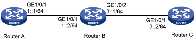

RIPng route summarization is interface-based. RIPng advertises a summary route based on the longest match.
RIPng route summarization improves network scalability, reduces routing table size, and increases routing table lookup efficiency.
RIPng advertises a summary route with the smallest metric of all the specific routes.
For example, RIPng has two specific routes to be advertised through an interface: 1:11:11::24 with a metric of a 2 and 1:11:12::34 with a metric of 3. Configure route summarization on the interface, so RIPng advertises a single route 11::0/16 with a metric of 2.

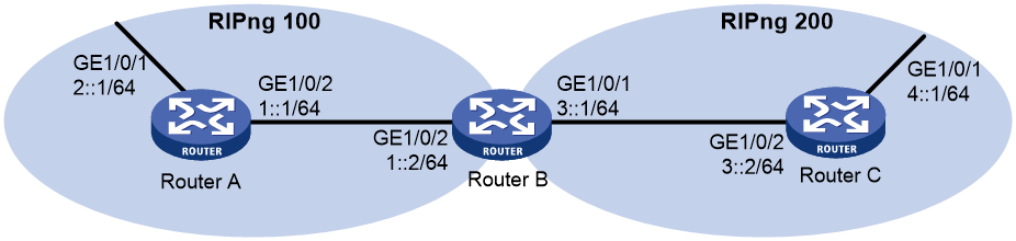

Configuring RIPng route redistribution
2.     Enter RIPng view.
ripng [ process-id ] [ vpn-instance vpn-instance-name ]
3.     Configure route redistribution.
¡     Redistribute routes from BGP4+.
import-route bgp4+ [ as-number ] [ allow-ibgp ] [ cost cost-value | route-policy route-policy-name ] *
¡     Redistribute direct or static routes.
import-route { direct | static } [ cost cost-value | route-policy route-policy-name ] *
¡     Redistribute routes from IPv6 IS-IS, OSPFv3, or other RIPng processes.
import-route { isisv6 | ospfv3 | ripng } [ process-id ] [ allow-direct | cost cost-value | route-policy route-policy-name ] *
By default, RIPng does not redistribute routes.
4.     (Optional.) Set a default routing metric for redistributed routes.
default cost cost-value
The default metric of redistributed routes is 0.

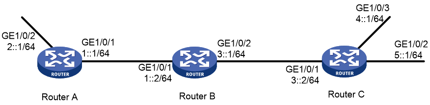

Restrictions and guidelines for split horizon and poison reverse
When you configure split horizon and poison reverse, following these restrictions and guidelines:
·     If both split horizon and poison reverse are configured, only the poison reverse feature takes effect.
·     Split horizon disables RIPng from sending routes through the interface where the routes were learned to prevent routing loops between neighbors. As a best practice, enable split horizon to prevent routing loops in normal cases.
·     Poison reverse enables a route learned from an interface to be advertised through the interface. However, the metric of the route is set to 16, which means the route is unreachable.

Figure 1 Network diagram for RIPng FRR
As shown in Figure 1, configure FRR on Router B by using a routing policy to specify a backup next hop. When the primary link fails, RIPng directs packets to the backup next hop. At the same time, RIPng calculates the shortest path based on the new network topology. Then, the device forwards packets over that path after network convergence.

As shown in Figure 2, Router A, Router B, and Router C learn IPv6 routing information through RIPng. Configure route filtering on Router B to accept all received routes except the route 2::/64 and to advertise only the route 4::/64.
Figure 2 Network diagram

As shown in Figure 3, Router B communicates with Router A through RIPng 100 and with Router C through RIPng 200.
Configure route redistribution on Router B, so the two RIPng processes can redistribute routes from each other.
Figure 3 Network diagram

<RouterA> system-view
[RouterA] ripng 100
[RouterA-ripng-100] quit
[RouterA] interface gigabitethernet 1/0/1
[RouterA-GigabitEthernet1/0/1] ripng 100 enable
[RouterA-GigabitEthernet1/0/1] quit
[RouterA] interface gigabitethernet 1/0/2
[RouterA-GigabitEthernet1/0/2] ripng 100 enable
# Enable RIPng 100 and RIPng 200 on Router B.
<RouterB> system-view
[RouterB] ripng 100
[RouterB-ripng-100] quit
[RouterB] interface gigabitethernet 1/0/2
[RouterB-GigabitEthernet1/0/2] ripng 100 enable
[RouterB-GigabitEthernet1/0/2] quit
[RouterB] ripng 200
[RouterB-ripng-200] quit
[RouterB-GigabitEthernet1/0/1] ripng 200 enable
#  Enable RIPng 200 on Router C.
<RouterC> system-view
[RouterC] ripng 200
[RouterC] interface gigabitethernet 1/0/1
[RouterC-GigabitEthernet1/0/1] ripng 200 enable
[RouterC-GigabitEthernet1/0/1] quit
[RouterC] interface gigabitethernet 1/0/2
[RouterC-GigabitEthernet1/0/2] ripng 200 enable
[RouterC-GigabitEthernet1/0/2] quit
# Display the routing table on Router A.
[RouterA] display ipv6 routing-table
Destinations : 7 Routes : 7
Destination: ::1/128                                     Protocol  : Direct
NextHop    : ::1                                         Preference: 0
Interface  : InLoop0                                     Cost      : 0
Destination: 1::/64                                      Protocol  : Direct
NextHop    : 1::1                                        Preference: 0
Interface  : GE1/0/2                                     Cost      : 0
Destination: 1::1/128                                    Protocol  : Direct
Destination: 2::/64                                      Protocol  : Direct
NextHop    : ::                                          Preference: 0
Interface  : GE1/0/1                                     Cost      : 0
Destination: 2::1/128                                    Protocol  : Direct
Destination: FE80::/10                                   Protocol  : Direct
Interface  : NULL0                                       Cost      : 0
Destination: FF00::/8                                    Protocol  : Direct
3.     Configure RIPng route redistribution:
# Configure route redistribution between the two RIPng processes on Router B.
[RouterB] ripng 100
[RouterB-ripng-100] import-route ripng 200
[RouterB] ripng 200
[RouterB-ripng-200] import-route ripng 100

Example: Configuring RIPng GR
As shown in Figure 4, Router A, Router B, and Router C learn IPv6 routing information through RIPng.
Configure Router A as the GR restarter. Configure Router B and Router C as the GR helpers to synchronize their routing tables with Router A by using GR.
Figure 4 Network diagram
1.     Configure IPv6 addresses for the interfaces. (Details not shown.)
2.     Configure RIPng on the routers to ensure the following: (Details not shown.)
¡     Router A, Router B, and Router C can communicate with each other at Layer 3.
¡     Dynamic route update can be implemented among them with RIPng.
3.     Enable RIPng GR on Router A.
[RouterA] ripng 1
[RouterA-ripng-1] graceful-restart
# Restart RIPng or trigger an active/standby switchover, and then display GR status on Router A.
<RouterA> display ripng 1 graceful-restart
RIPng process: 1
 Graceful Restart capability    : Enabled
 Current GR state               : Normal
 Graceful Restart period        : 60  seconds
 Graceful Restart remaining time: 0   seconds
Example: Configuring RIPng NSR
As shown in Figure 5, Router S, Router A, and Router B learn IPv6 routing information through RIPng.
Enable RIPng NSR on Router S to ensure correct routing when an active/standby switchover occurs on Router S.
Figure 5 Network diagram

Example: Configuring RIPng FRR
As shown in Figure 6, Router A, Router B, and Router C run RIPng. Configure RIPng FRR so that when Link A becomes unidirectional, traffic can be switched to Link B immediately.
Figure 6 Network diagram
Device
Interface
IP address
Router A
GigabitEthernet 1/0/1
1::1/64
Router A
GigabitEthernet 1/0/2
2::1/64
Router A
Loopback 0
10::1/128
Router B
3::1/64
Router B
2::2/64
Router B
Loopback 0
20::1/128
Router C
1::2/64
Router C
3::2/64
1.     Configure IPv6 addresses for the interfaces on the routers. (Details not shown.)
2.     Configure RIPng on the routers to make sure Router A, Router B, and Router C can communicate with each other at the network layer. (Details not shown.)

Example: Using an IPsec profile to protect RIPng
As shown in Figure 7, configure RIPng on the routers, and configure IPsec profiles on the routers to authenticate and encrypt protocol packets.
Figure 7 Network diagram
2.     Configure basic RIPng settings:
# Configure Router A.
[RouterA] ripng 1
[RouterA-ripng-1] quit
[RouterA-GigabitEthernet1/0/1] ripng 1 enable
# Configure Router B.
[RouterB] ripng 1
[RouterB-ripng-1] quit
[RouterB-GigabitEthernet1/0/1] ripng 1 enable
[RouterB-GigabitEthernet1/0/1] quit
[RouterB-GigabitEthernet1/0/2] ripng 1 enable
# Configure Router C.
[RouterC] ripng 1
[RouterC-ripng-1] quit
[RouterC-GigabitEthernet1/0/1] ripng 1 enable
3.     Configure RIPng IPsec profiles:
¡     On Router A:
# Create an IPsec transform set named protrf1.
[RouterA] ipsec transform-set protrf1
# Specify the ESP encryption and authentication algorithms.
[RouterA-ipsec-transform-set-protrf1] esp encryption-algorithm 3des-cbc
[RouterA-ipsec-transform-set-protrf1] esp authentication-algorithm md5
# Specify transport mode for encapsulation.
[RouterA-ipsec-transform-set-protrf1] encapsulation-mode transport
[RouterA-ipsec-transform-set-protrf1] quit
# Create a manual IPsec profile named profile001.
[RouterA] ipsec profile profile001 manual
# Reference IPsec transform set protrf1.
[RouterA-ipsec-profile-profile001-manual] transform-set protrf1
# Configure the inbound and outbound SPIs for ESP.
[RouterA-ipsec-profile-profile001-manual] sa spi inbound esp 256
[RouterA-ipsec-profile-profile001-manual] sa spi outbound esp 256
# Configure the inbound and outbound SA keys for ESP.
[RouterA-ipsec-profile-profile001-manual] sa string-key inbound esp simple abc
[RouterA-ipsec-profile-profile001-manual] sa string-key outbound esp simple abc
[RouterA-ipsec-profile-profile001-manual] quit
¡     On Router B:
[RouterB] ipsec transform-set protrf1
[RouterB-ipsec-transform-set-protrf1] esp encryption-algorithm 3des-cbc
[RouterB-ipsec-transform-set-protrf1] esp authentication-algorithm md5
[RouterB-ipsec-transform-set-protrf1] encapsulation-mode transport
[RouterB-ipsec-transform-set-protrf1] quit
[RouterB] ipsec profile profile001 manual
[RouterB-ipsec-profile-profile001-manual] transform-set protrf1
[RouterB-ipsec-profile-profile001-manual] sa spi inbound esp 256
[RouterB-ipsec-profile-profile001-manual] sa spi outbound esp 256
[RouterB-ipsec-profile-profile001-manual] sa string-key inbound esp simple abc
[RouterB-ipsec-profile-profile001-manual] sa string-key outbound esp simple abc
[RouterB-ipsec-profile-profile001-manual] quit
¡     On Router C:
[RouterC] ipsec transform-set protrf1
[RouterC-ipsec-transform-set-protrf1] esp encryption-algorithm 3des-cbc
[RouterC-ipsec-transform-set-protrf1] esp authentication-algorithm md5
[RouterC-ipsec-transform-set-protrf1] encapsulation-mode transport
[RouterC-ipsec-transform-set-protrf1] quit
[RouterC] ipsec profile profile001 manual
[RouterC-ipsec-profile-profile001-manual] transform-set protrf1
[RouterC-ipsec-profile-profile001-manual] sa spi inbound esp 256
[RouterC-ipsec-profile-profile001-manual] sa spi outbound esp 256
[RouterC-ipsec-profile-profile001-manual] sa string-key inbound esp simple abc
[RouterC-ipsec-profile-profile001-manual] sa string-key outbound esp simple abc
[RouterC-ipsec-profile-profile001-manual] quit
4.     Apply the IPsec profiles to the RIPng process on each device:
¡     On Router A:
[RouterA] ripng 1
[RouterA-ripng-1] enable ipsec-profile profile001
¡     On Router B:
[RouterB] ripng 1
[RouterB-ripng-1] enable ipsec-profile profile001
¡     On Router C:
[RouterC] ripng 1
[RouterC-ripng-1] enable ipsec-profile profile001
# Verify that the RIPng packets between Routers A, B, and C are protected by IPsec. (Details not shown.)
