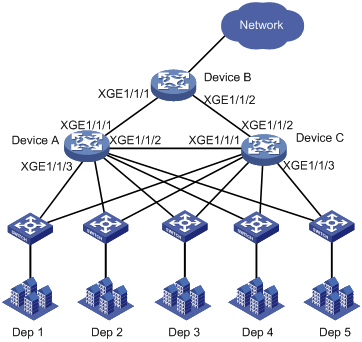

Example: Configuring link layer attack protection
Network requirements
As shown in Figure 1, Device A, Device B, and Device C run MSTP. Device B acts as the root bridge, and XGE 1/1/1 on Device C is blocked.
Configure the following features to prevent link layer attacks:
·     Configure root guard on XGE 1/1/1 and XGE 1/1/2 of Device B for Device B to act as the root bridge.
·     Configure loop guard on XGE 1/1/2 of Device C to prevent temporary loops. The loop guard feature keeps the port in Discarding state in all MSTIs when it receives no BPDU.
·     Configure BPDU guard on ports at the access side of Device A and Device C. The BPDU guard feature prevents the ports from performing spanning tree calculations when it receives forged BPDUs with a higher priority.
·     Enable TC-BPDU guard on Device A, Device B, and Device C. The TC-BPDU guard feature prevents a large number of TC-BPDUs from affecting the network in a short time.
·     Set the maximum number of MAC addresses that can be learned by ports at the access side of Device A and Device C. This configuration protects the devices from a large number of attack packets that have different source MAC addresses. The attack packets might cause a large MAC table and low forwarding performance.
·     Configure broadcast and multicast suppression on the designated ports of Device B and all ports on Device A and Device C. When incoming broadcast or multicast traffic exceeds the threshold, an interface discards broadcast or multicast packets until the traffic drops below the threshold.
Figure 1 Network diagram
Requirements analysis
For the ports at the access side of Device A and Device C to rapidly transit to the forwarding state, use the stp edged-port command to configure these ports as edge ports.
This example uses XGE 1/1/3 to illustrate the configuration on the ports at the access side on Device A and Device C.
Software version used
This example was created and verified on S7500EXS-CMW710-R7178.
When you configure link layer attack protection, follow these restrictions and guidelines:
·     On a port, the loop guard feature is mutually exclusive with the root guard feature or the edge port setting.
·     Do not configure the loop guard feature on ports at the access side. Otherwise, the ports stay in Discarding state in all MSTIs because they cannot receive BPDUs.
Configuration procedures
Configuring Device B

Configuration files

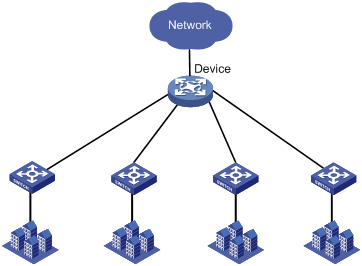

Example: Configuring ARP attack protection
As shown in Figure 2, the device is the gateway for the internal network. Configure ARP attack protection on the device to prevent ARP attacks.
Figure 2 Network diagram
# Specify IP addresses for interfaces. (Details not shown.)
# Enable ARP source suppression.
<Device> system-view
[Device] arp source-suppression enable
# Configure the device to accept a maximum of 8 unresolvable packets per source IP address in 5 seconds.
[Device] arp source-suppression limit 8
# Enable ARP black hole routing to prevent unresolvable IP packet attacks.
[Device] arp resolving-route enable
# Enable ARP active acknowledgment to prevent user spoofing.
[Device] arp active-ack enable
# Configure source MAC-based ARP attack detection to prevent ARP packet attacks from the same source MAC.
[Device] arp source-mac filter
[Device] arp source-mac threshold 25
# Enable ARP packet source MAC address consistency check to prevent attacks from ARP packets with different source MAC addresses in the Ethernet header and in the message body.
[Device] arp valid-check enable
1.     Verify that ARP attack protection functions on the device:
# Send ARP attack packets to the device. (Details not shown.)
# Verify that the CPU usage does not surge. (Details not shown.)
2.     Verify that each ARP attack protection feature functions on the device (this example uses the ARP source suppression feature):

Example: Configuring transport layer attack protection
As shown in Figure 4, the device is the gateway for the internal network. Configure SYN Cookie protection on the device to protect against SYN flood attacks. With this feature enabled, the device responds to a SYN packet with a SYN ACK packet without establishing a TCP semi-connection. The device establishes a TCP connection only when it receives an ACK packet from the sender.
Figure 4 Network diagram
# Enable SYN Cookie.
[Device] tcp syn-cookie enable
# Verify that the device does not have any TCP semi-connections. The state "SYN_RECEIVED" represents semi-connections.
[Device] display tcp
 *: TCP MD5 Connection
 Local Addr:port       Foreign Addr:port     State       Slot  Cpu PCB
 0.0.0.0:21            0.0.0.0:0             LISTEN      1     0   0xfffffffffff
fff9d
 0.0.0.0:23            0.0.0.0:0             LISTEN      1     0   0xfffffffffff
fff9f
 192.168.2.88:23       192.168.2.79:2197     ESTABLISHED 1     0   0xfffffffffff
fffa3
 192.168.2.88:23       192.168.2.89:2710     ESTABLISHED 1     0   0xfffffffffff
fffa2
 192.168.2.88:23       192.168.2.110:50199   ESTABLISHED 1     0   0xfffffffffff
fff
Configuration files
