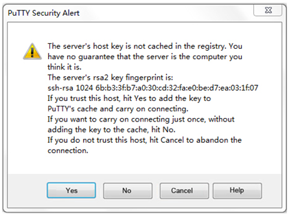

The dialog box shown in Figure 3 appears.
Figure 3 PuTTY Security Alert dialog box
5.     Click Yes.

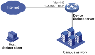

Network requirements
As shown in Figure 4:
·     The device uses publickey authentication and RSA public key algorithm.
·     The login username is client001.
Establish an Stelnet connection between the host and the device, so you can log in to the device to manage the campus network.
Import the client's host public key to the server to ensure correct format and content of the public key.
Figure 4 Network diagram

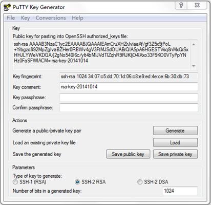

1.     Run PuTTYGen.exe, select SSH-2 RSA, and click Generate.
Figure 5 Generating a key pair on the client
2.     Continuously move the mouse and do not place the mouse over the green process bar shown in Figure 6. Otherwise, the process bar stops moving and the key pair generating process stops.
Figure 6 Generating process
3.     After the key pair is generated, click Save public key.
A file saving window appears.
4.     Select the saving directory (disk D in this example), enter a file name (key.pub in this example), and click Save.
Figure 7 Saving a key pair on the client

Configuring the device as the Stelnet server
# Generate RSA key pairs.
[Device] public-key local create rsa
The range of public key size is (512 ~ 2048).
If the key modulus is greater than 512, it will take a few minutes.
Press CTRL+C to abort.
Input the modulus length [default = 1024]:
Generating Keys...
Create the key pair successfully.
# Generate a DSA key pair.
[Device] public-key local create dsa
Generating Keys...
# Generate an ECDSA key pair.
[Device] public-key local create ecdsa
Generating Keys...
# Enable the SSH server function.
[Device] ssh server enable
# Set the authentication mode to AAA (scheme) for the user lines.
[Device] line vty 0 63
[Device-line-vty0-63] authentication-mode scheme
[Device-line-vty0-63] quit
# Import the client's public key from the file key.pub, and name the public key devicekey.
[Device] public-key peer devicekey import sshkey key.pub
# Create an SSH user named client001. Specify the authentication type as publickey for the user, and assign the public key devicekey to the user.
[Device] ssh user client001 service-type stelnet authentication-type publickey assign publickey devicekey
# Create a local user named client001.
[Device] local-user client001 class manage
New local user added.
# Authorize the local user client001 to use the SSH service.
[Device-luser-manage-client001] service-type ssh
# Assign the network-admin user role to the local user client001.
[Device-luser-manage-client001] authorization-attribute user-role network-admin
[Device-luser-manage-client001] quit

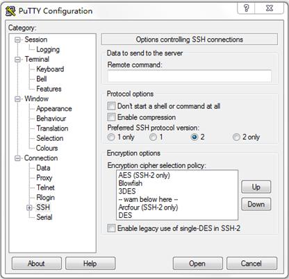

4.     From the navigation tree, select Connection > SSH.
The window shown in Figure 9 appears.
5.     In the Protocol options area, specify the preferred SSH version as 2.
Figure 9 Specifying the SSH version

The dialog box shown in Figure 11 appears.
Figure 11 PuTTY Security Alert dialog box
10.     Click Yes.
11.     Enter the username client001 to log in to the Stelnet server.

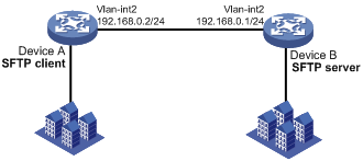

Configuring Device A as the SFTP client
# Create VLAN 2, and assign Ten-GigabitEthernet 1/1/2 to VLAN 2.
<DeviceA> system-view
[DeviceA] vlan 2
[DeviceA-vlan2] port ten-gigabitethernet 1/1/2
[DeviceA-vlan2] quit
# Assign an IP address to VLAN-interface 2. The client uses this address to connect to the server.
[DeviceA] interface vlan-interface 2
[DeviceA-Vlan-interface2] ip address 192.168.0.2 255.255.255.0
[DeviceA-Vlan-interface2] quit

Configuring Device B as the FTP server
<DeviceB> system-view
[DeviceB] vlan 2
[DeviceB-vlan2] port ten-gigabitethernet 1/1/2
[DeviceB-vlan2] quit
[DeviceB] interface vlan-interface 2
[DeviceB-Vlan-interface2] ip address 192.168.0.1 255.255.255.0
[DeviceB-Vlan-interface2] quit

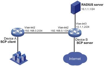

Example: Configuring SCP file transfer with remote password authentication
As shown in Figure 14, configure the devices and the RADIUS server to meet the following requirements:
·     Establish an SCP connection between Device A and Device B, so you can log in to Device B to perform file transfer.
·     Use the RADIUS server for SSH user authentication and authorization. The user name and password are hello@bbb and aabbcc, respectively.
·     Include the domain name in the username sent to the RADIUS server.
·     Assign the default user role network-admin to the SSH user, so the user can use all commands after login.
Figure 14 Network diagram
Requirements analysis
To meet the network requirements, you must perform the following tasks:
·     To ensure correct SSH version negotiation and algorithm negotiation, and to ensure that the server can pass the client's authentication, generate DSA, ECDSA, and RSA key pairs on the SSH server.
·     To perform remote password authentication, configure the username and password on the RADIUS server. To enable an SSH user to use all commands after login, set the user role to network-admin for the user on the RADIUS server.
·     To use the RADIUS server for authentication and authorization, perform the following tasks on Device B:
a.     Configure a RADIUS scheme to specify the authentication and authorization server.
b.     Create an ISP domain, and specify the ISP domain to use the RADIUS scheme for authentication, authorization, and accounting.
·     To ensure communication security between the RADIUS client (Device B) and the RADIUS server, configure the same shared key on Device B and the RADIUS server.
Software version used
This configuration example was created and verified on S7500EXS-CMW710-R7178.

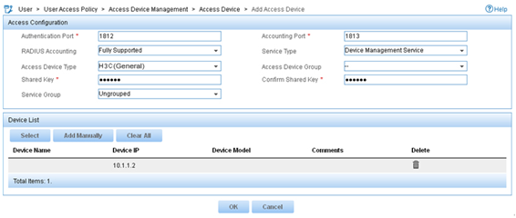

Adding Device B to the IMC Platform as an access device
1.     Log in to IMC.
2.     Click the User tab.
3.     From the navigation tree, select User Access Policy> Access Device Management > Access Device.
4.     Click Add.
5.     Configure an access device, as shown in Figure 15:
a.     Set the ports for authentication and accounting to 1812 and 1813, respectively.
b.     Select the service type Device Management Service.
c.     Select the access device type H3C(General).
d.     Set the shared key to expert for secure RADIUS communication.
e.     Select Device B from the device list or manually add Device B. (The IP address of Device B is 10.1.1.2).
f.     Use the default settings for other parameters.
6.     Click OK.
[DeviceB] vlan 2
# Assign an IP address to VLAN-interface 2. The SCP client uses this address as the destination IP address of the SCP connection.
# Create VLAN 3, and assign Ten-GigabitEthernet 1/1/1 to VLAN 3.
[DeviceB] vlan 3
[DeviceB-vlan3] port ten-gigabitethernet 1/1/1
[DeviceB-vlan3] quit
# Assign an IP address to VLAN-interface 3. Device B uses this address to communicate with the RADIUS server.
[DeviceB] interface vlan-interface 3
[DeviceB-Vlan-interface3] ip address 10.1.1.2 255.255.255.0
[DeviceB-Vlan-interface3] quit
[DeviceB] ssh server enable
# Create a RADIUS scheme named rad.
[DeviceB] radius scheme rad
# Specify the primary authentication server 10.110.1.1 and UDP port 1812 for the RADIUS scheme rad.
[DeviceB-radius-rad] primary authentication 10.1.1.1 1812
# Specify the primary authentication server 10.110.1.1 and UDP port 1813 for the RADIUS scheme rad.
[DeviceB-radius-rad] primary accounting 10.1.1.1 1813
# Specify the shared key as expert for secure authentication and accounting communication.
[DeviceB-radius-rad] key authentication simple expert
[DeviceB-radius-rad] key accounting simple expert
# Include domain names in the usernames sent to the RADIUS server.
[DeviceB-radius-rad] user-name-format with-domain
[DeviceB-radius-rad] quit
# Create an ISP domain named bbb.
[DeviceB] domain bbb
# Configure ISP domain bbb to use RADIUS scheme rad for authentication, authorization, and accounting of all login users.
[DeviceB-isp-bbb] authentication login radius-scheme rad
[DeviceB-isp-bbb] authorization login radius-scheme rad
[DeviceB-isp-bbb] accounting login radius-scheme rad
[DeviceB-isp-bbb] quit
[DeviceA] vlan 2
[DeviceA] quit
# Verify that you can log in to the SCP server, download the file remote.bin from the server, and save it locally with the name local.bin.
<DeviceA> scp 192.168.0.1 get remote.bin local.bin
Username: hello@bbb
Connecting to 192.168.0.1 port 22.
The Server is not authenticated. Continue? [Y/N]:y
Do you want to save the server public key? [Y/N]:n
hello@[email protected]'s password:
remote.bin                    100% 8275KB 318.3KB/s   00:26.

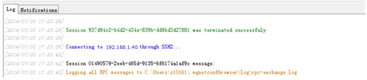

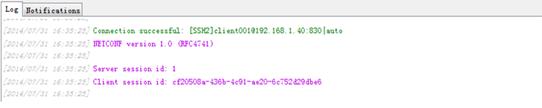

This example uses NetConf Browser 2013 (version 3.1).
To verify that you can log in to the NETCONF-over-SSH server and perform NETCONF operations:

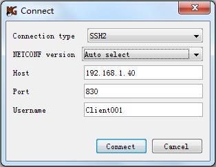

1.     Launch NetConf Browser 2013 (version 3.1).
2.     Select File > Connect… from the menu.
a.     Select Auto select from the NETCONF version list.
b.     Enter 192.168.1.40 in the Host field.
c.     Enter 830 in the Port field.
d.     Enter Client001 in the Username field.
3.     Click Connect.
Figure 18 Connecting to the device
4.     Enter the password aabbcc, and click OK.
The page shown in Figure 20 appears, and you enter the NETCONF configuration interface.
Figure 19 Entering the password
Figure 20 Logging in to the device
5.     Enter <get-sessions/> in the Command XML area.
The following message is displayed in the Output XML area.
<?xml version="1.0" encoding="utf-8"?>
<rpc-reply xmlns="urn:ietf:params:xml:ns:netconf:base:1.0" message-id="2">
  <get-sessions>
    <Session>
      <SessionID>1</SessionID>
      <Line>vty1</Line>
      <UserName>client001</UserName>
      <Since>2011-01-01T08:36:27</Since>
      <LockHeld>false</LockHeld>
    </Session>
  </get-sessions>
</rpc-reply>
