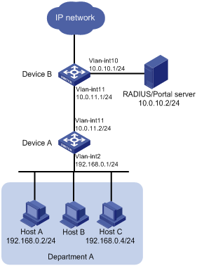

Network requirements
As shown in Figure 1, Device B supports portal authentication. A portal server acts as both a portal authentication server and a portal Web server. A RADIUS server acts as the AAA server for portal users.
Configure cross-subnet portal authentication. Before passing authentication, a host can access only the portal server. After passing authentication, the host can access resources in the IP network.
Figure 1 Network diagram

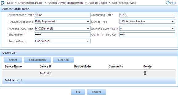

Adding an access device
1.     Log in to IMC, and click the User tab.
2.     From the navigation tree, select User Access Manager > Access Device Management > Access Device.
3.     Click Add.
The Add Access Device page appears.
4.     In the Access Configuration area, configure the following parameters:
¡     Enter expert in the Shared Key and Confirm Shared Key fields.
¡     Enter 1812 in the Authentication Port field and 1813 in the Accounting Port field.
¡     Select LAN Access Service from the Service Type list.
¡     Select H3C(General) from the Access Device Type list.
5.     In the Device List area, click Add Manually.
6.     On the page that appears, enter IP address 10.0.10.1 in the Start IP field, and click OK.
7.     Click OK.

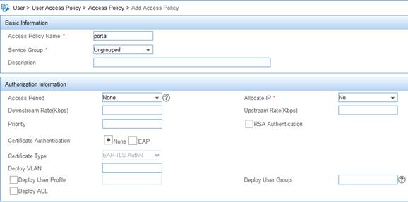

Adding an access policy
1.     Click the User tab.
2.     From the navigation tree, select User Access Manager > Access Policy.
3.     Click Add.
4.     On the page that appears, enter portal in the Access Policy Name field. Keep the default values for other parameters.
5.     Click OK.

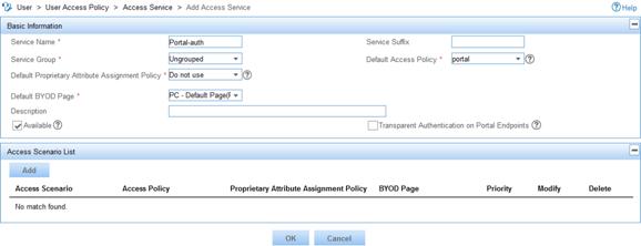

Adding an access service
2.     From the navigation tree, select User Access Manager > Access Service.
3.     Click Add.
4.     On the page that appears, configure the following parameters:
¡     Enter Portal-auth in the Service Name field.
¡     Select portal from the Default Access Policy list.
¡     Keep the default values for other parameters.
5.     Click OK.
Figure 4 Adding an access service

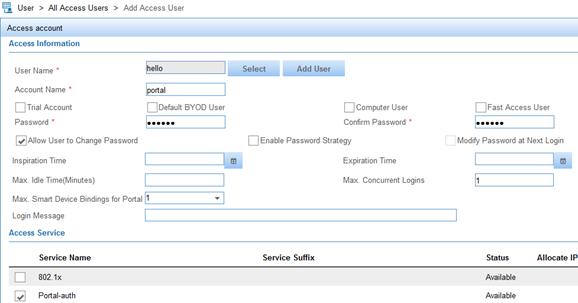

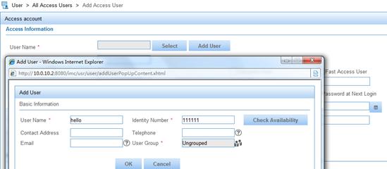

4.     In the Access Information area, click the Add User button for the User Name field.
5.     On the page that appears, configure the following parameters:
¡     Enter hello in the User Name field.
¡     Enter 111111 in the Identity Number field.
¡     Click OK.
Figure 5 Adding a user
6.     In the Access Information area, enter portal in the Account Name field and configure the password as 123456 for the account.
7.     In the Access Service area, select the access service named Portal-auth.
8.     Keep the default values for other parameters.
9.     Click OK.
Figure 6 Configuring an access user

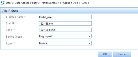

Adding an IP group for portal authentication
2.     From the navigation tree, select User Access Policy > Portal Service > IP Group.
3.     Click Add.
¡     Enter Portal_user in the IP Group Name field.
¡     Enter 192.168.0.0 in the Start IP field and 192.168.0.255 in the End IP field.
5.     Click OK.

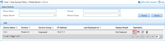

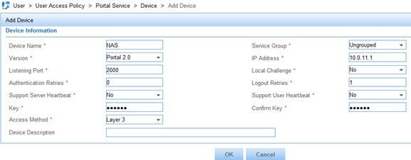

Configuring an access device for portal authentication
2.     From the navigation tree, select User Access Policy > Portal Service > Device.
3.     Click Add.
4.     On the Add Device page, configure the following parameters:
¡     Enter NAS in the Device Name field.
¡     Enter 10.0.11.1 in the IP Address field.
¡     Enter portal in the Key and Confirm Key fields.
The key must be the same as that for the portal authentication server configured on Device B.
¡     Select Layer 3 from the Access Method list.
5.     Click OK.

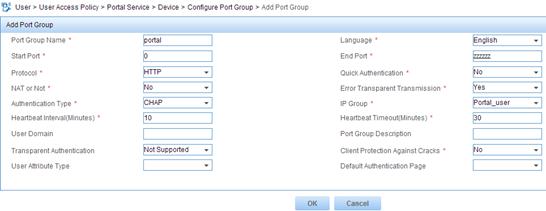

Configuring a port group for portal authentication
1.     On the Device page, click the Port Group icon.
Figure 10 Accessing the Device page
2.     On the Configure Port Group page, click Add.
3.     On the Add Port Group page, configure the following parameters:
¡     Enter portal in the Port Group Name field.
¡     Select Portal_user from the IP Group list.
4.     Click OK.

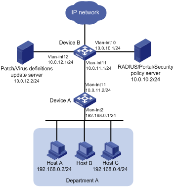

Example: Configuring extended cross-subnet portal authentication
As shown in Figure 12, Device B supports portal authentication. A portal server acts as both a portal authentication server and a portal Web server. A RADIUS server acts as the AAA server for portal users. A security policy server is deployed to perform security check on portal-authenticated users.
Configure extended cross-subnet portal authentication. Before passing portal authentication, a host can access only the portal Web server. After the host passes authentication, the security policy server performs a security check on the host. If the host fails the security check, the host is permitted to access only the Patch/Virus definitions update server. After passing the security check, the host can access resources in the IP network.
Figure 12 Network diagram
Requirements analysis
To enable Device B to perform cross-subnet portal authentication through RADIUS, you must perform the following tasks:
·     Configure the portal authentication and Web server, and enable cross-subnet portal authentication.
·     Configure the RADIUS scheme. Specify the AAA server for the scheme and apply the scheme to the portal authentication domain.
To perform security check on authenticated users, you must perform the following tasks:
·     On Device B, create an ACL (ACL 3000 in this example) for users who fail security checks, and an ACL (ACL 3001 in this example) for users who pass security checks.
·     On the security policy server, specify ACL 3000 as the isolation ACL and ACL 3001 as the security ACL.
Software version used
This configuration example was created and verified on S7500EXS-CMW710-R7178.
Configuration procedures

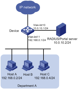

Example: Configuring direct portal authentication
As shown in Figure 13, hosts in Department A are directly connected to the device. A portal server acts as both a portal authentication server and a portal Web server. A RADIUS server acts as the authentication, authorization, and accounting server.
Configure direct portal authentication. The hosts can access only the portal server before passing authentication and can access other network resources after passing authentication.
Figure 13 Network diagram
To enable Device to perform portal authentication through RADIUS, you must perform the following tasks:
·     Configure the portal authentication and Web server, and enable direct portal authentication.
Configuring Device
