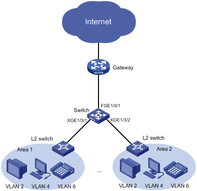

As shown in Figure 1, three types of traffic come from the Internet to the switch through the gateway.
·     Voice trafficTransmitted in VLAN 6 and carries 802.1p priority 6.
·     Video trafficTransmitted in VLAN 4 and carries 802.1p priority 4.
·     Data trafficTransmitted in VLAN 2 and carries 802.1p priority 2.

Figure 1 Network diagram
