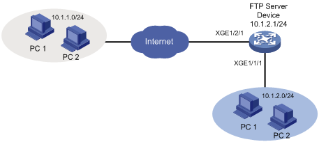

Example: Controlling FTP access
Network requirements
As shown in Figure 2, the device is an FTP server. Configure FTP access control on the device to meet the following requirements:
·     Users on subnet 10.1.2.0/24 can access the FTP server at any time.
·     Users on subnet 10.1.1.0/24 can access the FTP server during working hours (8:30 to 18:00) on working days (Monday to Friday).
·     Qualified users are assigned the level-15 user role.

Requirements analysis
To meet the network requirements, you must perform the following tasks:
·     Configure two rules for the ACL. One rule permits packets from subnet 10.1.2.0/24. The other one permits packets from subnet 10.1.1.0/24 and takes effect only during working hours on working days.
·     Use the ACL to control access to the FTP server.

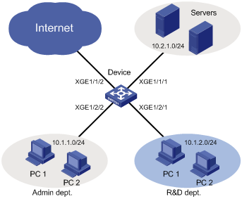

Example: Filtering packets by IP address
As shown in Figure 3, a company's internal network connects to the Internet through the device. The R&D department, Administration department, and servers are on different subnets.
Configure packet filtering to meet the following requirements:
·     The Administration department can access the Internet and servers at any time, but cannot access the R&D department at any time.
·     The R&D department can access only the servers during working hours (8:30 to 18:00) on working days (Monday to Friday). It can access the Internet and servers, but cannot access the Administration department outside working hours.
Figure 3 Network diagram
·     To deny the Administration department to access the R&D department, perform the following tasks:
?     Configure an advanced ACL to deny packets destined for subnet 10.1.2.0/24.
?     Apply the ACL to filter incoming packets on Ten-GigabitEthernet 1/2/2.
·     To implement access control for the R&D department, perform the following tasks:
?     Create a time range for the working hours (8:30 to 18:00) on working days (Monday to Friday).
?     Create an advanced ACL and configure the following rules:
-     Configure rules to allow only packets destined for subnet 10.2.1.0/24 to pass through. Set the rules to be active during the time range.
-     To deny the R&D department to access the Administration department, configure a rule to deny packets destined for subnet 10.1.1.0/24.
?     Apply the ACL to filter incoming packets on Ten-GigabitEthernet 1/2/1.

C:\>ping www.google.com
Pinging www.google.com [173.194.127.242] with 32 bytes of data:
Reply from 173.194.127.242: bytes=32 time=30ms TTL=50
Ping statistics for 173.194.127.242:
    Minimum = 30ms, Maximum = 30ms, Average = 30ms
C:\>
Configuration files
interface Ten-GigabitEthernet1/2/1
 port link-mode bridge
 packet-filter 3001 inbound
interface Ten-GigabitEthernet1/2/2
 packet-filter 3000 inbound
 time-range worktime 08:30 to 18:00 working-day
acl number 3000
 rule 0 deny ip destination 10.1.2.0 0.0.0.255
acl number 3001
 rule 0 permit ip destination 10.2.1.0 0.0.0.255 time-range worktime
 rule 5 deny ip time-range worktime
 rule 10 deny ip destination 10.1.1.0 0.0.0.255

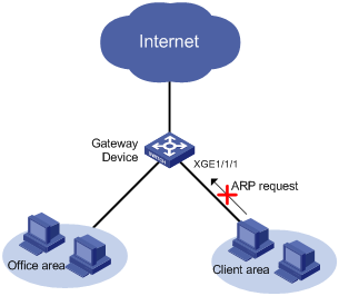

Example: Filtering ARP packets
As shown in Figure 5, configure packet filtering on the device to deny all ARP requests from the client area. Hosts in the client area can access the device only when a static ARP entry for the device is manually added on the hosts.
Figure 5 Network diagram
When ARP is used on an Ethernet network, the last 2-byte Length or Type field in the Ethernet header must be 0x0806 for ARP packets. For Ethernet frames, the l2 keyword represents the start of the Length or Type field. To identify ARP requests, you must specify the following matching criteria in one user-defined ACL rule:
·     Specify the l2 keyword, set the offset to 0 bytes, and set the rule string to 0806 to match the EtherType for ARP packets.
·     Specify the l2 keyword, set the offset to 8 bytes, and set the rule string to 0001 to match the Op field value of 01 for ARP requests.
Software version used
This configuration example was created and verified on S7500EXS-CMW710-R7178.
When you configure the user-defined ACL, follow these restrictions and guidelines:
·     An EC1, EF, or FG card supports user-defined ACLs only after you perform the following tasks:
a.     Execute the acl hardware-mode ipv6 enable command.
b.     Save the configuration and reboot the device.
·     An EB, EC2, or FD card supports user-defined ACLs only after you perform the following tasks:
c.     Execute the acl hardware-mode advanced command.
d.     Save the configuration and reboot the device.
·     A user-defined ACL rule cannot be modified. You must create a new rule with the same rule ID to override the old rule.
Configuration procedures
# Create user-defined ACL 5000.
<Device> system-view
[Device] acl number 5000
# Configure a rule to deny ARP requests to pass through.
[Device-acl-user-5000] rule deny l2 0806 ffff 0 l2 0001 ffff 8
[Device-acl-user-5000] quit
# Apply ACL 5000 to filter incoming ARP packets on Ten-GigabitEthernet 1/1/1.
[Device] interface ten-gigabitethernet 1/1/1
[Device-Ten-GigabitEthernet1/1/1] undo shutdown
[Device-Ten-GigabitEthernet1/1/1] packet-filter 5000 inbound
[Device-Ten-GigabitEthernet1/1/1] quit
# Verify that the ACL is successfully applied for packet filtering.
[Device]display packet-filter interface inbound
Interface: Ten-GigabitEthernet1/1/1
 In-bound policy:
  ACL 5000
# Verify that you can ping through the gateway from a host in the client area only when the host has a static ARP entry for the gateway:
1.     Deploy a new host in the client area. On the host, specify the IP address of the gateway but do not add an ARP entry for the gateway.
2.     Ping the gateway from the new host. The ping operation fails.
C:\>ping 10.0.0.1
Pinging 10.0.0.1 with 32 bytes of data:
Request timed out.
Request timed out.
Request timed out.
Request timed out.
Ping statistics for 10.0.0.1:
    Packets: Sent = 4, Received = 0, Lost = 4 (100% loss),
C:\>
3.     Add an ARP entry for the gateway on the host. (Details not shown.)
4.     Ping the gateway from the host. The ping operation succeeds.
C:\>ping 10.0.0.1
Reply from 10.0.0.1: bytes=32 time=1ms TTL=255
Reply from 10.0.0.1: bytes=32 time=37ms TTL=255
    Minimum = 1ms, Maximum = 37ms, Average = 10ms
C:\>
Configuration files
interface Ten-GigabitEthernet1/1/1
acl number 5000
 rule 0 deny l2 08060000000000000001 ffff000000000000ffff 0
