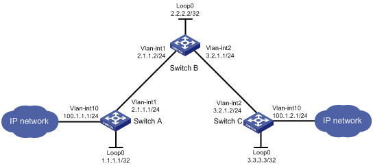

Network requirements
Switch A, Switch B, and Switch C run IS-IS.
Establish an MPLS TE tunnel over a static CRLSP from Switch A to Switch C to transmit data between the two IP networks. The required bandwidth for the tunnel is 2000 kbps.
The maximum bandwidth for MPLS TE traffic is 10000 kbps, and the maximum reservable bandwidth is 5000 kbps.
Figure 1 Network diagram
Configuration procedure

static-cr-lsp-1 Ingress     Null/20        Vlan1                Up
[SwitchB] display mpls static-cr-lsp
Name            LSR Type    In/Out Label   Out Interface        State
static-cr-lsp-1 Transit     20/30          Vlan2                Up
[SwitchC] display mpls static-cr-lsp
static-cr-lsp1  Egress      30/Null        -                    Up
# Verify that Switch A has a static route entry with interface Tunnel 1 as the output interface.
[SwitchA] display ip routing-table
Destinations : 12        Routes : 12
Destination/Mask   Proto   Pre Cost        NextHop         Interface
0.0.0.0/32         Direct  0   0           127.0.0.1       InLoop0
1.1.1.1/32         Direct  0   0           127.0.0.1       InLoop0
2.1.1.0/24         Direct  0   0           2.1.1.1         Vlan1
2.1.1.0/32         Direct  0   0           2.1.1.1         Vlan1
2.1.1.1/32         Direct  0   0           127.0.0.1       InLoop0
2.1.1.255/32       Direct  0   0           2.1.1.1         Vlan1
2.2.2.2/32         ISIS    15  10          2.1.1.2         Vlan1
100.1.2.0/24       Static  1   0           0.0.0.0         Tun1
3.3.3.3/32         ISIS    15  20          2.1.1.2         Vlan1
6.1.1.0/24         Direct  0   0           6.1.1.1         Tun1
6.1.1.0/32         Direct  0   0           6.1.1.1         Tun1
6.1.1.1/32         Direct  0   0           127.0.0.1       InLoop0
6.1.1.255/32       Direct  0   0           6.1.1.1         Tun1
