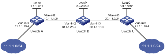

Static LSP configuration example
Network requirements
Switch A, Switch B, and Switch C all support MPLS.
Establish static LSPs between Switch A and Switch C, so that subnets 11.1.1.0/24 and 21.1.1.0/24 can access each other over MPLS.
Figure 1 Network diagram
·     For an LSP, the outgoing label specified on an LSR must be identical with the incoming label specified on the downstream LSR.
·     LSPs are unidirectional. You must configure an LSP for each direction of the data forwarding path.
·     A route to the destination address of the LSP must be available on the ingress node, but it is not needed on transit and egress nodes. Therefore, you do not need to configure a routing protocol to ensure IP connectivity among all switches.

1.     Create VLANs and configure IP addresses for all interfaces, including the loopback interfaces, as shown in Figure 1. (Details not shown.)
