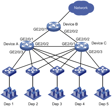

As shown in Figure 1, Device A, Device B, and Device C run MSTP. Device B acts as the root bridge, and GigabitEthernet 2/0/1 on Device C is blocked.
Configure the following features to prevent link layer attacks:
·     Configure root guard on GigabitEthernet 2/0/1 and GigabitEthernet 2/0/2 of Device B for Device B to act as the root bridge.
·     Configure loop guard on GigabitEthernet 2/0/2 of Device C to prevent temporary loops. The loop guard feature keeps the port in Discarding state in all MSTIs when it receives no BPDU.
·     Configure BPDU guard on ports at the access side of Device A and Device C. The BPDU guard feature prevents the ports from performing spanning tree calculations when it receives forged BPDUs with a higher priority.
·     Enable TC-BPDU guard on Device A, Device B, and Device C. The TC-BPDU guard feature prevents a large number of TC-BPDUs from affecting the network in a short time.
·     Set the maximum number of MAC addresses that can be learned by ports at the access side of Device A and Device C. This configuration protects the devices from a large number of attack packets that have different source MAC addresses. The attack packets might cause a large MAC table and low forwarding performance.
·     Configure broadcast and multicast suppression on the designated ports of Device B and all ports on Device A and Device C. When incoming broadcast or multicast traffic exceeds the threshold, an interface discards broadcast or multicast packets until the traffic drops below the threshold.
Figure 1 Network diagram
Requirements analysis
For the ports at the access side of Device A and Device C to rapidly transit to the forwarding state, use the stp edged-port command to configure these ports as edge ports.
This example uses GigabitEthernet 2/0/3 to illustrate the configuration on the ports at the access side on Device A and Device C.
Software version used
This example was created and verified on  S7500EX-CMW710-R7168.
When you configure link layer attack protection, follow these restrictions and guidelines:
·     On a port, the loop guard feature is mutually exclusive with the root guard feature or the edge port setting.
·     Do not configure the loop guard feature on ports at the access side. Otherwise, the ports stay in Discarding state in all MSTIs because they cannot receive BPDUs.

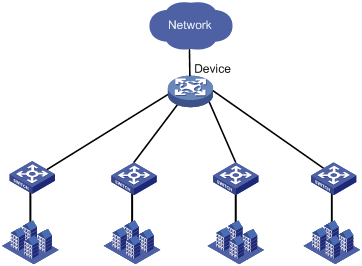

As shown in Figure 2, the device is the gateway for the internal network. Configure ARP attack protection on the device to prevent ARP attacks.
Figure 2 Network diagram

Example: Configuring transport layer attack protection
Network requirements
As shown in Figure 4, the device is the gateway for the internal network. Configure SYN Cookie protection on the device to protect against SYN flood attacks. With this feature enabled, the device responds to a SYN packet with a SYN ACK packet without establishing a TCP semi-connection. The device establishes a TCP connection only when it receives an ACK packet from the sender.
Figure 4 Network diagram
Configuration procedures
# Specify IP addresses for interfaces. (Details not shown.)
# Enable SYN Cookie.
<Device> system-view
[Device] tcp syn-cookie enable
# Verify that the device does not have any TCP semi-connections. The state "SYN_RECEIVED" represents semi-connections.
[Device] display tcp
 *: TCP MD5 Connection
 Local Addr:port       Foreign Addr:port     State       Slot  Cpu PCB
 0.0.0.0:21            0.0.0.0:0             LISTEN      1     0   0xfffffffffff
fff9d
 0.0.0.0:23            0.0.0.0:0             LISTEN      1     0   0xfffffffffff
fff9f
 192.168.2.88:23       192.168.2.79:2197     ESTABLISHED 1     0   0xfffffffffff
fffa3
 192.168.2.88:23       192.168.2.89:2710     ESTABLISHED 1     0   0xfffffffffff
fffa2
 192.168.2.88:23       192.168.2.110:50199   ESTABLISHED 1     0   0xfffffffffff
fff
Configuration files
