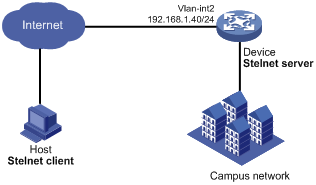

As shown in Figure 1:
·     The device uses local password authentication.
·     The login username and password are client001 and aabbcc, respectively.
Establish an Stelnet connection between the host and the device, so you can log in to the device to manage the campus network.
Figure 1 Network diagram

# Create VLAN 2, and assign GigabitEthernet 3/0/2 to VLAN 2.
[Device] vlan 2
[Device-vlan2] port gigabitethernet 3/0/2
[Device-vlan2] quit
# Assign an IP address to VLAN-interface 2. The Stelnet client uses the IP address as the destination address of the Stelnet connection.
[Device] interface vlan-interface 2
[Device-Vlan-interface2] ip address 192.168.1.40 255.255.255.0
[Device-Vlan-interface2] quit

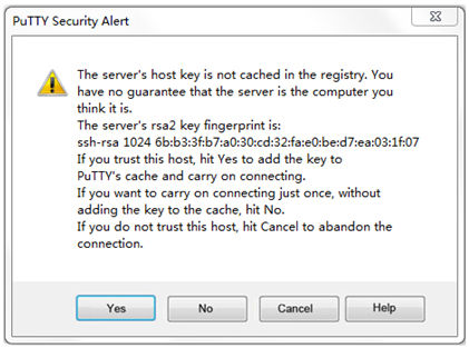

The dialog box shown in Figure 3 appears.
Figure 3 PuTTY Security Alert dialog box
5.     Click Yes.
6.     Enter the username client001 and the password aabbcc to log in to the Stelnet server.

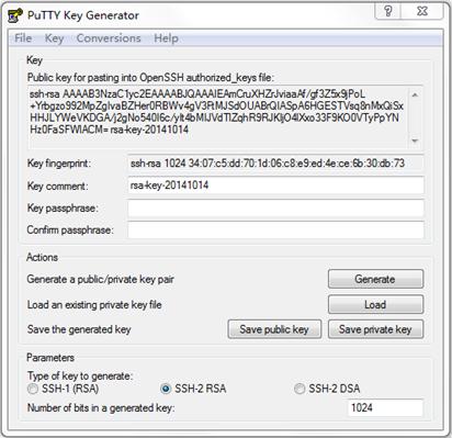

1.     Run PuTTYGen.exe, select SSH-2 RSA, and click Generate.
Figure 5 Generating a key pair on the client
2.     Continuously move the mouse and do not place the mouse over the green process bar shown in Figure 6. Otherwise, the process bar stops moving and the key pair generating process stops.
Figure 6 Generating process
3.     After the key pair is generated, click Save public key.
A file saving window appears.
4.     Select the saving directory (disk D in this example), enter a file name (key.pub in this example), and click Save.
Figure 7 Saving a key pair on the client

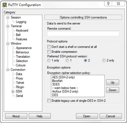

4.     From the navigation tree, select Connection > SSH.
The window shown in Figure 9 appears.
5.     In the Protocol options area, specify the preferred SSH version as 2.
Figure 9 Specifying the SSH version

9.     Click Open.
The dialog box shown in Figure 11 appears.
Figure 11 PuTTY Security Alert dialog box
10.     Click Yes.
11.     Enter the username client001 to log in to the Stelnet server.

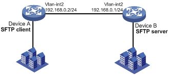

Example: Configuring SFTP with password-publickey authentication
Network requirements
As shown in Figure 13:
·     Device B uses password-publickey authentication and RSA public key algorithm.
Establish an SFTP connection between Device A and Device B, so you can log in to Device B to perform file and directory operations.
Import the client's host public key to the server to ensure correct format and content of the public key.
Figure 13 Network diagram

Configuring Device A as the SFTP client
<DeviceA> system-view
[DeviceA] vlan 2

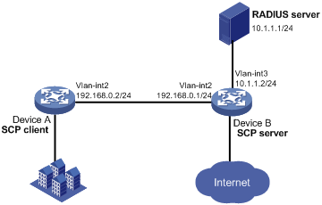

As shown in Figure 14, configure the devices and the RADIUS server to meet the following requirements:
·     Establish an SCP connection between Device A and Device B, so you can log in to Device B to perform file transfer.
·     Use the RADIUS server for SSH user authentication and authorization. The user name and password are hello@bbb and aabbcc, respectively.
·     Include the domain name in the username sent to the RADIUS server.
·     Assign the default user role network-admin to the SSH user, so the user can use all commands after login.
Figure 14 Network diagram

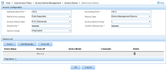

5.     Configure an access device, as shown in Figure 15:
a.     Set the ports for authentication and accounting to 1812 and 1813, respectively.
b.     Select the service type Device Management Service.
c.     Select the access device type H3C(General).
d.     Set the shared key to expert for secure RADIUS communication.
e.     Select Device B from the device list or manually add Device B. (The IP address of Device B is 10.1.1.2).
f.     Use the default settings for other parameters.
6.     Click OK.

# Assign an IP address to VLAN-interface 2. The SCP client uses this address as the destination IP address of the SCP connection.
[DeviceB] interface vlan-interface 2
[DeviceB-Vlan-interface2] ip address 192.168.0.1 255.255.255.0
[DeviceB-Vlan-interface2] quit
# Create VLAN 3, and assign GigabitEthernet 2/0/1 to VLAN 3.
[DeviceB] vlan 3
[DeviceB-vlan3] port gigabitethernet 2/0/1
[DeviceB-vlan3] quit
# Assign an IP address to VLAN-interface 3. Device B uses this address to communicate with the RADIUS server.
[DeviceB] interface vlan-interface 3
[DeviceB-Vlan-interface3] ip address 10.1.1.2 255.255.255.0
[DeviceB-Vlan-interface3] quit
# Enable the SSH server function.
[DeviceB] ssh server enable
# Create a RADIUS scheme rad.
[DeviceB] radius scheme rad
# Specify the primary authentication server 10.110.1.1 and UDP port 1812 for the RADIUS scheme rad.
[DeviceB-radius-rad] primary authentication 10.1.1.1 1812
# Specify the primary authentication server 10.110.1.1 and UDP port 1813 for the RADIUS scheme rad.
[DeviceB-radius-rad] primary accounting 10.1.1.1 1813
# Specify the shared key as expert for secure authentication and accounting communication.
[DeviceB-radius-rad] key authentication simple expert
[DeviceB-radius-rad] key accounting simple expert
# Include domain names in the usernames sent to the RADIUS server.
[DeviceB-radius-rad] user-name-format with-domain
[DeviceB-radius-rad] quit
# Create an ISP domain bbb.
[DeviceB] domain bbb
# Configure ISP domain bbb to use RADIUS scheme rad for authentication, authorization, and accounting of all login users.
[DeviceB-isp-bbb] authentication login radius-scheme rad
[DeviceB-isp-bbb] authorization login radius-scheme rad
[DeviceB-isp-bbb] accounting login radius-scheme rad
[DeviceB-isp-bbb] quit
[DeviceA] vlan 2
[DeviceA-vlan2] port gigabitethernet 3/0/2
[DeviceA-vlan2] quit
[DeviceA] interface vlan-interface 2
[DeviceA-Vlan-interface2] ip address 192.168.0.2 255.255.255.0
[DeviceA-Vlan-interface2] quit
[DeviceA] quit
# Verify that you can log in to the SCP server, download the file remote.bin from the server, and save it locally with the name local.bin.
<DeviceA> scp 192.168.0.1 get remote.bin local.bin
Username: hello@bbb
Press CTRL+C to abort.
Connecting to 192.168.0.1 port 22.
The Server is not authenticated. Continue? [Y/N]:y
Do you want to save the server public key? [Y/N]:n
hello@[email protected]'s password:
remote.bin                    100% 8275KB 318.3KB/s   00:26.

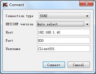

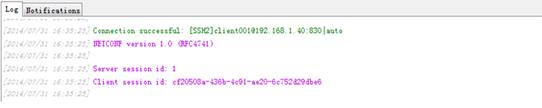

This example uses NetConf Browser 2013 (version 3.1).
To verify that you can log in to the NETCONF-over-SSH server and perform NETCONF operations:
1.     Launch NetConf Browser 2013 (version 3.1).
2.     Select File > Connect… from the menu.
a.     Select Auto select from the NETCONF version list.
b.     Enter 192.168.1.40 in the Host field.
c.     Enter 830 in the Port field.
d.     Enter Client001 in the Username field.
3.     Click Connect.
Figure 18 Connecting to the device
4.     Enter the password aabbcc, and click OK.
The page shown in Figure 20 appears, and you enter the NETCONF configuration interface.
Figure 19 Entering the password
Figure 20 Logging in to the device

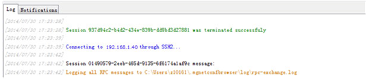

5.     Enter <get-sessions/> in the Command XML area.
The following message is displayed in the Output XML area.
<?xml version="1.0" encoding="utf-8"?>
<rpc-reply xmlns="urn:ietf:params:xml:ns:netconf:base:1.0" message-id="2">
  <get-sessions>
    <Session>
      <SessionID>1</SessionID>
      <Line>vty1</Line>
      <UserName>client001</UserName>
      <Since>2011-01-01T08:36:27</Since>
      <LockHeld>false</LockHeld>
    </Session>
  </get-sessions>
</rpc-reply>
