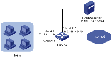

Network requirements
As shown in Figure 1, configure port security mode autoLearn on Ten-GigabitEthernet 1/0/1 to meet the following requirements:
·     The device accepts a maximum of 64 users to log in through the port without authentication.
·     After the number of users reaches 64, the port denies any new users to access the Internet.
Figure 1 Network diagram

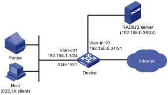

As shown in Figure 2:
·     Users use the 802.1X client on the host to initiate 802.1X authentication.
·     The device uses the RADIUS server to perform authentication, authorization, and accounting for all users in ISP domain sun.
·     IMC is the RADIUS server.
·     The device and the server use the shared key expert for secure RADIUS communication.
Configure port security mode userLoginWithOUI on the device to meet the following requirements:
·     Permit only one 802.1X user to pass authentication to access the Internet.
·     Permit the printer to access the Internet.
·     Discard all illegal frames without disabling the port security-enabled port.
Figure 2 Network diagram

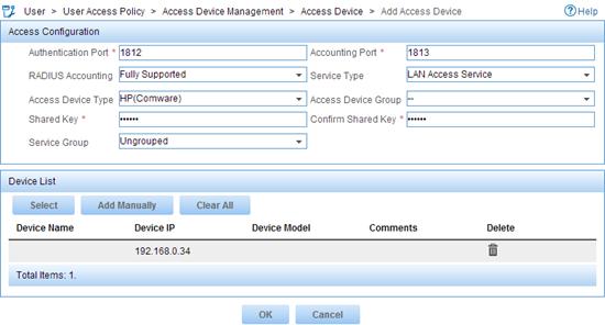

1.     Add the device to IMC as an access device:
a.     Click the User tab.
b.     From the navigation tree, select User Access Policy > Access Device Management > Access Device.
c.     Click Add.
The Add Access Device page appears.
d.     In the Access Configuration area, configure the following parameters:
-     Enter 1812 in the Authentication Port field, and enter 1813 in the Accounting Port field.
-     Select LAN Access Service from the Service Type list.
-     Select HP(Comware) from the Access Device Type list.
-     Enter expert in the Shared Key and Confirm Shared Key field.
-     Use the default values for other parameters.
e.     In the Device List area, click Select or Add Manually to add the device at 192.168.0.34 as an access device.
The IP address of the access device specified here must be the same as the source IP address of the RADIUS packets sent from the device. The source IP address is chosen in the following order on the device:
-     IP address specified by the nas-ip command.
-     IP address specified by the radius nas-ip command.
-     IP address of the outbound interface (the default).
f.     Click OK.
Figure 3 Adding the device as an access device

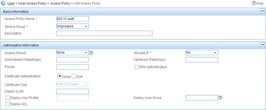

2.     Add an access policy:
b.     From the navigation tree, select User Access Policy > Access Policy.
c.     Click Add.
d.     On the page that appears, configure the following parameters, as shown in Figure 4:
-     Enter 802.1X-auth in the Access Policy Name field.
Figure 4 Adding an access policy
e.     Click OK.

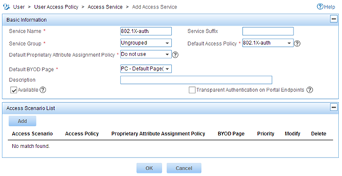

3.     Add an access service:
b.     From the navigation tree, select User Access Policy > Access Service.
c.     Click Add.
d.     On the page that appears, configure the following parameters, as shown in Figure 5:
-     Enter 802.1X-auth in the Service Name field.
-     Select 802.1X-auth from the Default Access Policy list.
Figure 5 Adding an access service
e.     Click OK.

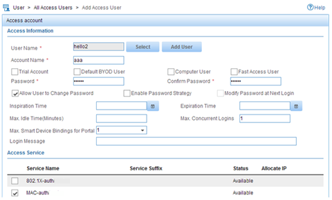

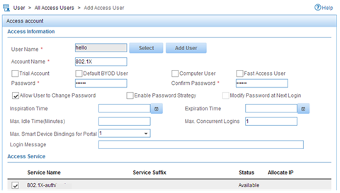

4.     Add an access user:
b.     From the navigation tree, select Access User Management > All Access Users.
The access user list appears.
c.     Click Add.
d.     On the Add Access User page, configure the following parameters, as shown in Figure 6:
-     Click Select or Add User to associate the user with IMC Platform user hello.
-     Enter 802.1X in the Account Name field.
-     Enter 802.1X in the Password and Confirm Password fields.
-     Configure other parameters in the Access Information area as needed.
-     Select 802.1X-auth from the Access Service list.
Figure 6 Adding an access user account
e.     Click OK.

Example: Configuring macAddressElseUserLoginSecure mode
As shown in Figure 7, the device uses the RADIUS server to perform authentication, authorization, and accounting for all users in domain sun.
Configure port security mode macAddressElseUserLoginSecure on the device to meet the following requirements:
·     Allow only one 802.1X user to pass authentication, and allow multiple MAC authentication users to pass authentication.
·     Perform MAC authentication first for an 802.1X user, and then 802.1X authentication if the user fails MAC authentication.
·     Use shared user account with username aaa and password 123456 for MAC authentication users.
·     Allow a maximum of 64 authenticated users.
·     Prevent frames from being sent to unknown MAC addresses.
Figure 7 Network diagram

1.     Add the device to IMC as an access device in the same way the device is added to IMC in "Example: Configuring userLoginWithOUI mode."
2.     Add an access policy, an access service, and an access user for 802.1X authentication in the same way they are added in "Example: Configuring userLoginWithOUI mode."

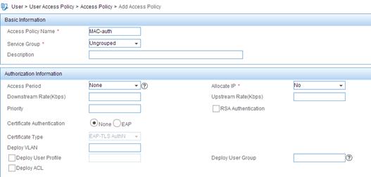

3.     Add an access policy for MAC authentication:
c.     Click Add.
d.     On the page that appears, configure the following parameters, as shown in Figure 8:
-     Enter MAC-auth in the Access Policy Name field.
Figure 8 Adding an access policy
e.     Click OK.

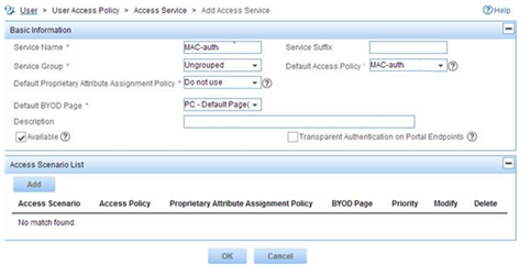

4.     Add an access service for MAC authentication:
c.     Click Add.
d.     On the page that appears, configure the following parameters, as shown in Figure 9:
-     Enter MAC-auth in the Service Name field.
-     Select MAC-auth from the Default Access Policy list.
Figure 9 Adding an access service
e.     Click OK.
5.     Add an access user for MAC authentication:
c.     Click Add.
d.     On the Add Access User page, configure the following parameters, as shown in Figure 10:
-     Click Select or Add User to associate the user with IMC Platform user hello2.
-     Enter aaa in the Account Name field.
-     Enter 123456 in the Password and Confirm Password fields.
-     Select MAC-auth from the Access Service list.
Figure 10 Adding an access user account
e.     Click OK.
