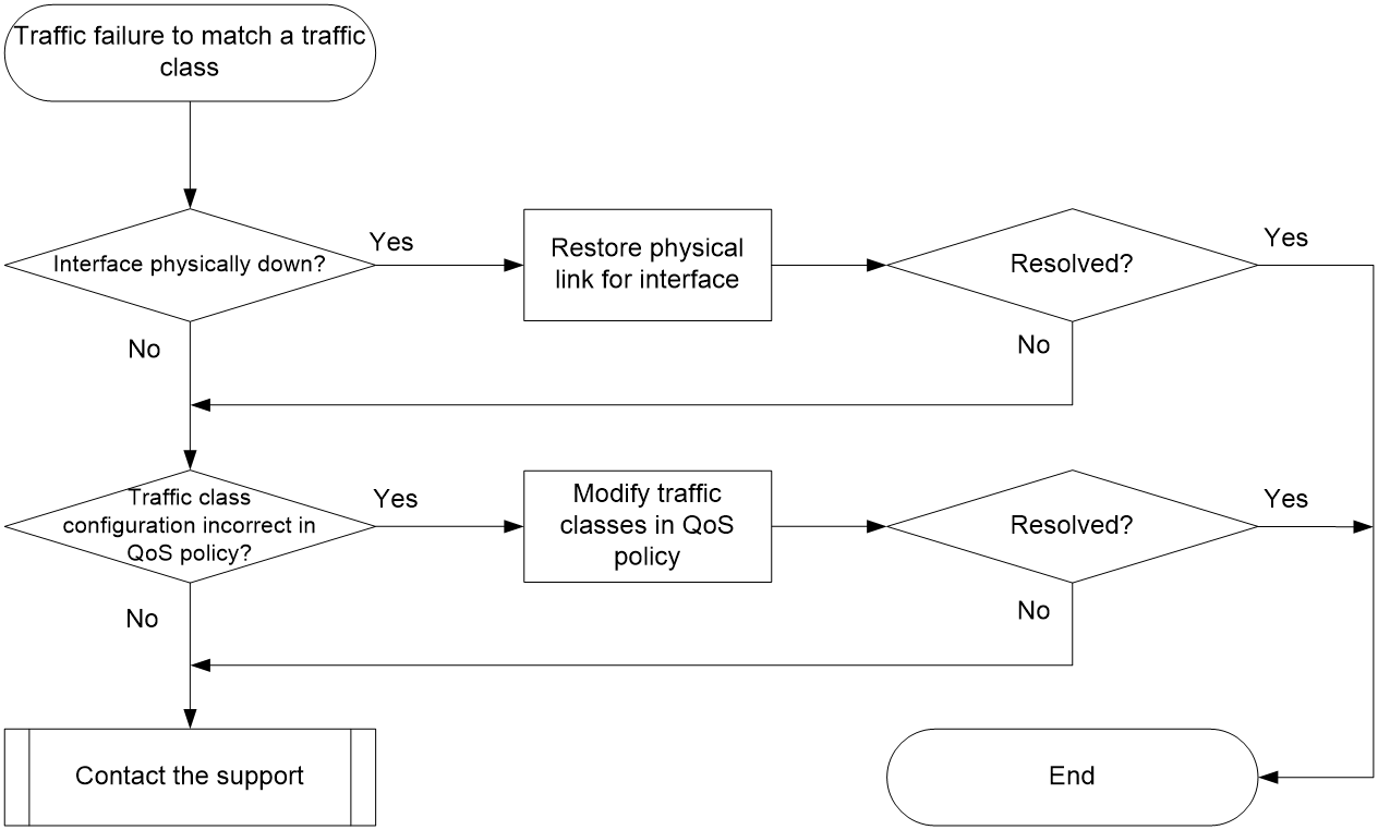

Figure 1 shows the troubleshooting flowchart.
Figure 1 Flowchart for troubleshooting traffic failure to match a traffic class
Solution

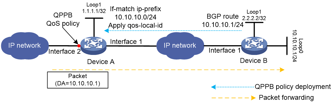

As shown in Figure 2, in a typical QoS Policy Propagation Through the Border Gateway Protocol (QPPB) environment, Device A and Device B establish a BGP neighbor relationship. Device B sends BGP route 10.10.10.1/24 to Device A. Device A sets the IP precedence or local QoS ID value for BGP route 10.10.10.1/24 through a routing policy and adds it to the routing table of Device A. When Device A receives a packet destined to 10.10.10.1/24, it classifies the packet based on the IP precedence or local QoS ID value in the routing table of Device A and executes the corresponding action.
The QPPB policy does not take effect when Device A forwards packets. The packets are not effectively classified based on the IP precedence or local QoS ID value in the routing table of Device A, and the corresponding action is not executed.
The following section describes the troubleshooting flow in BGP IPv4 unicast address view. The flow is similar for other address family views.
Figure 2 Typical QPPB network

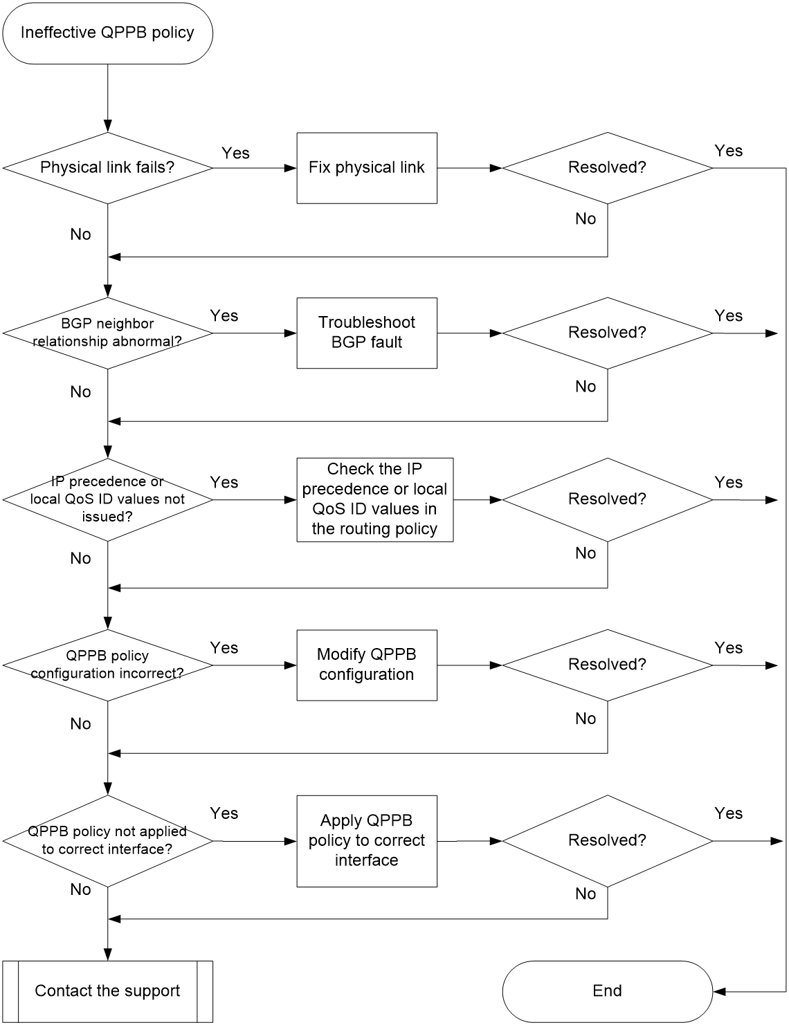

Figure 3 shows the troubleshooting flowchart of this type of fault.
Figure 3 Flowchart for troubleshooting ineffective QPPB policy
Solution
