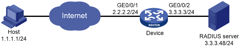

Relationship between IPsec and IKE
As shown in Figure 1, IKE negotiates SAs for IPsec and transfers the SAs to IPsec, and IPsec uses the SAs to protect IP packets.

Example: Configuring main-mode IKE with preshared key authentication
As shown in Figure 4, configure an IKE-based IPsec tunnel between Device A and Device B to secure the communication between subnet 10.1.1.0/24 and subnet 10.1.2.0/24.
·     Configure Device A and Device B to use the default IKE proposal for the IKE negotiation to set up the IPsec SAs.
·     Configure the two devices to use the preshared key authentication method for the IKE negotiation phase 1.
Figure 4 Network diagram
1.     Configure Device A:

Example: Configuring IKE remote extended authentication
As shown in Figure 5, configure an IPsec tunnel to protect the traffic between the host and the device.
·     Set up IPsec SAs through IKE negotiations.
·     Configure the host and the device to use preshared key for authentication in the phase-1 IKE negotiation.
·     Configure the device to use RADIUS to perform remote extended authentication on the host.
Figure 5 Network diagram
1.     Make sure the device, host, and server can reach one another.
2.     Configure the RADIUS server. Make sure the RADIUS server has an authentication account for the host. In this example, the account uses username test and password abc.
3.     Configure the device:

4.     Configure the host:
Perform the following tasks on the host and make sure the configuration matches that on the device:
¡     Specify the IP address of the remote security gateway.
¡     Set the preshared key used for IKE negotiation.
¡     Configure the username and password for IKE extended authentication.
¡     Specify the security protocol, encryption algorithm, and authentication algorithm.
¡     Configure IKE negotiation parameters.
¡     Configure the local ID and remote ID.
(Details not shown.)
# Initiate a connection from the host (1.1.1.1) to the device (2.2.2.2) to trigger IKE negotiation. (Details not shown.)
# On the device, verify that an IKE SA to the peer 1.1.1.1 is established and that extended authentication is enabled for remote users.
¡     Configure the username and password for IKE client authentication.
# Initiate a connection from the host (1.1.1.1) to the server (3.3.3.50) to trigger IKE negotiation. (Details not shown.)
# On the device, verify that an IKE SA to the peer 1.1.1.1 is established and that client authentication is enabled.

Example: Configuring a gateway-to-gateway IPsec tunnel with IKE extended authentication
As shown in Figure 7, establish an IPsec tunnel between Device A and Device B as follows:
·     Configure Device A and Device B to set up IPsec SAs through IKE negotiation and specify the preshared key authentication method for the phase-1 IKE negotiation.
·     Configure Device B to perform IKE extended authentication on Device A by using the RADIUS authentication method.
·     Configure Device A to use username test and password 123456TESTplat&! for the RADIUS authentication.
Figure 7 Network diagram
1.     Make sure Device A, Device B, and the RADIUS server can reach one another.
