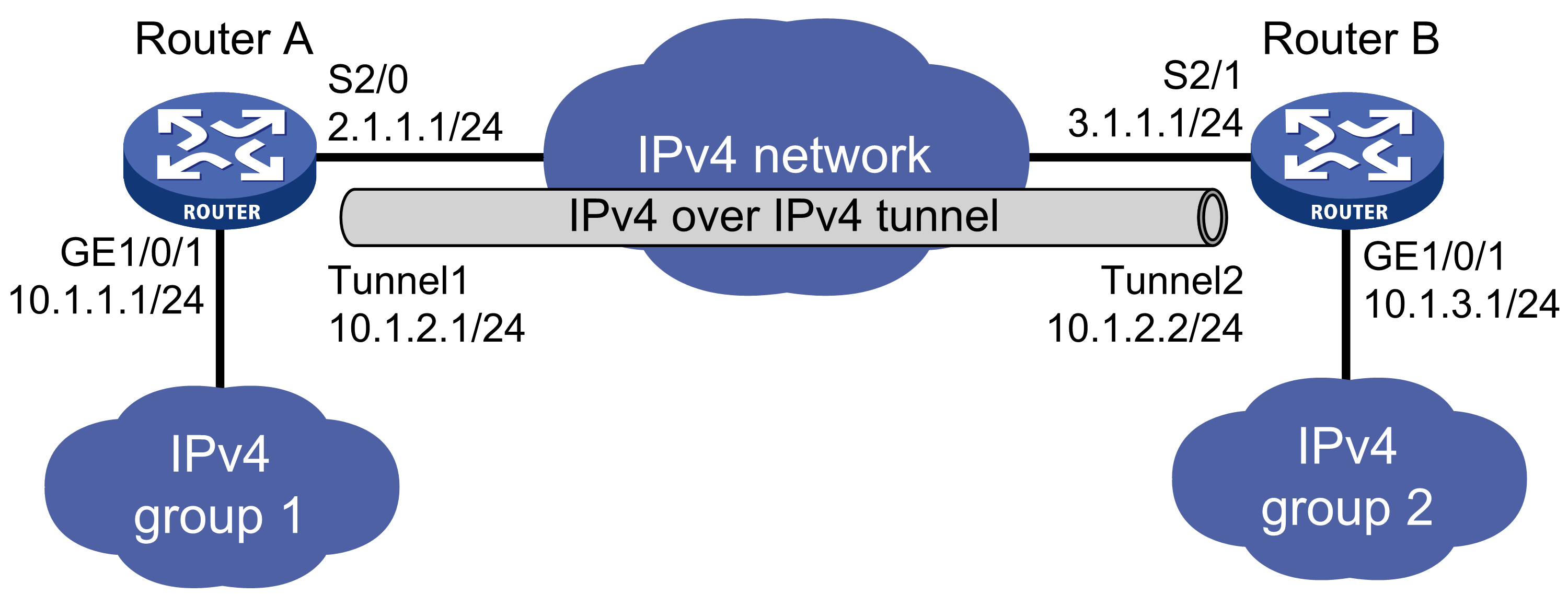

As shown in Figure 2, the two subnets IPv4 group 1 and IPv4 group 2 use private IPv4 addresses. Configure an IPv4 over IPv4 tunnel between Router A and Router B to make the two subnets reachable to each other.
Figure 2 Network diagram
Make sure Router A and Router B can reach each other through IPv4.
