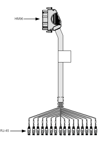

E1 cable |
E1-HM96 Ethernet copper ports |
Connects E1-HM96 Ethernet copper ports to transmit data. |

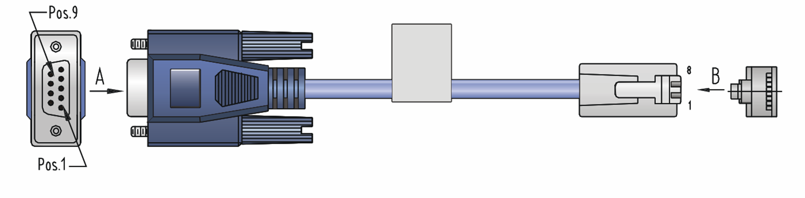

The console cable has an 8-core crimped RJ-45 connector for connecting to the console port of the router, and a DB-9 connector for connecting to the 9-core serial port of the terminal.
Figure3-2 shows the console cable and Table3-3 shows its pinouts.
Figure3-2 Console cable connecting the serial port and the console port
Table3-3 Pinouts for the console cable connecting the serial port and the console port
RJ-45 pin |
Signal |
DB-9 pin |
Signal |
1 |
RTS |
8 |
CTS |
2 |
DTR |
6 |
DSR |
3 |
TXD |
2 |
RXD |
4 |
CD |
5 |
SG |
5 |
GND |
5 |
SG |
6 |
RXD |
3 |
TXD |
7 |
DSR |
4 |
DTR |
8 |
CTS |
7 |
RTS |

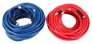

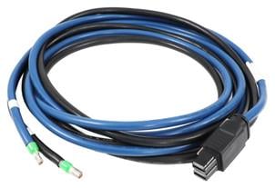

DC power cord
A DC power cord connects a DC power supply to an external DC power source. Power cords supported by the PSR2400-12D, PSR2400-D, and PSR2500B-12AHD-F power supplies are as shown in Table3-4.
Table3-4 Compatible power cords
Item |
Power cord code |
Cable length |
Wire diameter |
Remarks |
Description |
DC power cord |
0404A0E1 |
3 m (9.84 ft) |
6 AWG |
Black and blue power cord (ring terminal included) |
Used for the PSR2400-12D power supply on the CR16000-M |
DC power cord |
0404A0E2 |
15 m (49.21 ft) |
6 AWG |
DC power cord |
0404A1M5 |
20 m (65.62 ft) |
4 AWG |
Blue and red power cord (ring terminal included) |
Used for the PSR2400-D power supply on the CR16000-M |
DC power cord |
0404A1M6 |
15 m (49.21 ft) |
4 AWG |
DC power cord |
0404A1M7 |
10 m (32.81 ft) |
6 AWG |
DC power cord |
0404A1MD |
30 m (98.43 ft) |
4 AWG |
High-voltage DC power cord |
0404A0RL |
3 m (9.84 ft) |
3*2.5 mm2 |
Black power cord (ring terminal included) |
Used for the PSR2500B-12AHD-F power supply on the CR16000-M |
Figure3-3 PSR2400-12D DC power cord (black and blue cable as an example)
Figure3-4 Ring terminal
Figure3-5 PSR2400-D DC power cords

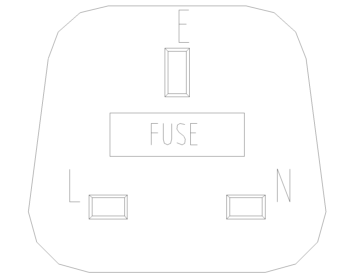

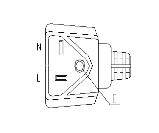

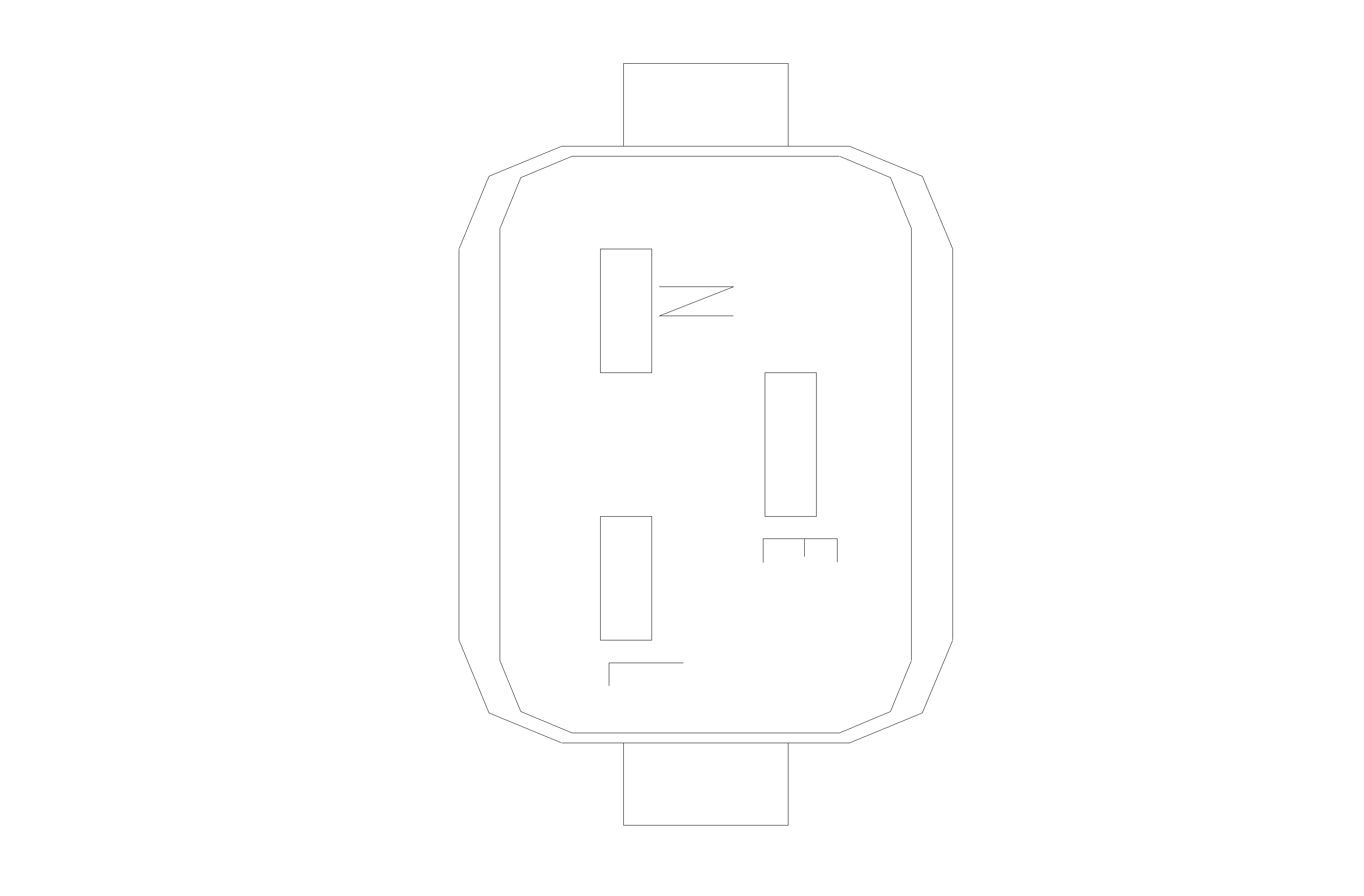

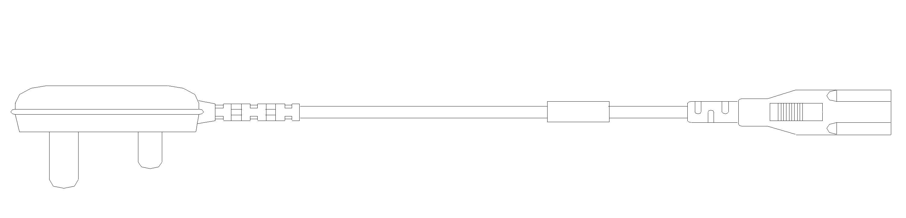

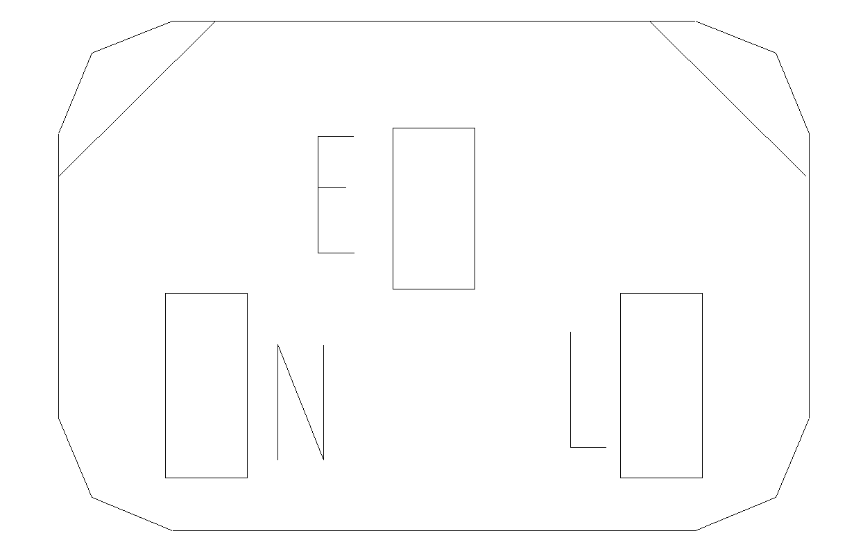

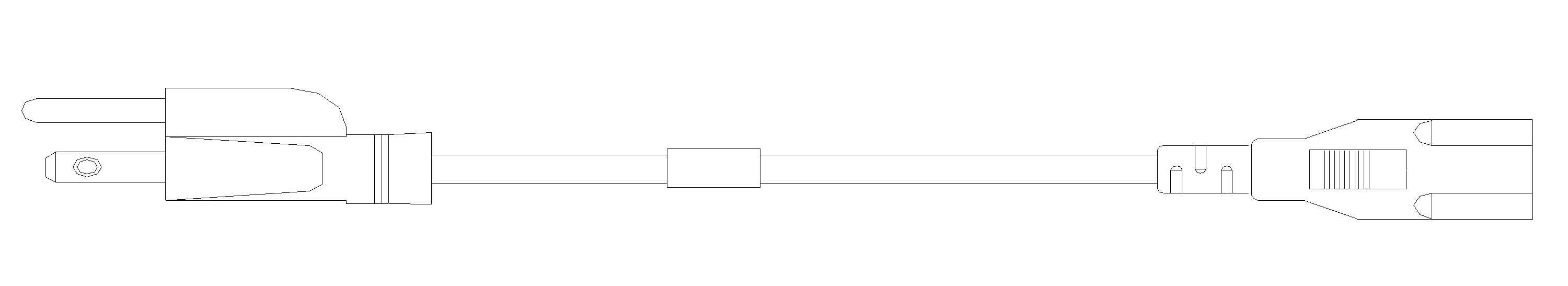

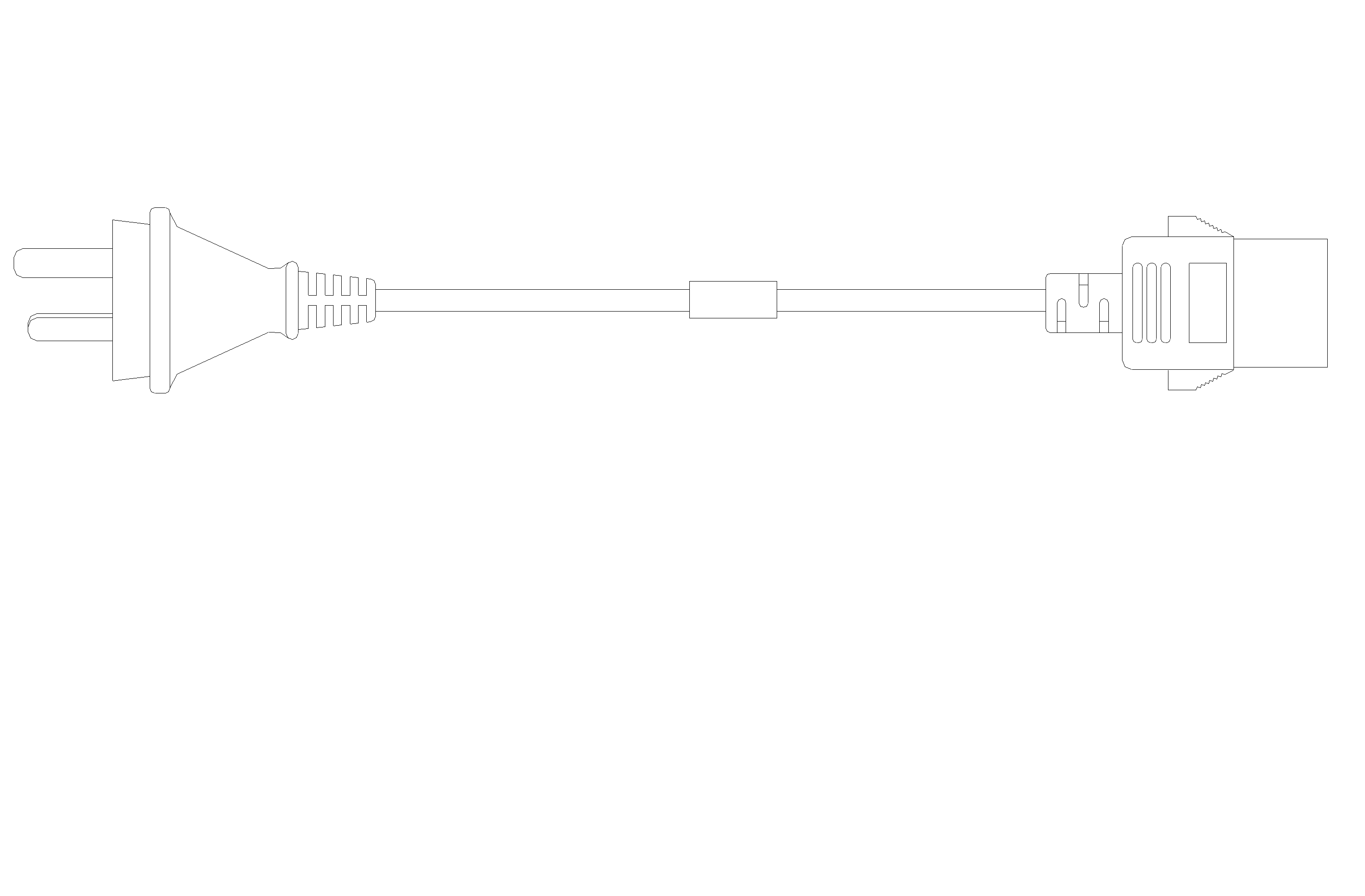

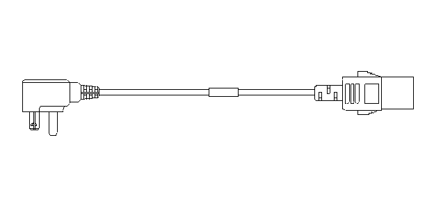

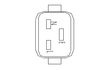

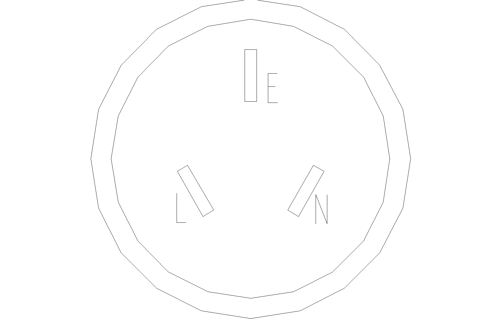

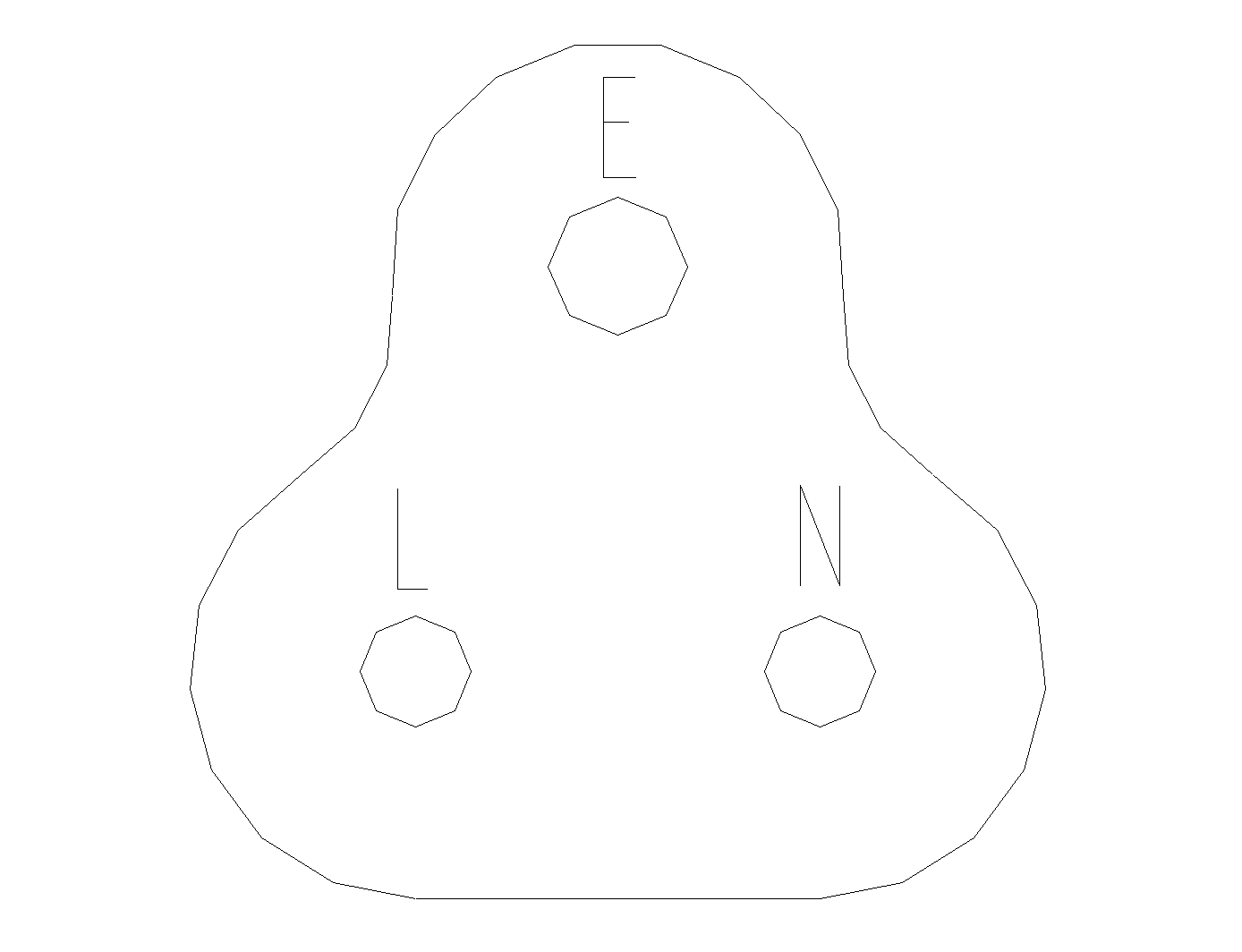

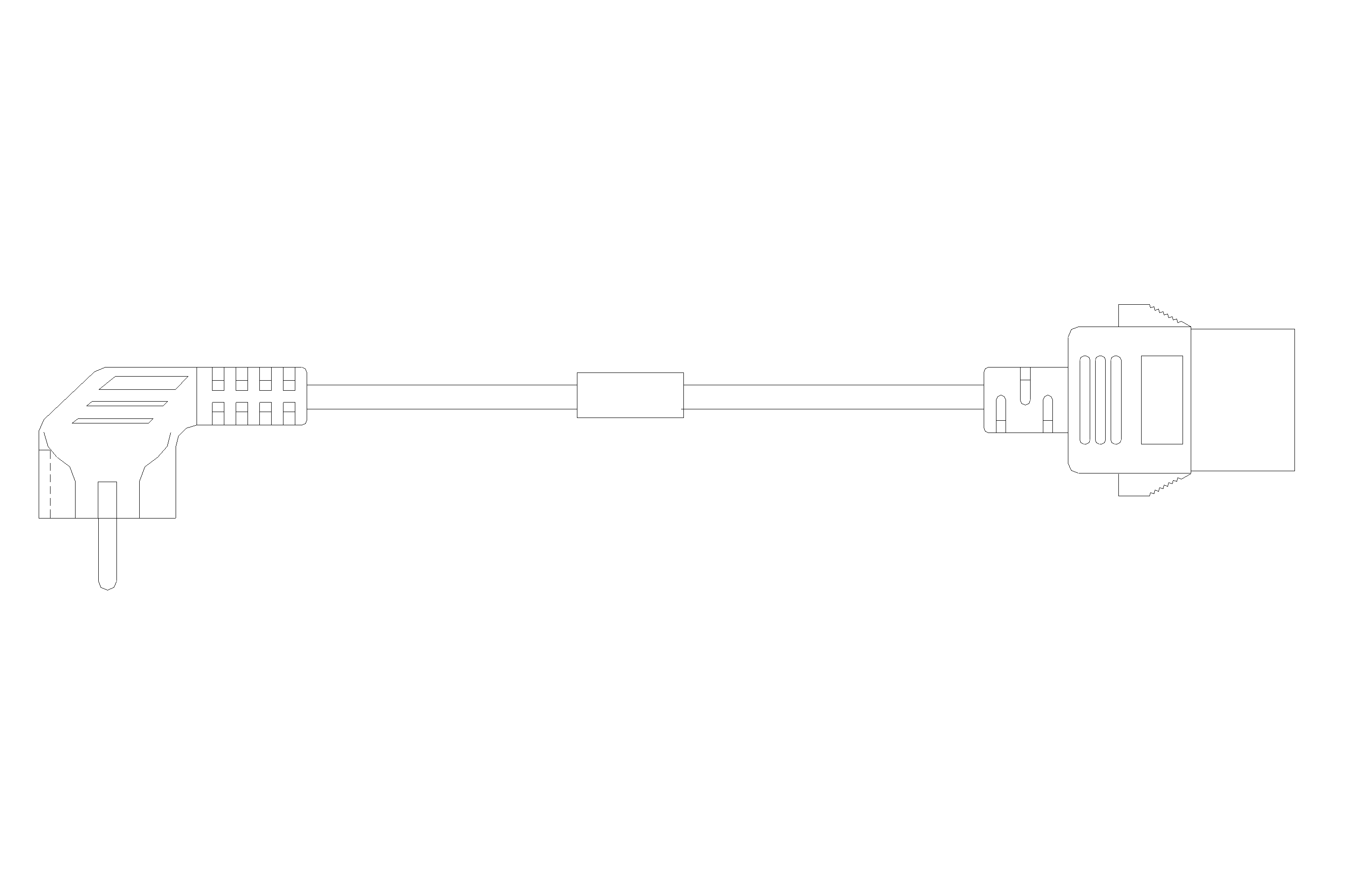

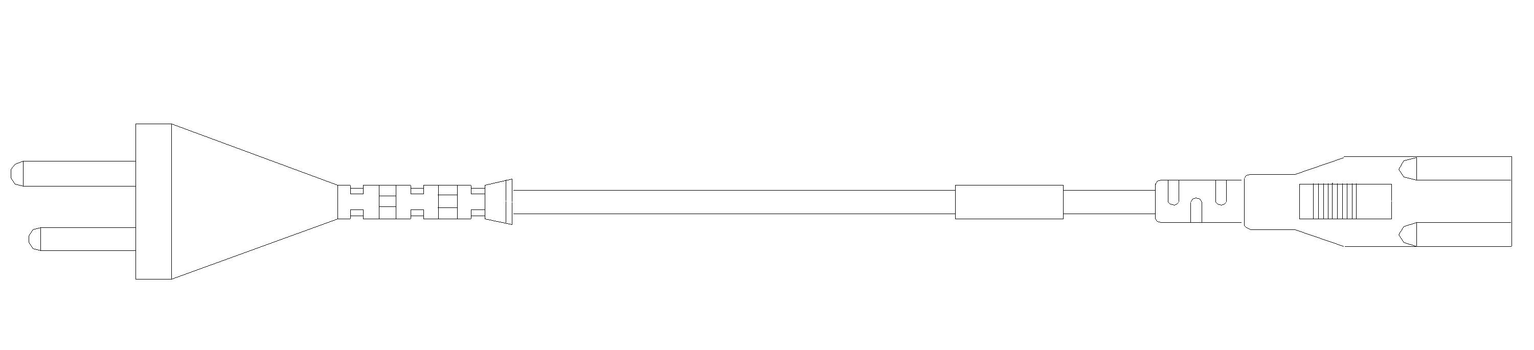

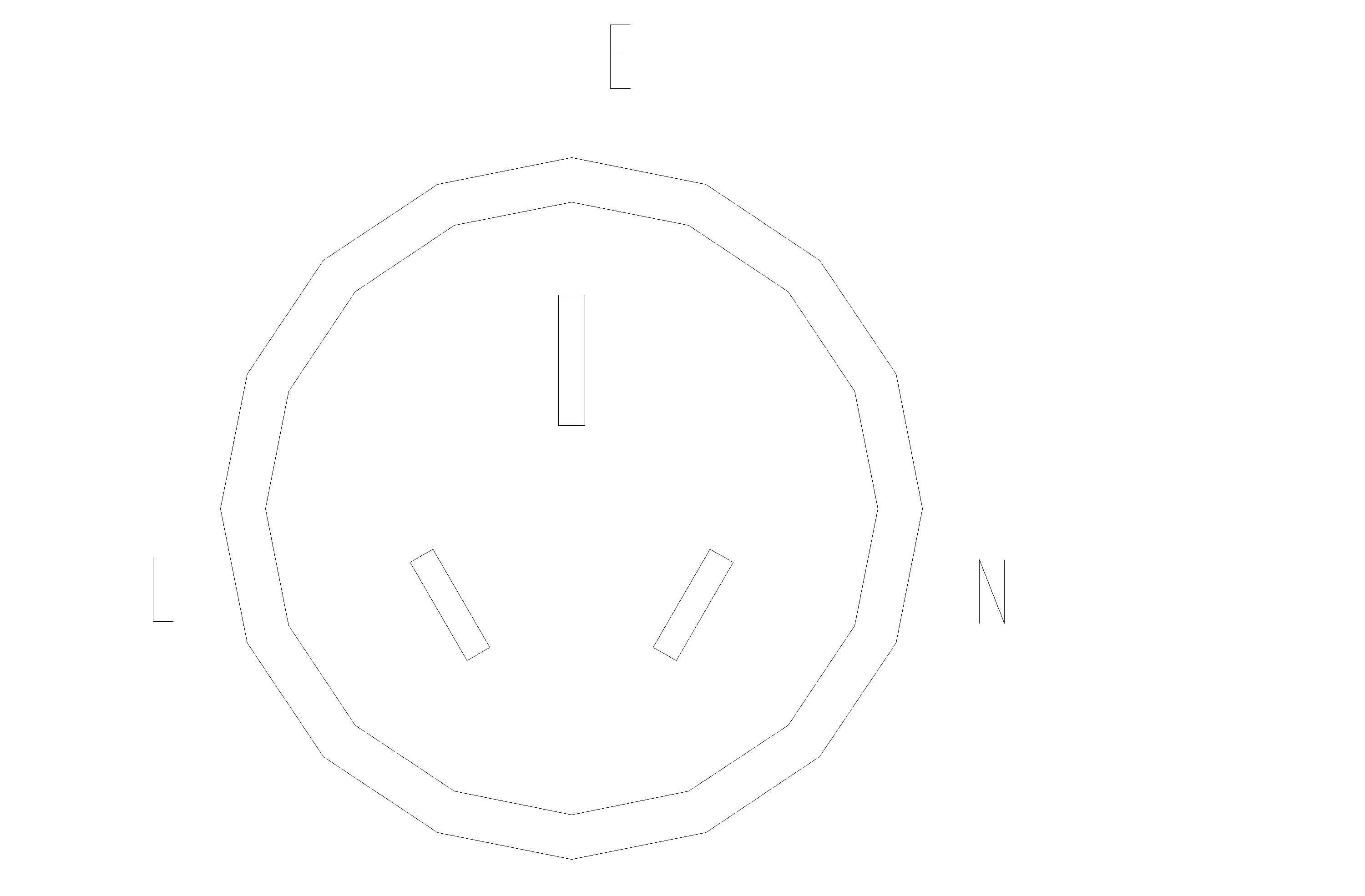

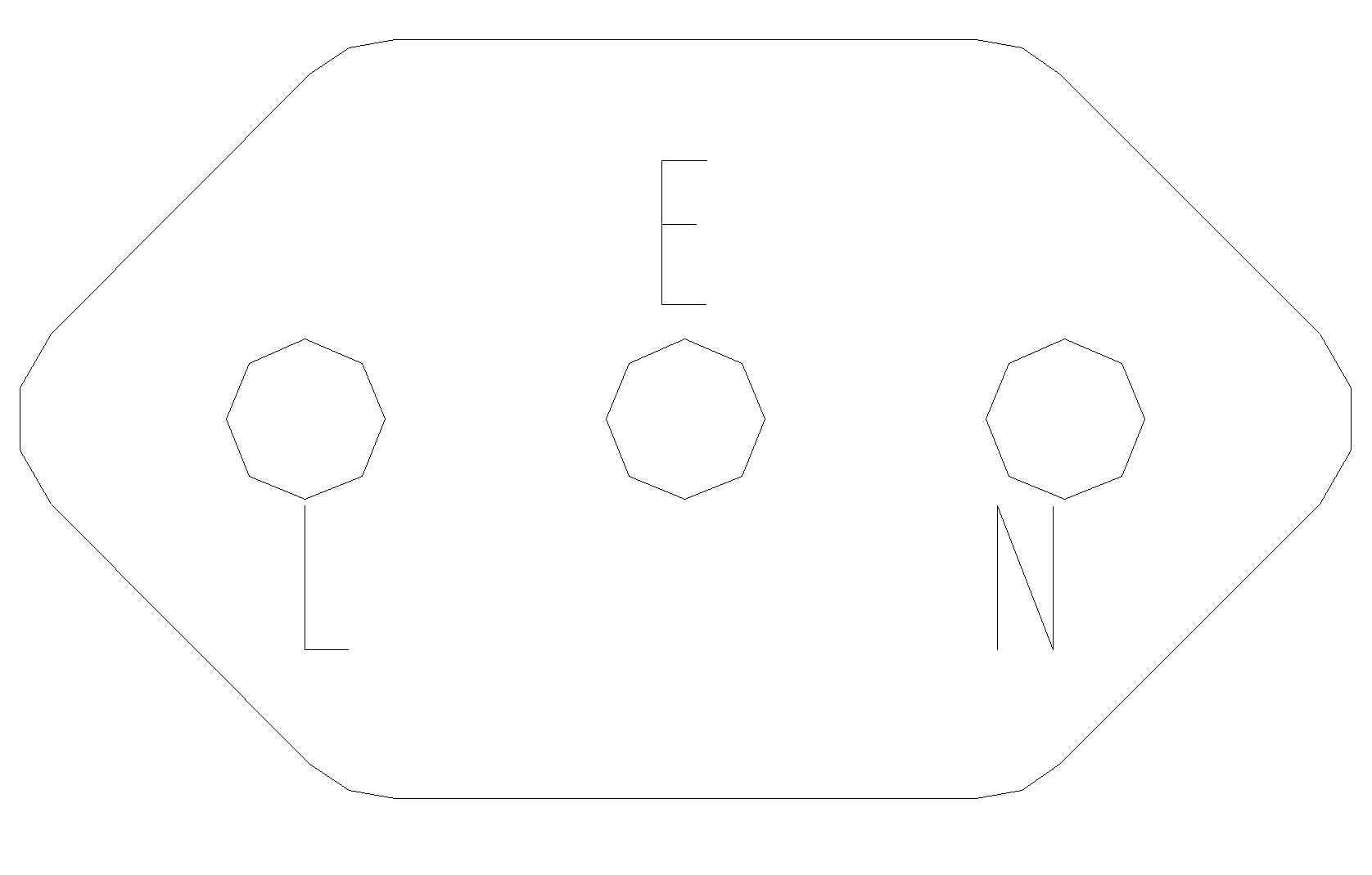

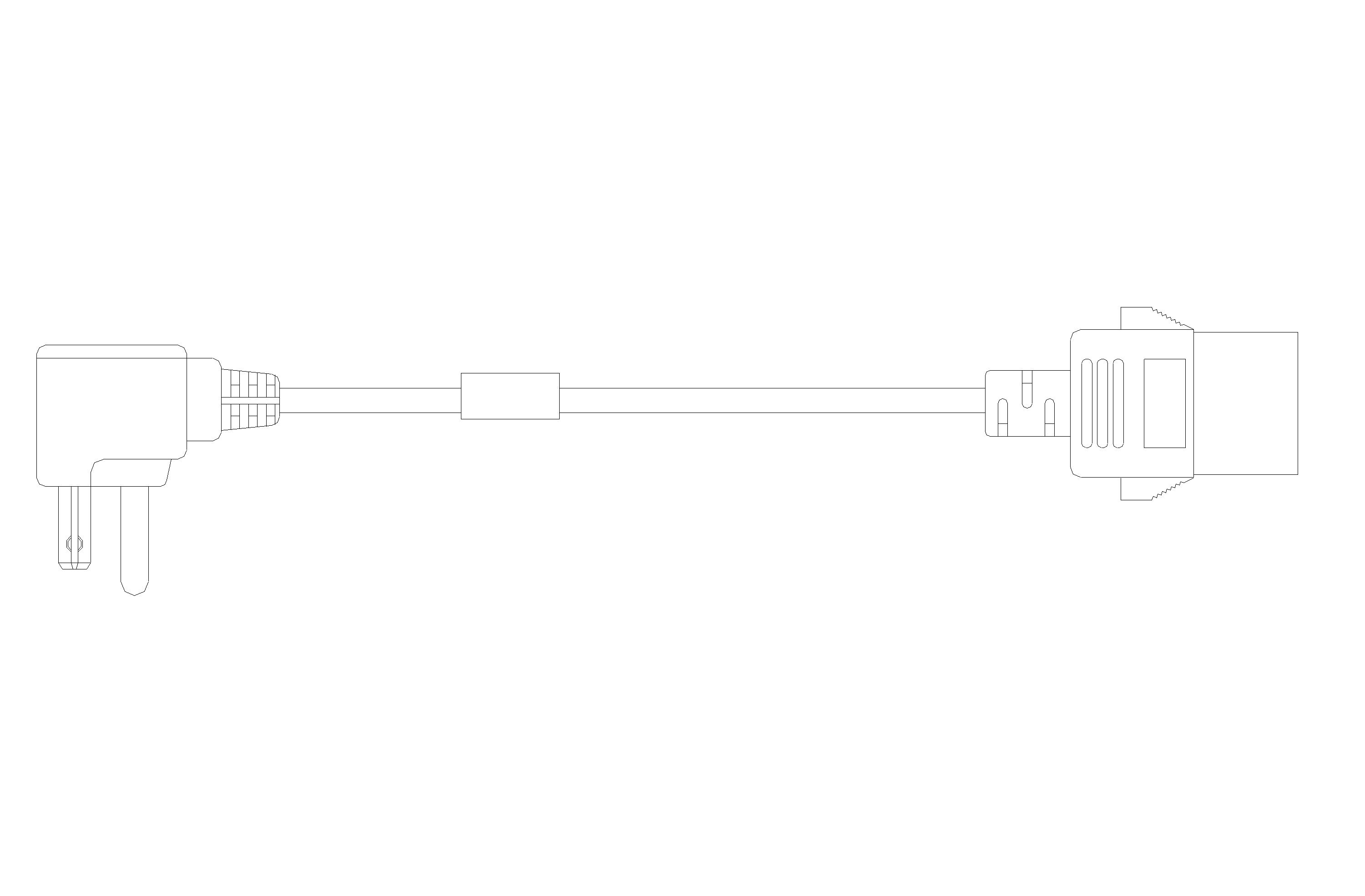

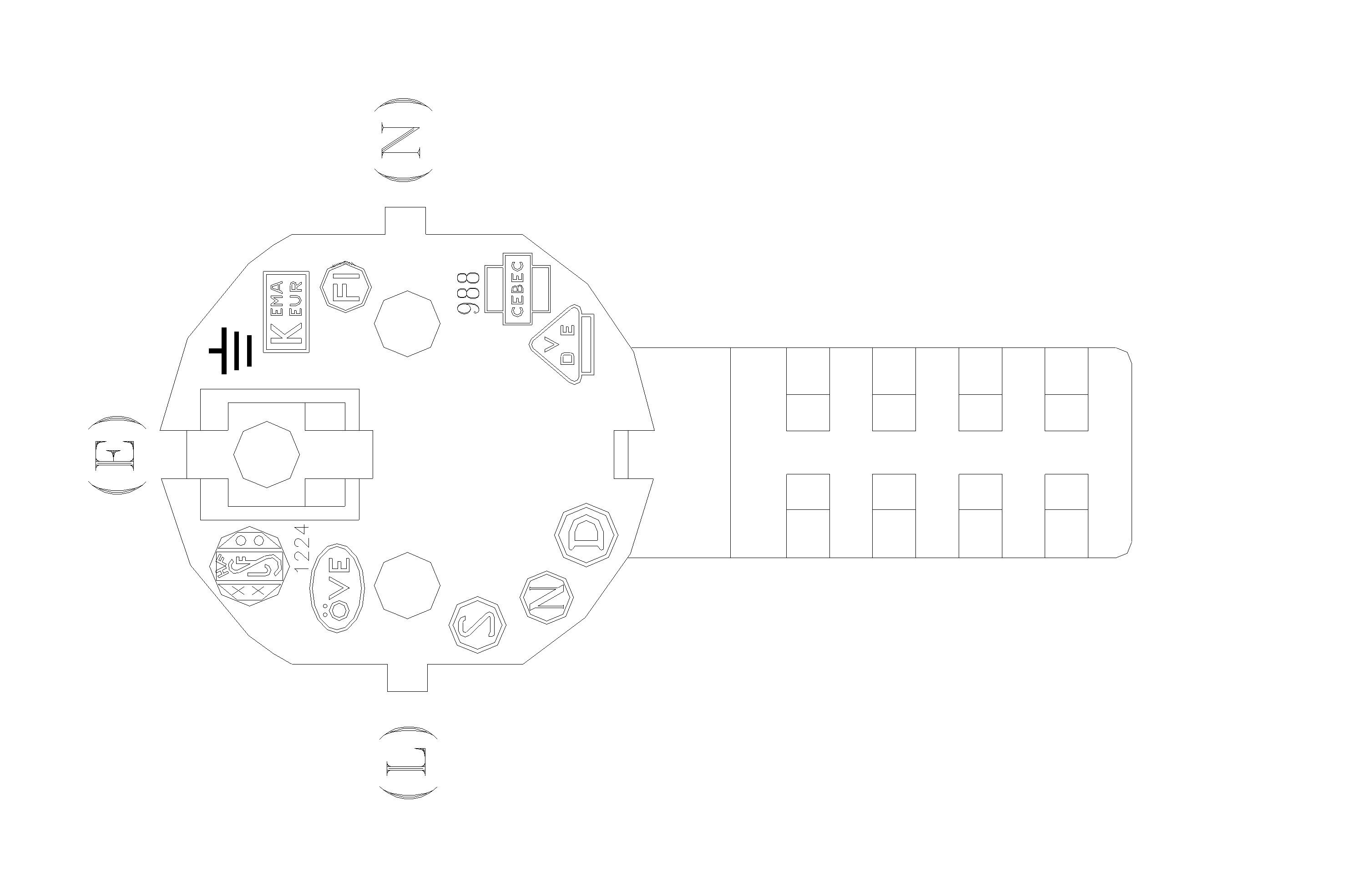

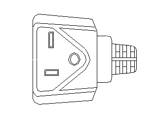

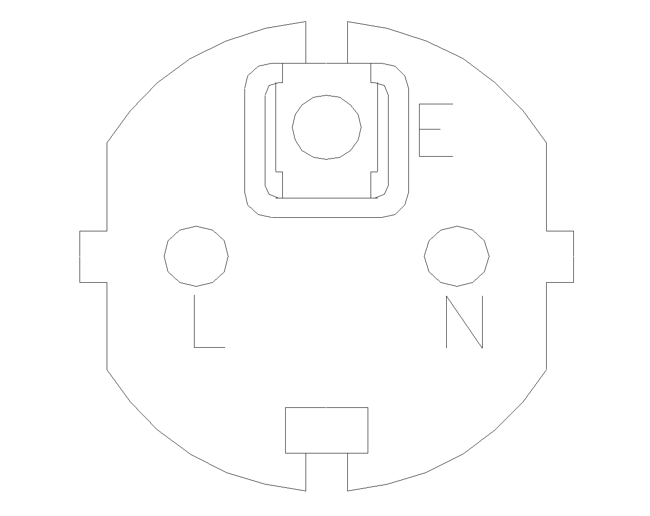

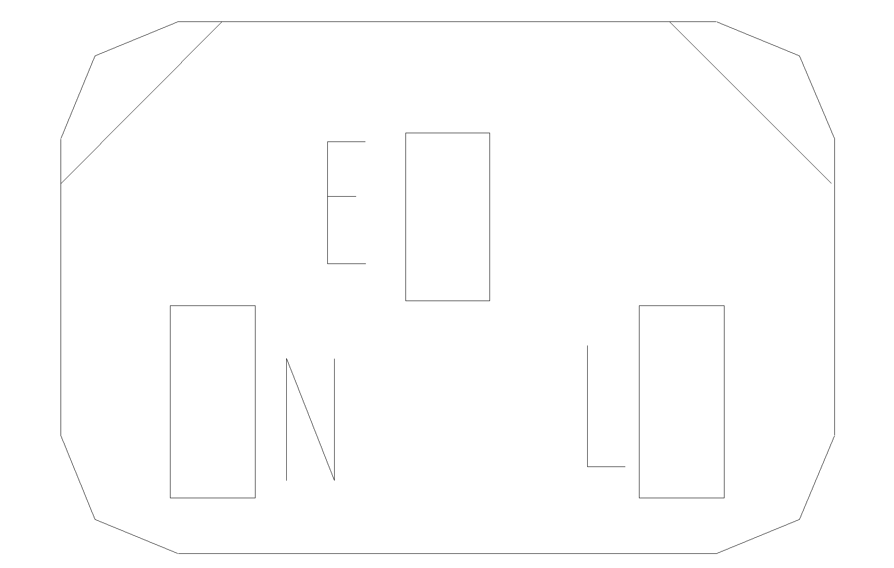

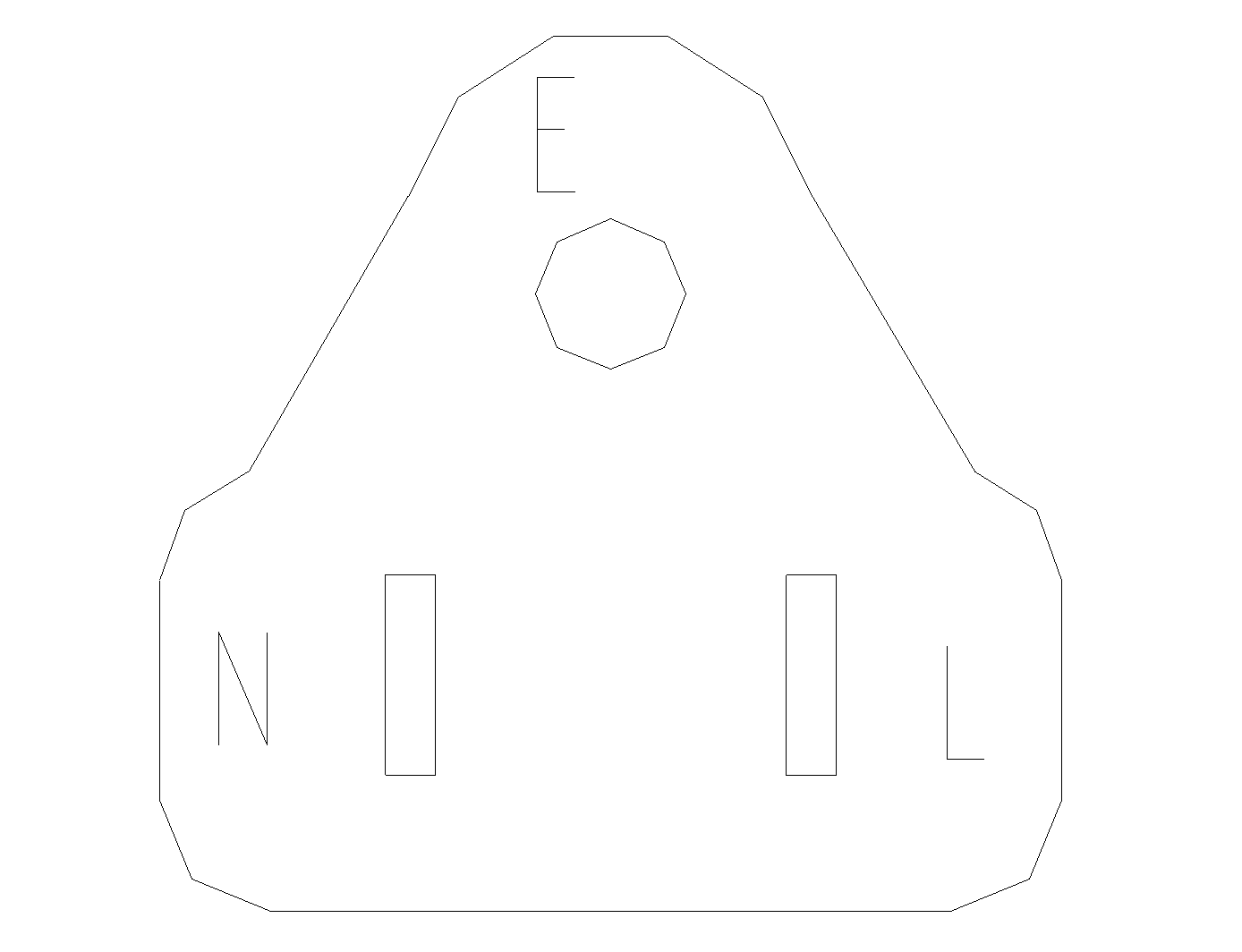

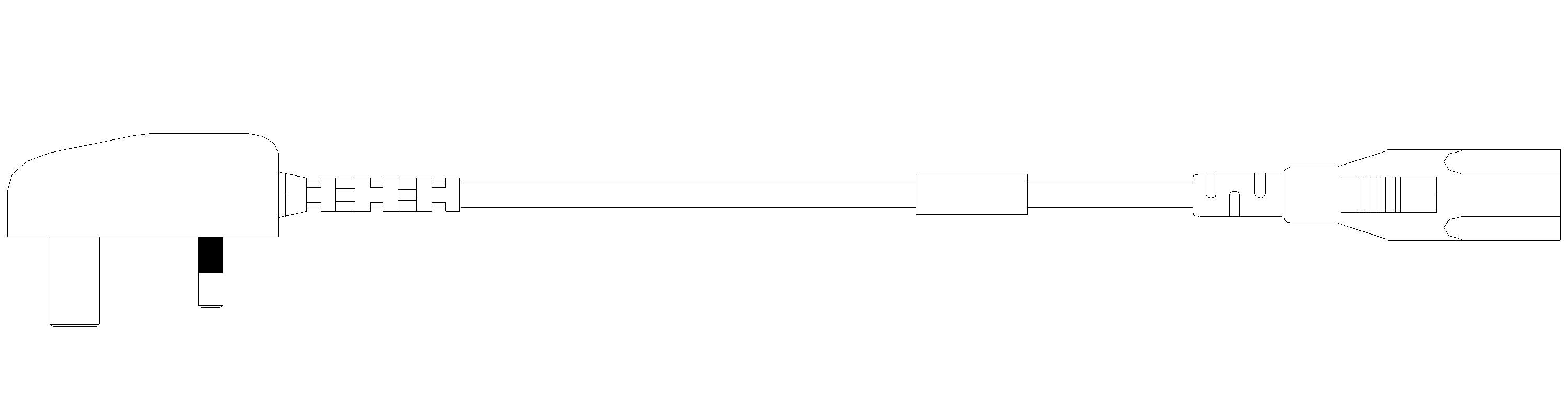

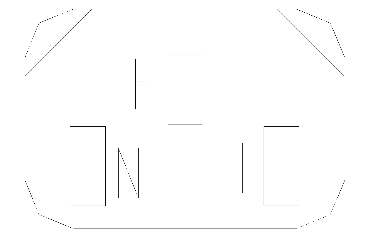

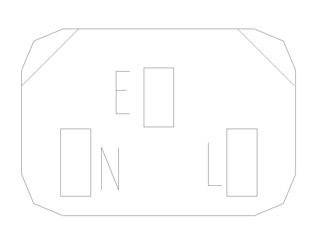

AC power cord
An AC power cord connects an AC power supply to an external AC power source.
· The power of a power supply has requirements on the current-carrying capacity of the AC power cord. Select an appropriate AC power cord based on the actual requirements.
· Available power plugs vary by country or region. Select the AC power cord that meets the requirements of the plug standard.
· AC power supplies of the CR16000-M require 16A or 10A AC power cords. For power plugs required by different countries or regions, see Table3-5 and Table3-6.
Code |
Description |
Power cord appearance (User side plug-Device side plug) |

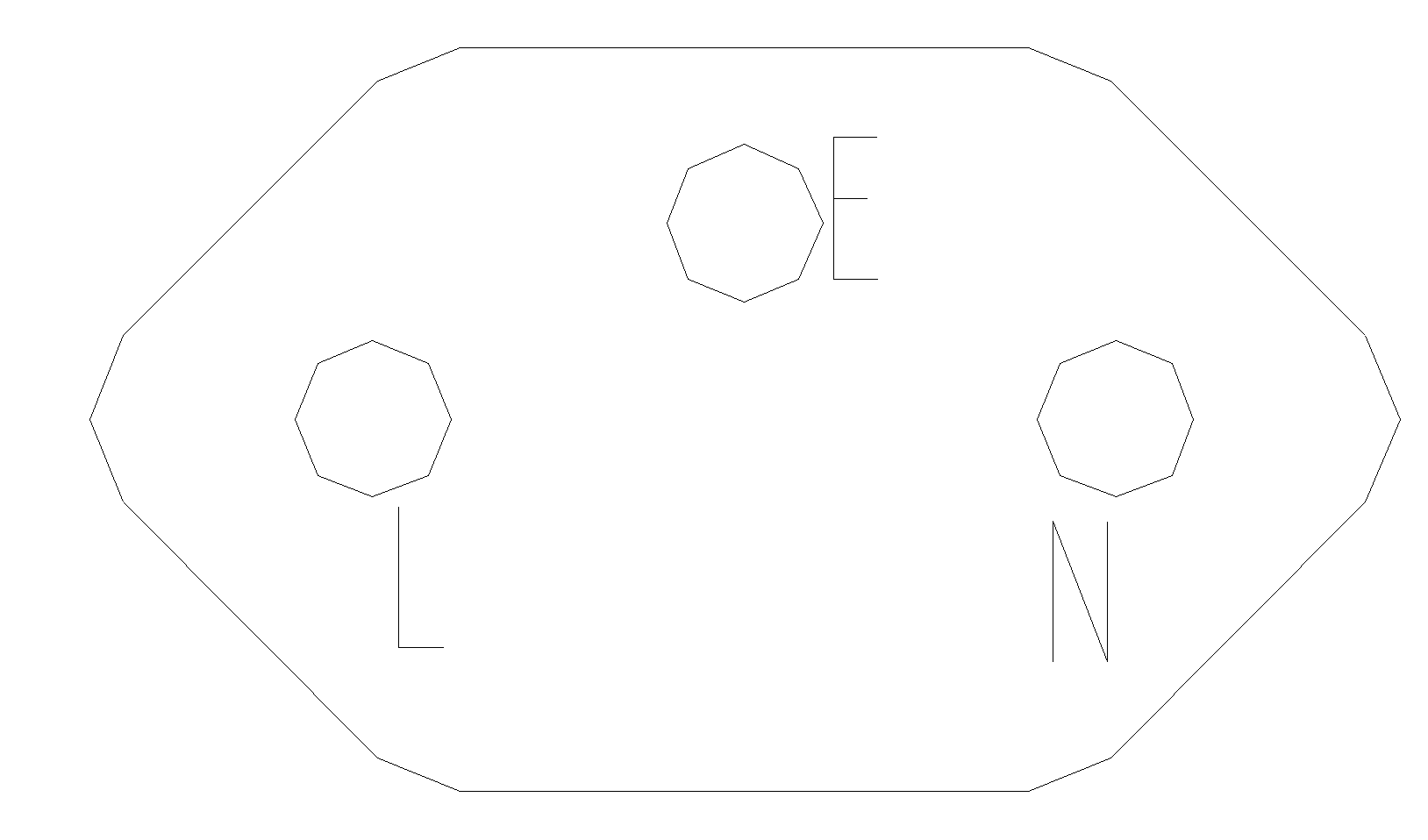

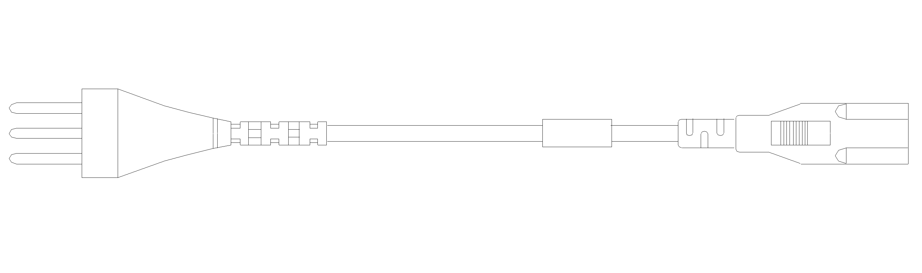

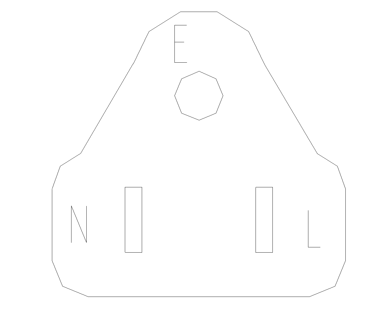

04041104 |
AC Power cord,3.0m,3*1.0mm^2,Black,GB1002P(3P)STM250V10A,227 IEC 53(RVV),C13C(3P)STF250V10A,CCC |
04020728 |
AC Power cord,3.0m,3*1.3mm^2,Black,NEMA5-15P(3P)STM125V13A,SJT,C13C(3P)STF125V13A,UL |
04041056 |
AC Power cord,3.0m,3*1.0mm^2,Black,CEE7-VIIP(3P)STM250V16A,H05VV-F,C13C(3P)STF250V10A,EU |
04040890 |
AC Power cord,3.0m,3*1.0mm^2,Black,BS1363AP(3P)AM250V13A,H05VV-F,C13C(3P)STF250V10A,ASTA |
04040887 |
AC Power cord,3.0m,3*1.25mm^2,Black,JIS C8303P(3P)STM125V12A,HVCTF,C13C(3P)STF125V12A,PSE |
04040888 |
AC Power cord,3.0m,3*1.0mm^2,Black,AS/NZS3112P(3P)STM250V10A,H05VV-F,C13C(3P)STF250V10A,SAA |
04041119 |
AC Power cord,3.0m,3*1.0mm^2,Black,SEV1011P(3P)STM250V10A,H05VV-F,C13C(3P)STF250V10A,SEV |
04041120 |
AC Power cord,3.0m,3*1.0mm^2,Black,CEI23-50P(3P)STM250V10A,H05VV-F,C13C(3P)STF250V10A,IMQ |
0404A0Q0 |
AC Power cord,3.0m,3*1.0mm^2,Black,IS1293P(3P)AM250V16A,IS694,C13C(3P)STF250V10A,BIS |
Code |
Description |

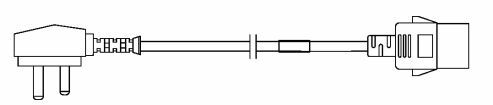

04043396 |
AC Power cord,3.0m,3*1.5mm^2,Black,GB1002P(3P)AM250V16A,227 IEC 53(RVV),C19C(3P)STF250V16A,CCC |
0404A0C2 |
AC Jumper Cord,3.0m,3*1.5mm^2,Black,C20C(3P)STM250V16A,227 IEC 53(RVV),C19C(3P)STF250V16A,CCC |
0404A063 |
AC Power cord,3.0m,3*3.3mm^2,Black,NEMA5-20PP(3P)AM125V20A,SJT,C19C(3P)STF125V20A,UL |
0404A061 |
AC Power cord,3.0m,3*1.5mm^2,Black,CEE7-VIIP(3P)AM250V16A,H05VV-F,C19C(3P)STF250V16A,EU |
0404A062 |
External Power Cable,Japan Power Cable 125V20A,3m,3*3.50mm^2,Black,PMAM,HVCTF-3.5^2(3C)B,C19SF |
0404A01A |
AC Power cord,3.0m,3*1.5mm^2,Black,AS/NZS3112P(3P)STM250V15A,H05VV-F,C19C(3P)STF250V15A,SAA |
0404A0RQ |
AC Power cord,3.0m,3*1.5mm^2,Black,GB1002P(3P)AM250V16A,227 IEC 53(RVV),HVDCBC(3P)STF250V16A,CCC |
NOTE: Select the power cord according to the country or region. |

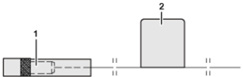

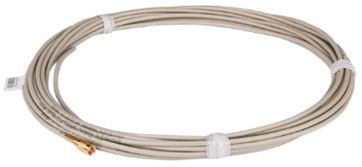

Clock cable
Clock cable for common MPUs
If connected to the clock interface of an external device through a clock cable, a router can receive 2-way 2.048MHz/2.048Mbit/s clock synchronization signals from the uplink device and provides 2-way 2.048MHz/2.048Mbit/s signals to the downlink.
A clock cable for common MPUs has an SMB connector at one end for connecting the clock interface on a router. The connector at the other end varies by the clock interface type on the external device.
Clock cable for 1588v2-capable MPUs
If connected to the clock interface of an external device through a clock cable, a router can receive 2Mbps/2MHz/1PPS+TOD clock signals from the uplink device and provides 2Mbps/2MHz/1PPS+TOD signals to the downlink.
75-ohm clock cables and 120-ohm clock cables are available for 1588v2-capable MPUs. A 75-ohm clock cable is used to transmit 2Mbps and 2MHz clock signals and a 120-ohm clock cable is used to transmit 1PPS+TOD clock signals.
At the router end, a 75-ohm clock cable provides an SMB connector and a 120-ohm clock cable provides an RJ-45 connector. The connector at the other end varies by the clock interface type on the external device.
Figure3-7 75-ohm clock cable
Figure3-8 75-ohm clock cable connector at the route side
(1) Coaxial connector-SMB |
(2) Label |
Table3-8 displays the pinouts for the RJ-45 connector of a 120-ohm cable.
Table3-8 Pinouts for the RJ-45 connector of a 120-ohm cable
RJ-45 |
Signal |
Description |
1 |
NC |
N/A |
2 |
NC |
N/A |
3 |
422_1_N |
1PPS |
4 |
GND |
Grounding |
5 |
GND |
Grounding |
6 |
422_1_P |
1PPS |
7 |
422_2_N |
TOD time information |
8 |
422_2_P |

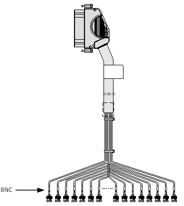

E1 cable
You can use an E1 cable to connect E1-HM96 Ethernet copper ports.
Figure3-14 E1 cable (1)
Figure3-15 E1 cable (2)
Figure3-16 E1 cable (3)
