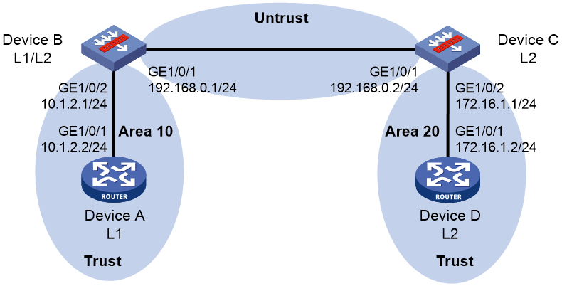

As shown in Figure 13, Device A, Device B, Device C, and Device D reside in an AS.
Device A is a Level-1 device, Device C and Device D are Level-2 devices, and Device B is a Level-1-2 device connecting two areas. Device A and Device B are in area 10. Device C and Device D are in area 20.
Figure 13 Network diagram

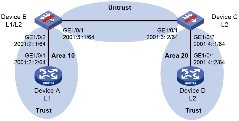

IPv6 IS-IS configuration examples
Example: Configuring IPv6 IS-IS basics
As shown in Figure 14, Device A, Device B, Device C, and Device D reside in an AS.
Figure 14 Network diagram
# Configure Device B.
1.     Configure IPv6 addresses for interfaces correctly according to the network diagram above.
a.     Configure an IPv6 address for GigabitEthernet 1/0/1.
<DeviceB> system-view
[DeviceB-GigabitEthernet1/0/1] ipv6 address 2001:3::1 64
[DeviceB-GigabitEthernet1/0/1] quit
b.     Configure IPv6 addresses for other interfaces in the same way GigabitEthernet 1/0/1 is configured. (Details not shown.)
2.     Add each interface on Device B to a security zone.
[DeviceB] security-zone name untrust
[DeviceB-security-zone-Untrust] import interface gigabitethernet 1/0/1
[DeviceB-security-zone-Untrust] quit
[DeviceB] security-zone name trust
[DeviceB-security-zone-Trust] import interface gigabitethernet 1/0/2
[DeviceB-security-zone-Trust] quit
3.     Configure security policies.
a.     Configure a security policy to allow IPv6 IS-IS neighbor relationship establishment by permitting traffic between security zone untrust and security zone local.
# Create security policy rule is-islocalin and permit Device B to receive IPv6 IS-IS packets from Device C.
[DeviceB] security-policy ipv6
[DeviceB-security-policy-ipv6] rule name is-islocalin
[DeviceB-security-policy-ipv6-0-is-islocalin] source-zone untrust
[DeviceB-security-policy-ipv6-0-is-islocalin] destination-zone local
[DeviceB-security-policy-ipv6-0-is-islocalin] action pass
[DeviceB-security-policy-ipv6-0-is-islocalin] quit
# Create security policy rule is-islocalout and permit Device B to send IPv6 IS-IS packets to Device C.
[DeviceB-security-policy-ipv6] rule name is-islocalout
[DeviceB-security-policy-ipv6-1-is-islocalout] source-zone local
[DeviceB-security-policy-ipv6-1-is-islocalout] destination-zone untrust
[DeviceB-security-policy-ipv6-1-is-islocalout] action pass
[DeviceB-security-policy-ipv6-1-is-islocalout] quit
b.     Configure a security policy to permit traffic between security zone trust and security zone local.
# Create security policy rule trust-local and permit Device A to send IPv6 IS-IS packets to Device B.
[DeviceB-security-policy-ipv6] rule name trust-local
[DeviceB-security-policy-ipv6-2-trust-local] source-zone trust
[DeviceB-security-policy-ipv6-2-trust-local] destination-zone local
[DeviceB-security-policy-ipv6-2-trust-local] action pass
[DeviceB-security-policy-ipv6-2-trust-local] quit
# Create security policy rule local-trust and permit Device B to send IPv6 IS-IS packets to Device A.
[DeviceB-security-policy-ipv6] rule name local-trust
[DeviceB-security-policy-ipv6-3-local-trust] source-zone local
[DeviceB-security-policy-ipv6-3-local-trust] destination-zone trust
[DeviceB-security-policy-ipv6-3-local-trust] action pass
[DeviceB-security-policy-ipv6-3-local-trust] quit
[DeviceB-security-policy-ipv6] quit
c.     Configure a security policy that permits traffic between security zone untrust and security zone trust to permit traffic between area 10 and area 20.
# Create security policy rule trust-untrust and permit packets from security zone trust to security zone untrust to pass.
[DeviceB-security-policy-ipv6] rule name trust-untrust
[DeviceB-security-policy-ipv6-4-trust-untrust] source-zone trust
[DeviceB-security-policy-ipv6-4-trust-untrust] destination-zone untrust
[DeviceB-security-policy-ipv6-4-trust-untrust] source-ip-subnet 2001:2:: 64
[DeviceB-security-policy-ipv6-4-trust-untrust] destination-ip-subnet 2001:4:: 64
[DeviceB-security-policy-ipv6-4-trust-untrust] action pass
[DeviceB-security-policy-ipv6-4-trust-untrust] quit
# Create security policy rule untrust-trust and permit packets from security zone untrust to security zone trust to pass.
[DeviceB-security-policy-ip] rule name untrust-trust
[DeviceB-security-policy-ip-5-untrust-trust] source-zone untrust
[DeviceB-security-policy-ip-5-untrust-trust] destination-zone trust
[DeviceB-security-policy-ip-5-untrust-trust] source-ip-subnet 2001:4:: 64
[DeviceB-security-policy-ip-5-untrust-trust] destination-ip-subnet 2001:2:: 64
[DeviceB-security-policy-ip-5-untrust-trust] action pass
[DeviceB-security-policy-ip-5-untrust-trust] quit
[DeviceB-security-policy-ip] quit
4.     Enable IS-IS.
[DeviceB] isis 1
[DeviceB-isis-1] network-entity 10.0000.0000.0001.00
[DeviceB-isis-1] address-family ipv6
[DeviceB-isis-1-ipv6] quit
[DeviceB-isis-1] quit
[DeviceB-GigabitEthernet1/0/1] isis ipv6 enable 1
[DeviceB] interface gigabitethernet 1/0/2
[DeviceB-GigabitEthernet1/0/2] isis ipv6 enable 1
[DeviceB-GigabitEthernet1/0/2] quit
# Configure Device C.
<DeviceC> system-view
[DeviceC] interface gigabitethernet 1/0/1
[DeviceC-GigabitEthernet1/0/1] ipv6 address 2001:3::2 64
[DeviceC-GigabitEthernet1/0/1] quit
2.     Add each interface on Device C to a security zone.
[DeviceC] security-zone name untrust
[DeviceC-security-zone-Untrust] import interface gigabitethernet 1/0/1
[DeviceC-security-zone-Untrust] quit
[DeviceC] security-zone name trust
[DeviceC-security-zone-Trust] import interface gigabitethernet 1/0/2
[DeviceC-security-zone-Trust] quit
a.     Configure a security policy to allow IS-IS neighbor relationship establishment by permitting traffic between security zone untrust and security zone local.
# Create security policy rule is-islocalin and permit Device C to receive IPv6 IS-IS packets from Device B.
[DeviceC] security-policy ipv6
[DeviceC-security-policy-ipv6] rule name is-islocalin
[DeviceC-security-policy-ipv6-0-is-islocalin] source-zone untrust
[DeviceC-security-policy-ipv6-0-is-islocalin] destination-zone local
[DeviceC-security-policy-ipv6-0-is-islocalin] action pass
[DeviceC-security-policy-ipv6-0-is-islocalin] quit
# Create security policy rule is-islocalout and permit Device C to send IPv6 IS-IS packets to Device B.
[DeviceC-security-policy-ipv6] rule name is-islocalout
[DeviceC-security-policy-ipv6-1-is-islocalout] source-zone local
[DeviceC-security-policy-ipv6-1-is-islocalout] destination-zone untrust
[DeviceC-security-policy-ipv6-1-is-islocalout] action pass
[DeviceC-security-policy-ipv6-1-is-islocalout] quit
# Create security policy rule trust-local and permit Device D to send IPv6 IS-IS packets to Device C.
[DeviceC-security-policy-ipv6] rule name trust-local
[DeviceC-security-policy-ipv6-2-trust-local] source-zone trust
[DeviceC-security-policy-ipv6-2-trust-local] destination-zone local
[DeviceC-security-policy-ipv6-2-trust-local] action pass
[DeviceC-security-policy-ipv6-2-trust-local] quit
# Create security policy rule local-trust and permit Device C to send IPv6 IS-IS packets to Device D.
[DeviceC-security-policy-ipv6] rule name local-trust
[DeviceC-security-policy-ipv6-3-local-trust] source-zone local
[DeviceC-security-policy-ipv6-3-local-trust] destination-zone trust
[DeviceC-security-policy-ipv6-3-local-trust] action pass
[DeviceC-security-policy-ipv6-3-local-trust] quit
[DeviceC-security-policy-ipv6] quit
[DeviceC-security-policy-ipv6] rule name trust-untrust
[DeviceC-security-policy-ipv6-4-trust-untrust] source-zone trust
[DeviceC-security-policy-ipv6-4-trust-untrust] destination-zone untrust
[DeviceC-security-policy-ipv6-4-trust-untrust] source-ip-subnet 2001:4:: 64
[DeviceC-security-policy-ipv6-4-trust-untrust] destination-ip-subnet 2001:2:: 64
[DeviceC-security-policy-ipv6-4-trust-untrust] action pass
[DeviceC-security-policy-ipv6-4-trust-untrust] quit
[DeviceC-security-policy-ipv6] rule name untrust-trust
[DeviceC-security-policy-ipv6-5-untrust-trust] source-zone untrust
[DeviceC-security-policy-ipv6-5-untrust-trust] destination-zone trust
[DeviceC-security-policy-ipv6-5-untrust-trust] source-ip-subnet 2001:2:: 64
[DeviceC-security-policy-ipv6-5-untrust-trust] destination-ip-subnet 2001:4:: 64
[DeviceC-security-policy-ipv6-5-untrust-trust] action pass
[DeviceC-security-policy-ipv6-5-untrust-trust] quit
4.     Enable IPv6 IS-IS.
[DeviceC] isis 1
[DeviceC-isis-1] is-level level-2
[DeviceC-isis-1] network-entity 20.0000.0000.0001.00
[DeviceC-isis-1] address-family ipv6
[DeviceC-isis-1-ipv6] quit
[DeviceC-isis-1] quit
[DeviceC-GigabitEthernet1/0/1] isis ipv6 enable 1
[DeviceC] interface gigabitethernet 1/0/2
[DeviceC-GigabitEthernet1/0/2] isis ipv6 enable 1
[DeviceC-GigabitEthernet1/0/2] quit
# Configure Device A.
1.     Configure an IPv6 address for GigabitEthernet 1/0/1 correctly according to the network diagram above.
<DeviceA> system-view
[DeviceA-GigabitEthernet1/0/1] ipv6 address 2001:2::2 64
[DeviceA-GigabitEthernet1/0/1] quit
2.     Enable IPv6 IS-IS.
[DeviceA] isis 1
[DeviceA-isis-1] is-level level-1
[DeviceA-isis-1] network-entity 10.0000.0000.0002.00
[DeviceA-isis-1] address-family ipv6
[DeviceA-isis-1-ipv6] quit
[DeviceA-isis-1] quit
[DeviceA-GigabitEthernet1/0/1] isis ipv6 enable 1
# Configure Device D.
<DeviceD> system-view
[DeviceD] interface gigabitethernet 1/0/1
[DeviceD-GigabitEthernet1/0/1] ipv6 address 2001:4::2 64
[DeviceD-GigabitEthernet1/0/1] quit
[DeviceD] isis 1
[DeviceD-isis-1] is-level level-2
[DeviceD-isis-1] network-entity 20.0000.0000.0002.00
[DeviceD-isis-1] address-family ipv6
[DeviceD-isis-1-ipv6] quit
[DeviceD-isis-1] quit
[DeviceD-GigabitEthernet1/0/1] isis ipv6 enable 1
# View IPv6 IS-IS routing information on Device B.
[DeviceB] display isis route ipv6
                         Route information for IS-IS(1)
                         Level-1 IPv6 forwarding table
 Destination : 2001:2::                                PrefixLen: 64
 Flag        : D/L/-                                   Cost     : 10
 Next hop    : Direct                                  Interface: GE1/0/2
 Destination : 2001:3::                                PrefixLen: 64
 Next hop    : Direct                                  Interface: GE1/0/1
      Flags: D-Direct, R-Added to Rib, L-Advertised in LSPs, U-Up/Down Bit Set
                         Level-2 IPv6 forwarding table
 Destination : 2001:4::1                               PrefixLen: 64
 Flag        : R/-/-                                   Cost     : 10
# Verify that devices in area 10 can ping the devices in area 20, and vice versa.
