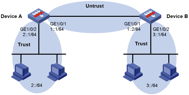

RIPng configuration examples
Example: Configuring basic RIPng
As shown in Figure 2, Device A and Device B are attached to networks 2::/64 and 3::/64, respectively. Configure RIPng on Device A and Device B to enable communication between the two networks.
Figure 2 Network diagram
Configuring Device A
1.     Assign IPv6 addresses to interfaces:
# Assign an IPv6 address to interface GigabitEthernet 1/0/1.
<DeviceA> system-view
[DeviceA-GigabitEthernet1/0/1] ipv6 address 1::1 64
[DeviceA-GigabitEthernet1/0/1] quit
# Assign IPv6 addresses to other interfaces in the same way. (Details not shown.)
2.     Add interfaces to security zones.
[DeviceA] security-zone name untrust
[DeviceA-security-zone-Untrust] import interface gigabitethernet 1/0/1
[DeviceA-security-zone-Untrust] quit
[DeviceA] security-zone name trust
[DeviceA-security-zone-Trust] import interface gigabitethernet 1/0/2
[DeviceA-security-zone-Trust] quit
3.     Configure security policies:
a.     Configure a security policy to permit traffic between the Untrust and Local security zones, and enable the devices to establish RIPng neighbor relationship with each other.
# Configure a rule named ripnglocalin to allow Device A to receive RIPng packets from Device B.
[DeviceA] security-policy ipv6
[DeviceA-security-policy-ipv6] rule name ripnglocalin
[DeviceA-security-policy-ipv6-0-ripnglocalin] source-zone untrust
[DeviceA-security-policy-ipv6-0-ripnglocalin] destination-zone local
[DeviceA-security-policy-ipv6-0-ripnglocalin] service rip
[DeviceA-security-policy-ipv6-0-ripnglocalin] action pass
[DeviceA-security-policy-ipv6-0-ripnglocalin] quit
# Configure a rule named ripnglocalout to allow Device A to send RIPng packets to Device B.
[DeviceA-security-policy-ipv6] rule name ripnglocalout
[DeviceA-security-policy-ipv6-1-ripnglocalout] source-zone local
[DeviceA-security-policy-ipv6-1-ripnglocalout] destination-zone untrust
[DeviceA-security-policy-ipv6-1-ripnglocalout] service rip
[DeviceA-security-policy-ipv6-1-ripnglocalout] action pass
[DeviceA-security-policy-ipv6-1-ripnglocalout] quit
b.     Configure a security policy to permit traffic between the Trust and Untrust security zones, and enable communication between network 2::/64 and network 3::/64.
# Configure a rule named trust-untrust to permit packets from network 2::/64 to network 3::/64.
[DeviceA-security-policy-ipv6] rule name trust-untrust
[DeviceA-security-policy-ipv6-2-trust-untrust] source-zone trust
[DeviceA-security-policy-ipv6-2-trust-untrust] destination-zone untrust
[DeviceA-security-policy-ipv6-2-trust-untrust] source-ip-subnet 2:: 64
[DeviceA-security-policy-ipv6-2-trust-untrust] destination-ip-subnet 3:: 64
[DeviceA-security-policy-ipv6-2-trust-untrust] action pass
[DeviceA-security-policy-ipv6-2-trust-untrust] quit
# Configure a rule named untrust-trust to permit packets from network 3::/64 to network 2::/64.
[DeviceA-security-policy-ipv6] rule name untrust-trust
[DeviceA-security-policy-ipv6-3-untrust-trust] source-zone untrust
[DeviceA-security-policy-ipv6-3-untrust-trust] destination-zone trust
[DeviceA-security-policy-ipv6-3-untrust-trust] source-ip-subnet 3:: 64
[DeviceA-security-policy-ipv6-3-trust-untrust] destination-ip-subnet 2:: 64
[DeviceA-security-policy-ipv6-3-untrust-trust] action pass
[DeviceA-security-policy-ipv6-3-untrust-trust] quit
[DeviceA-security-policy-ipv6] quit
4.     Configure basic RIPng functions.
[DeviceA] ripng 1
[DeviceA-ripng-1] quit
[DeviceA-GigabitEthernet1/0/1] ripng 1 enable
[DeviceA] interface gigabitethernet 1/0/2
[DeviceA-GigabitEthernet1/0/2] ripng 1 enable
[DeviceA-GigabitEthernet1/0/2] quit
Configuring Device B
<DeviceB> system-view
[DeviceB-GigabitEthernet1/0/1] ipv6 address 1::2 64
[DeviceB-GigabitEthernet1/0/1] quit
[DeviceB] security-zone name untrust
[DeviceB-security-zone-Untrust] import interface gigabitethernet 1/0/1
[DeviceB-security-zone-Untrust] quit
[DeviceB] security-zone name trust
[DeviceB-security-zone-Trust] import interface gigabitethernet 1/0/2
[DeviceB-security-zone-Trust] quit
# Configure a rule named ripnglocalin to allow Device B to receive RIPng packets from Device A.
[DeviceB] security-policy ipv6
[DeviceB-security-policy-ipv6] rule name ripnglocalin
[DeviceB-security-policy-ipv6-0-ripnglocalin] source-zone untrust
[DeviceB-security-policy-ipv6-0-ripnglocalin] destination-zone local
[DeviceB-security-policy-ipv6-0-ripnglocalin] service rip
[DeviceB-security-policy-ipv6-0-ripnglocalin] action pass
[DeviceB-security-policy-ipv6-0-ripnglocalin] quit
# Configure a rule named ripnglocalout to allow Device B to send RIPng packets to Device A.
[DeviceB-security-policy-ipv6] rule name ripnglocalout
[DeviceB-security-policy-ipv6-1-ripnglocalout] source-zone local
[DeviceB-security-policy-ipv6-1-ripnglocalout] destination-zone untrust
[DeviceB-security-policy-ipv6-1-ripnglocalout] service rip
[DeviceB-security-policy-ipv6-1-ripnglocalout] action pass
[DeviceB-security-policy-ipv6-1-ripnglocalout] quit
# Configure a rule named trust-untrust to permit packets from network 3::/64 to network 2::/64.
[DeviceB-security-policy-ipv6] rule name trust-untrust
[DeviceB-security-policy-ipv6-2-trust-untrust] source-zone trust
[DeviceB-security-policy-ipv6-2-trust-untrust] destination-zone untrust
[DeviceB-security-policy-ipv6-2-trust-untrust] source-ip-subnet 3:: 64
[DeviceB-security-policy-ipv6-2-trust-untrust] destination-ip-subnet 2:: 64
[DeviceB-security-policy-ipv6-2-trust-untrust] action pass
[DeviceB-security-policy-ipv6-2-trust-untrust] quit
# Configure a rule named untrust-trust to permit packets from network 2::/64 to network 3::/64.
[DeviceB-security-policy-ipv6] rule name untrust-trust
[DeviceB-security-policy-ipv6-3-untrust-trust] source-zone untrust
[DeviceB-security-policy-ipv6-3-untrust-trust] destination-zone trust
[DeviceB-security-policy-ipv6-3-untrust-trust] source-ip-subnet 2:: 64
[DeviceB-security-policy-ipv6-3-trust-untrust] destination-ip-subnet 3:: 64
[DeviceB-security-policy-ipv6-3-untrust-trust] action pass
[DeviceB-security-policy-ipv6-3-untrust-trust] quit
[DeviceB-security-policy-ipv6] quit
[DeviceB] ripng 1
[DeviceB-ripng-1] quit
[DeviceB-GigabitEthernet1/0/1] ripng 1 enable
[DeviceB] interface gigabitethernet 1/0/2
[DeviceB-GigabitEthernet1/0/2] ripng 1 enable
[DeviceB-GigabitEthernet1/0/2] quit
# Display the RIPng routing table of Device A.
[Device A] display ripng 1 route
 Route Flags: A - Aging, S - Suppressed, G - Garbage-collect, D - Direct
                O - Optimal, F - Flush to RIB
 Peer FE80::76A5::A3FF:FE7B:205 on GigabitEthernet1/0/1
 Destination 3::/64,
     via FE80::76A5:A3FF:FE7B:205, cost 1, tag 0, AOF, 17 secs
 Local route
 Destination 2::/64,
     via ::, cost 0, tag 0, DOF
 Destination 1::/64,
The output shows that the hosts in network 2::/64 can communicate with the hosts in network 3::/64.
