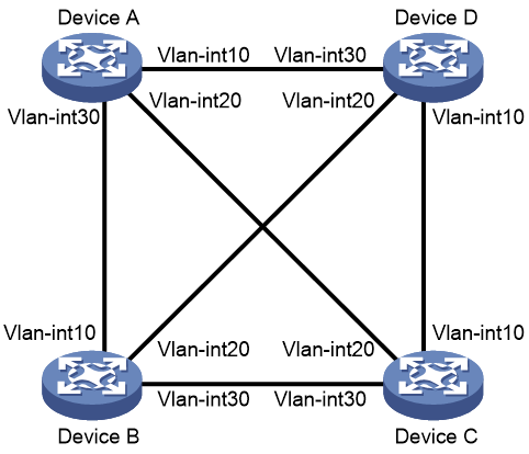

Figure 2 shows one IS-IS network topology. Area 1 is the backbone that comprises a set of Level-2 routers. The other four areas are non-backbone areas connected to the backbone through Level-1-2 routers.
Figure 2 IS-IS topology 1
Figure 3 shows another IS-IS topology. No area is defined as the backbone in this topology. The backbone comprises all contiguous Level-2 and Level-1-2 routers in different areas. The IS-IS backbone does not need to be a specific area.
Figure 3 IS-IS topology 2
Both the Level-1 and Level-2 routers use the SPF algorithm to generate the shortest path tree.

Configuring IPv6 IS-IS MTR
On a network, IPv4 and IPv6 topologies must be consistent so that both IPv6 IS-IS and IPv4 IS-IS can use the SPF algorithm to perform route calculation. If they are different, routers supporting both IPv4 and IPv6 might send IPv6 packets to routers that do not support IPv6, resulting in packet loss.
To resolve this issue, configure IPv6 IS-IS MTR to perform route calculation separately in IPv4 and IPv6 topologies.
Figure 7 Network diagram
As shown in Figure 7, the numbers refer to the link costs. Router A, Router B, and Router D support both IPv4 and IPv6. Router C supports only IPv4 and cannot forward IPv6 packets.
Enable IPv6 IS-IS MTR on Router A, Router B, Router C, and Router D to make them perform route calculation separately in IPv4 and IPv6 topologies. With this configuration, Router A does not forward IPv6 packets destined to Router D through Router B, avoiding packet loss.
As a best practice to avoid route calculation failures, configure this feature when both IPv4 and IPv6 topologies exist in the network.

On a fully meshed network, many P2P links exist. As shown in Figure 12, Devices A, B, C and D run IS-IS. When Device A generates an LSP, it floods the LSP out of VLAN-interface 10, VLAN-interface 20, and VLAN-interface 30. After Device D receives the LSP from VLAN-interface 30, it floods it out of VLAN-interface 10 and VLAN-interface 20 to Device B and Device C. However, Device B and Device C have already received the LSP from Device A. Repeated LSP flooding consumes extra bandwidth.
Figure 12 Network diagram of a fully meshed network
To avoid this problem, you can add interfaces to a mesh group or block some interfaces.

Setting the LSDB overload bit
By setting the overload bit in sent LSPs, an IS-IS device informs other devices of failures that make it unable to select routes and forward packets. The device is then excluded from the SPF calculation by other devices except its direct routes.
When an IS-IS device cannot record the complete LSDB, for example, because of memory insufficiency, it will calculate routes incorrectly. To locate the faulty device, you can temporarily isolate the suspects from the IS-IS network by setting the overload bit.
As shown in Figure 13, the path from Device A to the IP network should be Device A > Device D > Device E > IP network. After you set the overload bit in the LSPs sent by Device D, the path from Device A to the IP network becomes Device A > Device B > Device C > Device E > IP network. If the packets from Device A are destined for Device D's directly-connected networks, the forwarding path does not change.
Figure 13 Overload bit
When both IPv4 and IPv6 topologies exist, the following rules apply to the set-overload command and the multi-topology command:
·     If the set-overload command is executed in IS-IS view and the multi-topology command is not executed, the set-overload command takes effect on both IPv4 IS-IS and IPv6 IS-IS.
·     If the following conditions exist, the set-overload command does not take effect on IPv6 IS-IS after it is executed in IS-IS IPv6 unicast address family view:
¡     The set-overload command is not executed in IS-IS view.
¡     The multi-topology command is not executed.
·     If the set-overload command is executed in IS-IS view and the multi-topology command is executed, the set-overload command takes effect only on IPv4 IS-IS. To have the set-overload command take effect on IPv6 IS-IS, you must execute it in IS-IS IPv6 unicast address family view.

Configuring IS-IS LFA FRR
About IS-IS LFA FRR
A link or router failure on a path can cause packet loss. IS-IS LFA FRR enables fast rerouting to minimize the failover time.
Figure 14 Network diagram for IS-IS LFA FRR
In Figure 14, after you enable LFA FRR on Router B, IS-IS automatically calculates or designates a backup next hop when a link failure is detected. In this way, packets are directed to the backup next hop to reduce traffic recovery time. Meanwhile, IS-IS calculates the shortest path based on the new network topology, and forwards packets over the path after network convergence.
You can assign a backup next hop for IS-IS FRR through the following ways:
·     Enable IS-IS LFA FRR to calculate a backup next hop through LFA calculation.
·     Designate a backup next hop with a routing policy for routes matching specific criteria.
The LFA calculation of FRR and that of TE are mutually exclusive.

Example: Configuring DIS election
As shown in Figure 17, Switches A, B, C, and D reside in IS-IS area 10 on a broadcast network (Ethernet). Switch A and Switch B are Level-1-2 switches, Switch C is a Level-1 switch, and Switch D is a Level-2 switch.
Change the DIS priority of Switch A to make it elected as the Level-1-2 DIS router.
Figure 17 Network diagram
1.     Configure IP addresses for interfaces. (Details not shown.)

Example: Configuring IS-IS route redistribution
As shown in Figure 18, Switch A, Switch B, Switch C, and Switch D reside in the same AS. They use IS-IS to interconnect. Switch A and Switch B are Level-1 routers, Switch D is a Level-2 router, and Switch C is a Level-1-2 router.
Redistribute RIP routes into IS-IS on Switch D.
Figure 18 Network diagram

Example: Configuring IS-IS authentication
As shown in Figure 19, Switch A, Switch B, Switch C, and Switch D reside in the same IS-IS routing domain. Run IS-IS among them.
Switch A, Switch B, and Switch C belong to Area 10, and Switch D belongs to Area 20.
·     Configure neighbor relationship authentication between neighbors.
·     Configure area authentication in Area 10 to prevent untrusted routes from entering into the area.
·     Configure routing domain authentication on Switch C and Switch D to prevent untrusted routes from entering the routing domain.
Figure 19 Network diagram

[SwitchC] interface vlan-interface 300
[SwitchC-Vlan-interface300] isis authentication-mode md5 plain hSec
[SwitchC-Vlan-interface300] quit
[SwitchD] interface vlan-interface 300
[SwitchD-Vlan-interface300] isis authentication-mode md5 plain hSec
[SwitchD-Vlan-interface300] quit
4.     Set the area authentication mode to MD5 and set the plaintext key to 10Sec on Switch A, Switch B, and Switch C.
[SwitchA] isis 1
[SwitchA-isis-1] area-authentication-mode md5 plain 10Sec
[SwitchA-isis-1] quit
[SwitchB] isis 1
[SwitchB-isis-1] area-authentication-mode md5 plain 10Sec
[SwitchB-isis-1] quit
[SwitchC] isis 1
[SwitchC-isis-1] area-authentication-mode md5 plain 10Sec
[SwitchC-isis-1] quit
5.     Set routing domain authentication mode to MD5 and set the plaintext key to 1020Sec on Switch C and Switch D.
[SwitchC] isis 1
[SwitchC-isis-1] domain-authentication-mode md5 plain 1020Sec
[SwitchD] isis 1
[SwitchD-isis-1] domain-authentication-mode md5 plain 1020Sec

IPv6 IS-IS configuration examples
Example: Configuring IPv6 IS-IS basics
As shown in Figure 25, Switch A, Switch B, Switch C, and Switch D, all enabled with IPv6, reside in the same AS. Configure IPv6 IS-IS on the switches so that they can reach each other.
Switch A and Switch B are Level-1 switches, Switch D is a Level-2 switch, and Switch C is a Level-1-2 switch.
Figure 25 Network diagram
1.     Configure IPv6 addresses for interfaces. (Details not shown.)
2.     Configure IPv6 IS-IS:
# Configure Switch A.
<SwitchA> system-view
[SwitchA] isis 1
[SwitchA-isis-1] is-level level-1
[SwitchA-isis-1] network-entity 10.0000.0000.0001.00
[SwitchA-isis-1] address-family ipv6
[SwitchA-isis-1-ipv6] quit
[SwitchA-Vlan-interface100] isis ipv6 enable 1
# Configure Switch B.
<SwitchB> system-view
[SwitchB] isis 1
[SwitchB-isis-1] is-level level-1
[SwitchB-isis-1] network-entity 10.0000.0000.0002.00
[SwitchB-isis-1] address-family ipv6
[SwitchB-isis-1-ipv6] quit
[SwitchB] interface vlan-interface 200
[SwitchB-Vlan-interface200] isis ipv6 enable 1
[SwitchB-Vlan-interface200] quit
# Configure Switch C.
<SwitchC> system-view
[SwitchC] isis 1
[SwitchC-isis-1] network-entity 10.0000.0000.0003.00
[SwitchC-isis-1] address-family ipv6
[SwitchC-isis-1-ipv6] quit
[SwitchC] interface vlan-interface 100
[SwitchC-Vlan-interface100] isis ipv6 enable 1
[SwitchC-Vlan-interface100] quit
[SwitchC] interface vlan-interface 200
[SwitchC-Vlan-interface200] isis ipv6 enable 1
[SwitchC-Vlan-interface200] quit
[SwitchC-Vlan-interface300] isis ipv6 enable 1

Example: Configuring BFD for IPv6 IS-IS
As shown in Figure 26:
·     Configure IPv6 IS-IS on Switch A and Switch B so that they can reach other.
·     Enable BFD on VLAN-interface 10 of Switch A and Switch B.
After the link between Switch B and the Layer 2 switch fails, BFD can quickly detect the failure and notify IPv6 IS-IS of the failure. Then Switch A and Switch B communicate through Switch C.
Figure 26 Network diagram
Table 7 Interface and IP address assignment
Device
Interface
IPv6 address
Device
Interface
IPv6 address
Switch A
Vlan-int10
2001::1/64
Switch B
Vlan-int10
2001::2/64
Vlan-int11
2001:2::1/64
Vlan-int13
2001:3::2/64
Switch C
Vlan-int11
2001:2::2/64
Vlan-int13
2001:3::1/64

# Display route 10::1/128 on Switch B to view the backup next hop information.
[SwitchB] display ipv6 routing-table 10::1 128 verbose
Summary count : 1
Destination: 10::1/128
   Protocol: IS_L1
 Process ID: 1
  SubProtID: 0x1                    Age: 00h33m23s
       Cost: 10              Preference: 15
      IpPre: N/A             QosLocalID: N/A
        Tag: 0                    State: Active Adv
  OrigTblID: 0xa                OrigVrf: default-vrf
    TableID: 0xa                 OrigAs: 0
      NibID: 0x24000006          LastAs: 0
     AttrID: 0xffffffff        Neighbor: ::
      Flags: 0x10041        OrigNextHop: FE80::34CC:E8FF:FE5B:C02
      Label: NULL           RealNextHop: FE80::34CC:E8FF:FE5B:C02
    BkLabel: NULL             BkNextHop: FE80::7685:45FF:FEAD:102
    SRLabel: NULL             BkSRLabel: NULL
   SIDIndex: NULL               InLabel: NULL
  Tunnel ID: Invalid          Interface: Vlan-interface200
BkTunnel ID: Invalid        BkInterface: Vlan-interface101
   FtnIndex: 0x0           TrafficIndex: N/A
  Connector: N/A                 PathID: 0x0
   LinkCost: 0               MicroSegID: 0
RealFIRType: Normal           RealThres: 0
