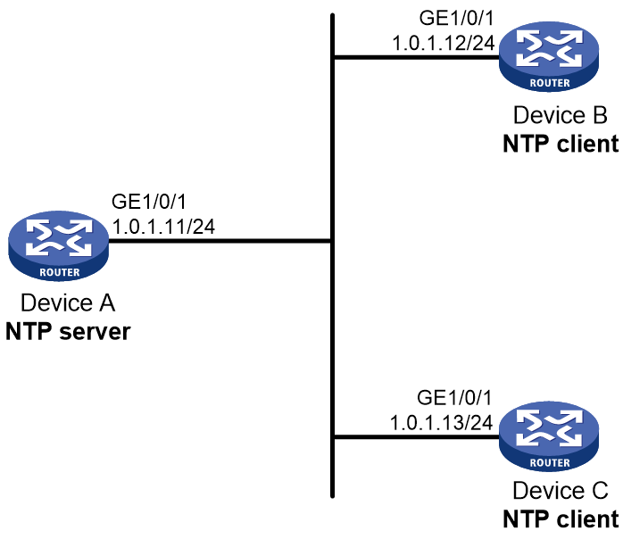

As shown in Figure 1, Device A on the network can be used as a time server to provide accurate time synchronization. Configure the NTP client/server mode to enable all devices to synchronize the time with Device A.
Figure 1 Network diagram

Configuring Device A
# Assign an IPv6 address to GigabitEthernet 1/0/1.
<DeviceA> system-view
[DeviceA-GigabitEthernet1/0/1] ip address 1.0.1.11 24
[DeviceA-GigabitEthernet1/0/1] quit
# Enable the NTP service.
[DeviceA] ntp-service enable
# Specify the local clock as the reference source, with the stratum level 2.
[DeviceA] ntp-service refclock-master 2
Configuring Device B
# Assign an IP address to GigabitEthernet 1/0/1.
<DeviceB> system-view
[DeviceB-GigabitEthernet1/0/1] ip address 1.0.1.12 24
[DeviceB-GigabitEthernet1/0/1] quit
[DeviceB] ntp-service enable
# Configure Device B to obtain time through NTP.
[DeviceB] clock protocol ntp
# Specify Device A as the NTP server of Device B.
[DeviceB] ntp-service unicast-server 1.0.1.11
Configuring Device C
<DeviceC> system-view
[DeviceC] interface gigabitethernet 1/0/1
[DeviceC-GigabitEthernet1/0/1] ip address 1.0.1.13 24
[DeviceC-GigabitEthernet1/0/1] quit
# Configure Device C to obtain time through NTP.
[DeviceC] clock protocol ntp
# Specify Device A as the NTP server of Device C.
[DeviceC] ntp-service unicast-server 1.0.1.11
