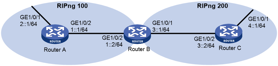

Example: Configuring RIPng route redistribution
As shown in Figure 3, Router B communicates with Router A through RIPng 100 and with Router C through RIPng 200.
Configure route redistribution on Router B, so the two RIPng processes can redistribute routes from each other.
Figure 3 Network diagram
1.     Configure IPv6 addresses for the interfaces. (Details not shown.)
2.     Configure basic RIPng settings:
# Enable RIPng 100 on Router A.
<RouterA> system-view
[RouterA] ripng 100
[RouterA-ripng-100] quit
[RouterA] interface gigabitethernet 1/0/1
[RouterA-GigabitEthernet1/0/1] ripng 100 enable
[RouterA-GigabitEthernet1/0/1] quit
[RouterA] interface gigabitethernet 1/0/2
[RouterA-GigabitEthernet1/0/2] ripng 100 enable
# Enable RIPng 100 and RIPng 200 on Router B.
<RouterB> system-view
[RouterB] ripng 100
[RouterB-ripng-100] quit
[RouterB] interface gigabitethernet 1/0/2
[RouterB-GigabitEthernet1/0/2] ripng 100 enable
[RouterB-GigabitEthernet1/0/2] quit
[RouterB] ripng 200
[RouterB-ripng-200] quit
[RouterB-GigabitEthernet1/0/1] ripng 200 enable
#  Enable RIPng 200 on Router C.
<RouterC> system-view
[RouterC] ripng 200
[RouterC] interface gigabitethernet 1/0/1
[RouterC-GigabitEthernet1/0/1] ripng 200 enable
[RouterC-GigabitEthernet1/0/1] quit
[RouterC] interface gigabitethernet 1/0/2
[RouterC-GigabitEthernet1/0/2] ripng 200 enable
[RouterC-GigabitEthernet1/0/2] quit

3.     Configure RIPng route redistribution:
# Configure route redistribution between the two RIPng processes on Router B.
[RouterB] ripng 100
[RouterB-ripng-100] import-route ripng 200
[RouterB] ripng 200
[RouterB-ripng-200] import-route ripng 100
# Display the routing table on Router A.
