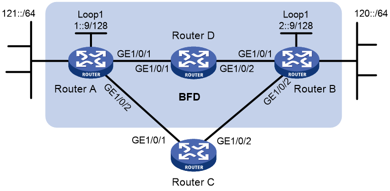

Example: Configuring BFD for IPv6 static routes (indirect next hop)
As shown in Figure 3:
·     Router A has a route to interface Loopback 1 (2::9/128) on Router B, and the output interface is GigabitEthernet 1/0/1.
·     Router B has a route to interface Loopback 1 (1::9/128) on Router A, and the output interface is GigabitEthernet 1/0/1.
·     Router D has a route to 1::9/128, and the output interface is GigabitEthernet 1/0/1. It also has a route to 2::9/128, and the output interface is GigabitEthernet 1/0/2.
Configure the following:
·     Configure an IPv6 static route to subnet 120::/64 on Router A.
·     Configure an IPv6 static route to subnet 121::/64 on Router B.
·     Enable BFD for both routes.
·     Configure an IPv6 static route to subnet 120::/64 and an IPv6 static route to subnet 121::/64 on both Router C and Router D.
When the link between Router A and Router B through Router D fails, BFD can detect the failure immediately and Router A and Router B can communicate through Router C.
Figure 3 Network diagram

1.     Configure IPv6 addresses for interfaces. (Details not shown.)
2.     Configure IPv6 static routes and BFD:
# Configure IPv6 static routes on Router A and enable BFD control packet mode for the IPv6 static route that traverses Router D.
<RouterA> system-view
[RouterA] bfd multi-hop min-transmit-interval 500
[RouterA] bfd multi-hop min-receive-interval 500
[RouterA] bfd multi-hop detect-multiplier 9
[RouterA] ipv6 route-static 120:: 64 2::9 bfd control-packet bfd-source 1::9
[RouterA] ipv6 route-static 120:: 64 10::100 preference 65
[RouterA] ipv6 route-static 2::9 128 12::2
[RouterA] quit
# Configure IPv6 static routes on Router B and enable BFD control packet mode for the IPv6 static route that traverses Router D.
<RouterB> system-view
[RouterB] bfd multi-hop min-transmit-interval 500
[RouterB] bfd multi-hop min-receive-interval 500
[RouterB] bfd multi-hop detect-multiplier 9
[RouterB] ipv6 route-static 121:: 64 1::9 bfd control-packet bfd-source 2::9
[RouterB] ipv6 route-static 121:: 64 13::2 preference 65
[RouterB] ipv6 route-static 1::9 128 11::1
[RouterB] quit
# Configure IPv6 static routes on Router C.
<RouterC> system-view
[RouterC] ipv6 route-static 120:: 64 13::1
[RouterC] ipv6 route-static 121:: 64 10::102
# Configure IPv6 static routes on Router D.
<RouterD> system-view
[RouterD] ipv6 route-static 120:: 64 11::2
[RouterD] ipv6 route-static 121:: 64 12::1
[RouterD] ipv6 route-static 2::9 128 11::2
[RouterD] ipv6 route-static 1::9 128 12::1
# Display BFD sessions on Router A.
<RouterA> display bfd session
 Total sessions: 1        Up sessions: 1        Init mode: Active
 IPv6 session working in control packet mode:
       Local discr: 513                 Remote discr: 33
         Source IP: 1::9
    Destination IP: 2::9
     Session state: Up                      Interface: N/A
         Hold time: 2012ms
The output shows that the BFD session has been created.
# Display IPv6 static routes on Router A.
<RouterA> display ipv6 routing-table protocol static
Summary Count : 1
Static Routing table Status : <Active>
Summary Count : 1
Destination: 120::/64                                    Protocol  : Static
NextHop    : 2::9                                        Preference: 60
Interface  : GE1/0/1                                     Cost      : 0
Static Routing table Status : <Inactive>
Summary Count : 0
The output shows that Router A communicates with Router B through GigabitEthernet 1/0/1. The link over GigabitEthernet 1/0/1 fails.
Summary Count : 1
Summary Count : 1
NextHop    : 10::100                                     Preference: 65
Interface  : GE1/0/2                                     Cost      : 0
Summary Count : 0
The output shows that Router A communicates with Router B through GigabitEthernet 1/0/2.
