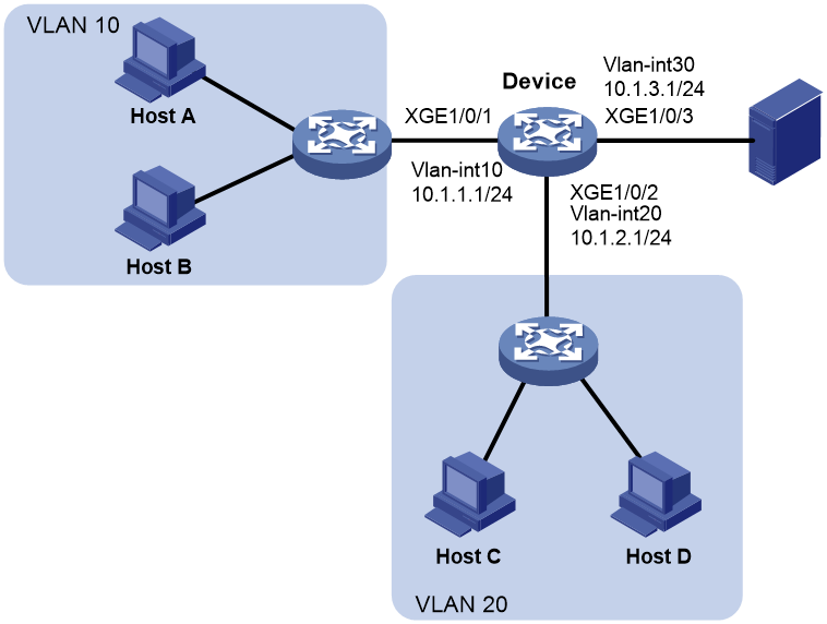

Example: Configuring ARP attack protection
As shown in Figure 1, the device connects to the server through GE1/0/3 as a gateway and connects to Host A and Host B in VLAN 10, and Host C and Host D in VLAN 20 through GE1/0/1 and GE1/0/2, respectively.
Configure ARP attack protection on the device to prevent the following ARP threats:
· Host A sends forged ARP packets and forged gratuitous ARP packets to the device to edit the ARP entries on the device maliciously. As a result, other users cannot receive data packets normally.
· Host C sends a large number of unresolvable IP packets to attack the device, causing the following results:
¡ The device CPU is busy, affecting normal service processing.
¡ The device sends a large number of ARP requests, overloading the target subnets.
· Host D launches ARP flood attacks by sending a large number of ARP packets with different source IP addresses but fixed MAC address. Such attacks run out the ARP table resources on the device and cause a busy CPU, affecting normal service processing.
Besides, Host B might send a large number of ARP packets to the device. This is normal ARP behavior required by services. Do not filter out packets sent from Host B when you configure ARP attack protection.

Analysis
To meet the network requirements, configure the device as follows:
· To prevent forged ARP packets sent by Host A from updating the ARP entries on the device, configure ARP blackhole routing and ARP active acknowledgement in strict mode.
· To prevent the forged gratuitous ARP packets sent by Host A from updating the ARP entries on the device, disable gratuitous ARP packet learning.
· To avoid unresolvable packets sent by Host C, enable ARP source suppression and set the maximum number of unresolvable packets that the device can process per source IP address within 5 seconds.
· To avoid ARP flood attacks caused by ARP packets with the same IP address, enable ARP packet rate limit and set the limit rate. When Host C launches ARP flood attacks on the device by sending a large number of ARP packets with the same source IP address, the device discards the packets that exceed the limit rate to avoid a busy CPU.
· To avoid users on the interfaces consume too many ARP resources, set the dynamic ARP learning limits for the interfaces.
· To avoid ARP flood attacks caused by ARP packets with different IP addresses but fixed MAC address sent by Host D, configure source MAC-based ARP attack detection. If you fail to configure this feature, the ARP table resources run out and the CPU is busy. To avoid filtering out packets sent by Host B, exclude the MAC address of Host B from this detection.
When you configure ARP attack protection, follow these restrictions and guidelines:
· When you configure ARP active acknowledgement in strict mode, make sure ARP blackhole routing is enabled.
· After you disable gratuitous ARP packet learning, the device does not create ARP entries when receiving gratuitous ARP packets, but updates the existing corresponding ARP entries. If you do not want the device to create ARP entries for gratuitous ARP packets, disable gratuitous ARP packet learning to save ARP entry resources.
· When you set the check interval for source MAC-based ARP attack detection, follow these guidelines:
¡ If attacks occur frequently in your network, set a short check interval so that source MAC-based ARP attacks can be detected in a timely manner. If attacks seldom occur, you can set a long check interval.
¡ If you set the check interval for source MAC-based ARP attack detection multiple times, the most recent configuration takes effect.
