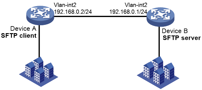

Example: Configuring the device as an Stelnet server using password authentication
As shown in Figure 1:
·     The device uses local password authentication.
·     The login username and password are client001 and hello12345, respectively.
Establish an Stelnet connection between the host and the device, so you can log in to the device to manage the campus network.
Figure 1 Network diagram

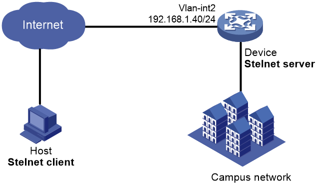

Example: Configuring the device as an Stelnet server using publickey authentication
As shown in Figure 4:
·     The device uses publickey authentication and RSA public key algorithm.
·     The login username is client001.
Import the client's host public key to the server to ensure correct format and content of the public key.
Figure 4 Network diagram

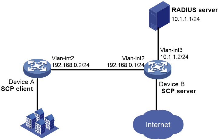

Example: Configuring the device as an Stelnet client for password authentication
As shown in Figure 12:
·     Device B uses local password authentication.
Establish an Stelnet connection between Device A and Device B, so you can log in to Device B to use all commands and perform secure data exchange.
To ensure communication security, configure Device A to use the host public key of Device B to authenticate Device B.
Figure 12 Network diagram

Example: Configuring SFTP with password-publickey authentication
As shown in Figure 13:
·     Device B uses password-publickey authentication and RSA public key algorithm.
Establish an SFTP connection between Device A and Device B, so you can log in to Device B to perform file and directory operations.
Figure 13 Network diagram
Analysis
To meet the network requirements, you must perform the following tasks:
·     Because the client's host public key is required in the server configuration, you must generate RSA key pairs on the client before configuring the SFTP server.
·     For successful publickey authentication, perform the following tasks:
a.     Configure the client's RSA host public key on the server.
b.     Specify the paired RSA host private key for the SSH user on the client.
To specify the RSA host private key on the client, use the identity-key rsa keyword in the sftp command.
·     To perform local authentication, create a local user and configure a password for the local user on the SFTP server.
·     To enable an SSH user to use all commands after login, set the user role of the local user to network-admin. By default, the user role of a local user is network-operator.
·     To assign correct working directory and user role to the SSH user, configure the local user to have the same username as the SSH user.

Example: Configuring SCP file transfer with remote password authentication
As shown in Figure 14, configure the devices and the RADIUS server to meet the following requirements:
·     Establish an SCP connection between Device A and Device B, so you can log in to Device B to perform file transfer.
·     Use the RADIUS server for SSH user authentication and authorization. The user name and password are hello@bbb and hello12345, respectively.
·     Include the domain name in the username sent to the RADIUS server.
·     Assign the default user role network-admin to the SSH user, so the user can use all commands after login.
Figure 14 Network diagram
Analysis
·     To ensure correct SSH version negotiation and algorithm negotiation, and to ensure that the server can pass the client's authentication, generate DSA and RSA key pairs on the SSH server.
·     To perform remote password authentication, configure the username and password on the RADIUS server. To enable an SSH user to use all commands after login, set the user role to network-admin for the user on the RADIUS server.
·     To use the RADIUS server for authentication and authorization, perform the following tasks on Device B:
a.     Configure a RADIUS scheme to specify the authentication and authorization server.
b.     Create an ISP domain, and specify the ISP domain to use the RADIUS scheme for authentication, authorization, and accounting.
·     To ensure communication security between the RADIUS client (Device B) and the RADIUS server, configure the same shared key on Device B and the RADIUS server.

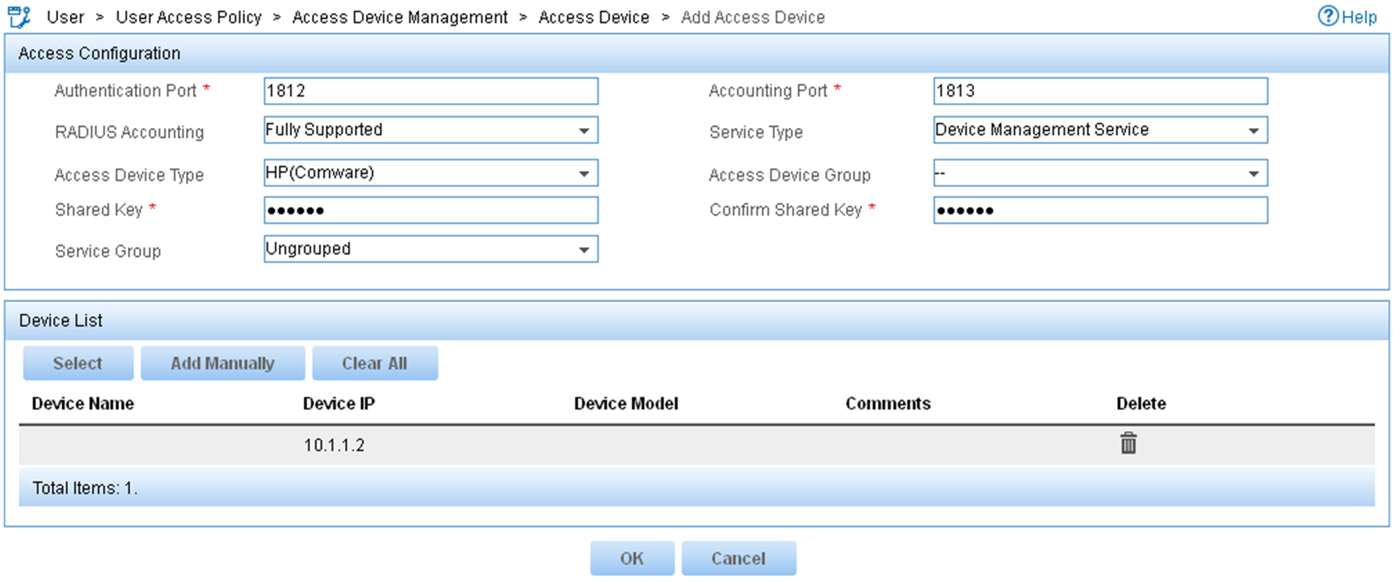

Adding Device B to the IMC Platform as an access device
1.     Log in to IMC.
2.     Click the User tab.
3.     From the navigation tree, select User Access Policy> Access Device Management > Access Device.
4.     Click Add.
5.     Configure an access device as follows:
a.     Set the ports for authentication and accounting to 1812 and 1813, respectively.
b.     Select the service type Device Management Service.
c.     Select the access device type HP(Comware).
d.     Set the shared key to expert for secure RADIUS communication.
e.     Select Device B from the device list or manually add Device B. (The IP address of Device B is 10.1.1.2).
f.     Use the default settings for other parameters.
6.     Click OK.
Figure 15 Adding Device B as an access device

Configuring Device B
# Generate RSA key pairs.
<DeviceB> system-view
[DeviceB] public-key local create rsa
The range of public key modulus is (512 ~ 4096).
If the key modulus is greater than 512, it will take a few minutes.
Press CTRL+C to abort.
Input the modulus length [default = 1024]:
Generating Keys...
Create the key pair successfully.
# Generate a DSA key pair.
[DeviceB] public-key local create dsa
The range of public key modulus is (512 ~ 2048).
Generating Keys...
# Generate an ECDSA key pair.
[DeviceB] public-key local create ecdsa secp256r1
Generating Keys...
# Create VLAN 2, and assign Ten-GigabitEthernet 1/0/2 to VLAN 2.
[DeviceB] vlan 2
[DeviceB-vlan2] port ten-gigabitethernet 1/0/2
[DeviceB-vlan2] quit
# Assign an IP address to VLAN-interface 2. The SCP client uses this address as the destination IP address of the SCP connection.
[DeviceB] interface vlan-interface 2
[DeviceB-Vlan-interface2] ip address 192.168.0.1 255.255.255.0
[DeviceB-Vlan-interface2] quit
# Create VLAN 3, and assign Ten-GigabitEthernet 1/0/3 to VLAN 3.
[DeviceB] vlan 3
[DeviceB-vlan3] port ten-gigabitethernet 1/0/3
[DeviceB-vlan3] quit
# Assign an IP address to VLAN-interface 3. Device B uses this address to communicate with the RADIUS server.
[DeviceB] interface vlan-interface 3
[DeviceB-Vlan-interface3] ip address 10.1.1.2 255.255.255.0
[DeviceB-Vlan-interface3] quit
# Enable the SSH server function.
[DeviceB] ssh server enable
# Create a RADIUS scheme rad.
[DeviceB] radius scheme rad
# Specify the primary authentication server 10.110.1.1 and UDP port 1812 for the RADIUS scheme rad.
[DeviceB-radius-rad] primary authentication 10.1.1.1 1812
# Specify the primary authentication server 10.110.1.1 and UDP port 1813 for the RADIUS scheme rad.
[DeviceB-radius-rad] primary accounting 10.1.1.1 1813
# Specify the shared key as expert for secure authentication and accounting communication.
[DeviceB-radius-rad] key authentication simple expert
[DeviceB-radius-rad] key accounting simple expert
# Include domain names in the usernames sent to the RADIUS server.
[DeviceB-radius-rad] user-name-format with-domain
[DeviceB-radius-rad] quit
# Create an ISP domain bbb.
[DeviceB] domain bbb
# Configure ISP domain bbb to use RADIUS scheme rad for authentication, authorization, and accounting of all login users.
[DeviceB-isp-bbb] authentication login radius-scheme rad
[DeviceB-isp-bbb] authorization login radius-scheme rad
[DeviceB-isp-bbb] accounting login radius-scheme rad
[DeviceB-isp-bbb] quit
Configuring Device A
<DeviceA> system-view
[DeviceA] vlan 2
[DeviceA-vlan2] port ten-gigabitethernet 1/0/2
[DeviceA-vlan2] quit
[DeviceA] interface vlan-interface 2
[DeviceA-Vlan-interface2] ip address 192.168.0.2 255.255.255.0
[DeviceA-Vlan-interface2] quit
[DeviceA] quit
# Verify that you can log in to the SCP server, download the file remote.bin from the server, and save it locally with the name local.bin.
<DeviceA> scp 192.168.0.1 get remote.bin local.bin
Username: hello@bbb
Connecting to 192.168.0.1 port 22.
The Server is not authenticated. Continue? [Y/N]:y
Do you want to save the server public key? [Y/N]:n
hello@[email protected]'s password:
remote.bin                    100% 8275KB 318.3KB/s   00:26.
