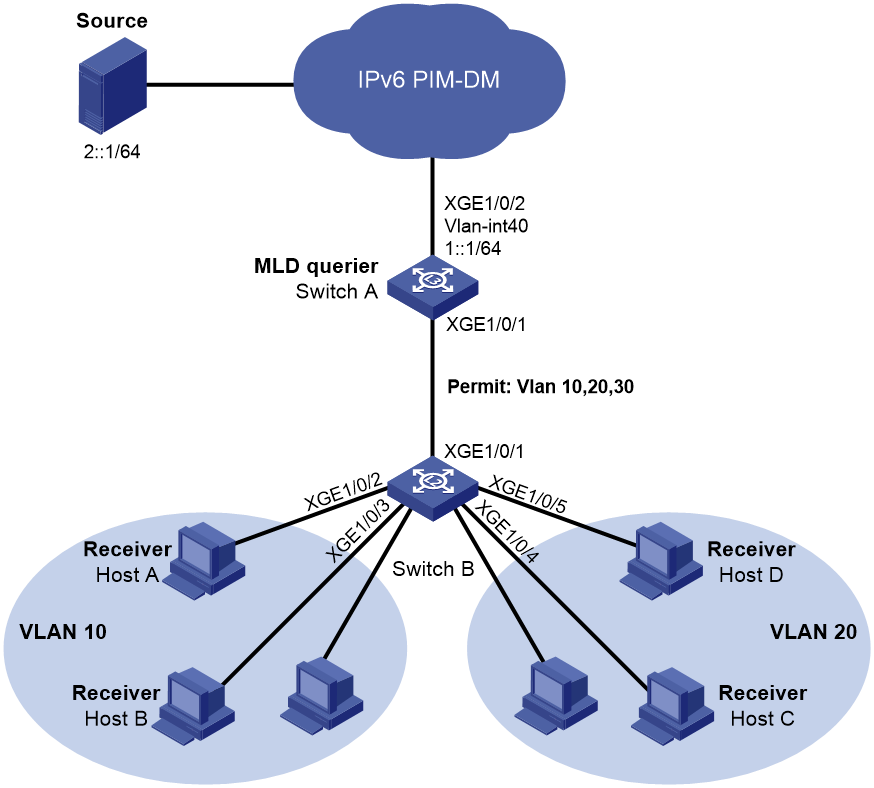

Example: Configuring sub-VLAN-based IPv6 multicast VLANs
As shown in Figure 1:
·     VLAN 10 and VLAN 20 are Department 1 and Department 2, respectively.
·     VLAN-interface 10 and VLAN-interface 20 on Layer 3 device Switch A are the gateways of VLAN 10 and VLAN 20, respectively.
·     MLDv1 runs in VLAN 10 on Switch A, and MLDv1 snooping runs in VLAN 10 on Layer 2 device Switch B.
·     The source sends IPv6 multicast data to IPv6 multicast group FF1E::101.
·     Host A and Host B in VLAN 10 join IPv6 multicast group FF1E::101. They can receive the IPv6 multicast data that the source sends to the group.
Figure 1 Network diagram

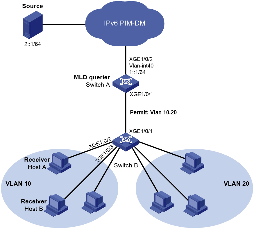

Now, Host C and Host D in VLAN 20 also join the group to receive the IPv6 multicast data, as shown in Figure 2. You can enable MLDv1 for VLAN 20 on Switch A and MLDv1 snooping for VLAN 20 on Switch B. In this way, Host C and Host D can receive the data addressed to the group. However, this occupies a large amount of bandwidth and increases the burden on Switch A.
To avoid the problems, you can configure a sub-VLAN-based IPv6 multicast VLAN on Switch B.
Figure 2 Network diagram
Analysis
To meet the network requirements, you must perform the following tasks:
·     Create VLAN 30 on Switch A and Switch B, and assign Ten-GigabitEthernet 1/0/1 on them to VLAN 30 as tagged VLAN members.
·     Create VLAN-interface 30 on Switch A, and enable MLD on the interface.
·     Enable MLD snooping for VLAN 10 through VLAN 30 on Switch B.
·     Configure VLAN 30 on Switch B as an IPv6 multicast VLAN, and assign VLAN 10 and VLAN 20 to IPv6 multicast VLAN 30 as sub-VLANs.

1.     Assign IPv6 addresses to VLAN-interface 10 and VLAN-interface 20 on Switch A. (Details not shown.)
2.     Configure a unicast routing protocol so that all devices on the network are interoperable at the network layer. (Details not shown.)
3.     Configure Switch A:
# Enable IPv6 multicast routing.
<SwitchA> system-view
[SwitchA] ipv6 multicast routing
[SwitchA-mrib6] quit
# Create VLAN 30, configure Ten-GigabitEthernet 1/0/1 as a hybrid port, and assign it to VLAN 30 as a tagged VLAN member.
[SwitchA] vlan 30
[SwitchA-vlan30] quit
[SwitchA] interface ten-gigabitethernet 1/0/1
[SwitchA-Ten-GigabitEthernet1/0/1] port link-type hybrid
[SwitchA-Ten-GigabitEthernet1/0/1] port hybrid vlan 30 tagged
# Create VLAN-interface 30, assign it an IPv6 address, and enable MLD on it.
[SwitchA] interface vlan-interface 30
[SwitchA-Vlan-interface30] ipv6 address 2001::1 64
[SwitchA-Vlan-interface30] mld enable
[SwitchA-Vlan-interface30] quit
# Create VLAN 40, and assign Ten-GigabitEthernet 1/0/2 to VLAN 40.
[SwitchA] vlan 40
[SwitchA-vlan40] port ten-gigabitethernet 1/0/2
[SwitchA-vlan40] quit
# Create VLAN-interface 40, assign it an IPv6 address, and enable IPv6 PIM-DM on it.
[SwitchA] interface vlan-interface 40
[SwitchA-Vlan-interface40] ipv6 address 1::1 64
[SwitchA-Vlan-interface40] ipv6 pim dm
[SwitchA-Vlan-interface40] quit
4.     Configure Switch B:
# Enable MLD snooping globally.
<SwitchB> system-view
[SwitchB] mld-snooping
[SwitchB-mld-snooping] quit
# Create VLAN 10, and enable MLD snooping for VLAN 10.
[SwitchB] vlan 10
[SwitchB-vlan10] mld-snooping enable
[SwitchB-vlan10] quit
# Create VLAN 20, and enable MLD snooping for VLAN 20.
[SwitchB] vlan 20
[SwitchB-vlan20] mld-snooping enable
[SwitchB-vlan20] quit
# Create VLAN 30, and enable MLD snooping for VLAN 30.
[SwitchB] vlan 30
[SwitchB-vlan30] mld-snooping enable
[SwitchB-vlan30] quit
# Configure Ten-GigabitEthernet 1/0/1 as a hybrid port, and assign it to VLAN 30 as a tagged VLAN member.
[SwitchB] interface ten-gigabitethernet 1/0/1
[SwitchB-Ten-GigabitEthernet1/0/1] port link-type hybrid
# Configure VLAN 30 as an IPv6 multicast VLAN, and assign VLAN 10 and VLAN 20 to IPv6 multicast VLAN 30 as sub-VLANs.
[SwitchB] ipv6 multicast-vlan 30
[SwitchB-ipv6-mvlan-30] subvlan 10 20
[SwitchB-ipv6-mvlan-30] quit
# Display information about all IPv6 multicast VLANs on Switch B.
[SwitchB] display ipv6 multicast-vlan
Total 1 IPv6 multicast VLANs.
IPv6 multicast VLAN 30:
  Sub-VLAN list(2 in total):
    10,20
  Port list(0 in total):
# Display information about multicast groups in IPv6 multicast VLANs on Switch B.
[SwitchB] display ipv6 multicast-vlan group
Total 1 entries.
IPv6 multicast VLAN 30: Total 1 entries.
  (::, FF1E::101)
    Sub-VLANs (2 in total):
      VLAN 10
      VLAN 20
The output shows that IPv6 multicast VLAN (VLAN 30) contains sub-VLANs VLAN 10 and VLAN 20. Switch B will forward IPv6 multicast data for VLAN 30 to VLAN 10 and VLAN 20.
[SwitchB] vlan 10
[SwitchB] vlan 20
[SwitchB] vlan 30
# Configure Ten-GigabitEthernet 1/0/2 as a hybrid port.
[SwitchB] interface ten-gigabitethernet 1/0/2
[SwitchB-Ten-GigabitEthernet1/0/2] port link-type hybrid
# Set the PVID of Ten-GigabitEthernet 1/0/2 to VLAN 10, and assign the port to VLAN 10 and VLAN 30 as an untagged VLAN member.
[SwitchB-Ten-GigabitEthernet1/0/2] port hybrid pvid vlan 10
[SwitchB-Ten-GigabitEthernet1/0/2] port hybrid vlan 10 30 untagged
[SwitchB-Ten-GigabitEthernet1/0/2] quit
# Configure Ten-GigabitEthernet 1/0/3 as a hybrid port.
[SwitchB] interface ten-gigabitethernet 1/0/3
[SwitchB-Ten-GigabitEthernet1/0/3] port link-type hybrid
# Set the PVID of Ten-GigabitEthernet 1/0/3 to VLAN 10, and assign the port to VLAN 10 and VLAN 30 as an untagged VLAN member.
[SwitchB-Ten-GigabitEthernet1/0/3] port hybrid pvid vlan 10
[SwitchB-Ten-GigabitEthernet1/0/3] port hybrid vlan 10 30 untagged
[SwitchB-Ten-GigabitEthernet1/0/3] quit
# Configure Ten-GigabitEthernet 1/0/4 as a hybrid port.
[SwitchB] interface ten-gigabitethernet 1/0/4
[SwitchB-Ten-GigabitEthernet1/0/4] port link-type hybrid
# Set the PVID of Ten-GigabitEthernet 1/0/4 to VLAN 20, and assign the port to VLAN 20 and VLAN 30 as an untagged VLAN member.
[SwitchB-Ten-GigabitEthernet1/0/4] port hybrid pvid vlan 20
[SwitchB-Ten-GigabitEthernet1/0/4] port hybrid vlan 20 30 untagged
[SwitchB-Ten-GigabitEthernet1/0/4] quit
# Configure Ten-GigabitEthernet 1/0/5 as a hybrid port.
[SwitchB] interface ten-gigabitethernet 1/0/5
[SwitchB-Ten-GigabitEthernet1/0/5] port link-type hybrid
# Set the PVID of Ten-GigabitEthernet 1/0/5 to VLAN 20, and assign the port to VLAN 20 and VLAN 30 as an untagged VLAN member
[SwitchB-Ten-GigabitEthernet1/0/5] port hybrid pvid vlan 20
[SwitchB-Ten-GigabitEthernet1/0/5] port hybrid vlan 20 30 untagged
[SwitchB-Ten-GigabitEthernet1/0/5] quit
5.     Configure VLAN 30 as an IPv6 multicast VLAN, and assign Ten-GigabitEthernet 1/0/1 through Ten-GigabitEthernet 1/0/5 to IPv6 multicast VLAN 30.
[SwitchB-ipv6-mvlan-30] port ten-gigabitethernet 1/0/2 to ten-gigabitethernet 1/0/5
# Display information about IPv6 multicast VLANs on Switch B.
  Sub-VLAN list(0 in total):
  Port list(4 in total):
    XGE1/0/2
    XGE1/0/3
    XGE1/0/4
    XGE1/0/5
# Display information about dynamic MLD snooping group entries.
[SwitchB] display mld-snooping group
Total 1 entries.
  (::, FF1E::101)
    Host ports (4 in total):
      XGE1/0/2                             (00:03:23)
      XGE1/0/3                             (00:04:07)
      XGE1/0/4                             (00:04:16)
      XGE1/0/5                             (00:05:10)
The output shows that MLD snooping maintains the user ports in the multicast VLAN (VLAN 30). Switch B will forward the IPv6 multicast data of VLAN 10 through these user ports.
